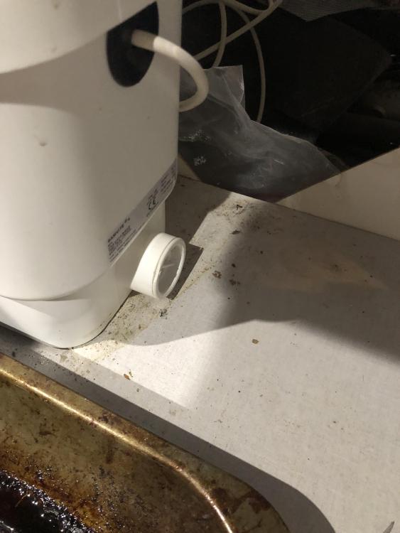

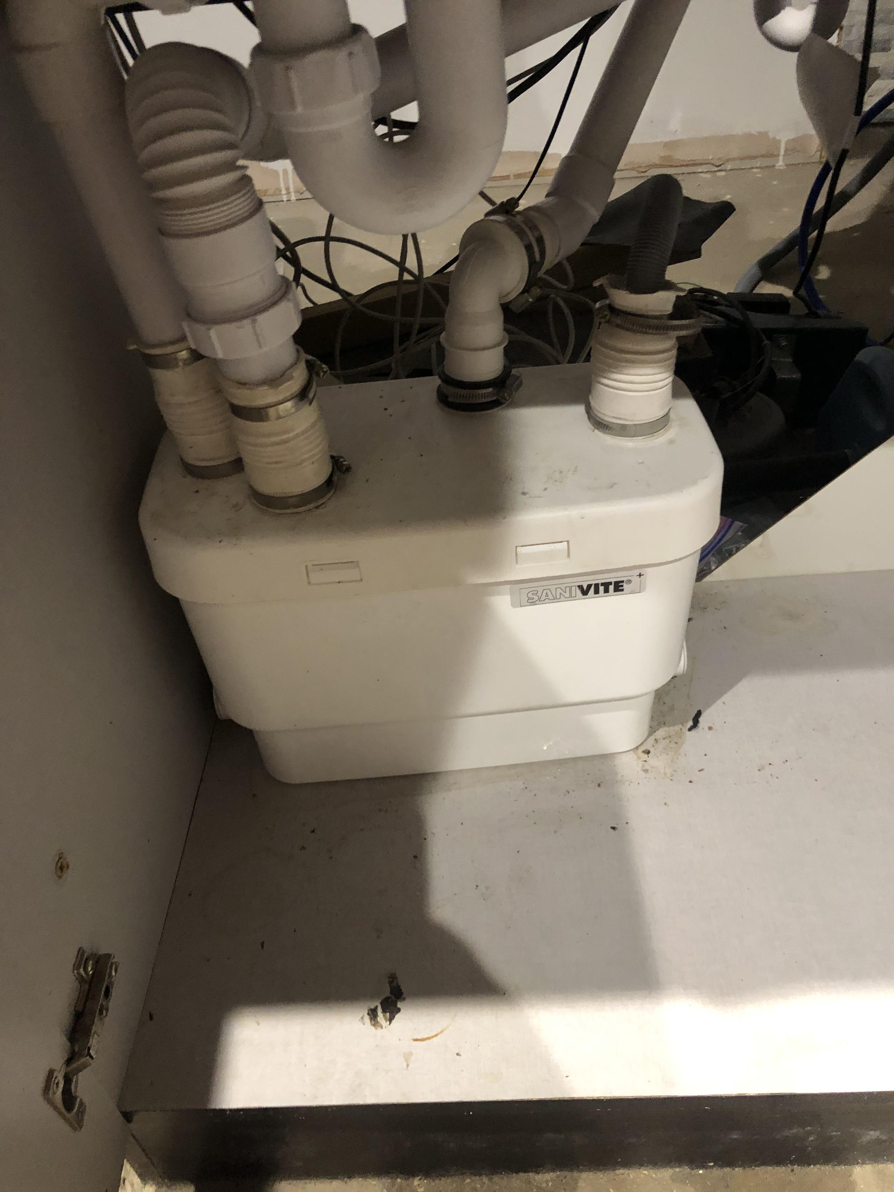

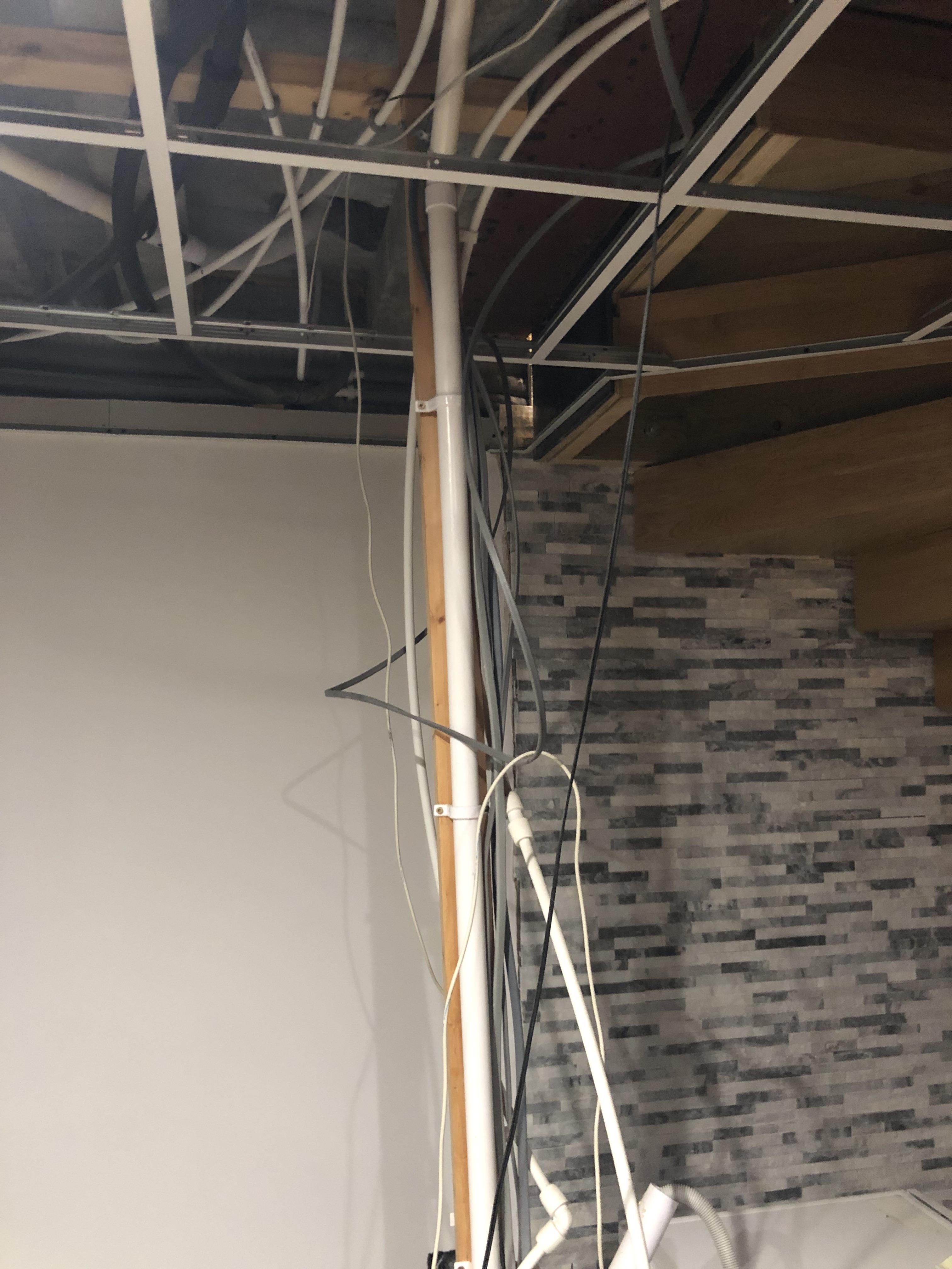

Pocster Posted October 5, 2023 Share Posted October 5, 2023 We are below ground level . Saniflo blocked - it’s grey water so presume just food waste . In the future though what should I do ? Currently it is draining but real slow ( like hours ) . Should I put some ‘tee off ‘ or something in the outlet pipework so I can drain it ?? As you can see even if I drain the sink I’ve still got a nice vertical pipe of stuff to deal with … Link to comment Share on other sites More sharing options...

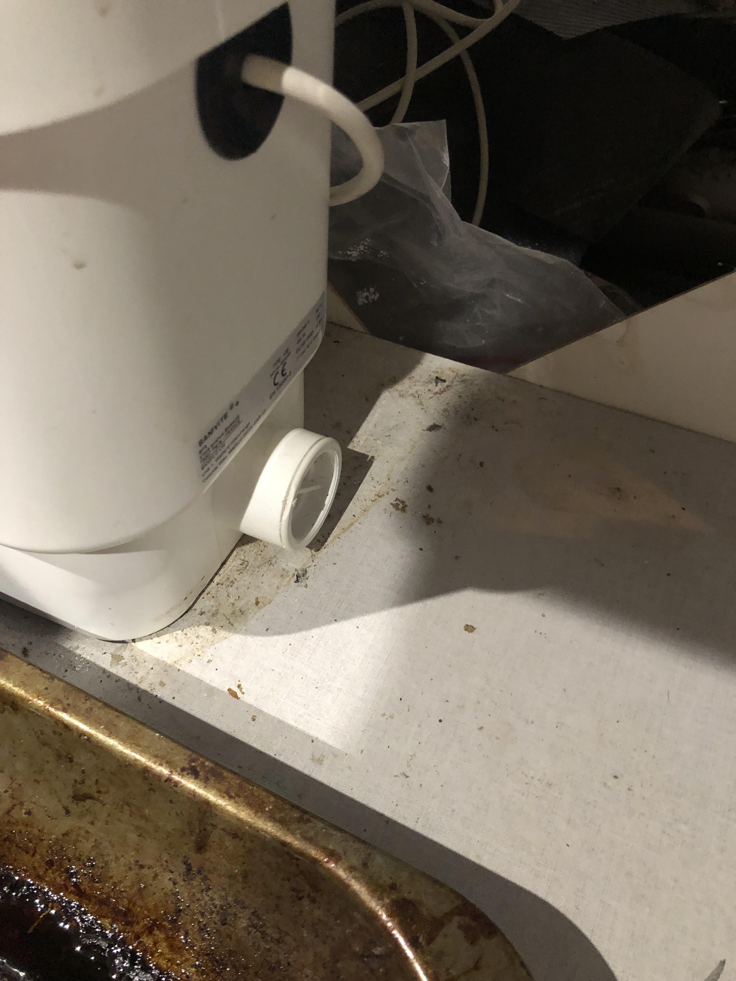

Pocster Posted October 5, 2023 Author Share Posted October 5, 2023 This a plug or a screw ? - I think it’s a plug ! So perhaps in the future raise the whole unit a bit so I can get a tray under it ? . Perhaps a ‘channel ‘ that takes the water to the front of the cabinet so easier to empty into a bigger tray ?? Link to comment Share on other sites More sharing options...
Pocster Posted October 5, 2023 Author Share Posted October 5, 2023 Perhaps a tap with a tube to the front of the cabinet ? . So I can drain in a controlled manner ?? Link to comment Share on other sites More sharing options...
markc Posted October 5, 2023 Share Posted October 5, 2023 I would say that’s a drain yes 1 Link to comment Share on other sites More sharing options...

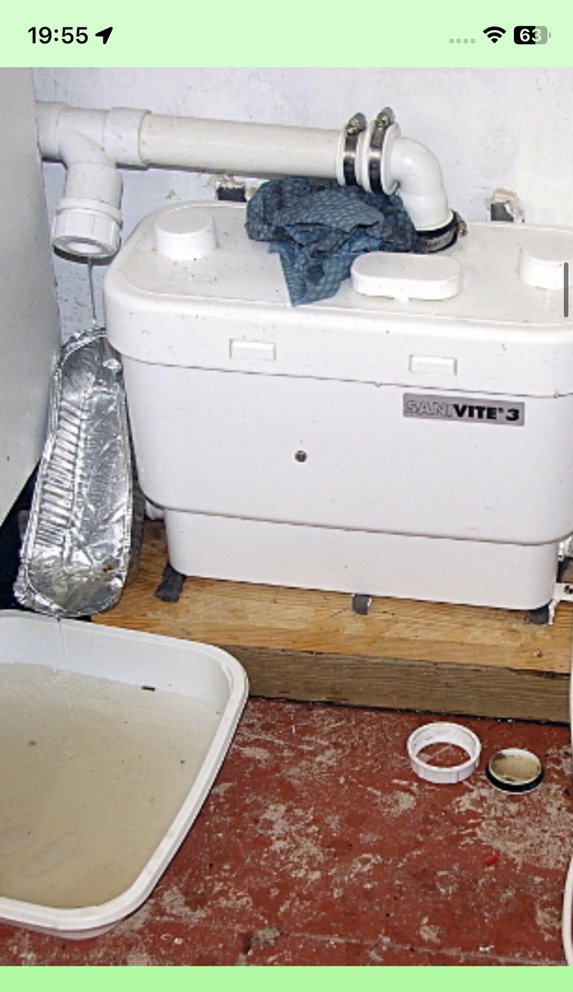

Pocster Posted October 5, 2023 Author Share Posted October 5, 2023 (edited) Should have fitted a tee on the outlet ( only temp kitchen so no a real issue ). If I take that plug off I’m going to flood shite everywhere Photo from internet Edited October 5, 2023 by Pocster Ffs Link to comment Share on other sites More sharing options...
Pocster Posted October 5, 2023 Author Share Posted October 5, 2023 Sink U trap with drain also ? . My plan is when sink is empty to disconnect then I can get some height under the unit and get a tray in . Link to comment Share on other sites More sharing options...
ProDave Posted October 5, 2023 Share Posted October 5, 2023 So if the sink is full and draining slowly, is the motor inside the saniflo running all that time to try and pump it up a presumably now blocked pipe? Link to comment Share on other sites More sharing options...
Pocster Posted October 5, 2023 Author Share Posted October 5, 2023 1 minute ago, ProDave said: So if the sink is full and draining slowly, is the motor inside the saniflo running all that time to try and pump it up a presumably now blocked pipe? No . It’s draining REAL slow . So every 20 mins or so the pump kicks in for a second . I presume the inlet / filter on the pump outlet pipe is blocked ( bet it’s rice ! ) Link to comment Share on other sites More sharing options...
ProDave Posted October 5, 2023 Share Posted October 5, 2023 No, that says to me, the water is only slowly trickling IN to the saniflo and the pump comes on when it gets enough to pump for a bit. I would start dismantling the sink trap and pipework between the trap and the saniflo. I would have thought if the saniflo was full and only pumping out very slowly, it would keep on pumping. 1 Link to comment Share on other sites More sharing options...
Pocster Posted October 5, 2023 Author Share Posted October 5, 2023 1 minute ago, ProDave said: No, that says to me, the water is only slowly trickling IN to the saniflo and the pump comes on when it gets enough to pump for a bit. I would start dismantling the sink trap and pipework between the trap and the saniflo. I would have thought if the saniflo was full and only pumping out very slowly, it would keep on pumping. Yeah I suppose it could be the sink trap blocked . I guess you are presuming pump would keep running if outlet blocked ? The saniflo unit feels heavy ( as though it’s full ) . Tomorrow will dismantle trap and see . Saniflo should put legs on unit so it’s easy to get a tray under to drain . Also a screw thread drain not a plug so controlled release of water . Link to comment Share on other sites More sharing options...

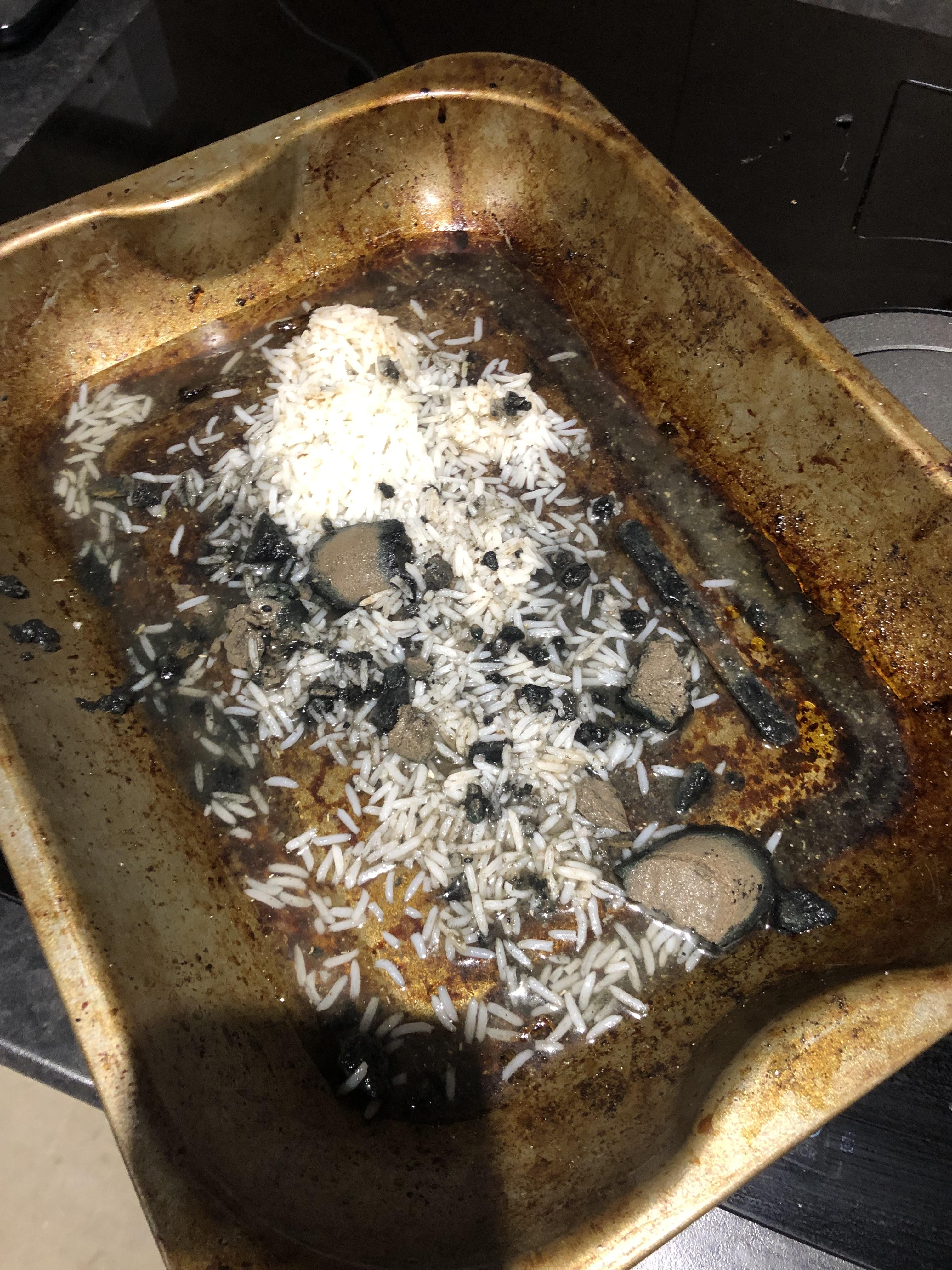

Pocster Posted October 5, 2023 Author Share Posted October 5, 2023 Top of the class for @ProDave I couldn’t resist undoing the sink trap …. What was in it ? Rice ( said so ! ) and erm cement or something … 🙄 Link to comment Share on other sites More sharing options...
