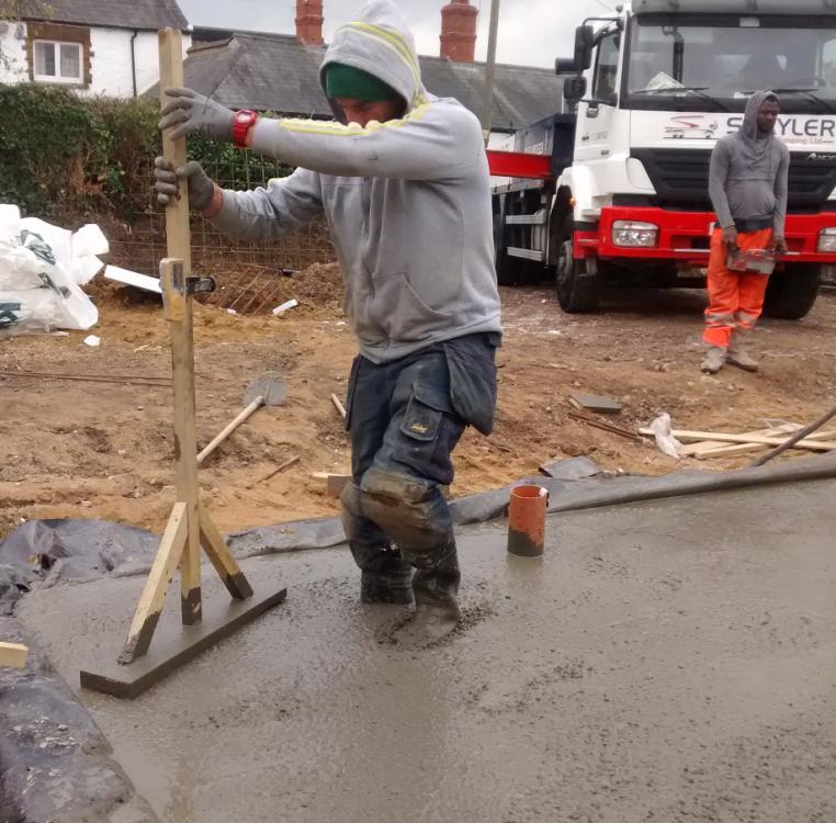

lizzie Posted September 3, 2017 Share Posted September 3, 2017 2 hours ago, Barney12 said: Yes, ours was power floated. ours was supposed to be power floated too and I assume it was but I have no idea who the lads were who did it, there were just 3 youngish chaps who did the white polystyrene stuff. I was not there when they did the concrete so cant say who was there. We had some nice Irish chaps putting the frame up but no idea of their names I was only there for short visits. One tiler who came to quote for the floor tiling said it would add about a thousand to our bill as he would have a lot to do to try and get the floor level....maybe he was trying it on! Our 3 soil pipes are in the wrong place and we are having to dig out the slab to move them back a foot to where they need to be for the wall hung w.c's At least there is no UFH in that area and I am not trying to apportion blame it is our fault we got the positions wrong. It seems that there was only a 20mm service void allowed for in the ceiling no one picked up that our downlights need 70mm so we are now having to pay for extra battening once insulation and membrane are done and that height difference affects the floor to ceiling kitchen units I have ordered and so on and on it goes......at least the mould is clearing up now the roof is watertight and we can get the place dried out. The complications and costs in sorting everything do make you wonder if it is worth it. I would think twice about doing this whole tf thing again too, last house build was 30 years ago traditional brick and block I understood that a lot better and it seems to be more flexible and forgiving, possibly a whole lot cheaper too! Link to comment Share on other sites More sharing options...

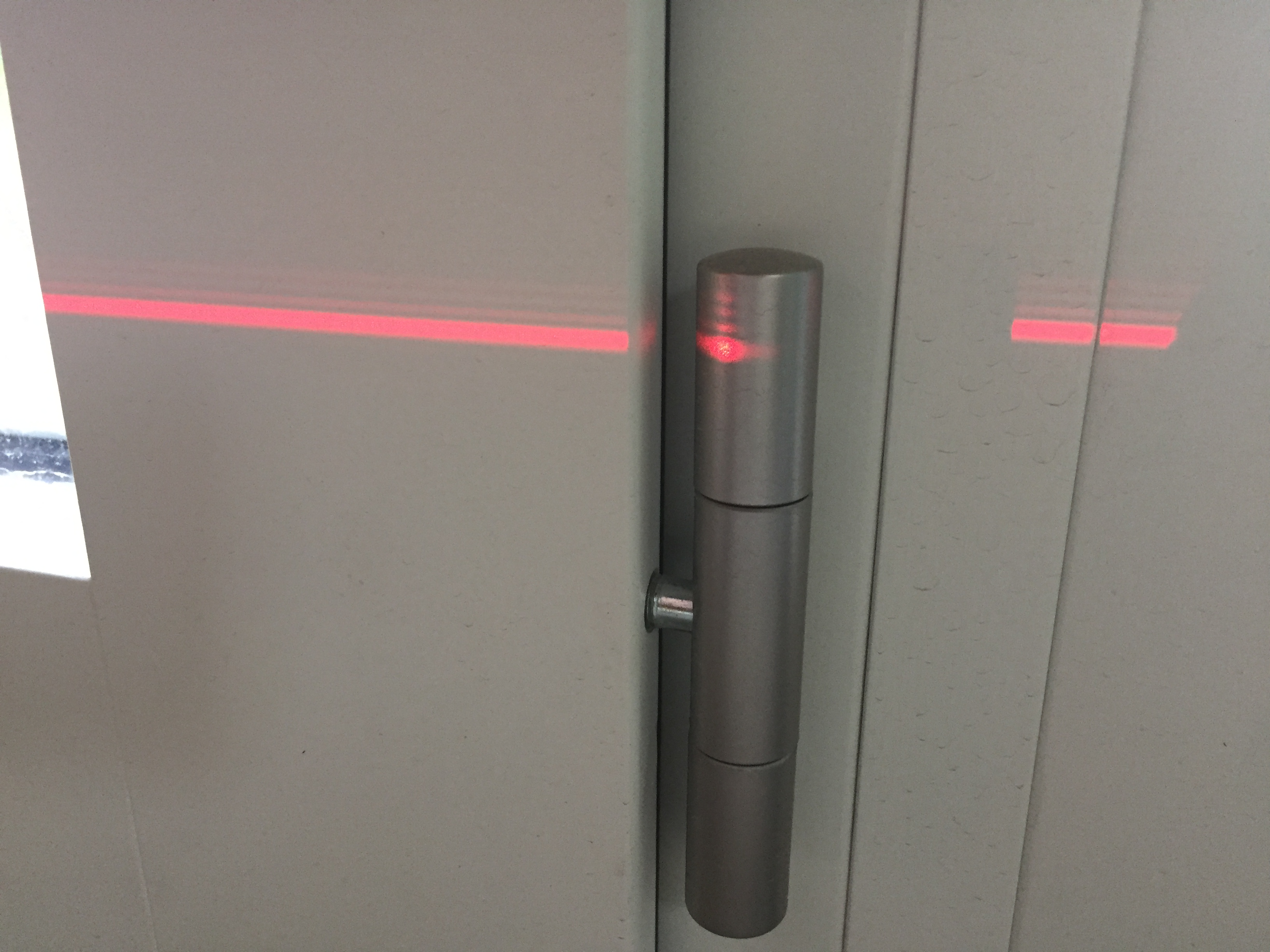

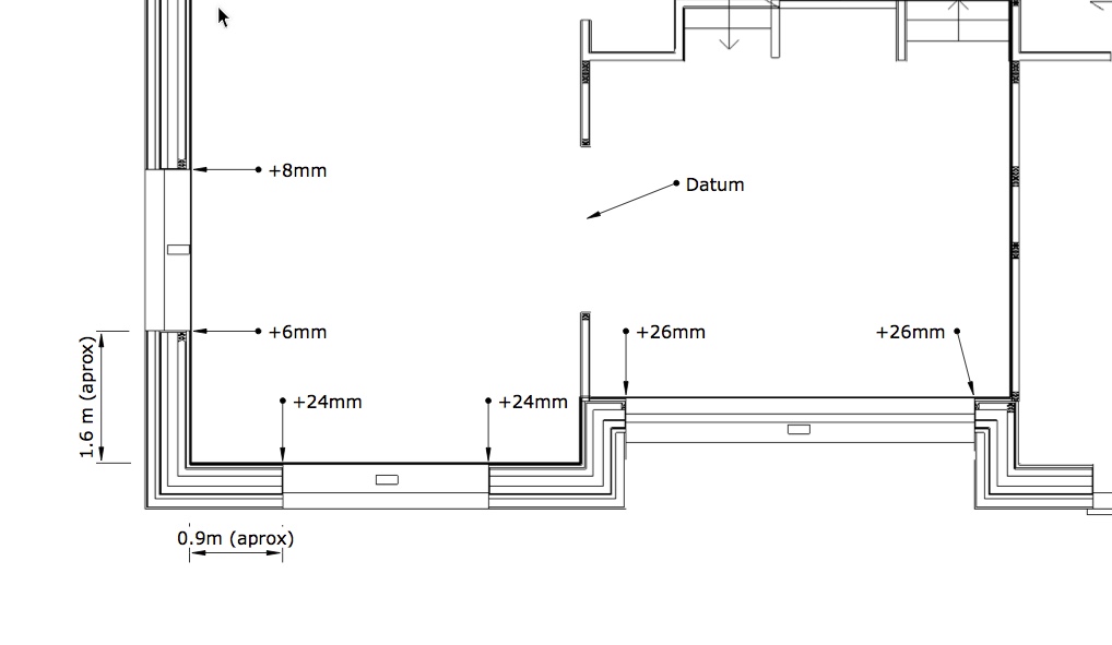

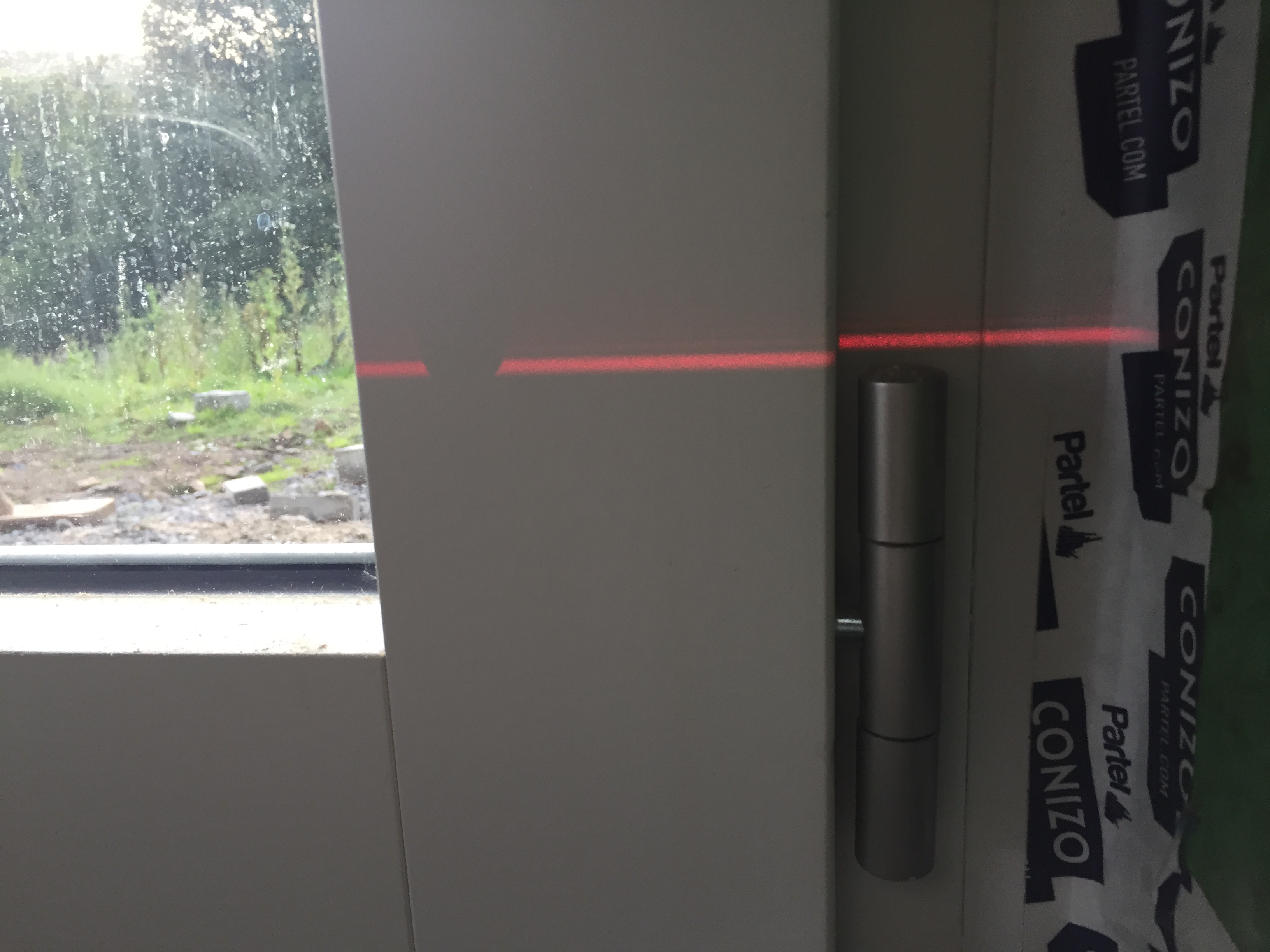

Barney12 Posted September 6, 2017 Author Share Posted September 6, 2017 OK, dragging this thread back to the beginning. @Nickfromwales OK, so popped up to site yesterday when I had a brief moment and set up the laser (just sat it on the floor). The results appear "less good" Note that the measurements below are to the threshold edge where the top of the tiles would sit. However, the results below only answer Nicks question about "are the two doors level". The gap below the threshold to the slab is actually around 20mm. This presumably demonstrates the slab not being level. As already show above the gap from threshold to slab on the slider differs considerably left to right. My head hurts I've also attached a couple of photo's of the laser line. The hinge position on each door photographed is identical. Link to comment Share on other sites More sharing options...
Nickfromwales Posted September 6, 2017 Share Posted September 6, 2017 @Barney12 Quite simple. You need an inventive tiler to come and give you some solutions. Its extremely difficult to advise definitively over the forum, and would be so much easier if I was on site. The window / door fitters should have fitted these using a single datum point TBH, but with the issues they encountered you can see why they've neglected to observe such an important detail, instead going for individual 'nice fits' at each opening. . You can blame them for progressing ( without identifying that these would differ, and having not informed you as such, and therefore not giving you the opportunity to stop and rectify before the fitting ) but you also can't blame them as this wasn't really their problem to overcome, not to the extent that they've had to at least. Looking at the plan in the last post, it seems the only real issues are the areas marked as +6 to +8mm as you won't have enough depth to get a tile under the door threshold ? Is that the case ? If so MBC can simply grind those areas down accordingly. If the other areas are just over the required / ideal deficit, then they're easily resolved with some proper self leveling? You mark +6, +8 etc which you mean distance from threshold to screed yes? Also, opposite the opening marked +26, is the floor flat in that room to the wall opposite the opening? Need to know that that doesn't raise up again. Im about to tile a bathroom floor. It runs out 15mm to nothing, from the window to the door opposite, and that's only over 2400mm. I'm going to take ~ half of that out with adhesive, prob up to 10mm then the remaining 5mm won't matter as it simply won't be seen. Please confirm the above and we can box this off. ? Link to comment Share on other sites More sharing options...
Nickfromwales Posted September 6, 2017 Share Posted September 6, 2017 Oh, also, if the door hinges are differing in height aka the thresholds differ, are the measurements you show already taking this into consideration? eg +6 etc is 6mm from the FFL that you wanted to end up with. Eg if you sat a 10mm tile there on 4mm of adhesive you would be 8mm above the target FFL? Eg +26 with the same would be 12mm BELOW the target FFL? Link to comment Share on other sites More sharing options...
Barney12 Posted September 6, 2017 Author Share Posted September 6, 2017 Hi Nick, sorry I am succeeding in confusing! All I was doing in the above was answering your question: "Are the kitchen diner thresholds level with the one marked?" Thus my datum point is at "0" and the measurements show the threshold level. If everything had been done correctly then all of these measurements should be 18mm (I.e. 18mm from threshold to slab). However they are not. BUT I do have more than 6mm and 8mm on that West door. this thus corresponds with the slab sloping. When I get to site later I'm going to take some slab measurements and will add them to the drawing. Hopefully it will then become clearer P.S. I know a really good pro-tiler but he's too bloody busy to do my floor Link to comment Share on other sites More sharing options...
Nickfromwales Posted September 6, 2017 Share Posted September 6, 2017 Ok sorry. I thought you'd updated on screed top to current threshold. My mistake. So what your saying is the doors are nearly 20mm higher / lower than each other. Just future fyi, always choose the highest single point as your datum and call THAT zero. If the laser line won't go that low, find the highest point and call that 'ref point zero'. Mark the wall 1000mm up from there and that's your datum +1000. Start at the left and right hand margin of each opening. With the laser line on at the 1000mm mark simply stand up and lower the end of the tape measure down until it hits the screed and take the reading where the laser hits the tape ( say 1026 aka "datum + 26" ) and then at the same point measure the threshold and record that too. Go around all 4 corners of small rooms or 6 or 8 points around larger rooms to create a map. That way you know the highest point ( i.e. the point you cannot exceed ) and you should then have 2 measurements for each side of each opening, threshold and screed. PM me when your on site and I'll give you a ring whilst your there if easier Link to comment Share on other sites More sharing options...

Barney12 Posted September 6, 2017 Author Share Posted September 6, 2017 3 hours ago, Nickfromwales said: Ok sorry. I thought you'd updated on screed top to current threshold. My mistake. So what your saying is the doors are nearly 20mm higher / lower than each other. Just future fyi, always choose the highest single point as your datum and call THAT zero. If the laser line won't go that low, find the highest point and call that 'ref point zero'. Mark the wall 1000mm up from there and that's your datum +1000. Start at the left and right hand margin of each opening. With the laser line on at the 1000mm mark simply stand up and lower the end of the tape measure down until it hits the screed and take the reading where the laser hits the tape ( say 1026 aka "datum + 26" ) and then at the same point measure the threshold and record that too. Go around all 4 corners of small rooms or 6 or 8 points around larger rooms to create a map. That way you know the highest point ( i.e. the point you cannot exceed ) and you should then have 2 measurements for each side of each opening, threshold and screed. PM me when your on site and I'll give you a ring whilst your there if easier Ta. Understood. I won't get there tonight as work is getting in the way. Link to comment Share on other sites More sharing options...
