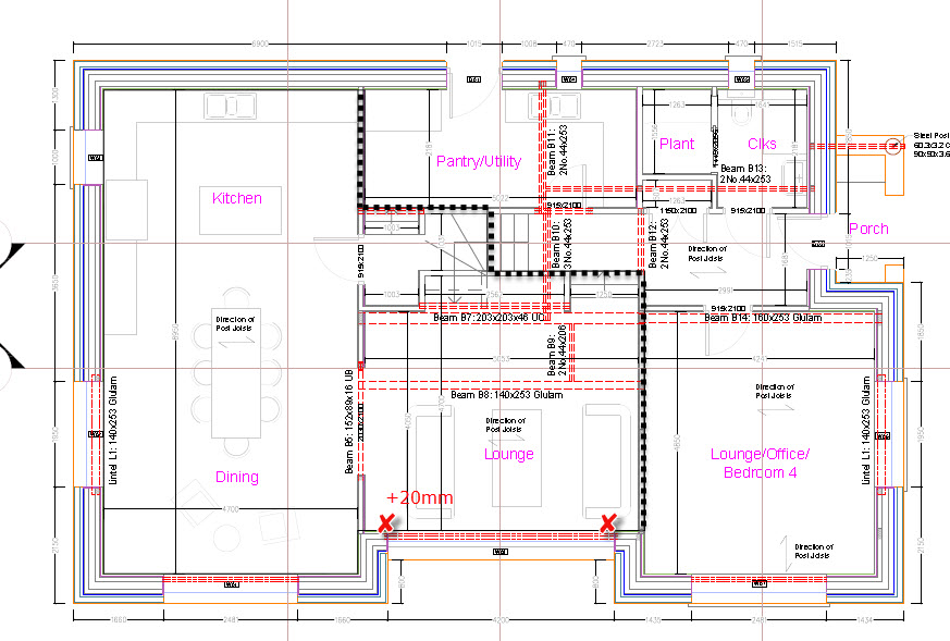

Barney12 Posted September 3, 2017 Share Posted September 3, 2017 (edited) OK, so I know my slab isn't level, you only need your eyes to see that. As an example; on the large sliding door I've got 20mm difference from one end to another (over 4m). I've got 5 sets of doors with level thresholds. Huge amounts of pre-planning detail was put into ensuring the doors would sit correctly into the slab so that the slab floor was 18mm below the FFL to allow for the tiling that is running through the entire house. I was lucky enough to be lent one of these: https://www.powertoolsuk.co.uk/bosch-gsl2set-floor-surface-lasers.html?gclid=EAIaIQobChMIuZPQ3tiI1gIV6rDtCh3uSwV-EAQYAyABEgJ3z_D_BwE so in a spare hour yesterday (whilst nursing my severe man flu, sympathy please) thought I'd have a look at "how the land lies" (quite literally! ). Its an incredible peice of kit, very clever. But alas all it did was make by brain hurt . The floor levels run all over the place and I'm failing to see how a tiler is ever going to create the beautifully flat level access around the house which was so important to us. But im no pro tiler and so perhaps I'm just worrying too much (as we all know a self builders biggest affliction). So what now? MBC have offered to come back and level the slab but from the measurements I've taken where they will level one door they'll throw the levels out elesewhere. I was was wanting to use the laser above to gauge out the various level changes so that I got what I wanted (I'm not entirely convinced MBC have got the skill set to put this right). But with so many conflicting levels I just got myself lost. So so some specific questions: 1. How do you choose a rooms datum point. I assume it's normally the highest point and work out from there. Or do you just go with the middle of the room? 2. Can a pro tiler (like our resident @Nickfromwales) "loose" these level changes? Presumably by feathering out across as big a distance as possible? 3. Is it sometimes better just to grind off an area of high spot? Presumably there are tools for the job that are designed to do this and get into corners? (Without trashing my expensive frames!). Many thanks in advance. Edited September 3, 2017 by Barney12 Typos Link to comment Share on other sites More sharing options...
Nickfromwales Posted September 3, 2017 Share Posted September 3, 2017 @Barney12 Ok, just to better grasp this. Your rooms are to be tiled through from one space to another, room to room, seamlessly? Does the tiled floor run past several external / folding door thresholds, and have you established that all the door thresholds are all exactly the same level off a datum you've fired through the floor space ? Do you have a flor plan you can post with an example of where the tiled floor starts and finishes ? Saves a lot of typing. . Link to comment Share on other sites More sharing options...
Jeremy Harris Posted September 3, 2017 Share Posted September 3, 2017 Our tiler spent around 40 minutes or so trying to find the highest point on the continuously tiled area to use as the starting point. The idea was he would work from there, and if any areas were beyond the tolerance he could take up with adhesive then some levelling compound would be use to bring them up to within tiling tolerance. We were lucky, our slab was dead flat, so flat that we had loads of tile adhesive left over (around eight, 20kg bags, IIRC). I think that the adhesive can make up for something like a 6mm discrepancy, any more than that and you need to level things out first. @Nickfromwales is the guru, though, and will correct me if I've got this wrong. Link to comment Share on other sites More sharing options...

Barney12 Posted September 3, 2017 Author Share Posted September 3, 2017 OK, thanks. I'll use the internal door threshold and the external door thresholds as my datum markers. Ill see if I can sketch up a plan. Link to comment Share on other sites More sharing options...
Barney12 Posted September 3, 2017 Author Share Posted September 3, 2017 42 minutes ago, Nickfromwales said: @Barney12 Ok, just to better grasp this. Your rooms are to be tiled through from one space to another, room to room, seamlessly? Does the tiled floor run past several external / folding door thresholds, and have you established that all the door thresholds are all exactly the same level off a datum you've fired through the floor space ? Do you have a flor plan you can post with an example of where the tiled floor starts and finishes ? Saves a lot of typing. . Sorry only just seen this earlier reply. I'll post something up shortly. Link to comment Share on other sites More sharing options...
Nickfromwales Posted September 3, 2017 Share Posted September 3, 2017 Add as much info as you can. ? Link to comment Share on other sites More sharing options...
Barney12 Posted September 3, 2017 Author Share Posted September 3, 2017 (edited) OK, so here's a floor plan: We have a split level slab which I've denoted with a dotted line. The higher section (right) concerns me less. I've marked the height difference points by the silder. At this point the slab is roughly 18mm as required. It then drops to c35mm at the other end. I've noted your comment about needing to see if all the door thresholds are at the same height. I'll try and do that tomorrow. Edited September 3, 2017 by Barney12 Link to comment Share on other sites More sharing options...
Nickfromwales Posted September 3, 2017 Share Posted September 3, 2017 Ok. I'll open that on the iPad later when you've updated the info ? Link to comment Share on other sites More sharing options...
Barney12 Posted September 3, 2017 Author Share Posted September 3, 2017 3 minutes ago, Nickfromwales said: Ok. I'll open that on the iPad later when you've updated the info ? Tis up. Ta for reviewing Link to comment Share on other sites More sharing options...
Nickfromwales Posted September 3, 2017 Share Posted September 3, 2017 Ok, so is this contained to one room if only one is marked or will it also need to match in the kitchen diner? Are the kitchen diner thresholds level with the one marked ? Link to comment Share on other sites More sharing options...

Barney12 Posted September 3, 2017 Author Share Posted September 3, 2017 8 minutes ago, Nickfromwales said: Ok, so is this contained to one room if only one is marked or will it also need to match in the kitchen diner? Are the kitchen diner thresholds level with the one marked ? The big double doors between the lounge and the kitchen/dinner will remain open almost all of the time so the idea was this was all on the same level with no threshold to create feeling of space. I haven't checked the levels of all three but will tomorrow. Link to comment Share on other sites More sharing options...

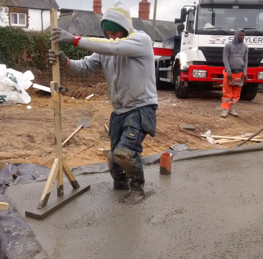

Oz07 Posted September 3, 2017 Share Posted September 3, 2017 Was @JSHarris slab not power floated? From the sounds of it the two latest slabs haven't been? Has this been dropped from the spec or is it an 'extra' within the package? I usually use a self compacting concrete which with not much skill you can get to within 10mm. Dare say tighter tolerance if you spend a little more time and effort on it. Link to comment Share on other sites More sharing options...
Barney12 Posted September 3, 2017 Author Share Posted September 3, 2017 2 minutes ago, Oz07 said: Was @JSHarris slab not power floated? From the sounds of it the two latest slabs haven't been? Has this been dropped from the spec or is it an 'extra' within the package? I usually use a self compacting concrete which with not much skill you can get to within 10mm. Dare say tighter tolerance if you spend a little more time and effort on it. Yes, ours was power floated. Link to comment Share on other sites More sharing options...
Oz07 Posted September 3, 2017 Share Posted September 3, 2017 hmm perhaps the change in level doesn't help in gauging a flat slab but still disappointing. Perhaps MBC should consider self compacting concrete if struggling with skills shortage? Link to comment Share on other sites More sharing options...
TerryE Posted September 3, 2017 Share Posted September 3, 2017 (edited) @Barney12 It sounds like MBC have got real quality issues with one of their foundation / slab crews. In our case they were very particular about getting the entire site level at each compaction layer as well as at the sand base and the formwork before they started the pour. We later found a slight low point in one room (about 4mm in a 6.5 m span), that they missed during floating. We didn't have Brendan, but his #2 Mick. I asked Mick why they were so particular about the layered compaction, and he said that the main risk with this type of slab was differential settlement across the slab if the underlying ground or the layering / compaction across the area wasn't uniform and this could lead to local slumping across the slab before it properly started to cure. If they did the same on your slab, I can't see them getting the concrete levels out by 20mm. Do you think that it could have been differential settlement? Even so the right thing to do would have been to fix it by levelling before doing starting the frame. And the framing crew should have highlighted this issue. Not good. Edited September 3, 2017 by TerryE Slight clarfication of wording Link to comment Share on other sites More sharing options...
Jeremy Harris Posted September 3, 2017 Share Posted September 3, 2017 32 minutes ago, Oz07 said: Was @JSHarris slab not power floated? Yes, it was power floated, in the main, but because the concrete was delivered late (a pretty familiar tale, I'm sure........) the final finish was by hand, out of deference to the neighbours at around 10pm. Link to comment Share on other sites More sharing options...

Barney12 Posted September 3, 2017 Author Share Posted September 3, 2017 Our initial slab work was subcontracted to someone (called Matt) who then subcontracted it (from what I could gather). To be frank the initial guy onsite (with his son) didn't seem to have any experience and did little to fill me with confidence, in fact his attitude was very poor. Brendan and his crew did arrive later on in the work as they were falling behind. But, as seems to be the case with Brendan (and Darren) they would arrive one day and be gone the next as they juggled multiple jobs. In fairness (although still MBC's error) our problems were compounded by the timber frame designer (again a subcontracted element not an employee of MBC) getting the frame detail wrong and the initial slab crew cocking up the recesses that the window/door frames were designed to fit in. There was much remediation with a grinder and bolster chisel !!! As ive already said though MBC have been very helpful in putting things right. I just hope that we get the floor we want Link to comment Share on other sites More sharing options...
