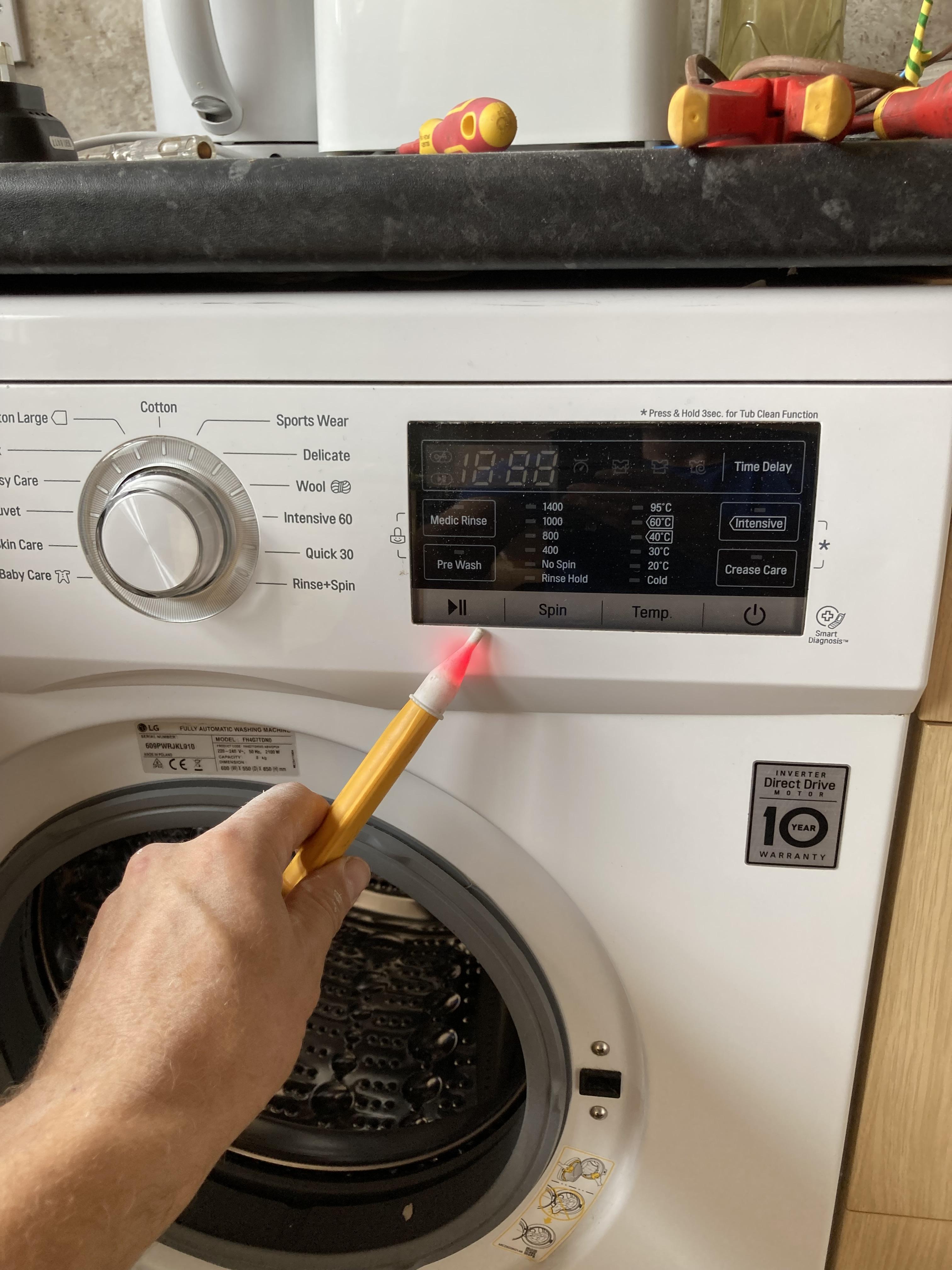

I have a washing machine that gave a mild shock recently on the leg when brushing against the main body of the machine (been fine for years).
using a tester it lights up when and only when I point it at the (plastic) control panel (see pic).
I have inspected the plug and it looks fine, the supply tests fine with a plug in tester (only thing it says on it is that it can’t detect earth neutral reverse).
I have used a pat tester and it seems to pass when I connect the testing lead to the screws next to the door latch. But fails on the first test of continuity of earth when touching the main painted section (seems like metal to me whereas the top section with controls is plastic as is the bottom section with drain/filter). Should that not pass since it is painted?
the unit passed a pat test that I had an electrician do in June this year for what that is worth.
any ideas or next steps to isolate the problem?
The light up tester is working correctly near the plastic panel because there are live components behind there. Is the shock from the metal parts or from the door? If it’s the door then mostly likely a static build up as opposed to an electrical problem. If it is the metal parts then possibly an electrical issue and possibly due to a loose or broken earth due to vibration, replace or even add another earth “bond” connecting the offending panel to the other earthed areas/conductor.
Check the socket that is is plugged into.  PAT test will only confirm continuity from earth pin of the WM plug to the WM case.  If the earth is missing from the socket you could get the effect you describe.
Volt sticks have their uses but this is not one of them.
As above, there’s a good chance there’s no earth continuity to the socket. A cheap plug in tester may or may not flag this up, as they are not really 100% reliable.
You may need to get an electrician to check this.
+1 To the no/bad Earth theory.

Well got the socket tested and earth for the cu and all was well.
ended up buying a new washing machine for tenants’ peace of mind and am keeping the old one as a replacement at some point
