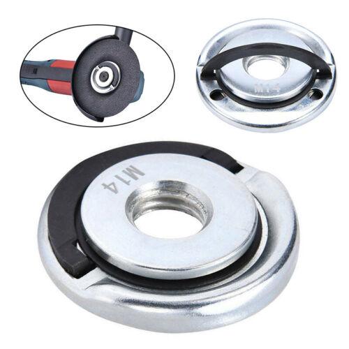

Temp Posted September 1, 2023 Share Posted September 1, 2023 I have two second hand angle grinders of unknown make and hate them both. Watch out tor.... ON/Off switches that are near impossible to work or latch on when wearing gloves. Spring loaded locks you need to press to stop the disc rotating when undoing the nut. Nightmare trying to hold the grinder, hold the lock and work the spanner. This type of no tool quick release nut is great and fit most makes.. 2 Link to comment Share on other sites More sharing options...
