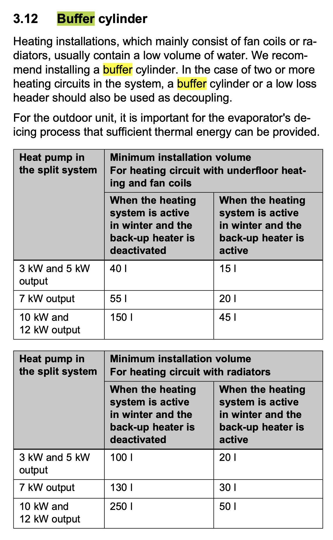

AliG Posted September 1, 2023 Share Posted September 1, 2023 6 minutes ago, zoothorn said: I'll await AliG's response (or anyone else's) to my idea of promising to turn off/ not use 3 rads. Looks like we crossposted. The 150l requirement is total water in the system between radiators and the buffer tank. I suspect they are looking at a 90l buffer tank which would be roughly the size you have quoted. If you turn off the radiators then there will be even less water in the system and they will want a bigger buffer tank again. If historically you have turned off the radiators then this may have caused a problem as they assume the volume of water in the radiators when making their calcs for the system. I think the system will run better with the radiators on and they will be providing some heat at a reasonable cost even if you then have to run a fire/stove or whatever on top of this. Link to comment Share on other sites More sharing options...

AliG Posted September 1, 2023 Share Posted September 1, 2023 2 hours ago, zoothorn said: Im still struggling to under the purpose of the buffer. Even resding your post above, 3x. I'll try to explain this simply. I am not 100% sure myself but this excerpt comes from the split system manual. It would be the same for a split or mono system. 1. You need a buffer as UFH and radiators will run at different times and the ASHP is not efficient running in short bursts (short cycling). With a buffer tank the ASHP heats up the water in the tank as well as in the heating system and when the heating system calls for heat this heat can be supplied first from the buffer tank before the ASHP runs for a longer burst again to heat up the tank and water in the radiators/UFH loops. 2. When you run an ASHP, it is like a fridge running backwards. If you stand in front of it, the air coming out is cold as it has drawn the energy out of the air and used it to heat water. In the winter, when the ASHP runs harder, eventually this causes water vapour in the air or rain/snow to freeze onto the coils of the ASHP which stops it running efficiently. So every so often it will run a defrost cycle to melt the ice. Indeed you will see a large amount of water running off it in winter. There are two ways to perform this defrost cycle, you can either run a backup heater directly in the ASHP, or you can briefly reverse the system and use warm water in the system to melt the ice. This is why if you have no back-up heater you need a buffer tank as you need a large enough amount of warm water so it carries enough energy to melt the ice ("sufficient thermal energy" as it says in the manual). It is also why turning off the radiators is a bad idea as it could impede this function by reducing the amount of warm water available to the system. I can only assume that the current split unit has a back-up heater and the mono unit is not planned to have one. You would have to ask the installer the reason for this. Both units appear to be able to have a back-up heater and have the same requirements for 45l of water with the heater and 150l without it. Unless of course the current unit was incorrectly installed with neither the heater nor buffer. Someone should be able to tell you why this change has happened. Just to be clear the 45l and 150l figures are for the amount of hot water in the whole system. Radiators tend to hold less water than UFH loops, so your system probably does not have much water in it and would need a larger buffer tank than someone with UFH needs. This issue why altering the number of radiators would alter the size of the buffer tank. Link to comment Share on other sites More sharing options...

AliG Posted September 1, 2023 Share Posted September 1, 2023 OK @zoothorn I don't want to get you frazzled. Feel free to read this tomorrow. Your current and your replacement ASHP both have the same requirements for minimum water volume in the system. The requirement is 45 litres if they have a backup heater installed in the heat pump and 150 litres if they don't. You don't need to know anything else about the backup heater just that with a backup heater you need 45 litres of water in the system and without it you need 150 litres. If your current ASHP does not have a buffer tank the assumption would be it has a backup heater so only needs 45 litres of water in the system and this is covered by the water in your radiators and pipework. So if the new ASHP also had a backup heater it also would not need a buffer tank. The only reason it would need a buffer tank is if it does not have the heater. So ask them if it can have a backup heater instead of a buffer tank like the current one. Link to comment Share on other sites More sharing options...

zoothorn Posted September 1, 2023 Author Share Posted September 1, 2023 @AliG why is there 105 litres of water discrepency, between a system that has a heater, to one that hasn't? I cannot equate a huge volume of water, to a heater. The two things seem alien ti each other. But you say they're inter-dependent. I have absolutely no idea what this additional heater's design principle is. Additional? Surely if there's some water in a CH system, it is heated by a heater. What on god's earth then, is all this about an --extra-- heater, sometimes there but sometimes not ?? And how does this bizarre extra heater thing, relate to a huge fridge sized vessel to hold water? It's like someone saying a car 'oh well if it has an extra combustion engine, you need to tow a trailer on the back'. I'm sorry what did you just say, I have a what & so I need a what??? Two totally unrelatable things, but somehow inherrantly dependent on each other. It doesn't compute. With these pathetic sniping posts in between trying to read your info.. I honestly cannot cope anymore. Appreciated. Zoot Link to comment Share on other sites More sharing options...
