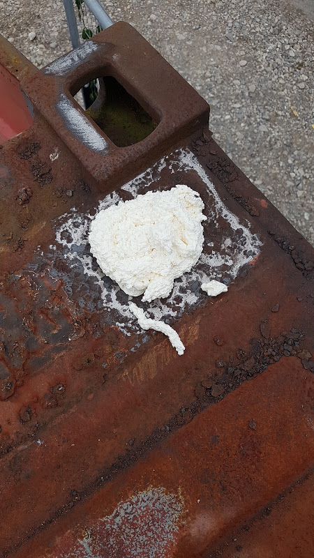

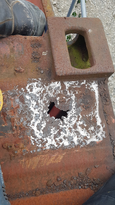

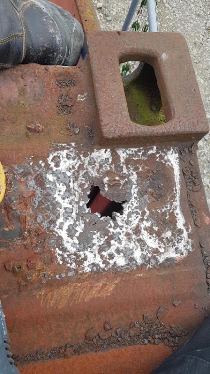

ToughButterCup Posted August 25, 2017 Posted August 25, 2017 I got some inspiration from you all....... I bought another container yay! Trouble is it's a bit rusty in parts. So, scorched by the heat of my own brilliance at welding , I got the grinder out and had a happy half hour getting this far.. Now even I know that ain't good enough, level enough, bright enough, so I chickened out I am deeply ashamed and am off to the pub early to drown my sorrows and incompetence. Thing is, do I cut a piece out, and then weld over the top? Or do I just grind away until there's enough bright metal to which to weld (I'm stick welding)? Please tell me foam will be fine. Have a productive weekend. Ian
Jeremy Harris Posted August 25, 2017 Posted August 25, 2017 The best bet is to either cut out a rectangular section, using a thin cutting disk, to get back to solid metal,then cut a patch and weld it into the hole, or just grind back to solid metal, a fair way from the badly corroded bit, then spray it with weld-through zinc primer (comes in aerosol cans), cut a new bigger patch of steel sheet and weld it on over the top. Give the whole job a coat of decent primer and paint and it'll be as good as new.
ToughButterCup Posted August 25, 2017 Author Posted August 25, 2017 6 minutes ago, JSHarris said: [...] or just grind back to solid metal, a fair way from the badly corroded bit, then spray it with weld-through zinc primer (comes in aerosol cans), cut a new bigger patch of steel sheet and weld it on over the top. Give the whole job a coat of decent primer and paint and it'll be as good as new. Ha! That's tomorrow morning sorted, then. Thanks.
MikeSharp01 Posted August 25, 2017 Posted August 25, 2017 Just now, recoveringacademic said: Ha! That's tomorrow morning sorted, then. Thanks. We will look forward to reading all about it tomorrow afternoon then, hope all goes well.
Russell griffiths Posted August 25, 2017 Posted August 25, 2017 TBH you need to think what this is for and how long until you sell it on. Welding to that with a stick will be a pita unless you are a welding god. Which you are probably not as you wouldn't need to ask the question. I would cut a patch larger than affected areas, clean area and prime stick patch on with stickaflex or ct1 smear around edges and smooth off with a paintbrush dipped in appropriate thinner, prime and paint over the whole patch. Go to pub with money saved from all those bent twisted welding rods. Ca Ching.
Onoff Posted August 25, 2017 Posted August 25, 2017 If MIG then you want clean metal as it's much less forgiving than stick. You can lay an oversize patch on the area then cut thru both panels with a 1mm slitting disc. Gives you a nice 1mm gap to weld. Ideally you want to clamp the new plate down or fix with self tappers. (Don't forget to take the screw out and weld the hole up or the MOT tester will say you screwed the panel on and didn't weld it. Ask me how I know... ) Reminds me, I need to fire up the MIG for the shower tray.

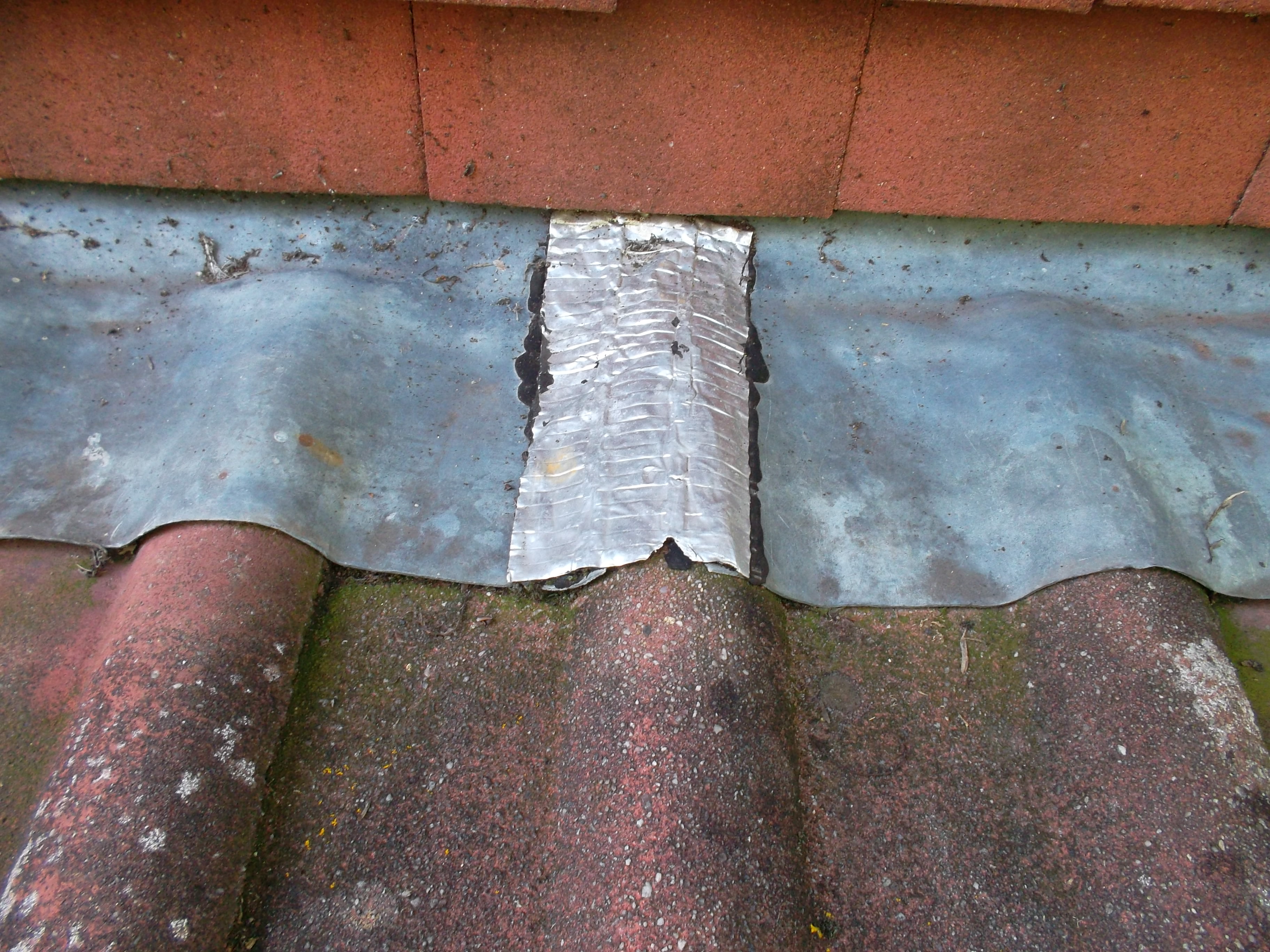

PeterW Posted August 25, 2017 Posted August 25, 2017 If you are just trying to make it watertight then go get a roll of flash band or that repair tape for gutters. Clean the loose crap off, make sure it's dry and preferably warm (blowtorch ...) then bang some tape on it, roller it down and job done ..
Onoff Posted August 25, 2017 Posted August 25, 2017 How a about a nice square of Solarshield? H.duty, textured aluminium facing with a bitumen backing. Peel off, lay on, heat gun, done.

Triassic Posted August 25, 2017 Posted August 25, 2017 There's got to be some satisfaction in cutting back to good steel and welding in a new bit. Personally I'd go with MIG rather than stick.
Vijay Posted August 25, 2017 Posted August 25, 2017 If it's just to weather, then I'd go for the easiest option which would be to cover it with torch on felt or as suggested, a piece of sheet metal stuck on
Jeremy Harris Posted August 25, 2017 Posted August 25, 2017 25 minutes ago, Triassic said: There's got to be some satisfaction in cutting back to good steel and welding in a new bit. Personally I'd go with MIG rather than stick. Me too, primarily as shipping containers are pretty thin steel, around 14g IIRC. The snag with MIG is that the steel needs to be really clean, with no rust pits. If the stick welder is a good one, that can be turned right down, then with decent 16g rods it should be possible to weld a 16g patch over the hole, and the flux will make it a bit more tolerant of small rust pits. Not easy welding thin sheet with a stick welder, though. I used to do a fair bit of farm gate and pig pen door repairs, years ago, and when thin gauge tubular gates took over from heavy gauge solid steel ones I had to switch to using a MIG.

Triassic Posted August 26, 2017 Posted August 26, 2017 Once you've stuck the patch on with blobs of weld you could apply the squirts foam from the inside to seal any gaps!
ToughButterCup Posted August 26, 2017 Author Posted August 26, 2017 8 minutes ago, Triassic said: Once you've stuck the patch on with blobs of weld you could apply the squirts foam from the inside to seal any gaps! That's plan Stan. And since according to some on here, I'm a lightweight welder, it won't matter will it ( @Russell griffiths)
