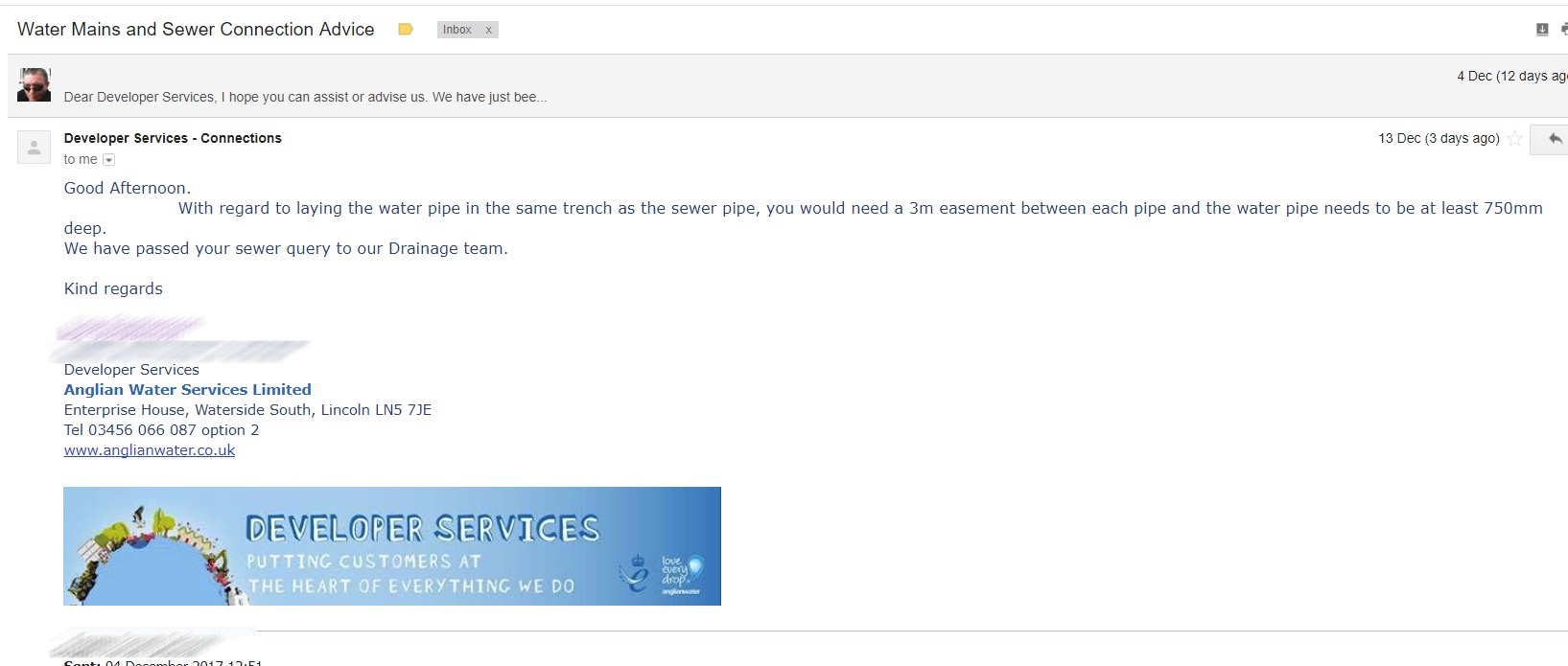

Ed_MK Posted December 14, 2017 Author Share Posted December 14, 2017 Hi All. an update to this ....now we have our planning and we are finalising things for the conditions and Building Regulations. I have been advised that we cannot REALISTICALLY run all the services in the one trench via our parents land. the reason is apparently wastewater must be 3.5m away from any water supply pipes ....and we only have a 2.2m gap at the side of the house to run the trench So we will have to connect it at the front, with the added cost and all the traffic management shennanigans ...sigh. On the original plans we submitted ..it shown the service trench ALL services within.. now of course the fresh water will be going to the front ..will this be an issue for planning ? ..we already have consent on the original submission hmmm Link to comment Share on other sites More sharing options...
PeterW Posted December 14, 2017 Share Posted December 14, 2017 31 minutes ago, Ed_MK said: Reason is apparently wastewater must be 3.5m away from any water supply pipes ... Says who...?? WRAS says 350mm... has someone put a typo in the dimensions ..??!! 1 Link to comment Share on other sites More sharing options...
Jeremy Harris Posted December 14, 2017 Share Posted December 14, 2017 30 minutes ago, Ed_MK said: Hi All. an update to this ....now we have our planning and we are finalising things for the conditions and Building Regulations. I have been advised that we cannot REALISTICALLY run all the services in the one trench via our parents land. the reason is apparently wastewater must be 3.5m away from any water supply pipes ....and we only have a 2.2m gap at the side of the house to run the trench So we will have to connect it at the front, with the added cost and all the traffic management shennanigans ...sigh. On the original plans we submitted ..it shown the service trench ALL services within.. now of course the fresh water will be going to the front ..will this be an issue for planning ? ..we already have consent on the original submission hmmm Who has quoted that a foul drain has to be 3.5m from a water supply pipe? Sounds wrong to me, as if that was the case there are a lot of lanes around here where there wouldn't be any sewers and water pipes. I can't see anything in building regs to support this at all, as @PeterW says, I reckon someone has their units mixed up, and has assumed that 350mm is 350cm............... Link to comment Share on other sites More sharing options...
Ed_MK Posted December 16, 2017 Author Share Posted December 16, 2017 Actually ..I see now it was 3m not 3.5m email below ...unless I am reading it wrong PS ...the names have been obscured to protect the innocent? Link to comment Share on other sites More sharing options...

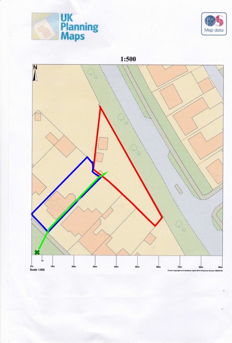

Ed_MK Posted December 16, 2017 Author Share Posted December 16, 2017 I know its hard to get a head around someone else,s layout, but i have produced a drawing (much simplified I must add!) I have tried to add what i think is relevant. I have put the heights of the land in (mm) compared to the datum i sunk at Road Level ...that is the road at MY side, to avoid confusion The nice chap laying my slab tells me that its height when finished will be approximately 250mm above median ground house footprint level (which works out at 230mm+250mm so I have called it 500m to the top of the slab above the datum point. He tells me it is QUITE common to lay the waste UNDER the slab (which is 1m deep) ..so I have marked that as the larger dashed line, I must admit any pipe UNDER something always worries me " The other utilities were planned to go "around" and into the same trench, which as you can see passes in the 2.5m gap between our parents house and the border wall. After all the hullabuloo of putting waste and water in the same trench ...I got quoted a SIMILAR price from Anglian Water to make a connection at the front of our property! ...so this might be the way forward ? As you can see the "run" from our house to through my parents to the services cluster on their rd is quite long ! SO i suppose this will have an effect on mainly the FALL in the sewage pipe If you are reading this for the first time ...you are probably thinking ...WHY THE HELL DOESN'T HE CONNECT ON HIS OWN RD! LOL Well 2 reasons ... 1. The road we have planning for does not have any other houses on that side, the houses on the other side are on "unadopted services" and the closes connection to me (avoiding the land owner over the way) is 150m 2. the second reason is our parents. When they bough the house yonks ago ...ALL the properties were on Cesspits here, but of course 30 years on .. there is now sewers running down the road ..SO as they are getting on a bit (75+)...and if you have ever had to rod a cesspit run when it gets clogged ..you will know there is a good reason to go on mains sewage ....:) So the through was as we were connecting, we could "run theirs through too" ? apologies if the attached drawing is a bit basic and unconventional ...but what are your thoughts ? services_simplified.pdf Link to comment Share on other sites More sharing options...
PeterW Posted December 16, 2017 Share Posted December 16, 2017 3 hours ago, Ed_MK said: Actually ..I see now it was 3m not 3.5m email below ...unless I am reading it wrong PS ...the names have been obscured to protect the innocent? Errr that’s still wrong ...!! It talks about an easement there too - that seems to be a different matter entirely ..! What you may be creating is a lateral sewer if you are connecting your house to your parents and then to the main sewer. This lateral - which only relates to the section from where the second property joins the run and then meets the main sewer - has to be built to a standard that is adoptable. From memory, Anglian water don’t do sewage so the standard would be the Severn Trent one and they have a decent guide for developers on their website. Link to comment Share on other sites More sharing options...
Ian Posted December 16, 2017 Share Posted December 16, 2017 (edited) @Ed_MK (typing this on a small phone screen so apologies in advance) some quick thoughts: 1) I’m guessing that the easement of 3m that Anglian Water mention would normally apply to a public supply - your pipe will be private so not subject to the same legal access requirements. You would normally lay the pipe to your boundary and they make the final connection. Having said all that it sounds like you now have the option of getting your water from the road on the opposite side which would be a good idea. 2) Foul sewer. You will need to find out the invert depth of the public sewer pipe at the point where you want to connect. This will be marked on a public record drawing that you should be able to access by making enquiries. You would normally be connecting to the nearest manhole located in the road next to your parents house. Once you have the invert level of that connection point you’ll be able to work out if you can get a normal gravity connection to it or whether you will need to have a pump. Foul pipes are normally 100mm diameter and fall at a gradient of about 1:40 so for a 50m run you will be dropping 1250mm just to get the fall you need on the pipe. Realistically therefore you will need the invert of the adopted sewer at the manhole in the road to be about 2M (or lower) below the level of your floor slab. Edited December 16, 2017 by Ian Link to comment Share on other sites More sharing options...
Jeremy Harris Posted December 16, 2017 Share Posted December 16, 2017 I think @Ian has nailed it, the water company are quoting the public side rules, not those on the private side. Our foul drain crossed over a water supply pipe in the lane for example, and is only 350mm away from it, as there was no other solution, Similarly, further up the lane the water main and foul drain run side by side in the same trench. They are over 750mm deep and separated, one one side of the trench, the other the other side of the trench, but that's all. The 3m easement is an access rule I believe, it just means that on a public pipe they need a 3m wide strip available above the pipes in order to access them when required (basically it's the width needed to get a digger over the pipe, with room to manoeuvre). Link to comment Share on other sites More sharing options...

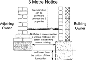

Ian Posted December 16, 2017 Share Posted December 16, 2017 @Ed_MK also, as your new sewer pipes will be very close to your neighbours boundary and may be deeper than their house foundations you will need a Party Wall agreement with them in place before you start digging https://www.gov.uk/party-walls-building-works Link to comment Share on other sites More sharing options...
