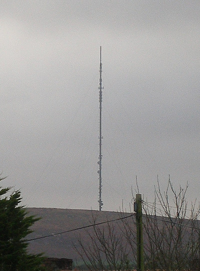

SteamyTea Posted August 8, 2023 Share Posted August 8, 2023 9 minutes ago, Big Jimbo said: Chesham town centre, Bucks Move her to Amersham Old Town, the butler can hand deliver the TV signal. This is an aerial, can see it from Bodmin, and Penzance, and Helston, and bits of Falmouth and Truro. Luckily not St Awful, it is to discourage theft of TVs there. 1 Link to comment Share on other sites More sharing options...
