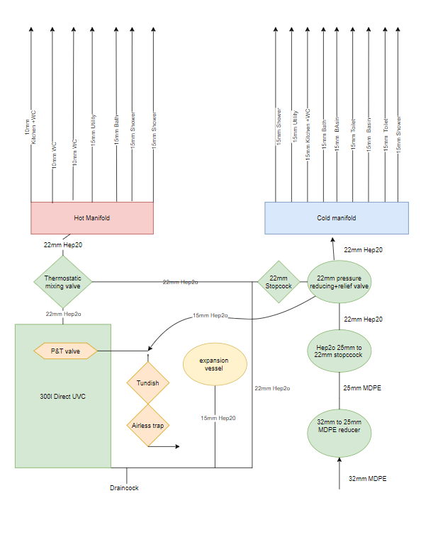

Iceverge Posted August 3, 2023 Posted August 3, 2023 Here's what I did. 25mm MDPE to the stopcock 22mm Hep to the control block and teed out to a cold water manifold. Hep push fit manifold. 15mm for all cold requirements in a radial fashion. Pipe is cheap, joints are dear. 22mm to a shutoff valve (to isolate the cold side if needed) and then 22mm UVC and then a very short run of 22mm to a hot water manifold that is vertically above the UVC allowing it to preheat via convention. 10mm Hep to the basins and the kitchen tap as it's too far away. 15mm to everything else. No joints in the pipes other than at the start and the end. I wish we had put a wetroom style floor drain in every room with a pipe joint in it. It would have ment that had we any serious leak the house wouldn't flood.

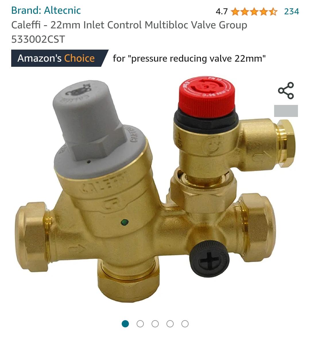

Iceverge Posted August 5, 2023 Posted August 5, 2023 33 minutes ago, markharro said: MDPE brings the water into the house to the main stopcock? Yes. 33 minutes ago, markharro said: whats a "control block"? Maybe the right name is something else. 33 minutes ago, markharro said: radial" - does that mean separate pipes to each location needing a cold supply? Yes like a spider with a pipe for each outlet. 33 minutes ago, markharro said: How does a "standard" circuit compare - does that have one main pipe in a circuit with Ts off to each room? It's like the branches of a tree where a big pipe splits off into smaller ones to feed outlets. You end up with lots of joints but less pipes. Unfortunately this means you have lots of joints hidden and inaccessible. You also have large deadlegs and can have flow rate issues as lots of outlets are fed from the same pipe. 33 minutes ago, markharro said: UVC UnVented Cylinder. 33 minutes ago, markharro said: So 10mm pipe only for hot water supplied to far off locations - is the logic that this gets the water there fast and minimises wasted heat loss from a smaller volume in the pipe? All basins. I did it for the kitchen tap too as it was a 13m run. It did limit the hot water to 6l/min though rather than 10l/min with a 15mm to have a quicker delivery of hot water. 33 minutes ago, markharro said: So 15mm would be the norm for shorter hot water feeds? Is that enough throughput for showers Loads yes.
Iceverge Posted August 5, 2023 Posted August 5, 2023 19 minutes ago, JohnMo said: It all becomes very simple, no hidden joints, single run between manifold and each location. Once in the room I split down with tees to bath, shower, sink and toilet. If I was to do it again I would have a rule that no joint should be inaccessible and should any joint fail it could safely drain into a floor drain. In this case Tees in a bathroom with a wetroom floor for instance would be fine. 20 minutes ago, JohnMo said: Our furthest tap is 18m from the cylinder, we have the pump on in the morning and evening, within a second or so, warm water comes out of the tap. Costs almost nothing to run so long as it's only running when you need it on. Had we been a bit more savvy with the UVC location we could have had a 4m run to the kitchen tap and less than 6m to the basins. No circulation loop needed or long runs. Hot dead legs to the showers and baths make no difference with such large flow rates and longer run times.

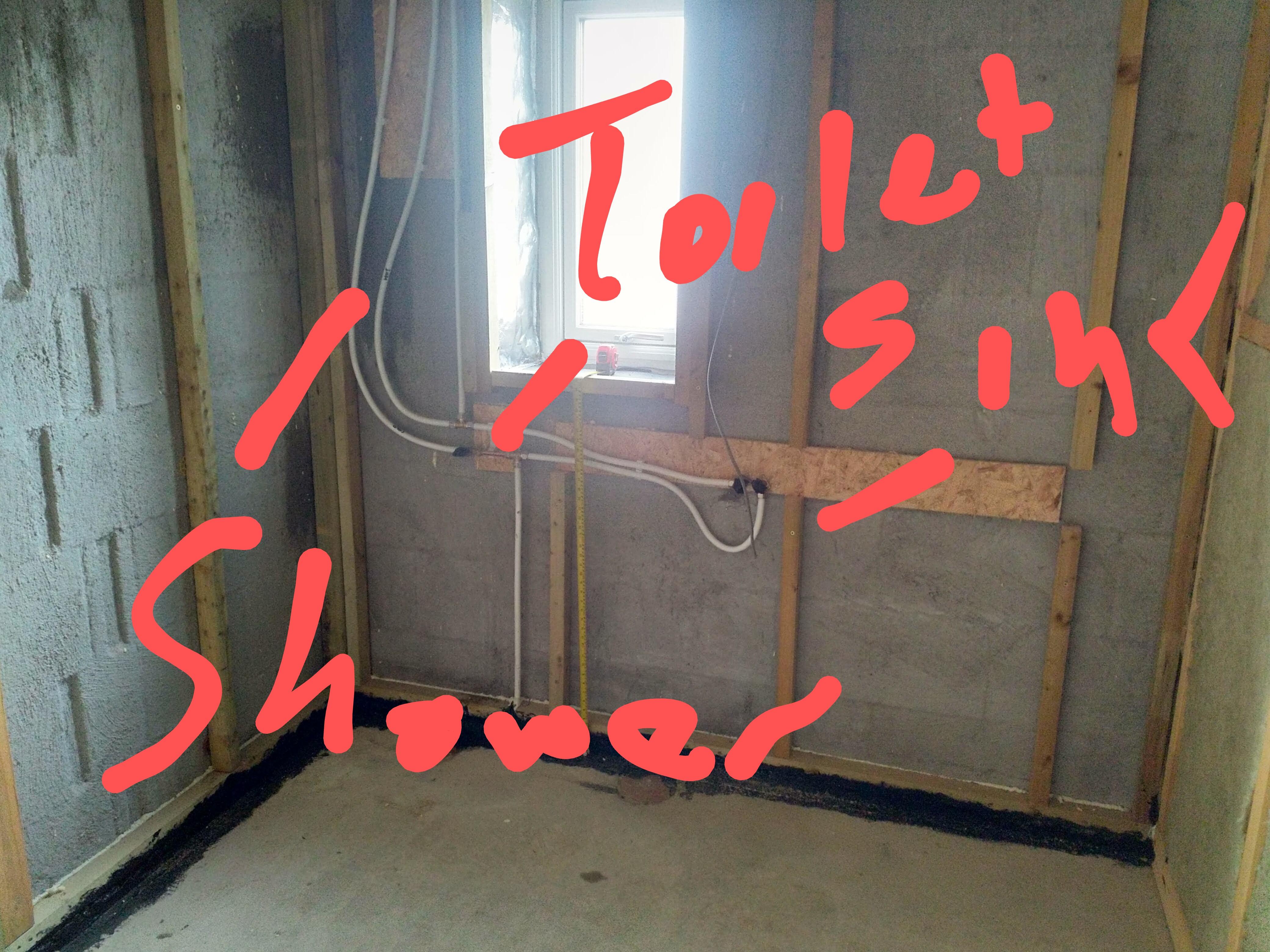

JohnMo Posted August 5, 2023 Posted August 5, 2023 56 minutes ago, markharro said: shower/bath how would you run 10mm to basin on this radial solution? 15mm to the room then split with 10mm to basin and 15mm to shower/bath? Or do you have 2 radial feeds to the single room - 1 at 10mm for the basin and the other 15mm for shower/bath? I kept it simple just 15mm everywhere. Image of shower room, no bath in this room. Hot water pipes come from cieling cold out of floor. Two curved vertical pipes are to shower. 1

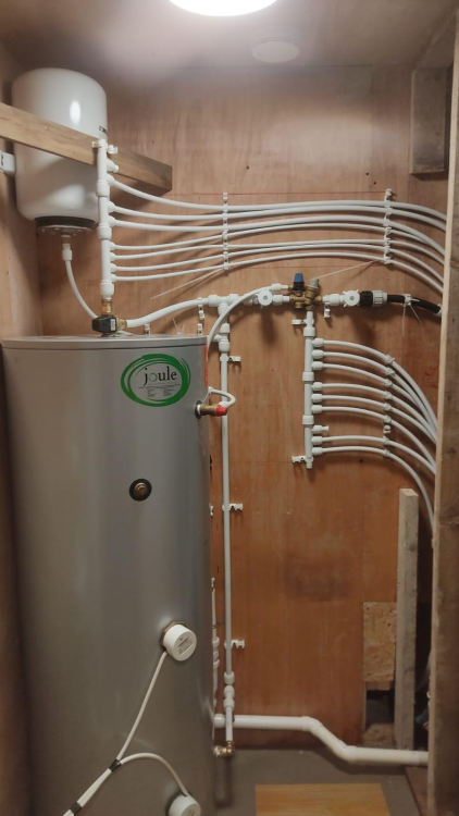

JohnMo Posted August 5, 2023 Posted August 5, 2023 Manifold looks like this, main stop cock at lower right corner, to the left is the pipe and isolator outside tap, bigger white pipe takes water up to plant room 1

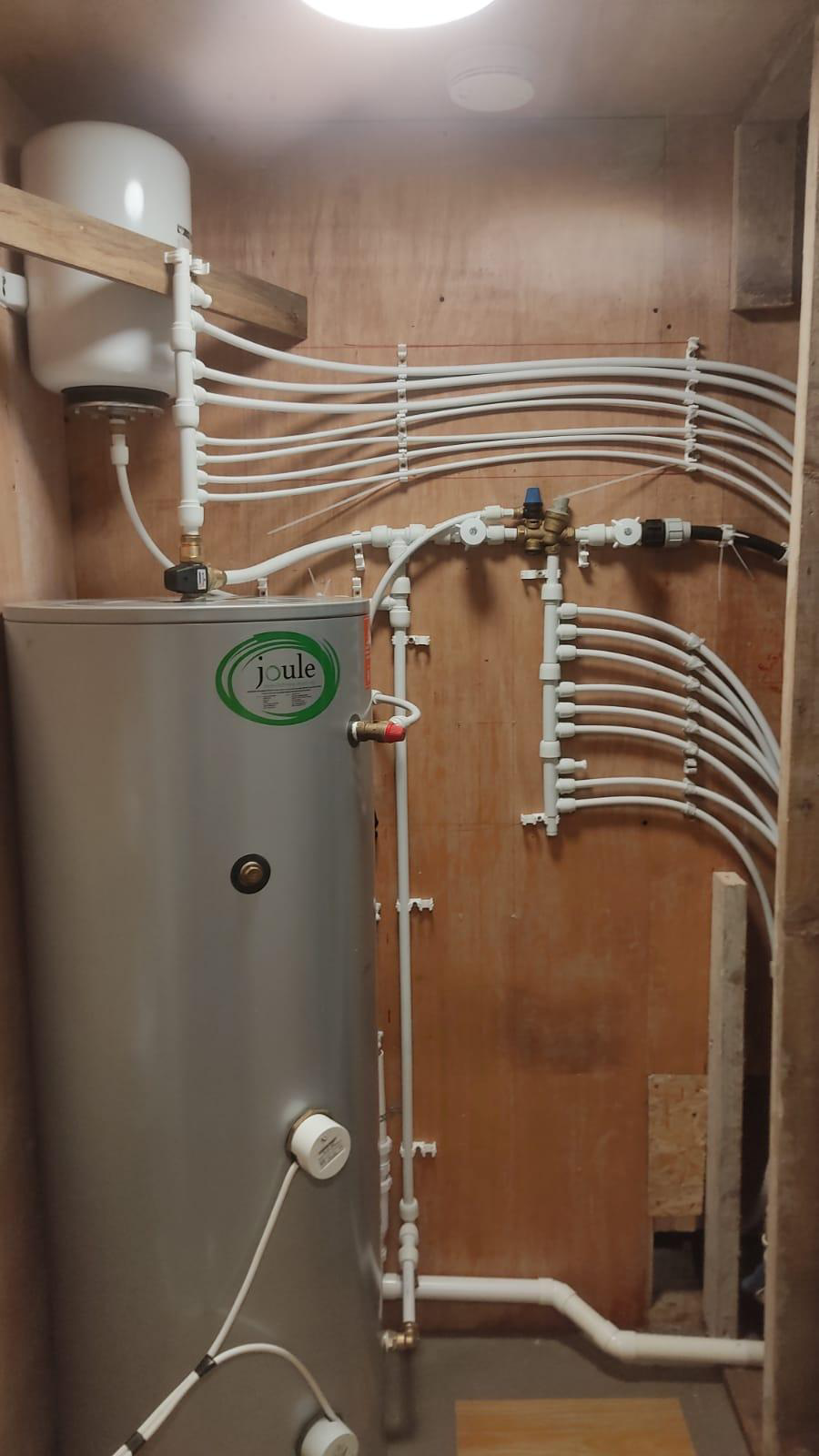

Iceverge Posted August 5, 2023 Posted August 5, 2023 Here's a diagram of mine.. And a Pic. Things I would change..... On @Nickfromwales advice avoid compression fixings of Hep2o pipes although I've had no issues yet. The Multiblock heats via convention from the thermostatic control valve (screwed directly onto the top of the tank) as it is higher than the top of the tank. This should be lower. Note the hot manifold and the 10mm pipes with the first draw off. It is preheated via convection and there's super speedy hot water to the basin taps. I only insulated the hot manifold as the Hep pipes contain almost no water and it cools instantly once switched off in any case with or without insulation. I should have tanked the floor and put in a floor drain too. I could have ran 10mm cold to the W/C cisterns and the basin taps too but fittings and manifolds were cheaper for the 15mm. 3
