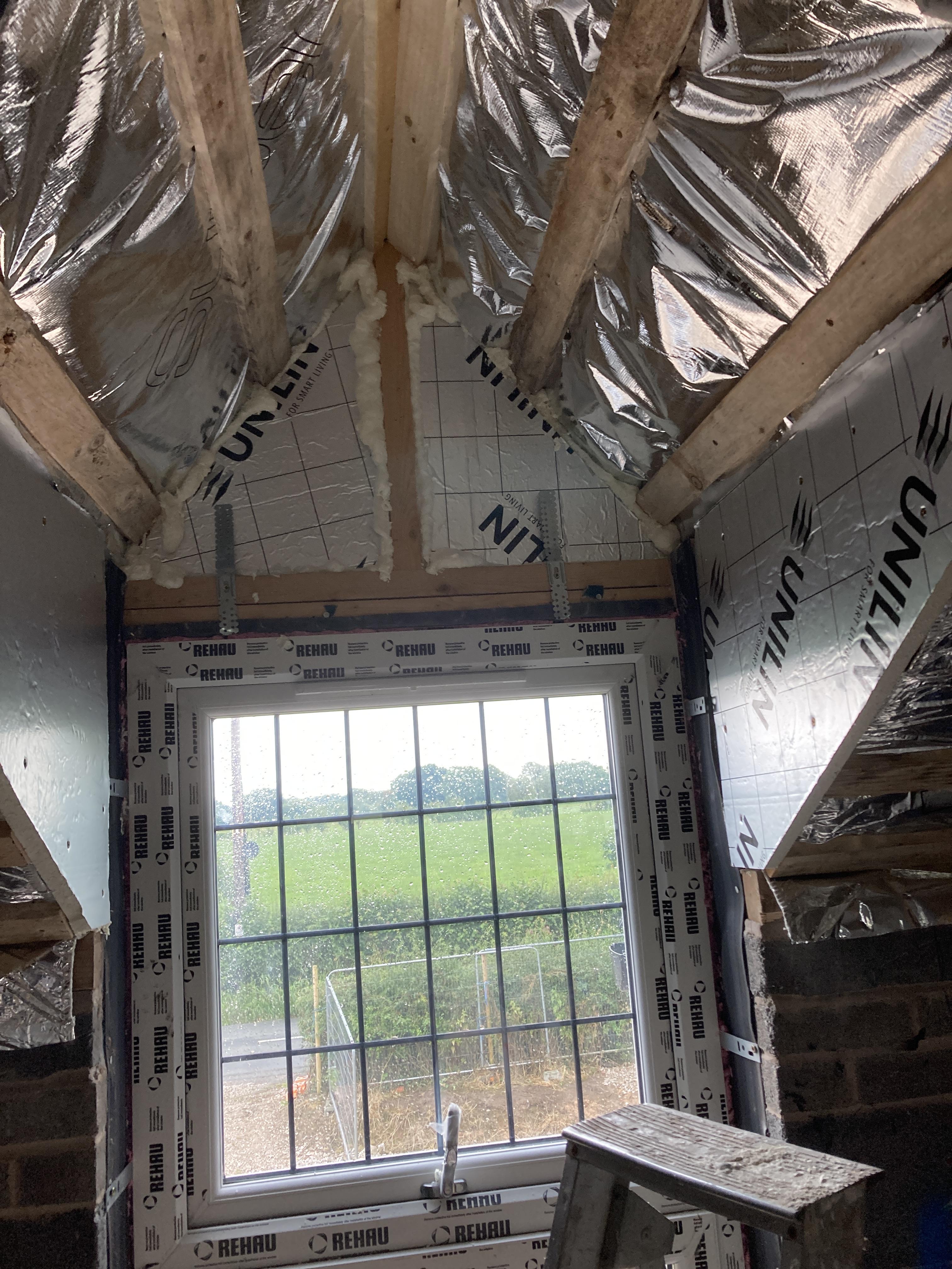

Maria Posted July 22, 2023 Posted July 22, 2023 Hello all, I have completed my self build, and paid the builders 100% for the works. The building control wouldn't issue the completion certificate without SAP and air pressure test. I got a call yesterday from the SAP assessor saying the the building failed to achieve the required min. He said I was ~16% under with the insulation and ~3% under carbon emissions. He hasn't issued yet the official report. He asked me if I wanted him to issue a report. Now thinking about it - do reports get logged in the official register somewhere? Does it make any difference if I have a report or not at this stage? Then he assessor said that my options are either to replace double glazing with triple and put 3kwh PV or put extra insulation in the dormer and 1kwh PV. The house is completely decorated painted and the flooring put in. I have no money left at all, and ended up borrowing more just to get to this stage. I didn't have SAP as designed. Nobody asked about it, and I didn't know. So I am annoyed that the builders proceeded to build without ever questioning anything, and the BC never flagged it up. I am not a professional developer, so feel that people who get paid to build and inspect have failed me. I probably wouldn't get anywhere by trying to hold the builders and building control responsible. But would you say I should try to? Any ideas how to get a pass on a budget? Any tips and assistance would be really appreciated. Many thanks

Alan Ambrose Posted July 22, 2023 Posted July 22, 2023 (edited) Are there any ‘assumed’ values in the current calc - they will generally assume ‘conservatively’ i.e. not to your gain. On a similar note I would double check all their input data. Stuff as simple as GIA can be substantially out. SAP calcs are fairly cheap and therefore often it’s a fairly careless procedure. Edited July 22, 2023 by Alan Ambrose 1 1
ProDave Posted July 22, 2023 Posted July 22, 2023 6 hours ago, Maria said: Hello all, I have completed my self build, and paid the builders 100% for the works. The building control wouldn't issue the completion certificate without SAP and air pressure test. I got a call yesterday from the SAP assessor saying the the building failed to achieve the required min. He said I was ~16% under with the insulation and ~3% under carbon emissions. He hasn't issued yet the official report. He asked me if I wanted him to issue a report. Now thinking about it - do reports get logged in the official register somewhere? Does it make any difference if I have a report or not at this stage? Then he assessor said that my options are either to replace double glazing with triple and put 3kwh PV or put extra insulation in the dormer and 1kwh PV. The house is completely decorated painted and the flooring put in. I have no money left at all, and ended up borrowing more just to get to this stage. Fit 4kW PV on roof. Least intrusive addition and it should get you "over the line" Not only that, it will reduce your electricity bills for the foreseeable future. DON'T go anywhere near an MCS supplier for the PV. You just need a roofer to fit the brackets and an electrician to fit the panels and connect it. I fitted my own for under £2K in parts cost. It is a great shame you did not ask the forum at design stage, we could have given lots of suggestions for how to build a good house. Sadly it looks as though you will have ended up with something akin to a mass produced developer house, the very minimum insulation and air tightness they can get away with and slap on just enough solar PV to scrape through. such a house will have higher ongoing heating costs but the developer does not care because 99% of buyers don't care or don't know. If you are self building you have a chance at the start to do it properly and get something better. 1 1

Maria Posted July 22, 2023 Author Posted July 22, 2023 (edited) 1 hour ago, ProDave said: Fit 4kW PV on roof. Least intrusive addition and it should get you "over the line" Not only that, it will reduce your electricity bills for the foreseeable future. DON'T go anywhere near an MCS supplier for the PV. You just need a roofer to fit the brackets and an electrician to fit the panels and connect it. I fitted my own for under £2K in parts cost. It is a great shame you did not ask the forum at design stage, we could have given lots of suggestions for how to build a good house. I, obviously, don't know much about insulation, but what's been installed didn't seem too bad. I double checked with the builder, and he provided the following; 1.Walls - 6” timber frame inner leaf with 140 mm timber frame cavity bats insulation, 4” blockwork external leaf with 2 coat sand and cement render, internally vapour barrier and skimmed plasterboard finish. 2. Floor – block and beam flooring covered with 1200 gauge radon barrier, topped with 100mm celotex and 22mm moisture resistant flooring. 3. Roof - 200mm deep factory made Truss system topped with breathable felt, batten and slate, internally 150mm celotex insulation between the rafters allowing for 50mm airflow between the insulation and the felt, 50mm insulation backed plasterboard to the underside of the rafters with skim finish. Would you expect to see a lot more than this? Edited July 22, 2023 by Maria

saveasteading Posted July 22, 2023 Posted July 22, 2023 14 minutes ago, Maria said: Will crack on with taping And before the air test, close off fan extracts (polythene and masking tape), and close any other vents and gaps. And be there during the test. The tester is likely to ask what number your are hoping for, so may be more helpful if it doesn't quite get there. 10 hours ago, Maria said: to replace double glazing with triple No that sounds like a bad idea. 10 hours ago, Maria said: feel that people who get paid to build and inspect have failed me Sorry you feel like that, but that doesn't help and probably isn't so. Nobody had overall responsibility but you, so best just get this sorted now. There is lots of knowledge here so keep asking. Have you any more info on the input numbers? The advice above is good. Your house is probably much better than many mass development units, but they know the tricks and have influence. There are lots of tick boxes in the sap assessment where one conservative assumption makes a big difference. I think my next move would be to chat to the assessor again. The windows are not going o be changed. What can be done free or more cost effectively? are there any assumptions you have had to make that could be looked at again? What Air change target am I after? Everyone, does anyone happen to know?. The suggestion by @ProDave is especially good if this can be fitted later...perhaps very much later. 1
Maria Posted July 23, 2023 Author Posted July 23, 2023 8 hours ago, saveasteading said: And be there during the test. The tester is likely to ask what number your are hoping for, so may be more helpful if it doesn't quite get there. Have you any more info on the input numbers? There are lots of tick boxes in the sap assessment where one conservative assumption makes a big difference. What Air change target am I after? Everyone, does anyone happen to know?. The suggestion by @ProDave is especially good if this can be fitted later...perhaps very much later. And what number should I try to achieve? Or is this what I should ask the SAP assessor? Is air change target the same as air pressure test results? Do you mean advice about the PV? To be honest, that's one modification I am quite accepting of. At the end of the day, it will only help to make the place more energy efficient and is least evasive.
