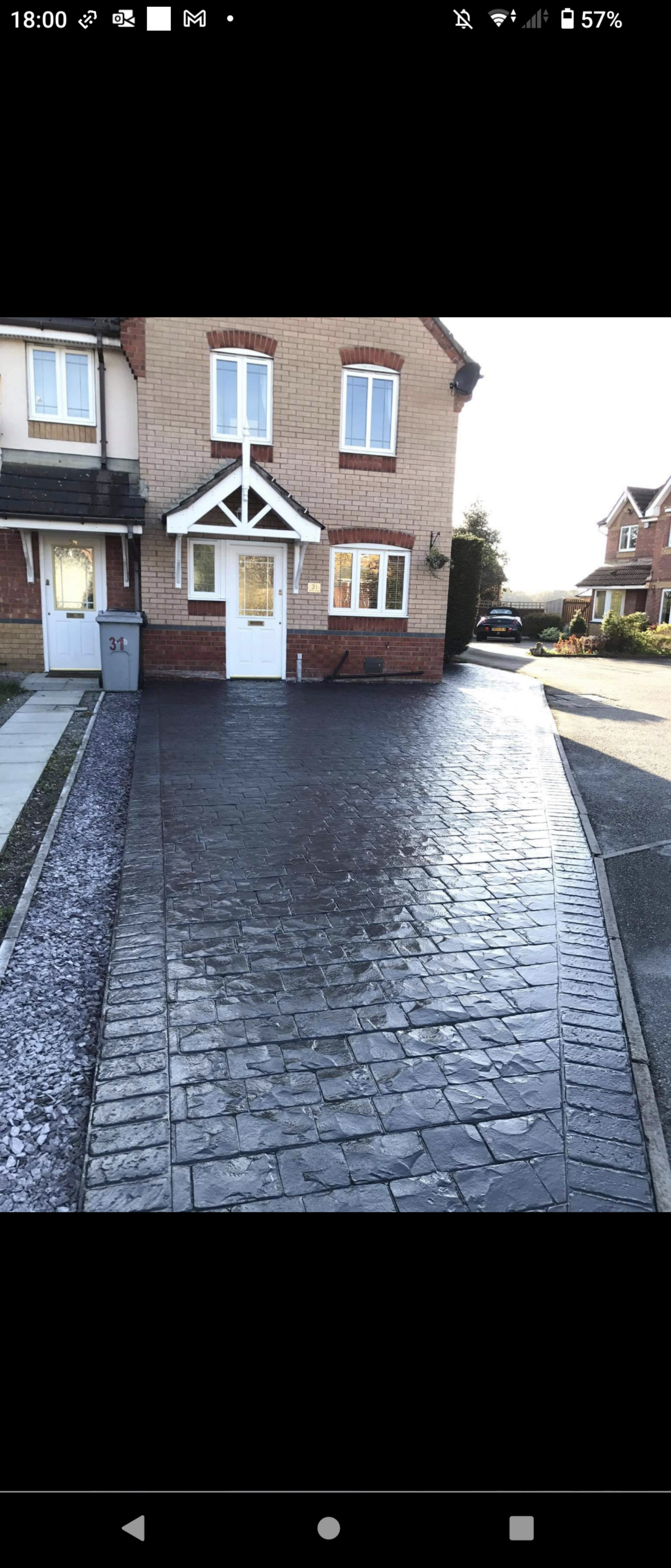

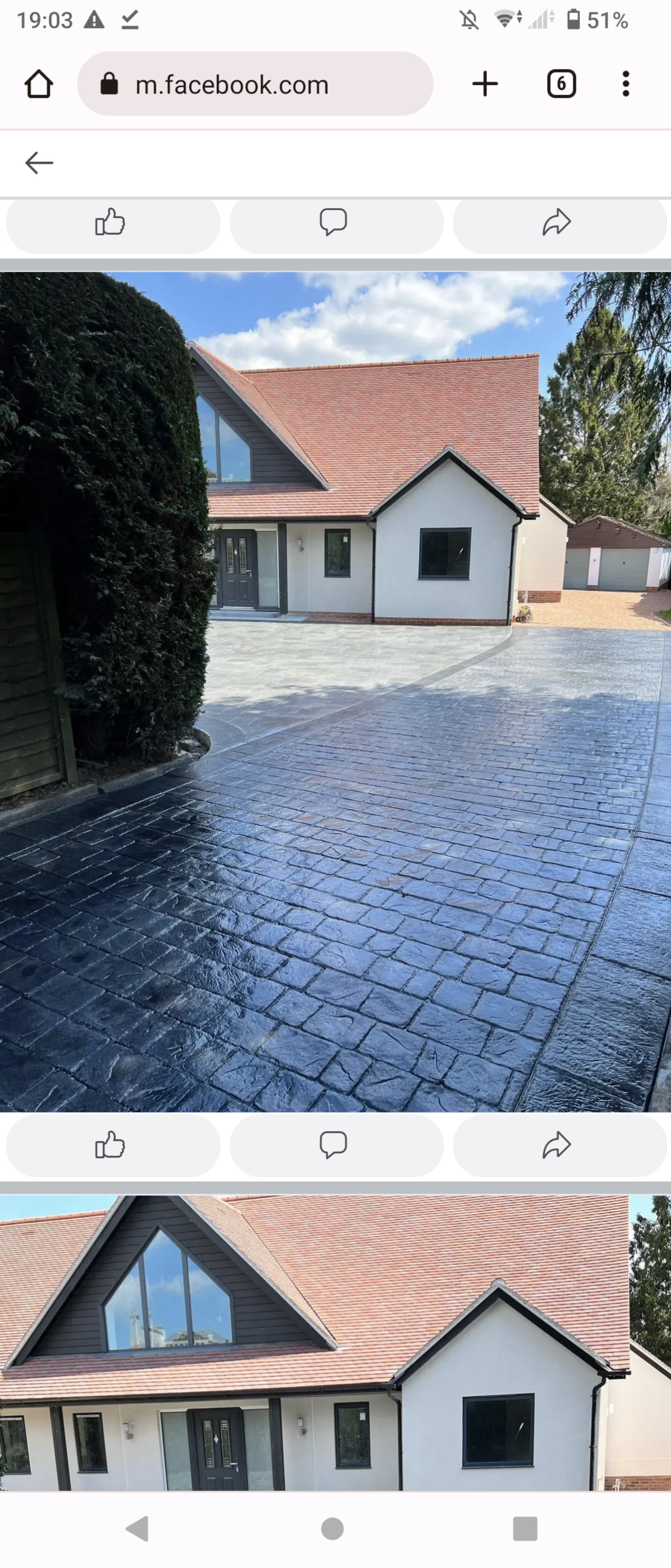

canalsiderenovation Posted July 18, 2023 Posted July 18, 2023 (edited) We are seriously considering imprinted concrete for our drive. The company is very reputable and we know someone who had them do theirs 15 years ago and it's still going strong. We have viewed some work and it certainly looks impressive. We have asked about cracks, thickness sealing etc and have been reassured that fibre mesh is used to reduce likelihood of craking and thickness would be 125mm. We also asked about it being slippy and he said he would add crushed glass to sealant (or something like this). We have a large area (probably close to 300m2) and we are expecting it to be around £27k and that's with three acro drains (we would need these either way with permeable or non permeable surfacing due to the fact we are on a slight slope and we naturally have water that runs from the nearby farm/over canal bridge). We know resin is likely to be more expensive plus edging etc and I think tarmac is going to look like a runway. Having got gravel and some block paving, the block paving is a nightmare with weeding and the gravel just turns to mush and is a nightmare. Anyone have any direct experience of it. Edited July 18, 2023 by canalsiderenovation
joe90 Posted July 18, 2023 Posted July 18, 2023 (edited) Yes, an old neighbour (previous house) had imprinted drive (cobbles) and it looked really good even after about 10 years, my brother in law had it fir around his garden swimming pool (I prepped the shuttering) and he is the most OCD person I know (a nightmare to work for) and he (and I ) were very impressed with the result (and no weeding) 👍 I am seriously considering it for my latest little cottage drive. Edited July 18, 2023 by joe90 1
canalsiderenovation Posted July 18, 2023 Author Posted July 18, 2023 Just now, joe90 said: Yes, an old neighbour (previous house) had imprinted drive (cobbles) and it looked really good even after about 10 years, my brother in law had it fir around his garden swimming pool (I prepped the shuttering) and he is the most OCD person I know (a nightmare to work for) and he (and I ) were very impressed with the result (and no weeding) 👍 Thanks @joe90 that's good to know. The cost is huge but the thought of it being low maintenance is very appealing to us. My Aunt's had it down 15 years and it still looks as good as new. I think a lot depends on getting a good contractor - like anything really.

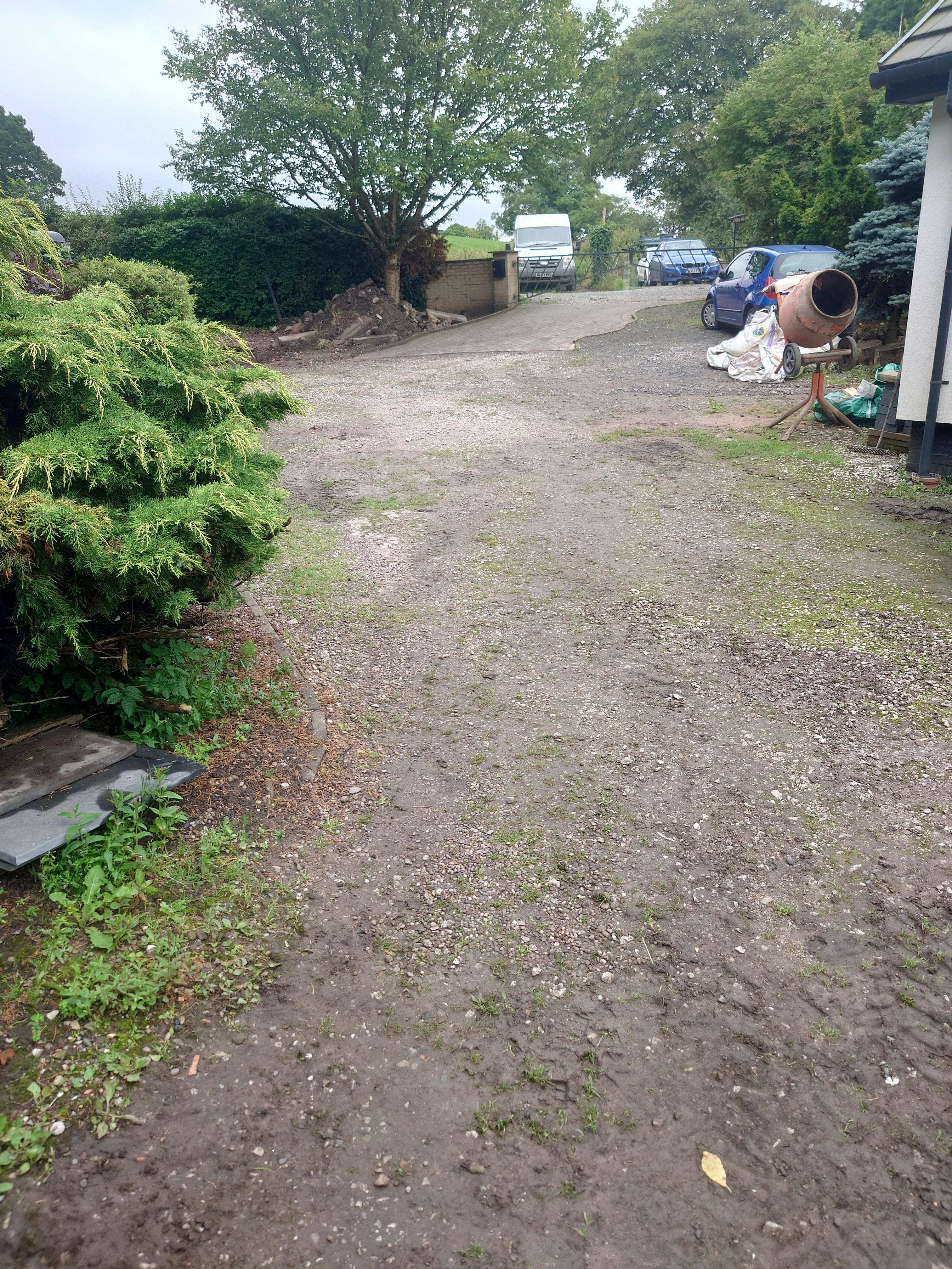

canalsiderenovation Posted July 20, 2023 Author Posted July 20, 2023 We are in the process of of also getting quotes for tarmac and looking at if this can be made 'prettier' and establishing cost, e.g. how it compares to the £28k price of imprinted concrete. I'm worried about concrete cracking. I'm not a fan of tarmac though and really don't think it looks attractive!
SteamyTea Posted July 20, 2023 Posted July 20, 2023 1 hour ago, canalsiderenovation said: £28k price of imprinted concrete Why not have a go yourself. 1
Jilly Posted July 20, 2023 Posted July 20, 2023 (edited) Gravel should be ok if the sub-base is compacted properly and is quite soft in appearance (to me) but I guess not, if you like the clean sterile look. I can think of better ways to spend £27k... Edited July 20, 2023 by Jilly 1

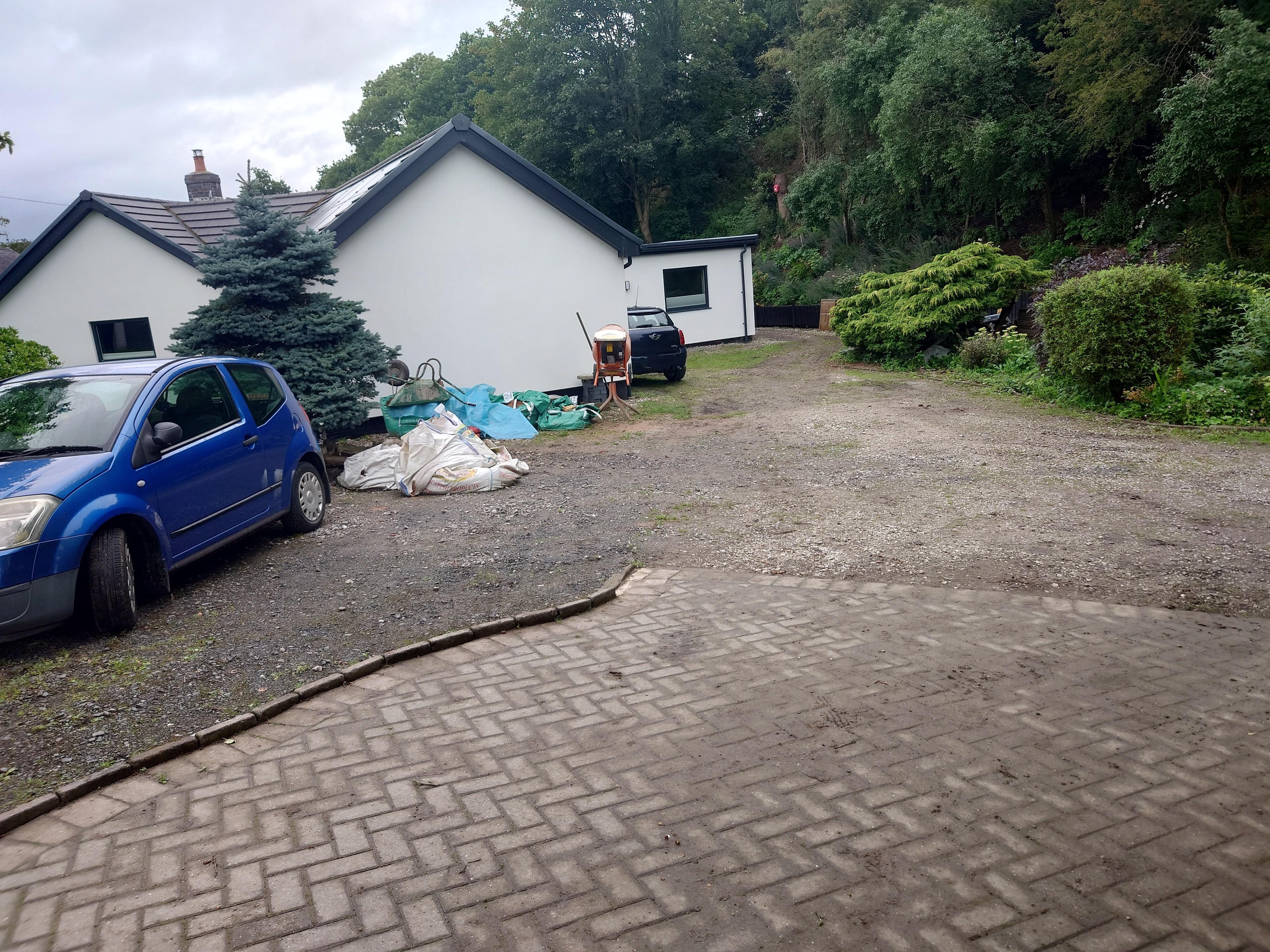

canalsiderenovation Posted July 20, 2023 Author Posted July 20, 2023 10 minutes ago, Jilly said: Gravel should be ok if the sub-base is compacted properly and is quite soft in appearance (to me) but I guess not, if you like the clean sterile look. I can think of better ways to spend £27k... It's a nightmare for us here. It's been a mix of gravel/bit of block paving from the beginning and even with membrane - the weeds, trees (we are surrounded by oak, sycamore and other trees) the wet (we are on a slight slope), it's awful. I just can't justify the cost though. We are getting some quotes for tarmac so we can compare. It's a large area - I'd guess close to 300m2. 1

Adsibob Posted July 31, 2023 Posted July 31, 2023 That sounds very expensive. Do you really need all 300m2 paved? Won’t it look like a car park? How many cars do you have? 12.5m2 is plenty big to park one car. Even a disabled parking bay is only 16m2. Unless you need so many parking spaces, I would consider some soft landscaping to reduce the area you need to pave. Will work out much cheaper and will look much nicer. 1

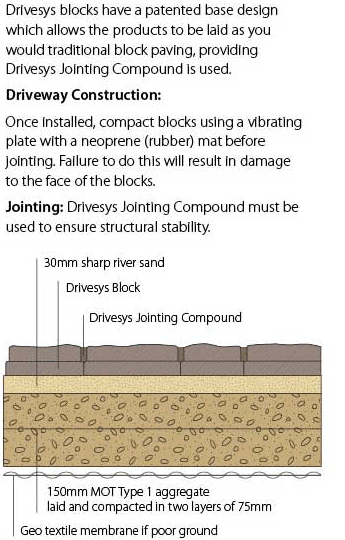

Adsibob Posted July 31, 2023 Posted July 31, 2023 If the only think that is pushing the OP towards imprinted concrete over paved slabs is the weed issue, then I can recommend Marshall's Drivesys cobble system. Each "cobble" is cast from concrete and has a ridge, so that once laid there is a barrier preventing weed growth. The diagram below isn't that clear, but effectively each "cobble" has a 6mm ridge protruding around the perimeter of the bottom half of the cobble, so that when installed adjacent to another cobble, there is a 12mm gap between cobbles (above the ridge). That 12mm gap is then filled with the joining compound to create a barrier. Weeds don't get through. You can get a very nice "cobbled" look, but with the benefits of modern engineering. I think that at most it would work out the same as imprinted concrete, but probably a bit less. 2

Big Jimbo Posted August 1, 2023 Posted August 1, 2023 Blinking heck. I'm dizzy now after trying to watch that. Don't think you are going to become a film maker anytime soon. Were you being chased by One of the chickens. Why not do either an area of slabbing, or block paving near the house, and gravel the rest. That is going to cost you a fortune. 1
