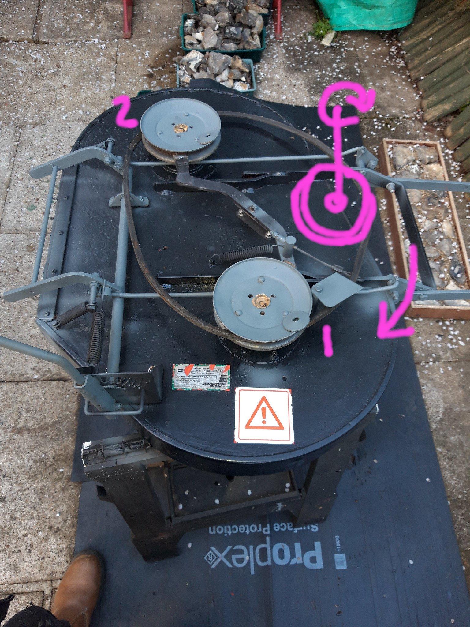

Onoff Posted April 21, 2020 Author Share Posted April 21, 2020 Hmm...deck back on but..... Picture below shows the repaired deck pre refitting. I've added on in pink the drive pulley on the bottom of the engine. The belt runs anti clockwise. The original pullies that turn the blades are shown at 1 & 2. They are stiffer to turn than I'd like. If, with the deck on I engage the cutter the belt jumps and slaps at 1. I think what is happening is that the drive pulley feeds the belt onto 1 which turns relatively freely. When it gets to 2, because that is stiff to turn the belt "backs up". New bearings ordered! Link to comment Share on other sites More sharing options...
Onoff Posted April 21, 2020 Author Share Posted April 21, 2020 Seems I had in wrong in my thought process above! I had it backwards. Belts pull only so all of the slack will be at 1 (which is where a tensioning pulley would be if fitted to take up any slack in the belt). I had to ensure the brake pads weren't engaging with the pullies when the cutter was engaged. They're not If the belt is flapping there badly then I either have a belt that is too long or the engagement needs some adjusting. Belt WAS the right one originally... Tried starting it just now on the pull cord, to video the belt slap it but no dice. Was starting fine yesterday!Anyway, ref the deck/belt. After refitting the deck the belt was smoking like Hell on trying engaging the cutter, blade pullies weren't turning and the belt was "slapping " terribly at 1, marked pink, above.We adjusted at the back here: And it's in these holes at the front, (before it was 1 hole back): After adjusting as above the belt smoking stopped pretty much and the cutting pullies seemed to be trying to turn.Deck fully raised, belt is level: Deck fully down, belt looks at too steep an angle to me: The belt is wearing here: Grateful for any pointers.Cheers Link to comment Share on other sites More sharing options...
PeterW Posted April 21, 2020 Share Posted April 21, 2020 9 minutes ago, Onoff said: Grateful for any pointers. let some air out of the tyres to lower it down... 2 Link to comment Share on other sites More sharing options...

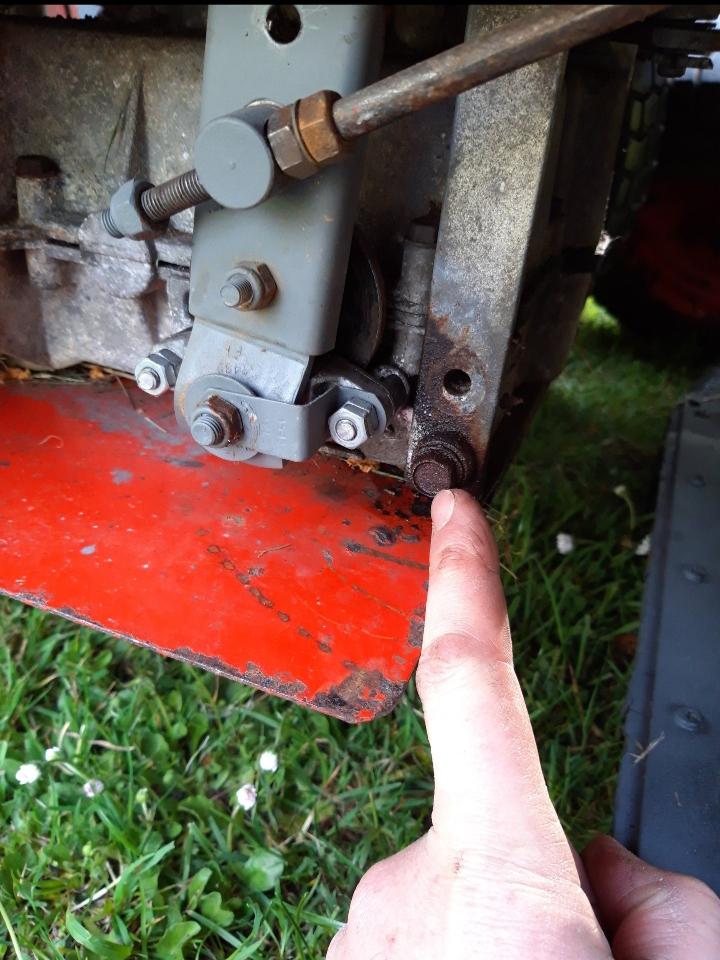

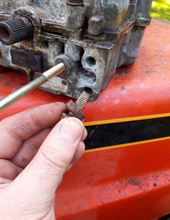

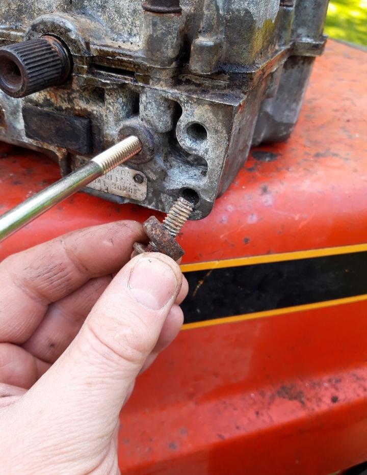

Onoff Posted May 17, 2020 Author Share Posted May 17, 2020 (edited) Well this mower is fighting me all the way! Seems that although the gearboxes are the same basic casting, my original one has tapped fixing holes into the ali gearbox. On the donor, the "new", gearbox these are pilot drilled and not tapped as the gearbox attaches a different way. And to boot they're UNC. This is mine. One bolt came out OK. The remaining one feels like it's going to shear. This is the donor, new box, holes need tapping: So this morning, looking at re tapping the bolts into the gearbox. The removed bolt measures 5/16" outside diameter. Teeth per inch is 18. So from my trusty Zeus book that makes it 5/16" BSW or 5/16-18 UNC. This Peerless gearbox being American I'd go for it being UNC. (BSW have 55deg and UNC 60deg thread angles. In the rough and ready circles it's considered acceptable to interchange bolts as all but the 1/2" size interchange from memory. 1/2" BSW is 12tpi, 1/2" UNC is 13tpi. There's other differences in the thread tips are pointed on one and rounded on the other). I only have taps for UNC but likely to be one bolt down anyway if (when) this next one shears. The holes in the gearbox measures up 9/32" as far as I can tell. So 7.32mm in new money. Recommended tapping hole sizes are 6.4/6.5mm for BSW and 6.5/6.6mm for UNC. I'm guessing these holes have grown a bit through corrosion. I'm tempted to drill out the 7.32mm holes to 8.2mm and re tap at M10 metric coarse. Not sure that tapping M8 will be "grippy" enough in there with what's left after the corrosion that's done it's thing. M8 requires a 6.8mm tapping hole and I'm at 7.32mm. Thinking M10 will be a bit "chunkier". Or I get some UNC bolts... Or I use "whatever" and thread lock... I'd rather avoid helicoils. Any thoughts to push me one way or the other? ? Edited May 17, 2020 by Onoff Link to comment Share on other sites More sharing options...

Onoff Posted May 17, 2020 Author Share Posted May 17, 2020 Old gearbox off but I sheared 3 out of the 4 bolts holding it on. I'll drill out and retap. The same bolt positions on the new gearbox drilled a bit bigger and tapped M10. I had to swap the gear change plates over as different lengths. Next I need to swap the pullies over as mine, the more orange, less rusty one has an extra hole for the pto to drive the grass box flails. Remaining wheel still refusing to budge! Link to comment Share on other sites More sharing options...
