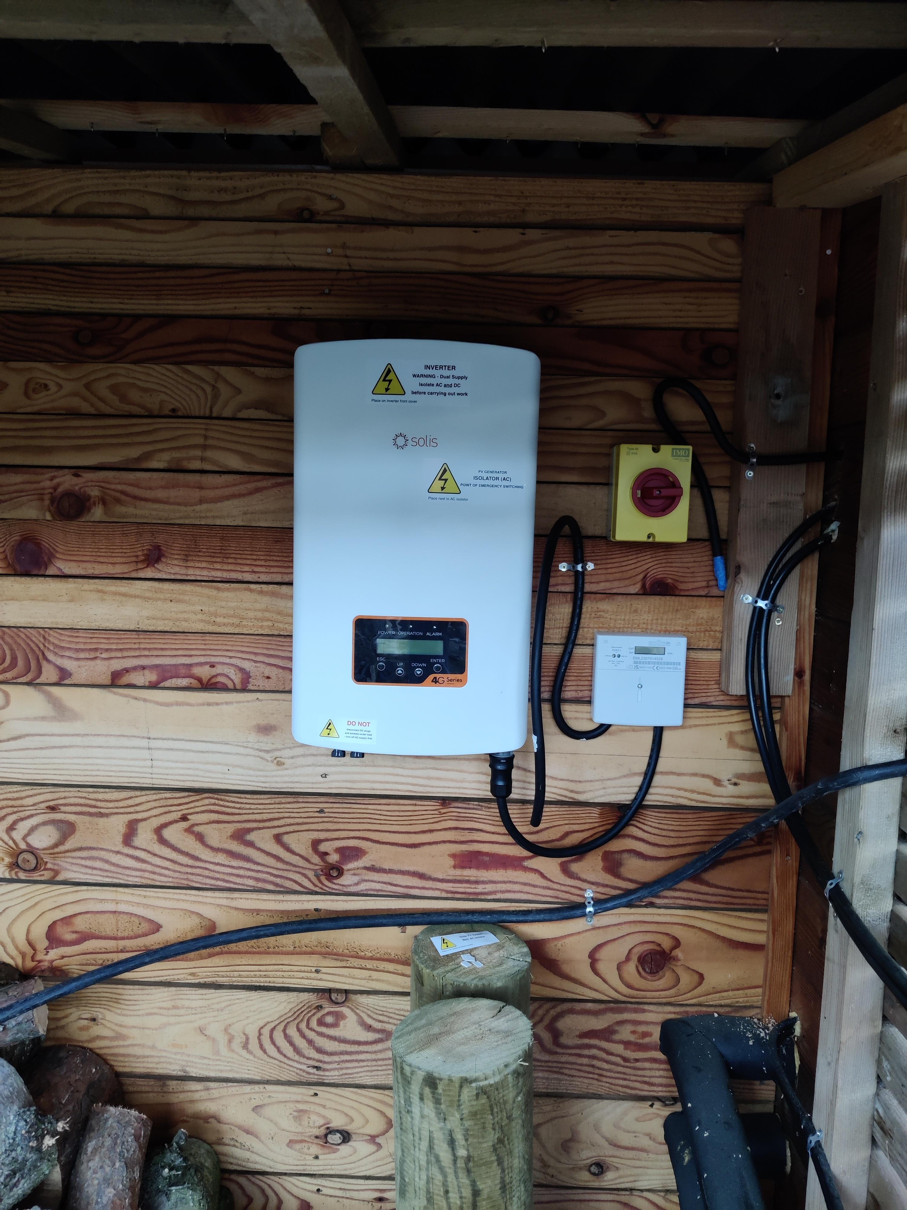

JohnMo Posted July 5, 2023 Author Share Posted July 5, 2023 Many thanks. Photo of the inverter. It is located on the rear wall of what was/is an overflow wood shed. My ASHP is at the front of the shed, the area between the inverter and ASHP remains clear of logs etc. The two pipes on the right are the flow and return to the ASHP, the logs are being used as a make shift work bench. Link to comment Share on other sites More sharing options...
SteamyTea Posted July 5, 2023 Share Posted July 5, 2023 32 minutes ago, JohnMo said: Photo of the inverter. I can't remember if you are going grid tied or off grid with this installation? Does that inverter island? (can't see a model number) Link to comment Share on other sites More sharing options...
JohnMo Posted July 5, 2023 Author Share Posted July 5, 2023 Grid tied - no it doesn't island. Model Solis-1P3.6K-4G. Link to comment Share on other sites More sharing options...
SteamyTea Posted July 5, 2023 Share Posted July 5, 2023 3 minutes ago, JohnMo said: Grid tied - no it doesn't island. Model Solis-1P3.6K-4G. Thanks Link to comment Share on other sites More sharing options...

JohnMo Posted July 6, 2023 Author Share Posted July 6, 2023 Well that's everything up and running, pretty cloudy today, and the sun does come out it's still not completely clear, but at 2pm was generating about 2.7kW. Only thing I had to correct was the meter got wired the wrong way round so it wasn't recording export. 10 mins to sort out. Link to comment Share on other sites More sharing options...

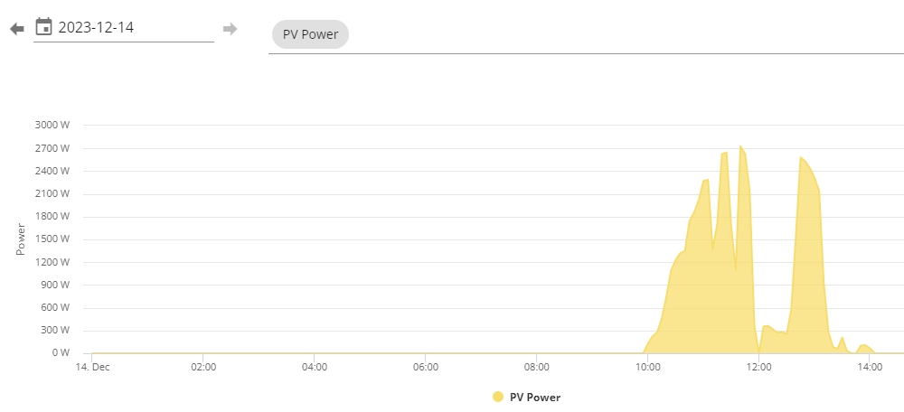

JohnMo Posted December 14, 2023 Author Share Posted December 14, 2023 (edited) So just as an update, no issues experienced so far, even in the high winds we have had. Was comparing the house output and the vertical array today. Both a similar kW rating, house at 45 degrees, this array vertical. Vertical array was generating 1.5kW while house was generating 1kW at the same time, this was at 11am, when sun direction suited the house array (SE) better than the vertical array (SW). So circa 50% (or more) uplift in winter performance. So fulfils the design brief I gave myself, generation between both arrays was 4.5kWh between 10am and 2pm and a sun/cloud day. Attached is a composite of the total output of house and hill top array, from the battery software. Edited December 14, 2023 by JohnMo 1 Link to comment Share on other sites More sharing options...

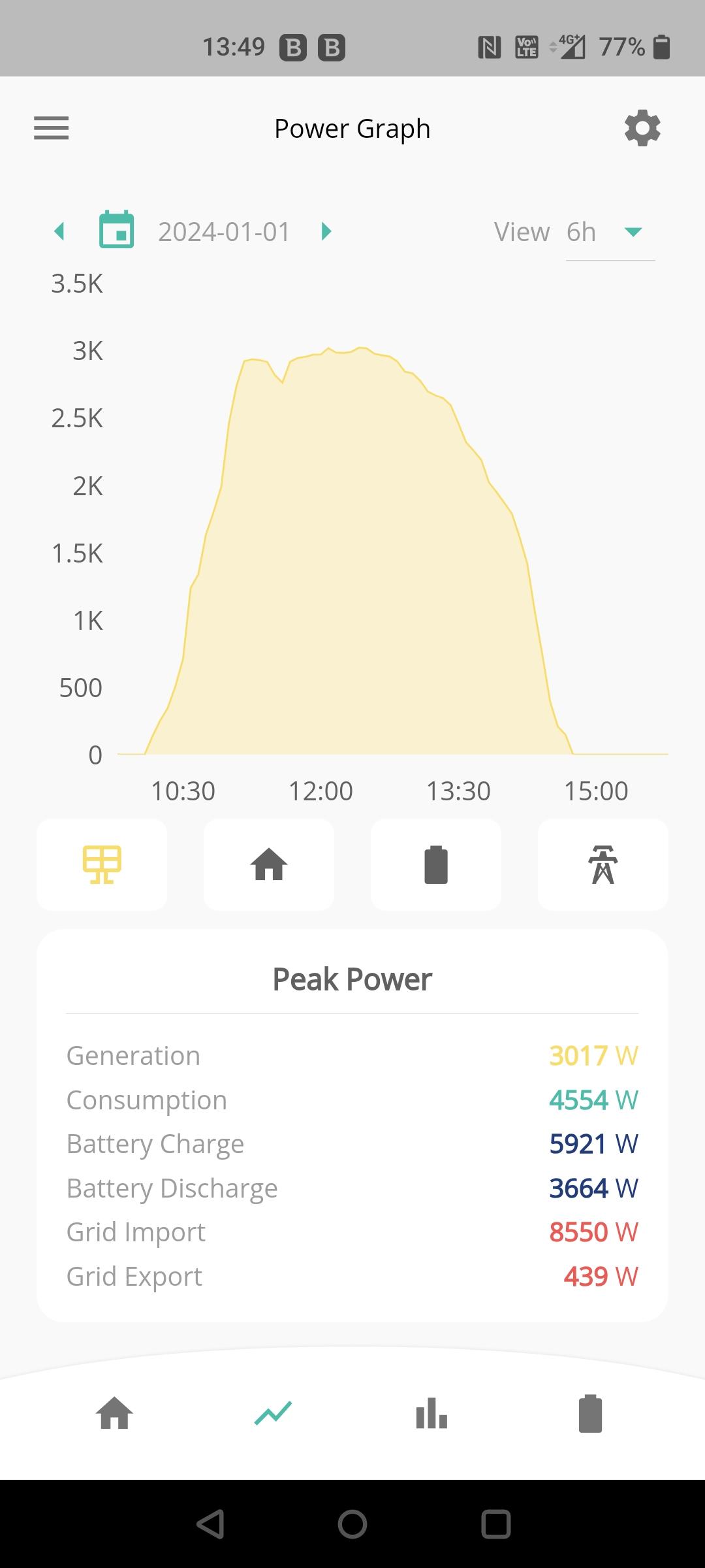

JohnMo Posted January 3 Author Share Posted January 3 Sunny day yesterday, 1/3 of electric came from the 45 deg array, the other 2/3 from the vertical. Link to comment Share on other sites More sharing options...

JohnMo Posted January 3 Author Share Posted January 3 I have a southeast array at 45 deg roof mounted and a vertical array bush split into 2 south east and nearly west. My generation profile looks like this. Late start is due to trees in the way and finish time is sun dropping below horizon (more trees). Not sure the faff of tracking is worth the hassle. In summer you are making loads of energy anyway. So I just optimise for winter. Link to comment Share on other sites More sharing options...
