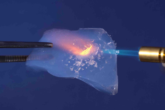

Sophiae Posted June 22, 2023 Share Posted June 22, 2023 Anyone heard of these? Any idea how much they cost? Their environmental impact? How they may affect the residents health long term? please help :0) Link to comment Share on other sites More sharing options...
TonyT Posted June 22, 2023 Share Posted June 22, 2023 It’s the most expensive insulation out there! 1 Link to comment Share on other sites More sharing options...
bmj1 Posted June 22, 2023 Share Posted June 22, 2023 35 minutes ago, Sophiae said: Anyone heard of these? Any idea how much they cost? Their environmental impact? How they may affect the residents health long term? please help :0) Can you provide more information on the problem you are trying to solve? Link to comment Share on other sites More sharing options...
Mike Posted June 22, 2023 Share Posted June 22, 2023 Yes, sometimes used for niche applications such as window reveals, where thickness available is limited. I may well use a small quantity in that application myself in a few months time. Likely to be too expensive to use more generally, unless you are in a high-value city-centre apartment where every mm² has an equally high value. They're non-toxic - at least the normal silica based ones are - but the you don't want to be inhaling the dust while installing it. Link to comment Share on other sites More sharing options...
Temp Posted June 22, 2023 Share Posted June 22, 2023 Some aerogel blankets have a thermal conductivity that isn't much better than PIR. For example one make quotes 0.024 W/mK which is the same as PIR. Link to comment Share on other sites More sharing options...

bmj1 Posted June 23, 2023 Share Posted June 23, 2023 6 hours ago, Temp said: Some aerogel blankets have a thermal conductivity that isn't much better than PIR. For example one make quotes 0.024 W/mK which is the same as PIR. Exactly. The other key point of aerogel is that it is vapour permeable, making it suitable for retrofit in older buildings. Having looked at aerogel for wall looking, we're now making use of an insulated plasterboard with just 17mm of PIR bonded to 9.5mm of plasterboard. 1 Link to comment Share on other sites More sharing options...
SteamyTea Posted June 23, 2023 Share Posted June 23, 2023 (edited) 8 hours ago, Mike said: They're non-toxic - at least the normal silica based ones are - but the you don't want to be inhaling the dust while installing it. Yes. It is the particles that are the problem, though at the nano metre scale, odd physics occurs between other chemicals. We used an aerogel based filler, which is similar to that used in the blanket type insulation (which I think is what @DamonHD had fitted), physically the properties are different to the solid form of aerogel, which is the one with the fantastic thermal properties. This Is not this Edited June 23, 2023 by SteamyTea 1 Link to comment Share on other sites More sharing options...

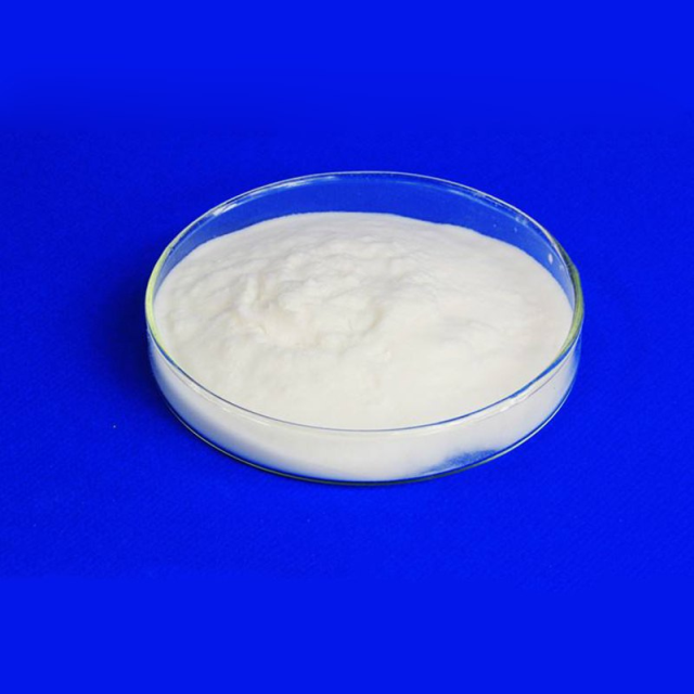

Sophiae Posted June 25, 2023 Author Share Posted June 25, 2023 5 hours ago, SteamyTea said: At 10mm thickness, it has a U-Value of 0.32 W.m-2.K-1 You can buy a bag of Aerosil and make your own. https://www.silmid.com/specialties/fillers-thickeners/Aerosil-300-Hydrophilic-Fumed-Silica-Flour-10Kg-Bag/ So in all true facts we need to at least triple that to get the desired U-value? Link to comment Share on other sites More sharing options...
Sophiae Posted June 25, 2023 Author Share Posted June 25, 2023 31 minutes ago, Temp said: Very approximately... The thermal conductivity of a material is the U-Value of a 1 meter thick layer of the insulation. So you can work out the U-Value of any thickness using.. U Value = Thermal Conductivity * 1000 / Thickness (in mm) Manufactures data sheets give more accurate data because they take into account surface effects such as that due to foil covering on PIR. In some cases manufacturers include the effect of air gaps one or both sides specified in the installation instructions I was hoping for a simpler reply as it’s a bit too technical for me, but I will dig deeper. 1 Link to comment Share on other sites More sharing options...
Sophiae Posted June 25, 2023 Author Share Posted June 25, 2023 5 hours ago, SteamyTea said: At 10mm thickness, it has a U-Value of 0.32 W.m-2.K-1 You can buy a bag of Aerosil and make your own. https://www.silmid.com/specialties/fillers-thickeners/Aerosil-300-Hydrophilic-Fumed-Silica-Flour-10Kg-Bag/ Can I just mix this with the intended building render cover? Link to comment Share on other sites More sharing options...
SteamyTea Posted June 25, 2023 Share Posted June 25, 2023 26 minutes ago, Sophiae said: So in all true facts we need to at least triple that to get the desired U-value? Depends what you are trying to achieve. You can vary U-Values a bit, as long as the overall value meets building regs. But if you have a specific problem like condensation, then you may need a better value than BR stated. You also have fire ratings to worry about. Steel does not fair well in a fire. 25 minutes ago, Sophiae said: Can I just mix this with the intended building render cover? You can, but it will cost a fortune to get it certified, so not worth doing. It does give an hour indication of how much normal plaster can be ramped up by adding the word 'nano' in the brochures. 1 Link to comment Share on other sites More sharing options...
