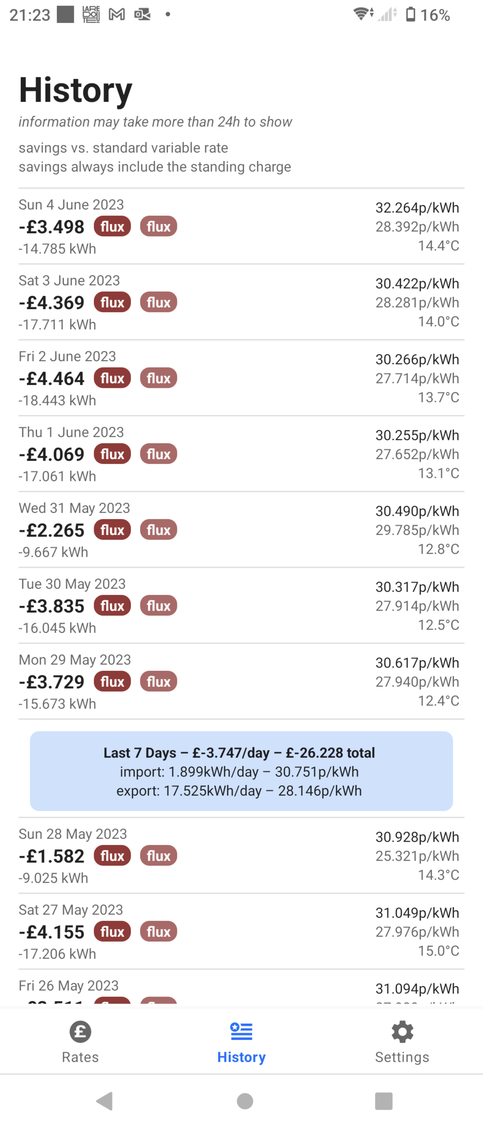

Pocster Posted June 13, 2023 Share Posted June 13, 2023 Yes - you all weep at MY cheap lecky . I can pick and choose a tariff that rather than ‘saves’ me money as conventionally ; I choose the one that makes me money . An electric whore if you will . Highest bidder gets my goods . Link to comment Share on other sites More sharing options...
canalsiderenovation Posted June 13, 2023 Author Share Posted June 13, 2023 2 hours ago, SteamyTea said: You still are. But we are currently installing new capacity, on long term contracts, at £40/MWh. So once the general public realize that, we could be into a couple of decades of fixed price power again. Will take another decade to get there. Even when we had the 'cheap' energy over the last 20 years, people still think they were robbed. (expletive deleted) them I say, let them get cut off or pay their share of the price. Batteries at home are not going to reduce anyone's outgoings. @canalsiderenovation Have you thought, as an experiment, making your boat all electric and truly off grid? Then plug your house into it. @SteamyTea we just sold the boat at the weekend. Made a bit of profit but this is funding the patio areas, planters, porcelain and double garage - and hopefully we can save up enough to finally get the driveway/landscaping. We absolutely want another boat in the future but at the moment the priority is trying to finally get things finished. We are sick of looking at 20 ton of MoT, mud and mess outside. Link to comment Share on other sites More sharing options...
canalsiderenovation Posted June 13, 2023 Author Share Posted June 13, 2023 3 hours ago, pocster said: Well - this ignores some things . You could end up exporting at 35p a kw - like I do . I estimate I’ll earn £1000 a year from that . Yes we are exporting on Flux at the moment and getting some good returns. 1 Link to comment Share on other sites More sharing options...
