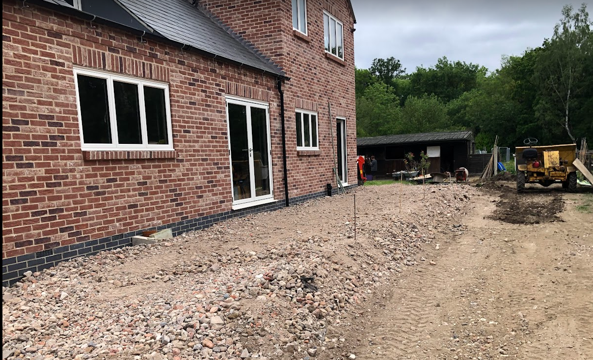

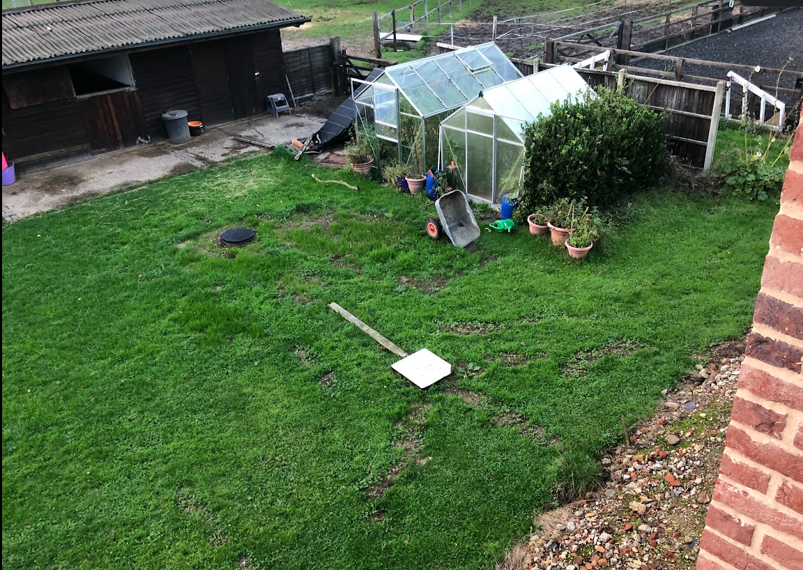

Will be going under the area where the greenhouses are in this pic, using access near the stables.image.thumb.png.19d2a50260ebe194fe1aad3be67d6306.png
Digging primarily will be done from about where my dumper is parked.

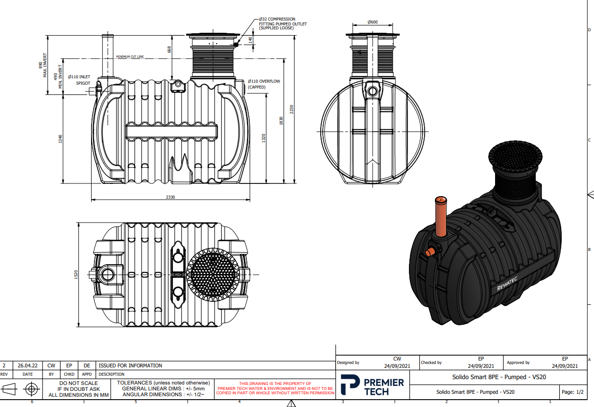

@crispy_wafer what size Solido is it? I've just checked our documentation and the 6-8PE is 150kg, needing a 180cm dig, it's got a lifting eye on top and no concrete required...
best practice is to steadily fill with water as you backfill, to equalise the loading although the moulded tank can take full load either way unsupported
Posted
Its the 8PE pumped version, watercourse is about 50 paces away.
I'll be looking to concrete as clay sublayer @ about 1m causes slow drainage, invert is approx 650mm.  The installation guides don't seem quite clear on whether I could pour mass concrete over the top or not to create a tomb like structure.  I may want to drive over its location occasionally with my small tractor...  Thinking I'll mix the concrete for it to sit on, then have either a readymix or volumetric delivery to fill the rest of the hole.  Best laid plans and all that,
