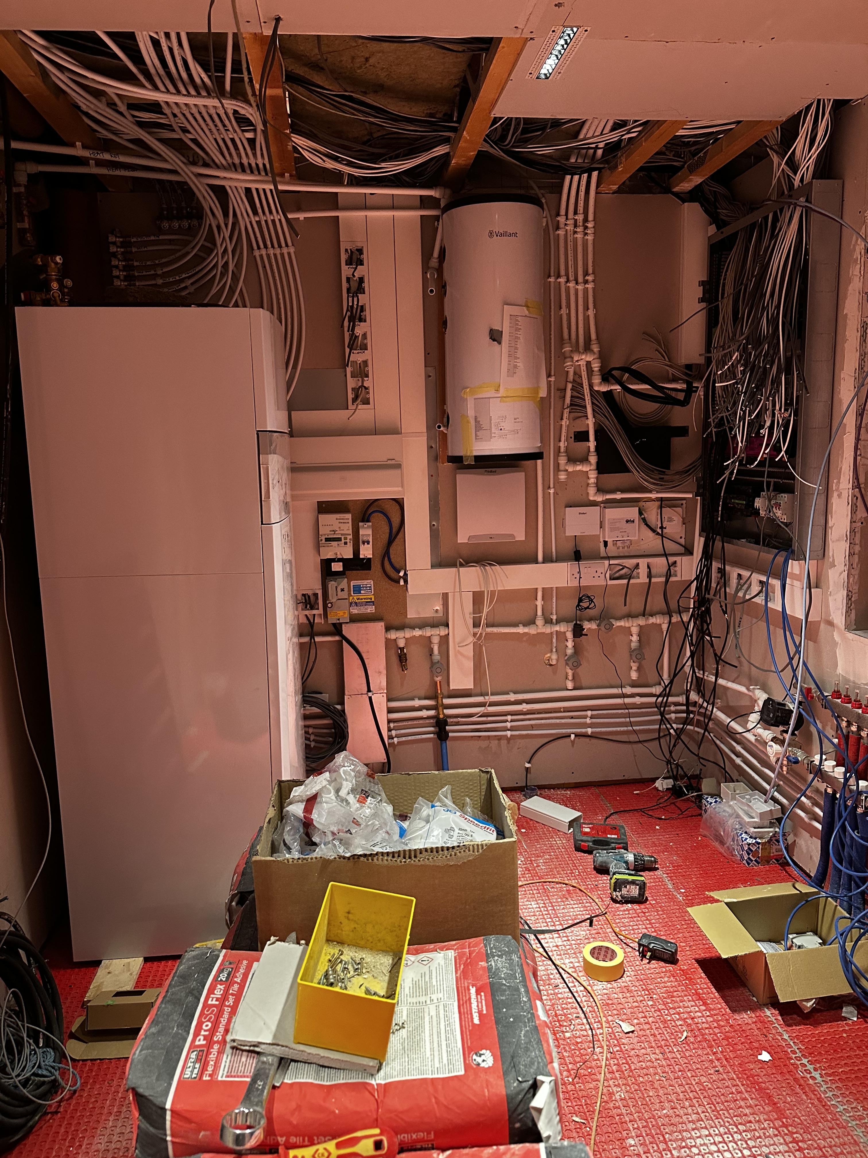

BartW Posted June 5, 2023 Author Share Posted June 5, 2023 We have always had dimmers in houses we lived and would not want not to have them going forward. Sonetimes all lights one circuit can give is not what we want / need. plus, it is too late to skip HA: Link to comment Share on other sites More sharing options...
