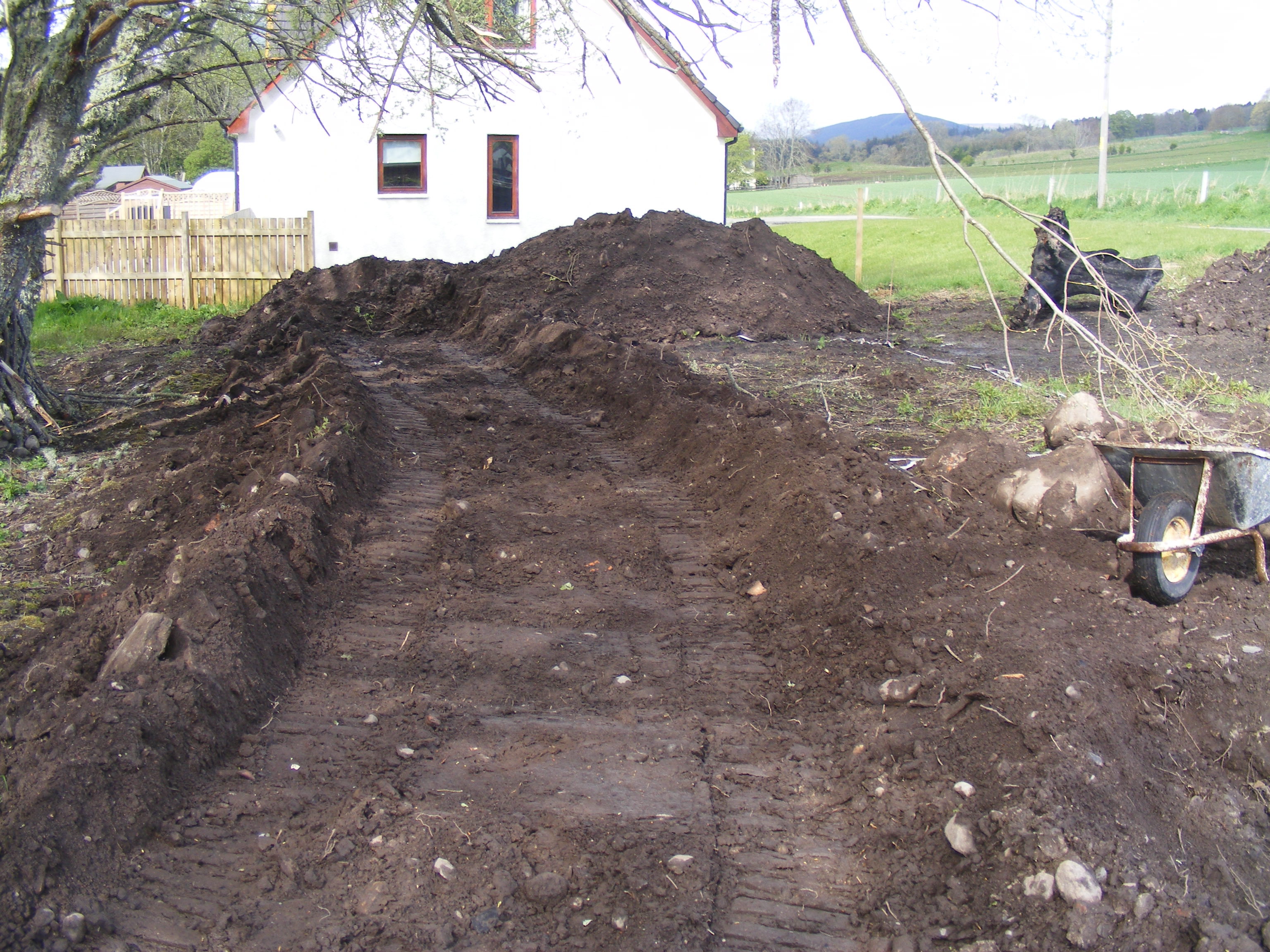

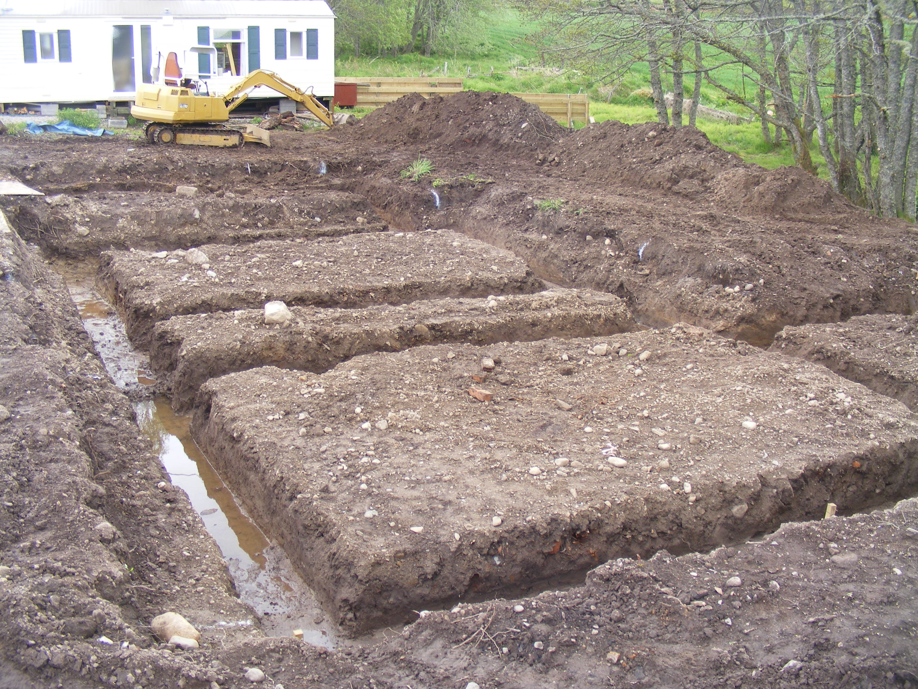

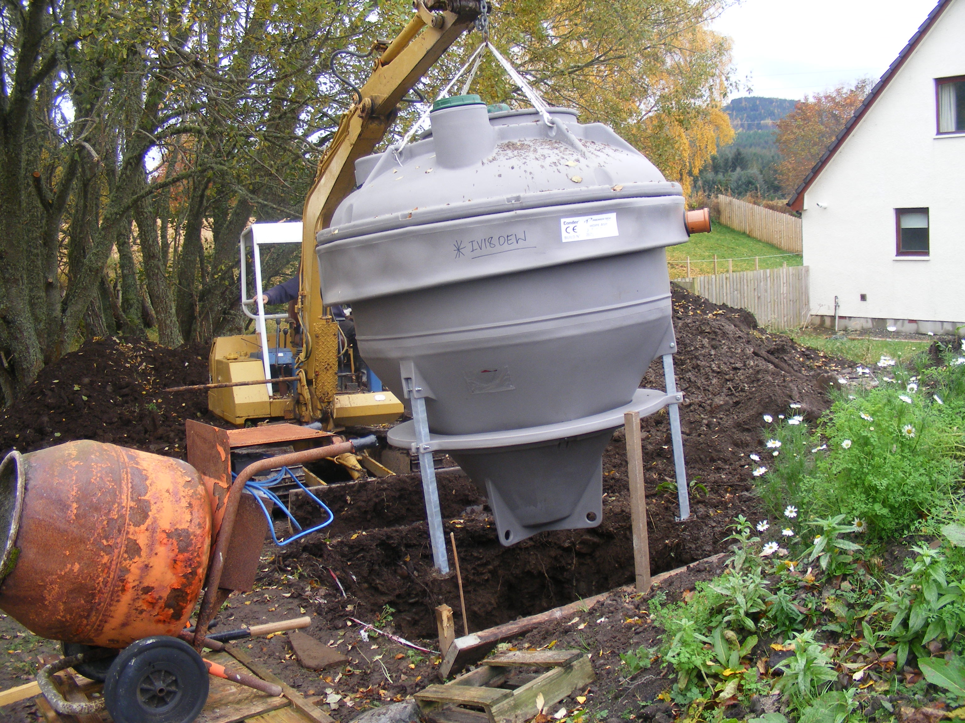

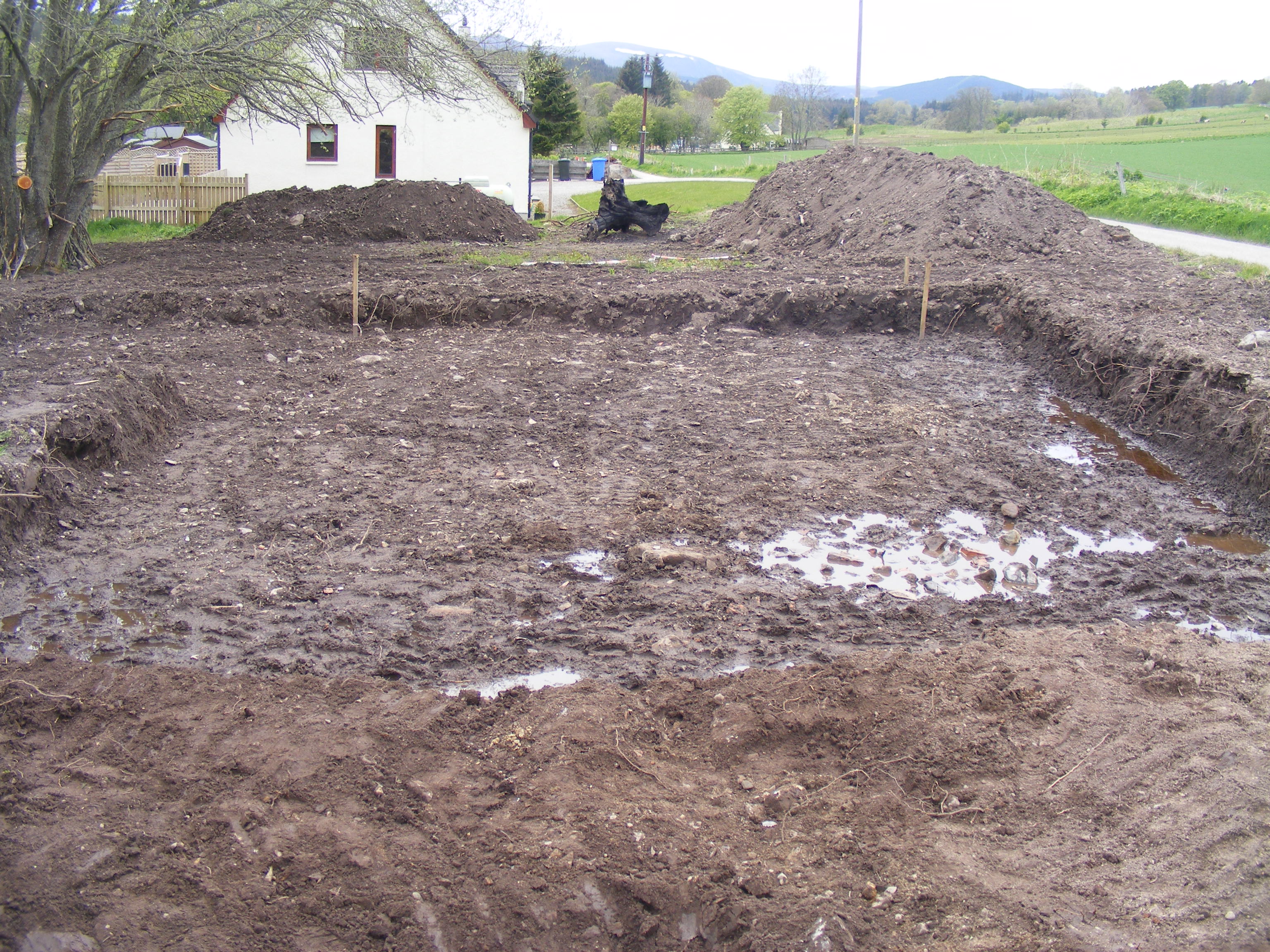

ProDave Posted June 6, 2016 Share Posted June 6, 2016 Mine is an old 3 ton Komatsu I dug off nearly a metre of top soil, shifting probably 150 tons of soil in the process Then dug the strip foundations And the deepest job, was digging a hole abourt 2.5 metres deep for the treatment plant, here we are almost at full reach down into the ground. 1 Link to comment Share on other sites More sharing options...

ProDave Posted June 7, 2016 Share Posted June 7, 2016 It is possible to get a fork lift attachment for a digger to lift stuff, but it would not be very good on an old machine like mine that tends to be a bit jerky in its movements. They are good for picking things up with slings or ropes, I used the digger to lift the treatment plant into its hole I wouldn't have wanted anything smaller than my 3 ton machine. On the other hand the builders I used brought their 13 ton machine to pour the concrete (for its greater bucket capacity and much longer reach) but it was very tight moving that around our site so that size would have been too big for general use on our site. Link to comment Share on other sites More sharing options...

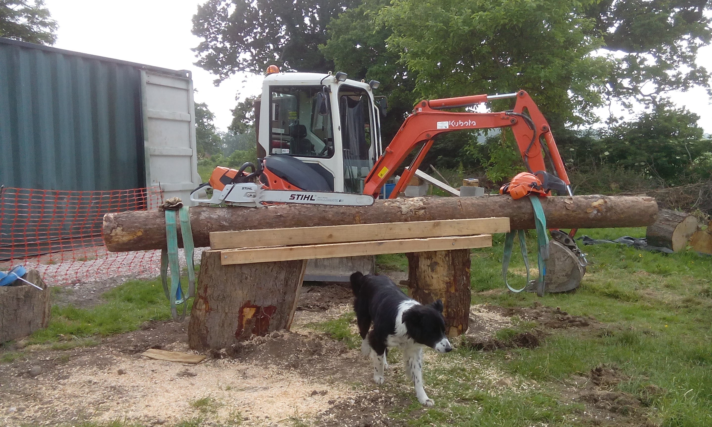

ToughButterCup Posted June 8, 2016 Share Posted June 8, 2016 Just to illustrate my point earlier in the thread have a look at this.... The 'pillars' were inserted by using the digger - the holes dug, the hemlock tree sawn in two and 'posted' into the holes - both back-filled by the digger , the cedar tree off loaded from the trailer (at full 3 meter stretch) and dropped onto the rails (4 by 4s). All on my own with no help. And I thought diggers were for digging holes. And that's Tess, the Chicken Dog. She spends all day rounding up chickens and herding them into the branches of a Bay tree. Yep, I dunno why either. 2 Link to comment Share on other sites More sharing options...
Declan52 Posted June 8, 2016 Share Posted June 8, 2016 Look at that lovely shinny shackle on the back of the bucket. I bet it makes lifting a lot easier for you. And if you need a few inches of extra height just open the bucket out. Link to comment Share on other sites More sharing options...
