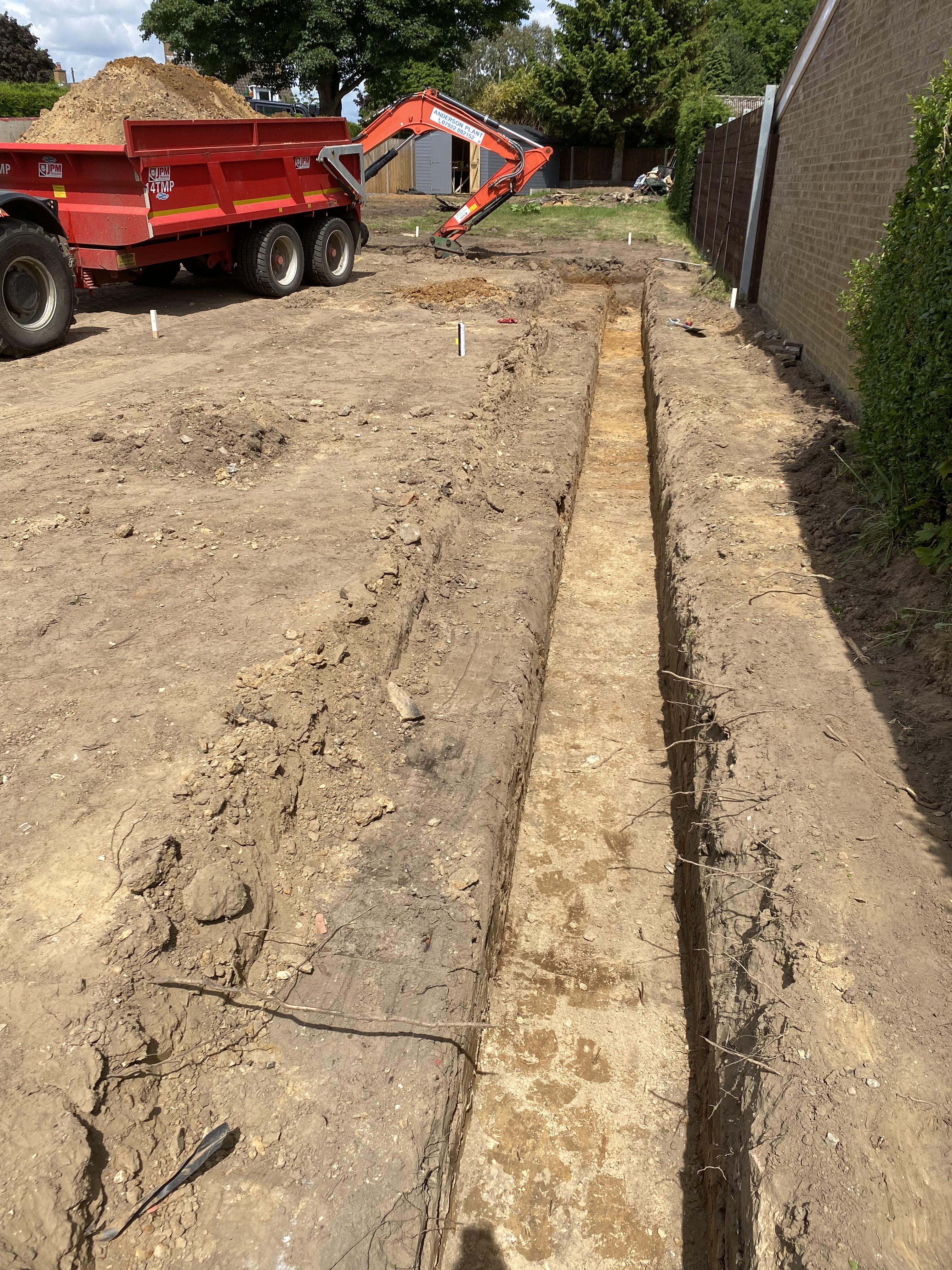

PJW Posted May 24, 2023 Share Posted May 24, 2023 So, as our build comes closer, who has done there own groundwork? pre foundation work including trenches to receive services from the road. Our ground floor is 140m2. We are building on an old orchard so I need to fell a few apple trees and possibly a walnut. Because we have trees we have yet to find out if we need to big down to 2m instead of the 1.2m standard. Soil survey will tell us this, so is getting a digger myself before to do this? Should I buy one or hire one? As you may tell by the question, I want to do what I can myself, 1. for the experience 2. to save money. Any advise? Link to comment Share on other sites More sharing options...
Kelvin Posted May 24, 2023 Share Posted May 24, 2023 I’d probably buy rather than hire. Digging straight lines at a certain depth and width to match the dimensions on good level ground isn’t hard. Where it gets hard is when unknown problems rear up and how best to deal with them. Our 1.4 acre plot is on a slope so there’s only a small area you can easily build on. It needed a degree of cutting and filling and a bit of thinking about that all took skill and experience to do. I was chatting to my BCO and he marvels at the skill of the groundswork team on difficult ground and tight sites like ours. Link to comment Share on other sites More sharing options...
PJW Posted May 24, 2023 Author Share Posted May 24, 2023 thanks Kelvin, our plot is relatively flat.. will need a small bit of levelling, however it's certainly not a slope. Good to know it's not difficult once we know the dimensions. Did you have any problems when doing yours? Just out of interest, what did you do with all the soil, stone, rocks you dug up... did you manage to repurpose any of it? or simply just had to pay to get to rid of it? Link to comment Share on other sites More sharing options...

Dave Jones Posted May 24, 2023 Share Posted May 24, 2023 there will be a local man with a digger, 3-400 a day with machine. They will be 5x faster and neater than trying to do it yourself. They will also have contacts for muckaways etc 1 Link to comment Share on other sites More sharing options...
ProDave Posted May 24, 2023 Share Posted May 24, 2023 There are quite a few of us on here that bought our own digger and used it for most of the build. I did my own foundations up to the concrete then the builders turned up and took over from concrete pour onwards. They started off by saying I would never survey it, mark it out and dig the trenches in the right place on my own, but then admitted I had done a very accurate job, there was just one corner out by about 100mm and that was because I could not get the digger square on for that corner. It took us 10 minutes with a shovel to square off that corner to get it right. I used it for all the site preparation first, services, moving soil around and it's final task before I sold it was the basic landscaping of the garden. Link to comment Share on other sites More sharing options...

Chanmenie Posted May 25, 2023 Share Posted May 25, 2023 (edited) I agree with @Dave Jones. I was going to borrow a digger and do my own, but found a local guy who had all the equipment, I marked out the site and levels. Using an 8 ton digger with myself holding the lazer level he dug perfect trenches, they were straight as an arrow and within 10mm of required depth all round. It didn’t take him very long and he took 200 ton of muck away at a very reasonable cost. I then arranged for a local company to pour the 300mm strip footings then did the blockwork up to DPC myself. So with a mixture of DIY and Trades I got very accurate trenches and level, square foundations for a much reduced outlay Edited May 25, 2023 by Chanmenie 3 Link to comment Share on other sites More sharing options...

LSB Posted May 26, 2023 Share Posted May 26, 2023 We have done everything ourselves, except drawings from architect, SE and for BC. I even submitted my own planning app after 2 refusals and got it approved. If you look at my blog you will see what we've been through so far. It's a very very slow build, just got the first wall to DPM level. BS officer (private) was very happy with our trenches and said the others can just be photos. We do have SE drawings which specify the depth, in our case it varies between 1m on sandy soil and 2.4m on clay / roots. The trees were cut down, most of them dead already a few years ago, for various reasons hence the trench depth. That said when BC came out for our 1st trench (1m) he said there was no need to go that deep on our soil and 450 would have been plenty, we are single story. We have digger, dumper and every other tool known to man, well it seems that way, 7 sheds. The main reason we decided to do it was because we had 4 groundwork companies out to quote and not one of them even bothered because of the depth where the clay / roots are and underpinning needed (barn conversion). Too many easy jobs out there. We are now tackling the build in 4 sections starting on the easy one to gain experience. So, perfectly possible with the right tools, learning (books & internet), build hub and taking it steady. I would also recommend private BC because they are working for us, not the council. Still the same checks, but more flexible. The SE did say that the trench depth can be approved by BC so we are going to do step trenches and just dig down until on 'good' ground and not just dig to 2.4 around half the walls. Our build is 240m2 on one floor with 87m of wall that needs trenches or underpinning. where the existing walls are they are single skin so we are building a 2nd skin that needs it's own foundations. Link to comment Share on other sites More sharing options...
