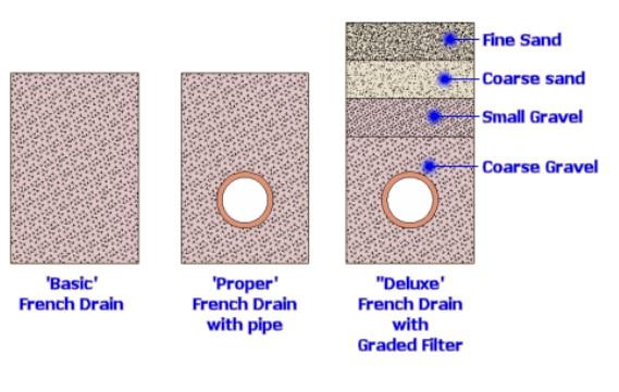

Adsibob Posted July 15, 2021 Posted July 15, 2021 (edited) I'm a bit confused by the discussion here about not needing a pipe in a French drain. thepavingexpert.com website that gets lots of rave reviews here, just says the following: "A big part of the problem with French Drains was that the vast majority of them were poorly constructed. As already stated they often comprise nothing more than a trench backfilled with any old gravel that happened to be lying around, but a true French Drain should include an unjointed pipe and the better ones would be surrounded by a graded filter of selected gravels and sands." There is then a somewhat helpful picture: But apart from describing the third option as "deluxe" it doesn't really tell you why. Why would it be helpful to have a graded filter? As long as the perforations in the pipe are smaller than the size of the pebbles/gravel/pea shingle it presumably won't impact performance, or does the filter make sure that the closer the water gets to the pipe the cleaner it is and therefore the less likely the pipe is to block up? The other point, which I'm sure is obvious to everyone else, but not to me, is whether the pipe needs to be installed at a fall or whether it is sufficient for the bottom of the trench to have the fall? And finally, what are the pros and cons of a fully perforated pipe (top and bottom) versus one that is only perforated on one side (presumably the top side)? For context, I'm trying to finalise the spec of my french drain for the perimeter of my house, which includes two damp walls where a significant cause of damp was insufficient drainage of water away from the wall. It would also be incredibly helpful to have people's views on what diameter pipe I should specify. Architect has specified 60mm and two types of gravel coarse and then a finer decorative type on top. I've also found an 80mm pipe for similar money. Which is better? Edited July 15, 2021 by Adsibob

Mr Punter Posted July 15, 2021 Posted July 15, 2021 17 minutes ago, Adsibob said: Why would it be helpful to have a graded filter? Depends on the soil type. You don't want the pipe clogging up and I guess the graded thing should stop this. Depends on soil type. In heavy clay, most land drains fail over time because they clog up. I have seen lots of examples of old pipes completely blocked with clay. Regarding fall, as long as the pipe does not get silted up it is fine to lay level if it is sited low enough and has a gravity outfall.
Onoff Posted July 15, 2021 Author Posted July 15, 2021 7 minutes ago, Mr Punter said: In heavy clay, most land drains fail over time because they clog up. I have seen lots of examples of old pipes completely blocked with clay. Does a wrap of permeable geotextile around the pipe or say under the top layer of aggregate help prevent blockage?
Mr Punter Posted July 15, 2021 Posted July 15, 2021 26 minutes ago, Onoff said: Does a wrap of permeable geotextile around the pipe or say under the top layer of aggregate help prevent blockage? It just gets silted up if on clay
Onoff Posted July 15, 2021 Author Posted July 15, 2021 5 minutes ago, Mr Punter said: It just gets silted up if on clay Even the geotextile? What's the answer then on clay....line the whole trench first?
jfb Posted July 15, 2021 Posted July 15, 2021 38 minutes ago, Onoff said: Does a wrap of permeable geotextile around the pipe or say under the top layer of aggregate help prevent blockage? I believe that for a clay soil a geotextile membrane won’t help much since the membrane itself is prone to clogging up. Sandy soil is much more suited to a membrane.
jfb Posted July 15, 2021 Posted July 15, 2021 15 minutes ago, Onoff said: What's the answer then on clay Just shingle and perforated pipe
