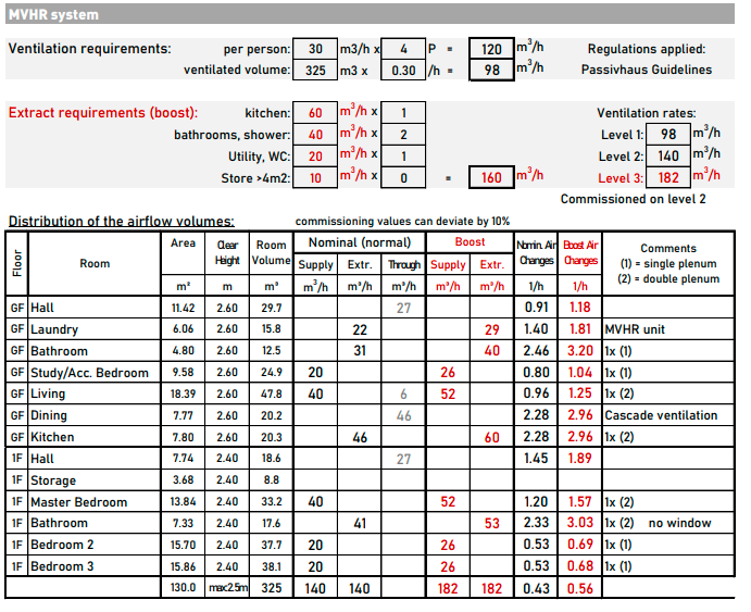

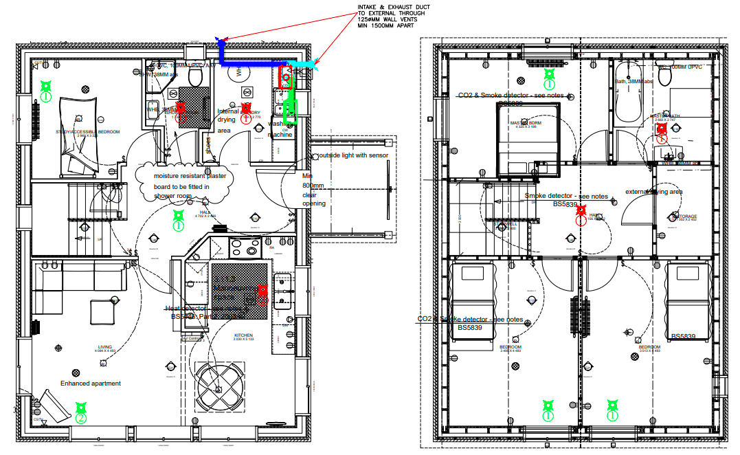

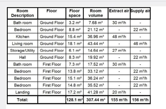

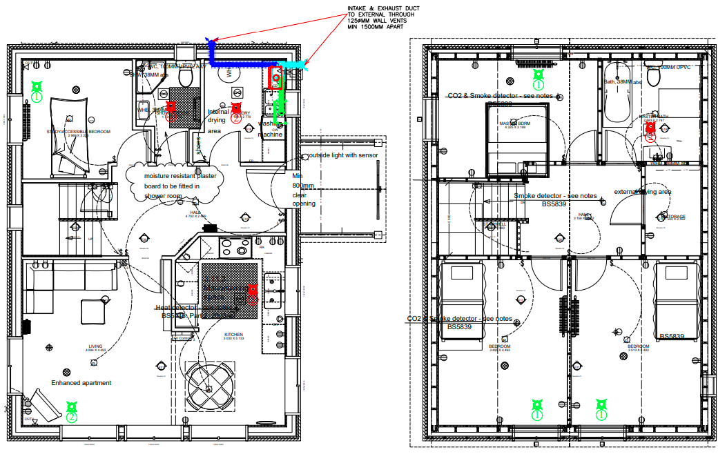

Ola Posted May 8, 2023 Share Posted May 8, 2023 (edited) Any help/comments on the MVHR design greatly appreciated We have just ordered Zehnder Comfoair Q350, 90mm radial ducts, 160mm spiral and insulated ducts (split order: 80% BPC / 20% VentilationLand & phstore). MVHR unit will be located at the ground floor utility/laundry room. I received two quite different Location Guides from BPC. The first one was initially done for the 75mm radial ducting by an error but then no change in the guide when we pointed this out; the second one for the 90mm ducting after asking some additional questions regarding the number of double duct valves (in return they changed the design). Both guides show two separate exhaust/supply external terminals but this will be changed to Zehnder 160mm combo-grille (drilling openings vs building construction issues, plus wouldn't want the terminals on two different walls anyway). I also received some calculations from PAUL for the Zehnder unit and 90mm system, with the number of supply/extract points indicated in the table below (the quote was well out of our budget though so have not got the full design from them). Which one out of the three would you describe as the most suited? Can any obvious errors be seen in the valves placement, folks? 1. BPC Ground floor (left hand side drawing) has red extract points in 2x utility, 2x shower room, 2x kitchen; green supply points in 2x living area (dining area via cascade effect?), 1x bed/study Upper floor extracts: 2x bathroom, 1x in each bedroom 2. BPC re-designed Ground floor: extracts - 1x utility, 1x shower room, 2x kitchen; supply valves - 2x living area, 1x bed/study, 1x hallway Upper floor: extracts - 1x bathroom, 1x hallway; supply valves - 1x in each bedroom 3. PAUL calcs for 90mm ducting system and a different approach to the valves' number/ location (see the right hand side column for this) - no valves in the hallways at all, 2x extract valves in the upper (main) bathroom, and 2x supply point in the "master" bedroom (although it is slightly smaller in area than the other two upper floor bedrooms and much closer to the unit). Edited May 8, 2023 by Ola some details added to the description 1 Link to comment Share on other sites More sharing options...
Johnny Jekyll Posted May 9, 2023 Share Posted May 9, 2023 Design one with two ducts per valve in larger (or multiple occupancy) areas seems to be common with 75mm ducting. Design two which I’m presuming will be your approach because you have purchased 90mm ducting seems good. I’ve read that 90mm ducting enables a lot more airflow, which is why only one duct is needed to most valves. The valves are on the opposite sides of the rooms to the doors (near to windows), which is great. The only question I would ask BPC is why are valves being used in the hallways? I was under the impression valves aren’t needed in hallways because they are not habitable rooms? Maybe a Build Hub colleague with more knowledge can jump in and explain? Also I will follow with interest (to try and learn and bit) what others on here will say about the PAUL calcs. Link to comment Share on other sites More sharing options...
Ola Posted May 9, 2023 Author Share Posted May 9, 2023 3 hours ago, Johnny Jekyll said: The only question I would ask BPC is why are valves being used in the hallways? I was under the impression valves aren’t needed in hallways because they are not habitable rooms? Maybe a Build Hub colleague with more knowledge can jump in and explain? Thank you for your response @Johnny Jekyll I have inquired this and got an email from BPC explaining that the vales in the hallway would let them balance the machine. They also like to have an extract in the upstairs hall for heat grab. (As heat rises, there is usually a good source of heat there.) I really don't know. My another guess was, they added the supply valve in the downstairs hallway, to allow more air in the living room? The location of the living area supply valve would perhaps cause the fresh air making a shortcut to the kitchen extract point, creating a stale air zone when the sitting area is? 1 Link to comment Share on other sites More sharing options...
Ola Posted May 12, 2023 Author Share Posted May 12, 2023 On 08/05/2023 at 15:38, Ola said: Upper floor extracts: 2x bathroom, 1x in each bedroom Re- BPC 1 design - somehow I missed out 'supply valves' in the original post description (this should read "uper floor extracts: 2x bathroom, supply valves: 1x in each bedroom") Link to comment Share on other sites More sharing options...
MikeSharp01 Posted May 12, 2023 Share Posted May 12, 2023 On 09/05/2023 at 20:26, Ola said: I have inquired this and got an email from BPC explaining that the vales in the hallway would let them balance the machine. They also like to have an extract in the upstairs hall for heat grab. (As heat rises, there is usually a good source of heat there.) I have not heard that heat grab idea before - I wonder how it really works as apart from the immediately obvious it will have the effect of extracting in a place where you would naturally want to be supplying so the air from the bedrooms will now go out of the hallway and bathroom extracts and it may suck air up the stairs feels odd but has the whiff of right about it. 1 Link to comment Share on other sites More sharing options...
MikeGrahamT21 Posted May 12, 2023 Share Posted May 12, 2023 12 minutes ago, MikeSharp01 said: I have not heard that heat grab idea before - I wonder how it really works as apart from the immediately obvious it will have the effect of extracting in a place where you would naturally want to be supplying so the air from the bedrooms will now go out of the hallway and bathroom extracts and it may suck air up the stairs feels odd but has the whiff of right about it. Sucking up warm air and passing it through a heat exchanger which isn't 100% efficient, surely leaving the warm air where it is, displace it with filtered cool air with recovered heat would be more efficient overall? The humidity helps with the heat exchange too, so by pulling from hallway you would be drying that air somewhat, and reducing efficiency? Maybe i'm wrong here, i'm no expert, just doesn't necessarily seem sensible 1 Link to comment Share on other sites More sharing options...

Ola Posted May 12, 2023 Author Share Posted May 12, 2023 (edited) Thank you for all the comments. I now have also received the calcs from BPC relating to the 2nd design. The height of the ground floor has been incorrect though, it should be 2.60m (it looks grey used 2.4m). Edited May 12, 2023 by Ola Link to comment Share on other sites More sharing options...
