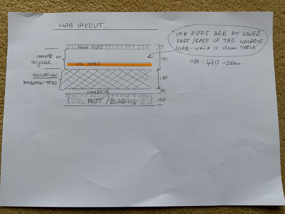

Tilbert Posted May 7, 2023 Share Posted May 7, 2023 Hello, I’m a first time poster here. Hopefully my question is not too daft… I’m converting a barn, which is attached to our house, into our new kitchen. It’s about 72 square metres and will be just a kitchen. I’m planning on a wet underfloor heating system and considering how to heat it. I’m trying to figure out if I could put in a heat battery just to power the underfloor, so to draw electricity from the grid overnight at cheap rate into the battery and then release to heat the underfloor. Any words of wisdom greatly appreciated. we are on oil for the rest of the house (no gas in our village). I initially looked at air source but not impressed by the ongoing running costs. Thank you Link to comment Share on other sites More sharing options...

Nickfromwales Posted May 7, 2023 Share Posted May 7, 2023 1 hour ago, Tilbert said: Hello, I’m a first time poster here. Hopefully my question is not too daft… I’m converting a barn, which is attached to our house, into our new kitchen. It’s about 72 square metres and will be just a kitchen. I’m planning on a wet underfloor heating system and considering how to heat it. I’m trying to figure out if I could put in a heat battery just to power the underfloor, so to draw electricity from the grid overnight at cheap rate into the battery and then release to heat the underfloor. Any words of wisdom greatly appreciated. we are on oil for the rest of the house (no gas in our village). I initially looked at air source but not impressed by the ongoing running costs. Thank you Hi. If you cannot attach to the oil heating system, which is 100% what you should be doing btw, then you may as well just install an in-screed direct electric heater wire and heat the slab up instead of a stupidly expensive SA / Thermino as the slab will have inherent storage and release characteristics already. Before we advise any further, we would need to know how much insulation and how thick the slab / screed will be, please? You'll get probably less than 3 hrs of space heating from the largest SA unit, the 12-14kWh one, when fully charged, if you're lucky. Every one of these I fitted for space heating, with plans and designs approved directly by SA, ended in very expensive arguments / tears. The ones that didn't blow up, that is Link to comment Share on other sites More sharing options...
Tilbert Posted May 7, 2023 Author Share Posted May 7, 2023 Thank you all for your comments, certainly helpful. The slab will be constructed of concrete, then insulation, then screed on top. We’re insulating the walls with 100mm celotex and roof 100mm, so hoping the room will be well insulated. (It’s fairly high at circa 6metres to the apex). In my mind I had thought of moving away from oil for green reasons, and also there is some difficulty in running pipes from the existing boiler to the UF heating - but if this is the most practical and good for low running costs may persevere with this. I’d initially thought of ASHP, but been put off by comments on very high and unexpected running costs. Link to comment Share on other sites More sharing options...

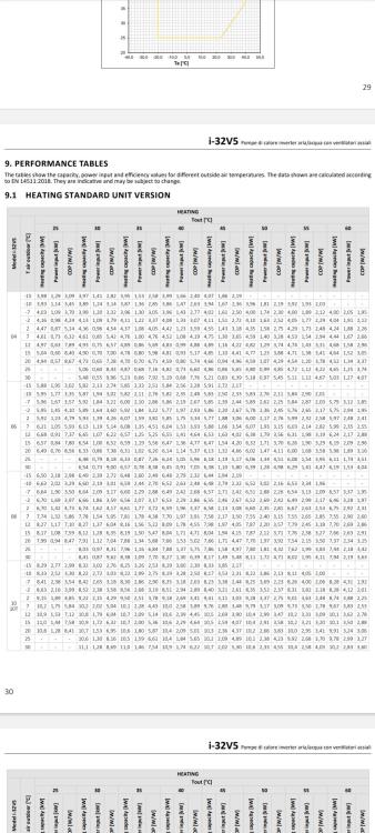

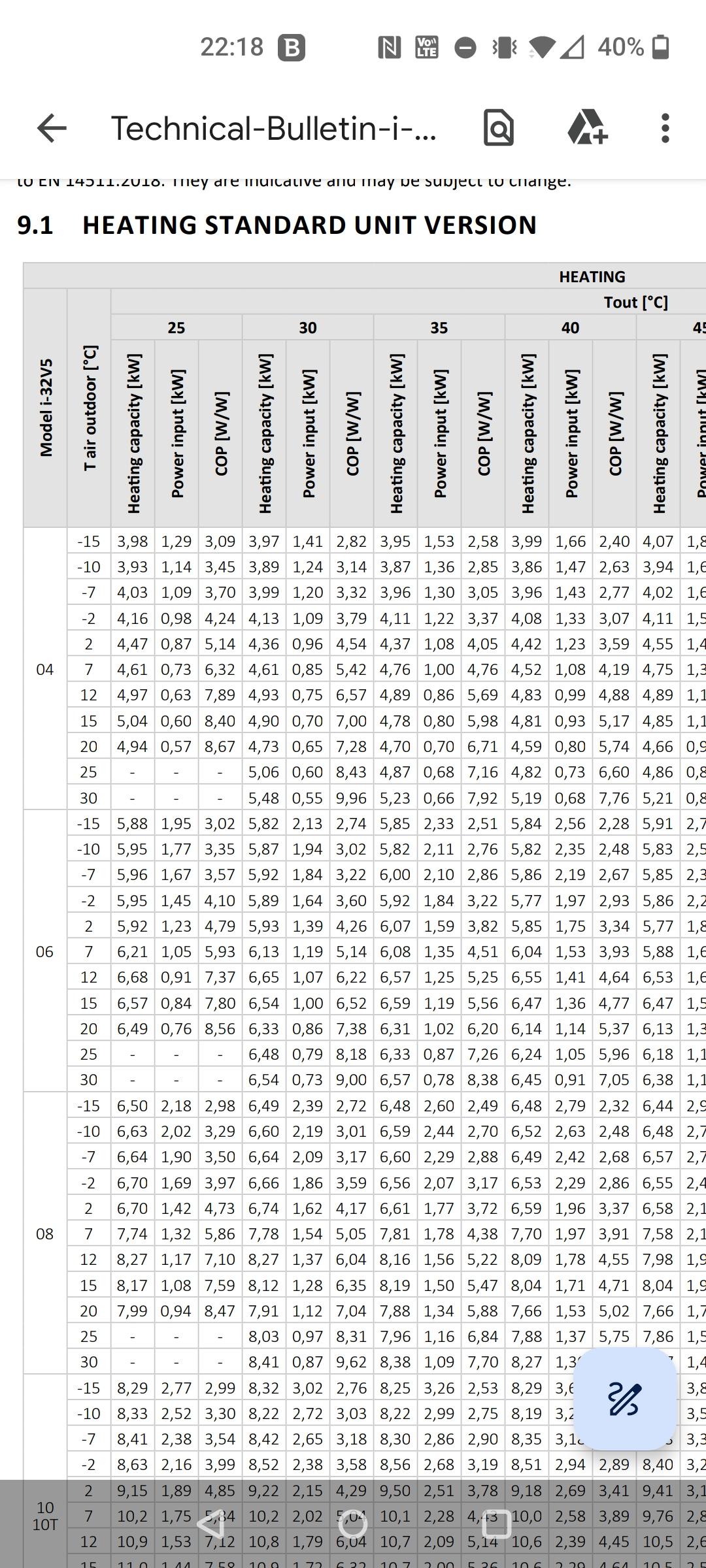

JohnMo Posted May 7, 2023 Share Posted May 7, 2023 21 minutes ago, Tilbert said: ASHP, but been put off by comments on very high and unexpected running costs Running UFH from an ASHP shouldn't be expensive in fact it's possibly one of the cheapest forms of heating when coupled to UFH. Low flow temperature leads to very good CoP. Attached is section out of our technical manual which gives, flow temperature, heating power and CoP, for reference. By the way you should be adding way more insulation, I doubt you even meet building regs minimum requirement, with 100mm. For UFH you ideally need around 150mm or more. Link to comment Share on other sites More sharing options...
Nickfromwales Posted May 7, 2023 Share Posted May 7, 2023 I'd review the floor construction methodology, and do as a lot here have done, including what I do for my clients. Forget the screed, put the insulation down low on the ground, and then have a constructional, heated slab with steel mesh reinforcement for anti-cracking. The ufh pipes get cable-tied to the steel, and then the concrete pour is your finished interior floor ( less final coverings ). A small, cheap ASHP on this would be very cheap to run. Coming off oil will have its challenges also, as the oil boiler could never see just the UFH independently or it'll "poop the bed". At the minimum, you'd need to install something like a 150L - 200L buffer tank to accept the huge amount of heat the oil boiler will produce before it realises it's not even needed. If you run the UFH and radiators simultaneously, then you may JUST get away with it, but maybe not even then. Oil boilers like to light, burn at 100% ( or 0%, nothing in-between with oil btw ), and burn for as long as is possible, and this is because they do not modulate. This means that it would produced huge amounts of heat, the UFH would be taking 5-10% of that at most, and then the boiler would cycle on/off repeatedly ( referred to as "short-cycling" ) which would eventually ruin the boiler. A decent 5kW ASHP is around £2.5k FYI, or less if you go for a lesser-known brand. Rethink the floor, because, as stated, it shouldn't be heated with that poor a level of insulation, sorry! For your stated floor detail, you should be having rads on the walls instead. Link to comment Share on other sites More sharing options...

Nickfromwales Posted May 8, 2023 Share Posted May 8, 2023 1 hour ago, Tilbert said: So, if I understand the theory, 1 hour ago, Tilbert said: Insulation (100mm) Look, you're new here, so I won't shout You need way more than 100mm of insulation. That's not going to cut it. You need a minimum of 140mm to be anywhere near "energy efficient". To clarify, British Building Regs is the worst standard to build to without getting a bollocking off the BCO. That is NOT what you should aim for. Dig out a bit more, maybe see if you can get away with less type1, whatever. But the maths are; FFL of (x) thickness less 100mm concrete c/w mesh & UFH pipes less 140mm of PIR rigid insulation less (x) depth below that to get to a suitable substrate to start the process. That lot added up is what you need to get down to. 😎 Link to comment Share on other sites More sharing options...
Radian Posted May 8, 2023 Share Posted May 8, 2023 2 hours ago, Tilbert said: As an aside, an earlier comment suggested we have more insulation Say the 100mm insulation has a U-value of 0.2 W/m2, then with the UFH flow at 35oC and the ground beneath at 5oC, then the loss in Watts will be 0.2 * 72 * 30 = 432W. Nearly 0.5kWh constantly leaking away to the Earth. Do the same for the roof with 150mm of insulation when 5oC outside and 20oC inside: 0.133 * 72 * 15 = 144W. To get anywhere near the same low loss through the floor you'd need a minimum of 250mm giving U-value of 0.08 * 72 * 30 = 173W. 1 Link to comment Share on other sites More sharing options...

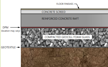

Nickfromwales Posted May 9, 2023 Share Posted May 9, 2023 7 hours ago, Dave Jones said: id do. 150mm hardcore 300mm EPS insulation 75mm fibre screed (no need for metalwork). ASHP as others have said IF you can get the barn airtight. If you cant it will struggle and as you have read be expensive to run. Guessing the barn doesnt have a DPC so you will need to get over this, painted on etc. 200mm of PIR means virtually the same value, but with 100mm less digging / removals / muck-away I'd stick with 100mm of concrete and anti-crack mesh, but it'll depend on whether you want to turn the heating on / off vs up/down (eg winter constant on) Link to comment Share on other sites More sharing options...
Dave Jones Posted May 9, 2023 Share Posted May 9, 2023 (edited) cost wise 200mm celotex is £650 more expensive than 300mm eps, but your right if you have muckaways it may be worth paying the extra for celotex. Edited May 9, 2023 by Dave Jones Link to comment Share on other sites More sharing options...

SteamyTea Posted May 9, 2023 Share Posted May 9, 2023 1 hour ago, Tilbert said: I’m not really sure how to calculate the ongoing running costs of oil vs ASHP, I have some data from a supplier but hard to factor in all the variables. What the SCoP is for. It tells you the expected performance over a typical metrological year. Then divide the price of electricity by the SCoP to get the running cost. The heat demand of the house is blind to the technology used to heat it. Link to comment Share on other sites More sharing options...
