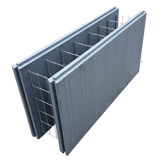

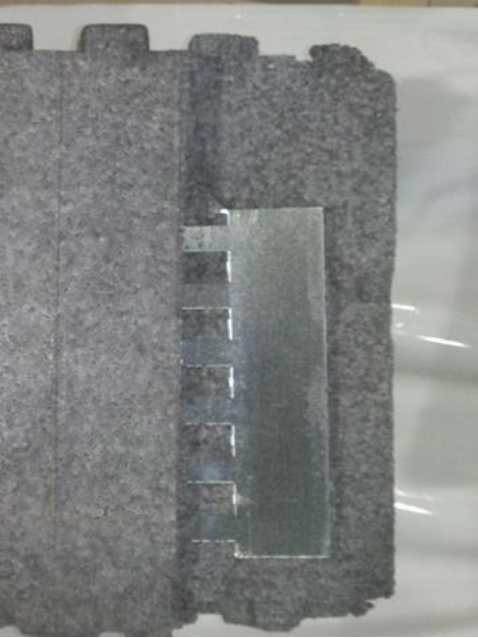

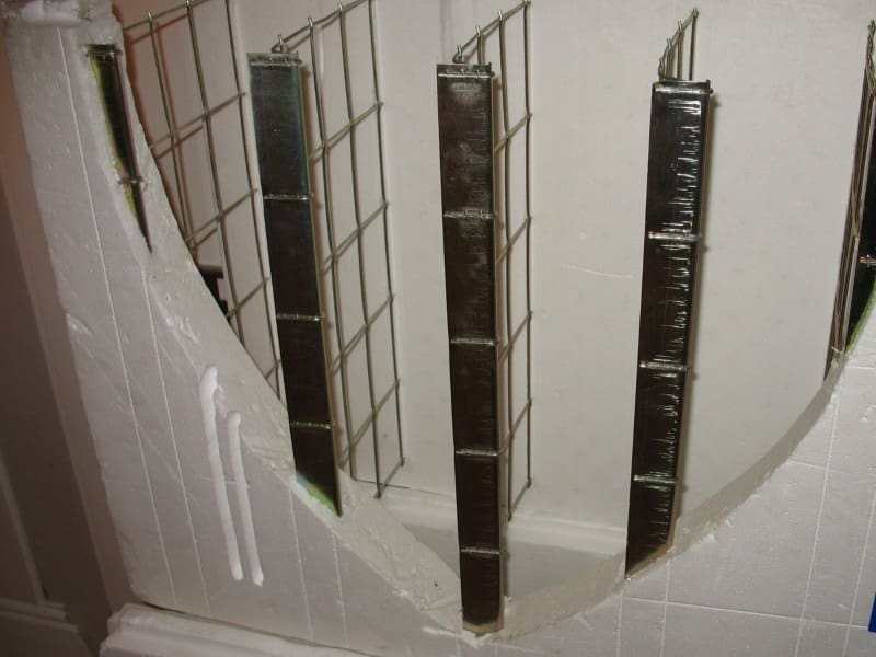

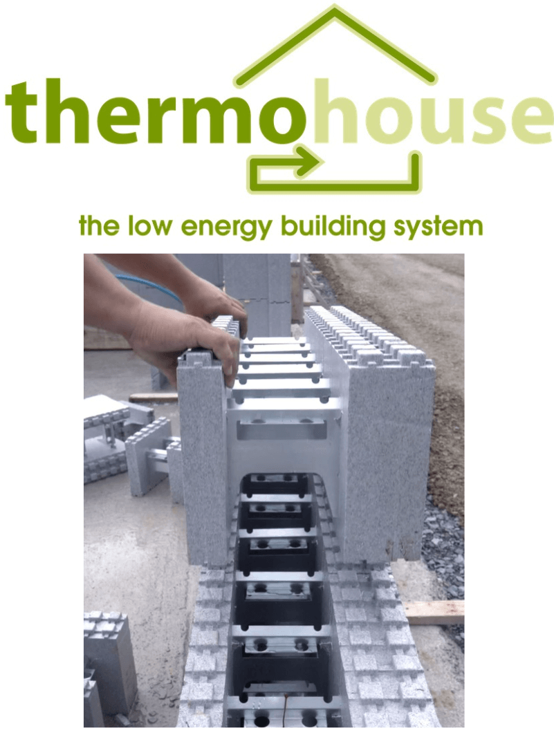

Nick Laslett Posted March 3, 2025 Posted March 3, 2025 5 hours ago, Iceverge said: Are those metal webs the same as the ones @Jenki has? No, not really. Polysteel Block Thermohouse block The Thermohouse block flanges/webs are 40mm wide, spaced at 150mm centres.

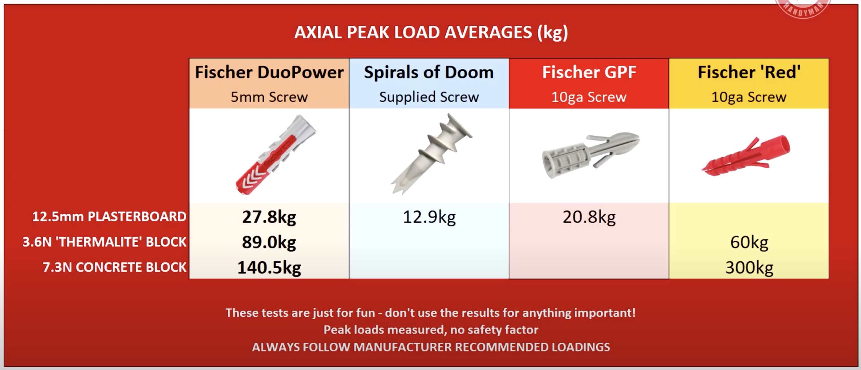

Iceverge Posted March 4, 2025 Posted March 4, 2025 Are those flanges strong enough to take a reasonable load like a big TV?
Nickfromwales Posted March 4, 2025 Posted March 4, 2025 5 hours ago, Iceverge said: Are those flanges strong enough to take a reasonable load like a big TV? Easily! You can also rebate the insulation to fit plywood across multiples of them if you were looking to affix between or away from the flanges (where the fixing holes simply don't line up for eg). Exp foam behind the plywood and then fix that to the flanges, leave to cure for 24hrs, then crack on with plaster boarding. Much more flexibility if you make the plywood patch a lot bigger, so when the rooms finished and you think the TV's too high / low etc you have room to manoeuvre 1
Nick Laslett Posted March 4, 2025 Posted March 4, 2025 (edited) 5 hours ago, Iceverge said: Are those flanges strong enough to take a reasonable load like a big TV? I'm not sure. They don't have any technical specs for the flanges. For internal finishing, you can either batten to the flanges, then fit plasterboard, or glue and screw the plasterboard directly to the blocks. When I finish the build, I might test the holding strength of the flange, but I would have thought it can hold 15kg on a single screw. The Fischer EPS fixings I use have a 10kg rating and they are just held in the eps. Edited March 4, 2025 by Nick Laslett 1
Nickfromwales Posted March 4, 2025 Posted March 4, 2025 16 minutes ago, Nickfromwales said: Easily! Obvs should have caveated by saying don’t hang an 80” TV off one fixing lol. 200mm concrete screw for anything crazy. Happy days.

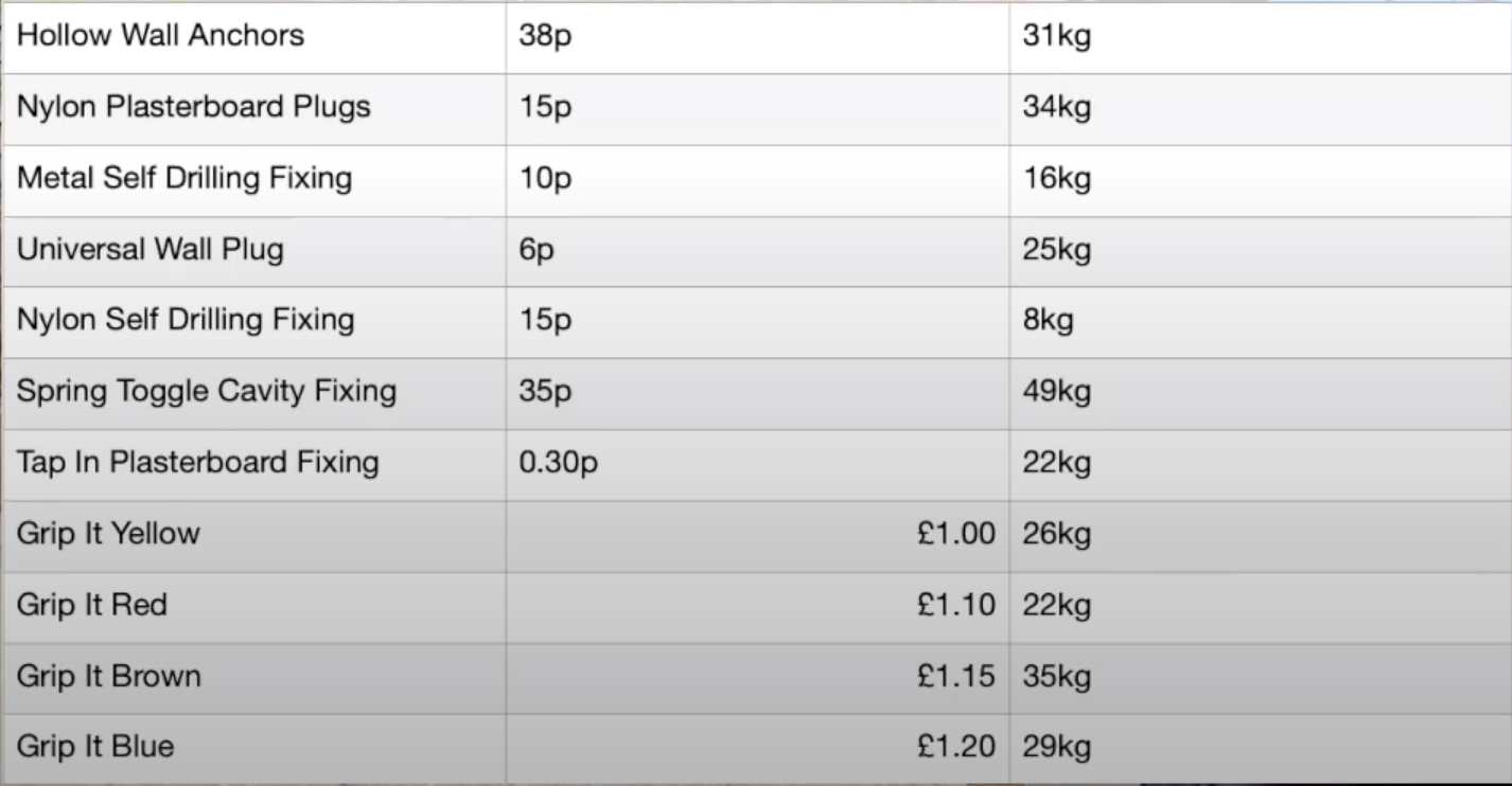

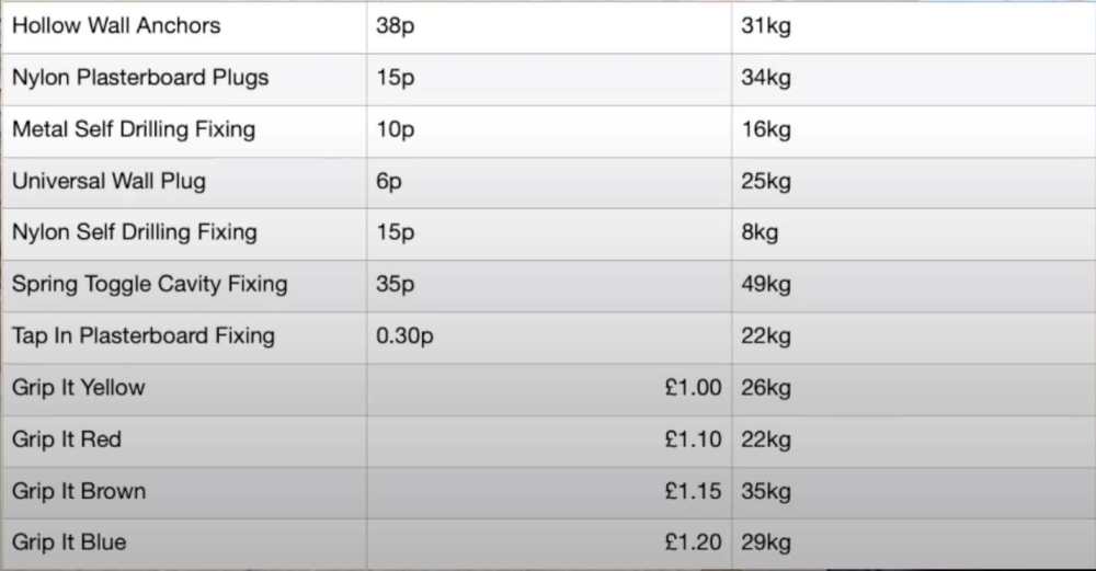

Nick Laslett Posted March 4, 2025 Posted March 4, 2025 (edited) I've watched a fews of these Youtube testing videos, and it is surprisingly how much weight plasterboard can take. (Obviously there are many different specs of plasterboard.) This one tests a number of different fixings. https://youtu.be/nfGG1Z5m-5A?si=tu70HP6OMuasUncK DIYGuy Table Gosforth Handyman has a load of testing videos, and he compared the Fisher Duo fixing in plasterboard and got good results, 27.8kg Just as a point of reference the Samsung 98” Neo QLED 4K QN90D TV weighs 61.4kg. The Samsung 65” OLED S95D 4K TV weighs 18.9kg. TVs are just not that heavy these days. My old 60" Pioneer Kuro Plasma weighed 55.5kg. Edited March 4, 2025 by Nick Laslett 1

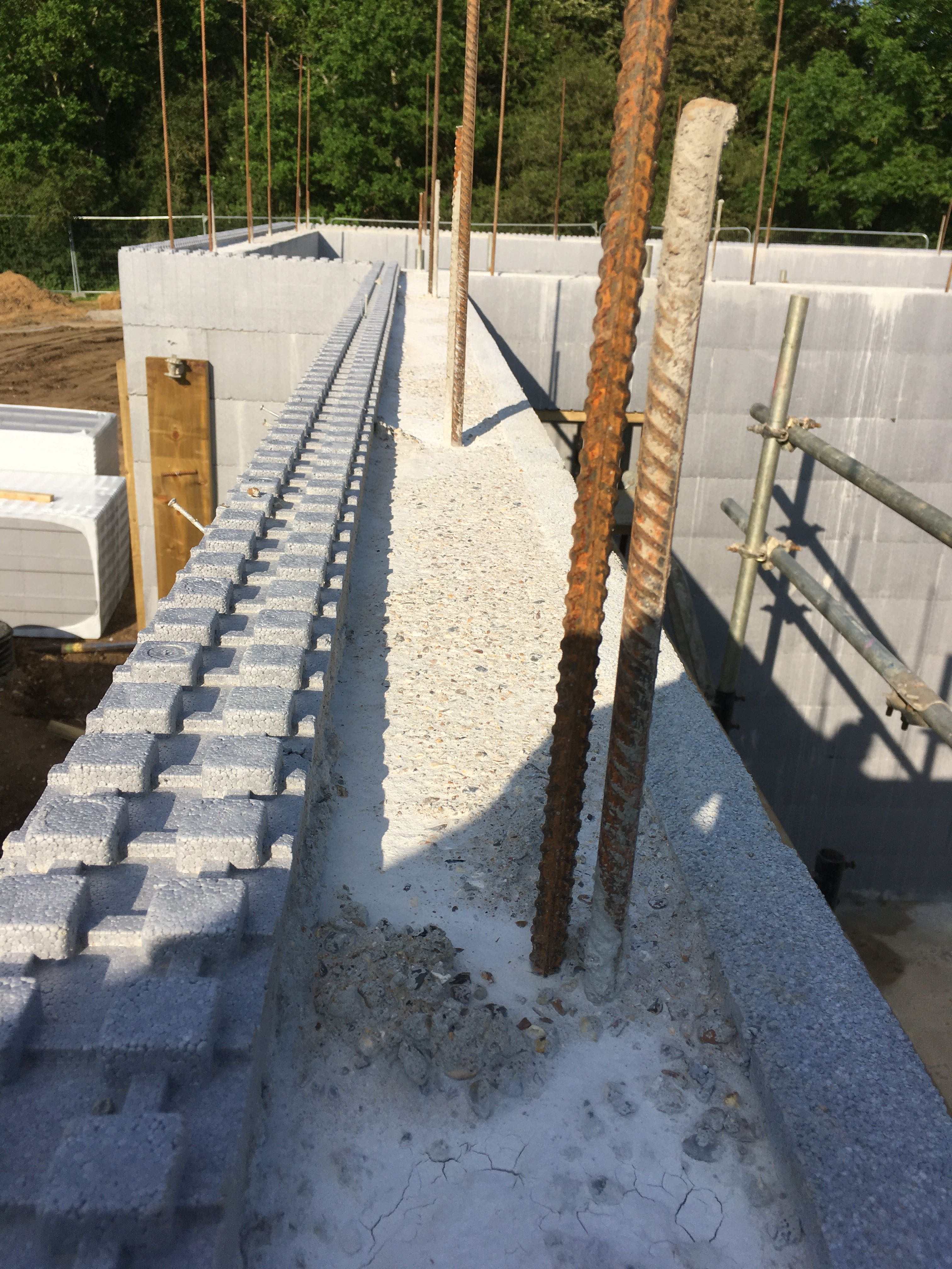

Nick Laslett Posted March 27, 2025 Posted March 27, 2025 Also on my build the vertical rebar connects the ground floor walls to the slab, then the first floor walls to the ground floor walls. 1

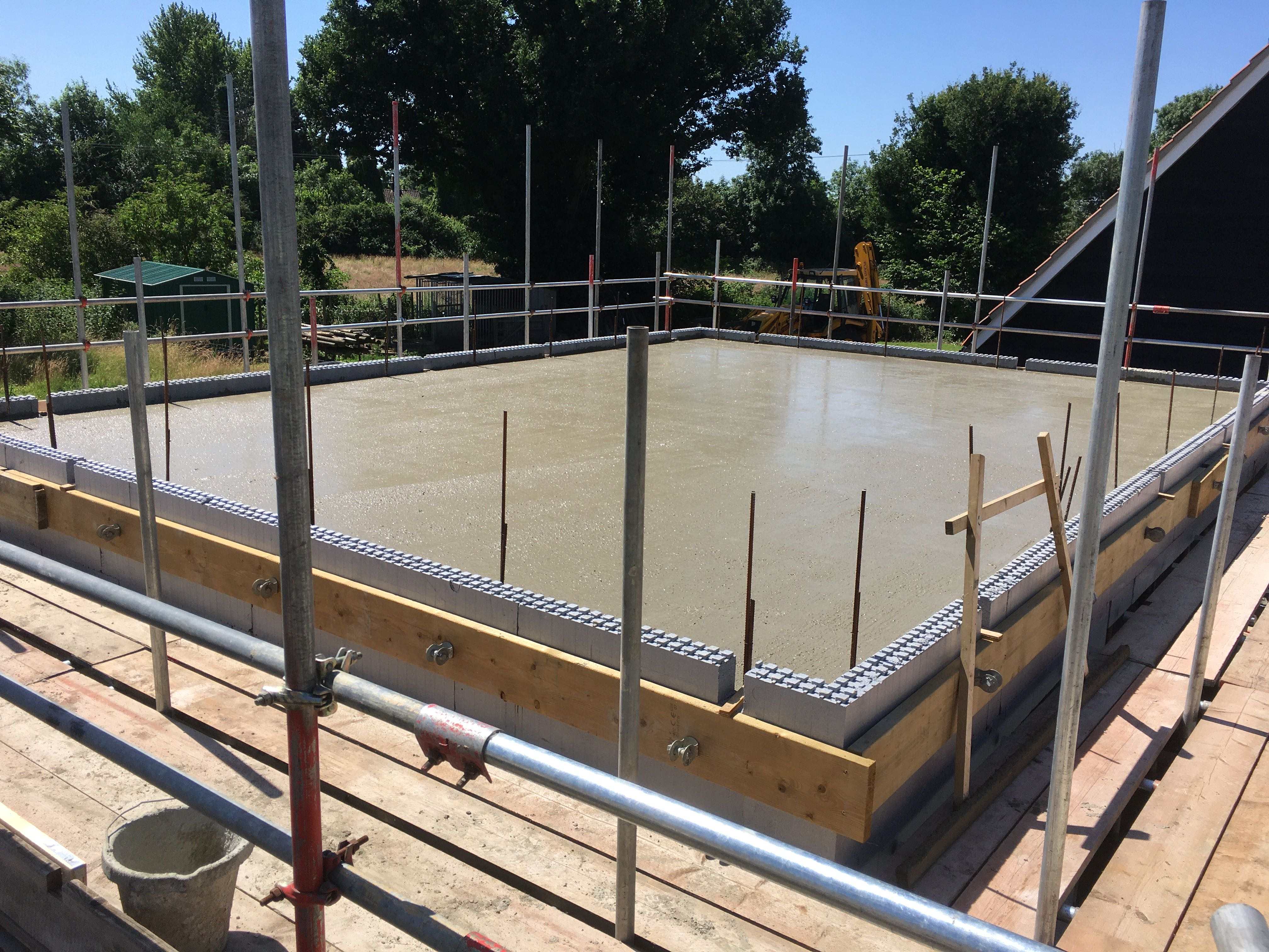

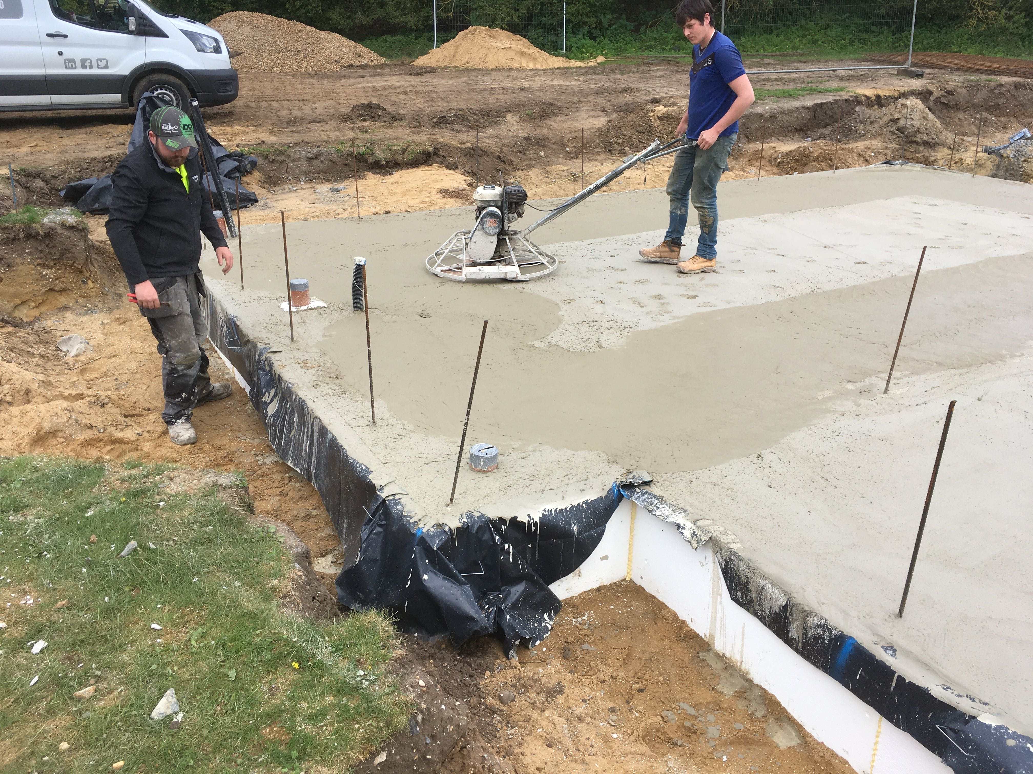

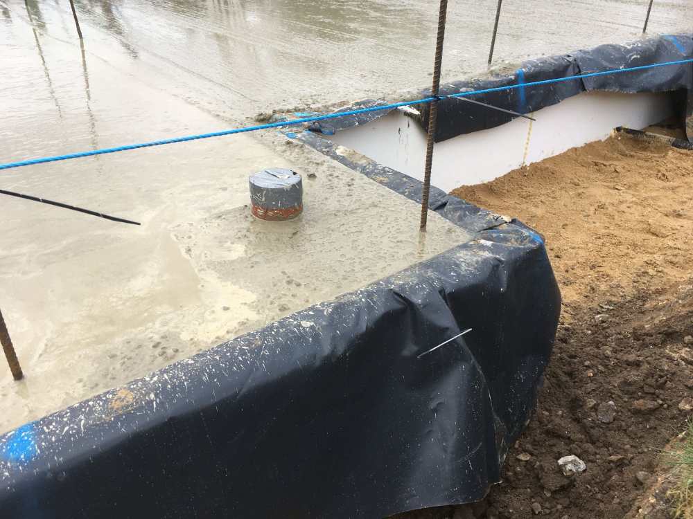

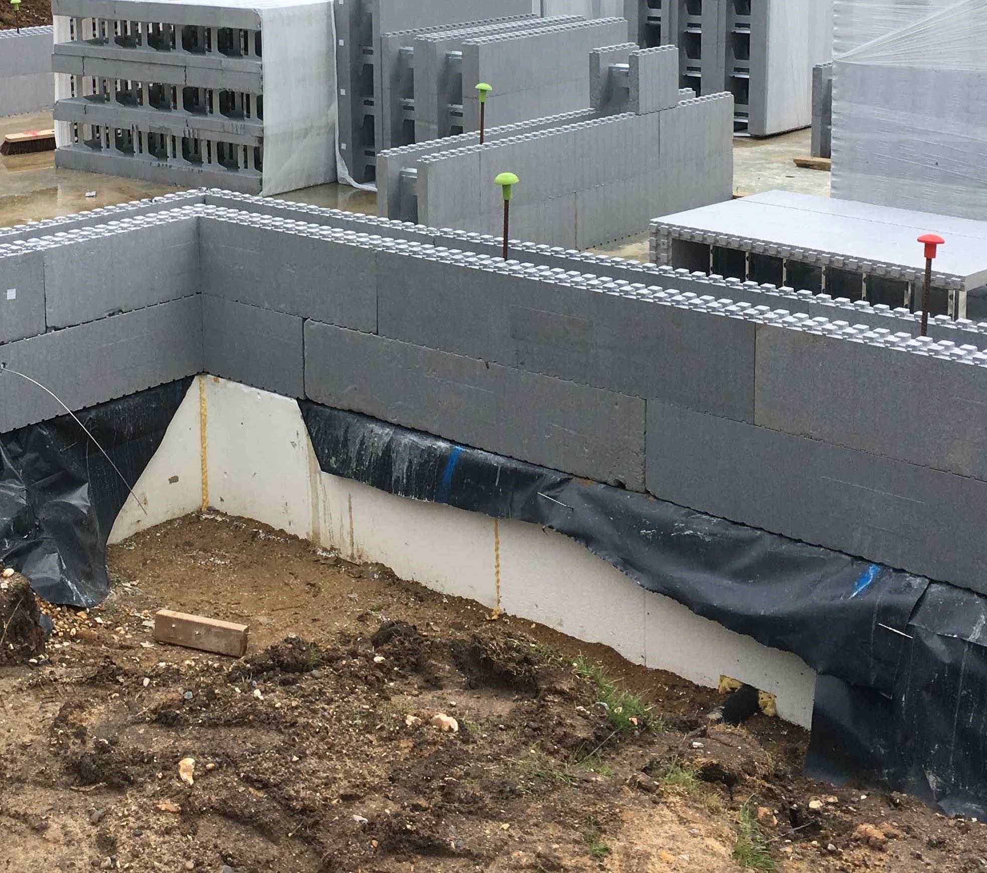

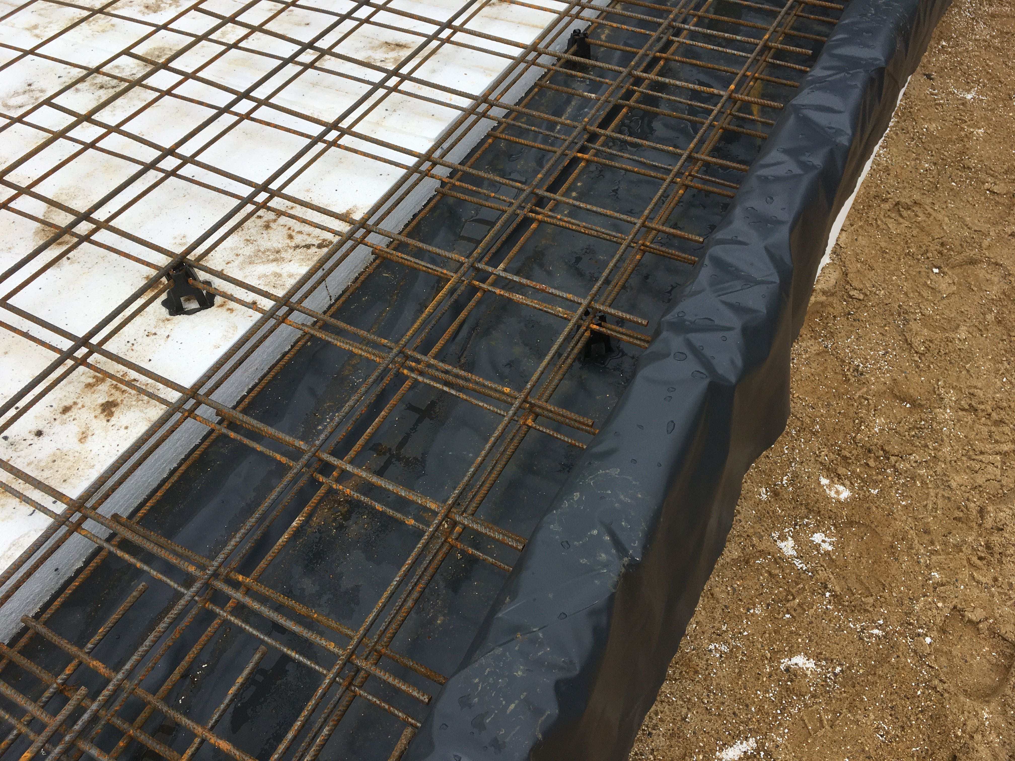

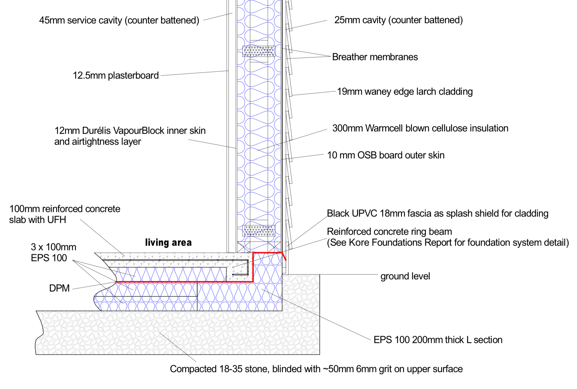

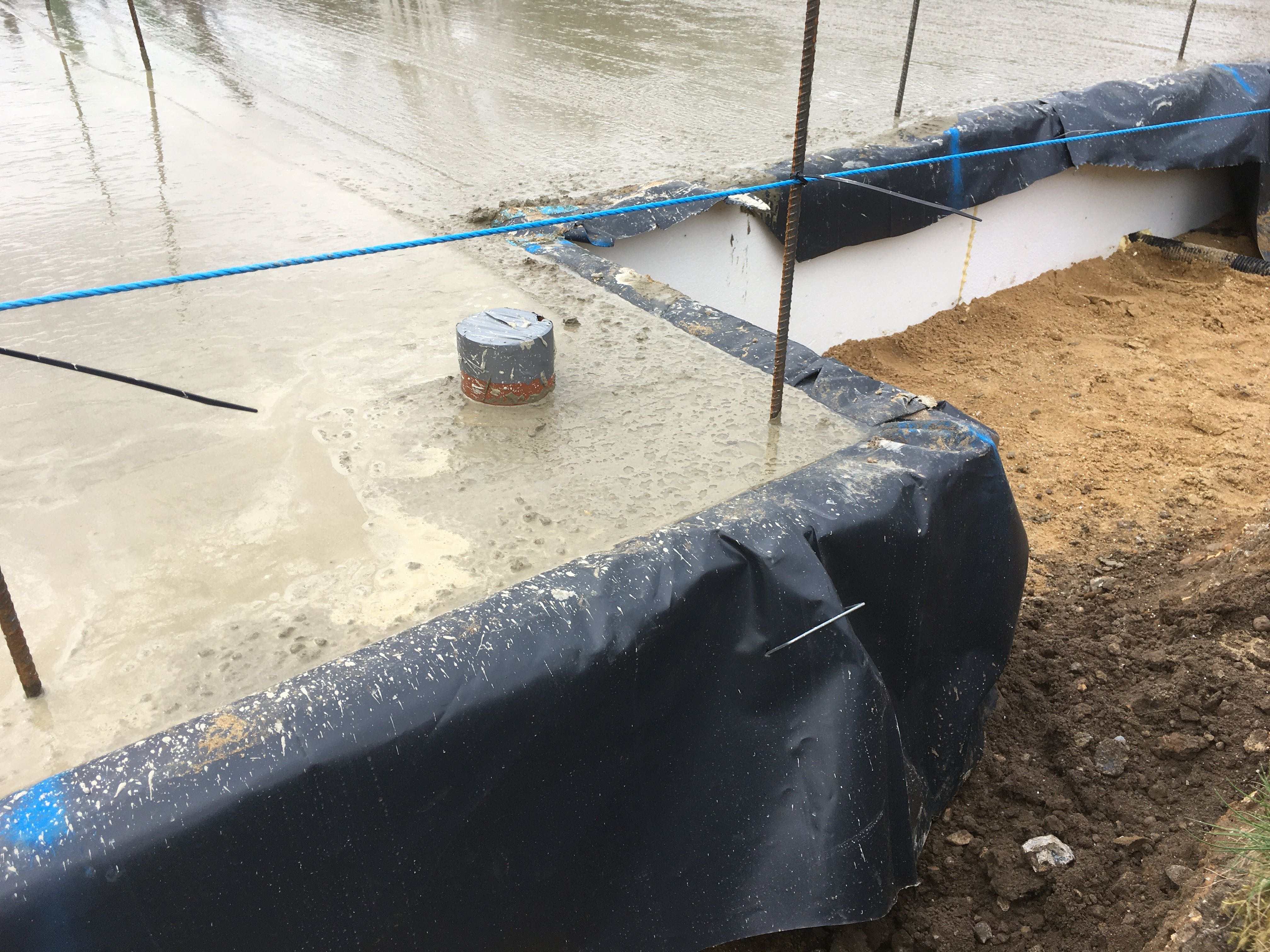

ChrisJ Posted March 27, 2025 Posted March 27, 2025 (edited) 1 hour ago, Nick Laslett said: Also on my build the vertical rebar connects the ground floor walls to the slab, then the first floor walls to the ground floor walls. Is that DPM on top of the concrete slab separating the wall concrete from the slab, or placed prior to the slab concrete and just run over the top edge of the KORE? Edited March 27, 2025 by ChrisJ
Nick Laslett Posted March 27, 2025 Posted March 27, 2025 (edited) 2 hours ago, ChrisJ said: Is that DPM on top of the concrete slab separating the wall concrete from the slab, or placed prior to the slab concrete and just run over the top edge of the KORE? Same spot on foundation pour day. You can see the DPM is still overhanging in this photo. According to my drawings you would put a second DPM strip under the ICF blocks before you start the wall. Not sure how necessary that is with ICF walls. Here is a close up. Before the concrete. Edited March 27, 2025 by Nick Laslett
Chanmenie Posted March 27, 2025 Posted March 27, 2025 5 minutes ago, Nick Laslett said: Same spot on foundation pour day. You can see the DPM is still overhanging in this photo. According to my drawings you would put a second DPM strip under the ICF blocks before you start the wall. Not sure how necessary that is with ICF walls. I think it’s normal to just lay the ICF blocks on the overhanging DPM, why add another one ? 1

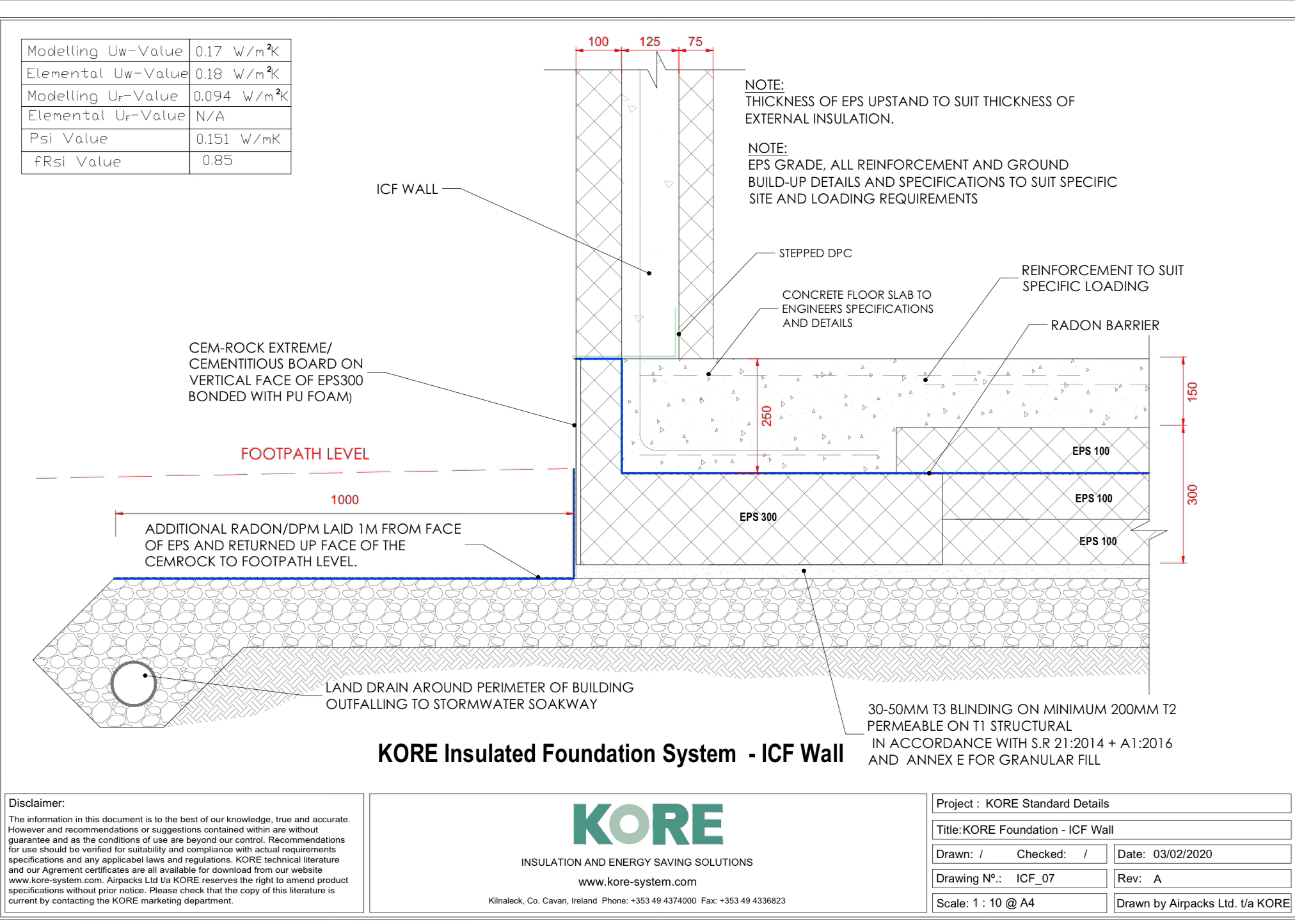

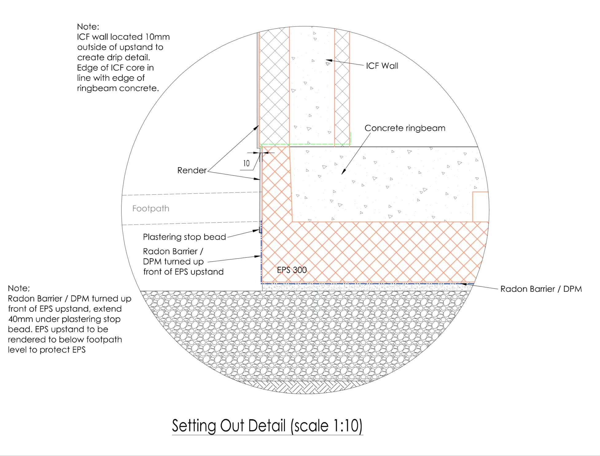

Nick Laslett Posted March 27, 2025 Posted March 27, 2025 19 minutes ago, Chanmenie said: I think it’s normal to just lay the ICF blocks on the overhanging DPM, why add another one ? I agree, I don’t think it is critical. Here is the generic Kore construction detail, see the small green line for DPC under ICF block.
SteamyTea Posted March 27, 2025 Posted March 27, 2025 7 hours ago, ChrisJ said: This post is to make you think and question nothing more Does rebar help with catastrophic failure? i.e. holds chunks of concrete together. When carbon fibre composites were first used as structural elements in vehicles, Kevlar was also put into the weave. Kevlar yield point was 'further up the scale' than CFs. Going back a bit further, when Kevlar was first used in composites, glass fibre was include. There were times that a very flexible weave called Diolen was used to hold all the bits together when failures happened. We had lots of failures when we first used more advanced composites back in the 1970 and early 1980s. Thankfully the knowledge base is huge now, back then there were only about 3 UK based companies doing it, and we're did not discuss our failures with each other.
Chanmenie Posted March 27, 2025 Posted March 27, 2025 1 hour ago, Nick Laslett said: I agree, I don’t think it is critical. Here is the generic Kore construction detail, see the small green line for DPC under ICF block. So how are you supposed to fold the DPC up into the ICF block ? Surely when you pour the concrete it’ll push it down. Seems overkill, especially with an EPS raft
Nick Laslett Posted March 27, 2025 Posted March 27, 2025 40 minutes ago, Chanmenie said: So how are you supposed to fold the DPC up into the ICF block ? Surely when you pour the concrete it’ll push it down. Seems overkill, especially with an EPS raft I don’t know, made no sense to me. Here is my construction detail from Tanner, the DPS under the ICF is a little different. The MBC crew did my foundation, you can see from my photos what they did. This is Jeremy Harris construction detail, he had an MBC foundation and timber frame. You can see that the DPC is consistent with my photos. I’m not trying to confuse or mislead with my posts about DPC placement. Building controls seem to be very touchy about this requirement. Please seek professional advice, don’t take my posts as advice. @ChrisJ, sorry if I have made things more confusing. 1

ChrisJ Posted March 28, 2025 Posted March 28, 2025 @Nick Laslett Your drawing makes sense to me, couldn't tell from your photo I don't agree with the DPM between the top of the slab and the wall, may as well just slather some butter on there as the bond will be the same @SteamyTea Yes rebar can help during catastrophic failure, I've seen it and allows time to safely secure and repair rather then no notice and someone die
