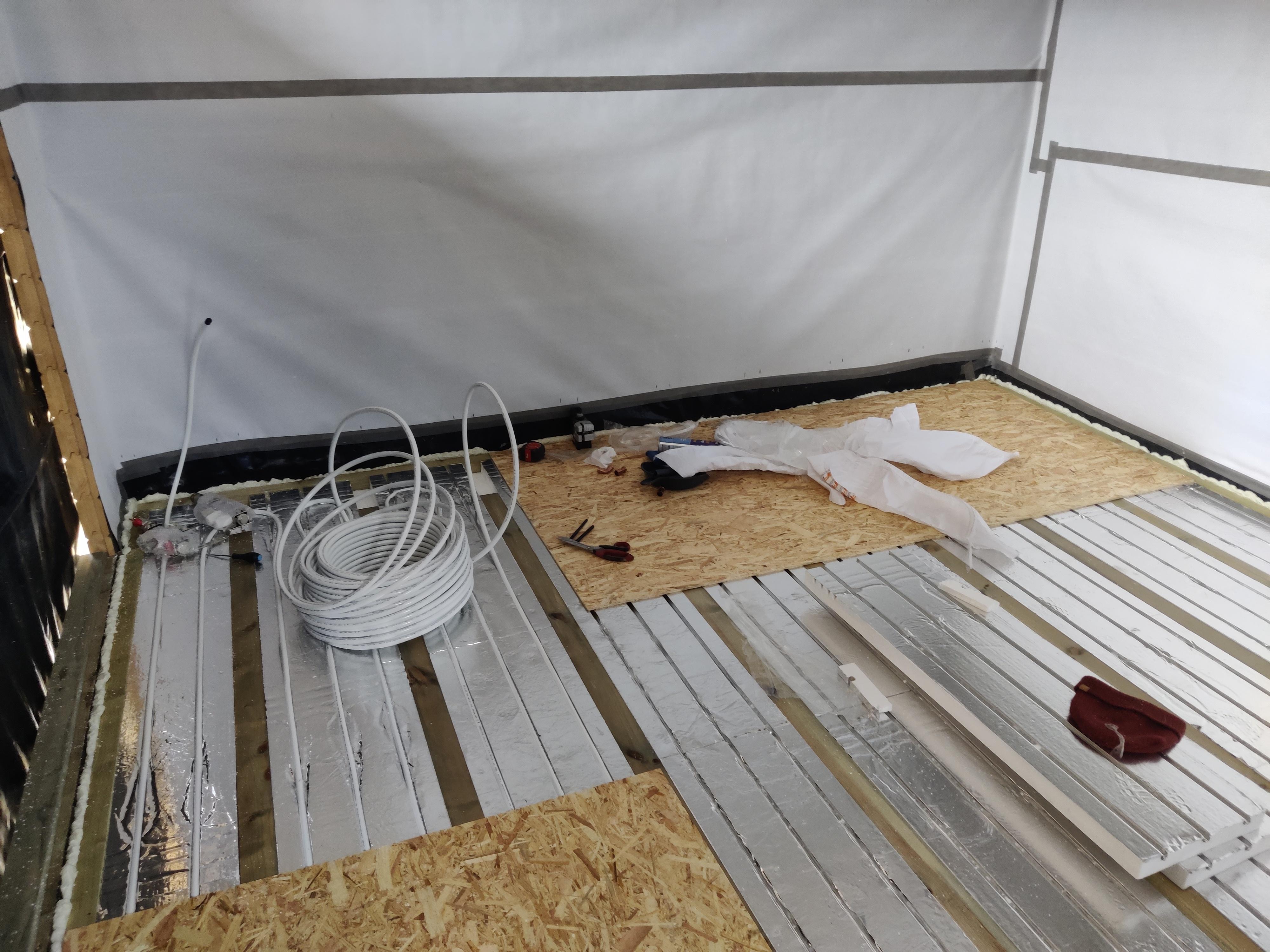

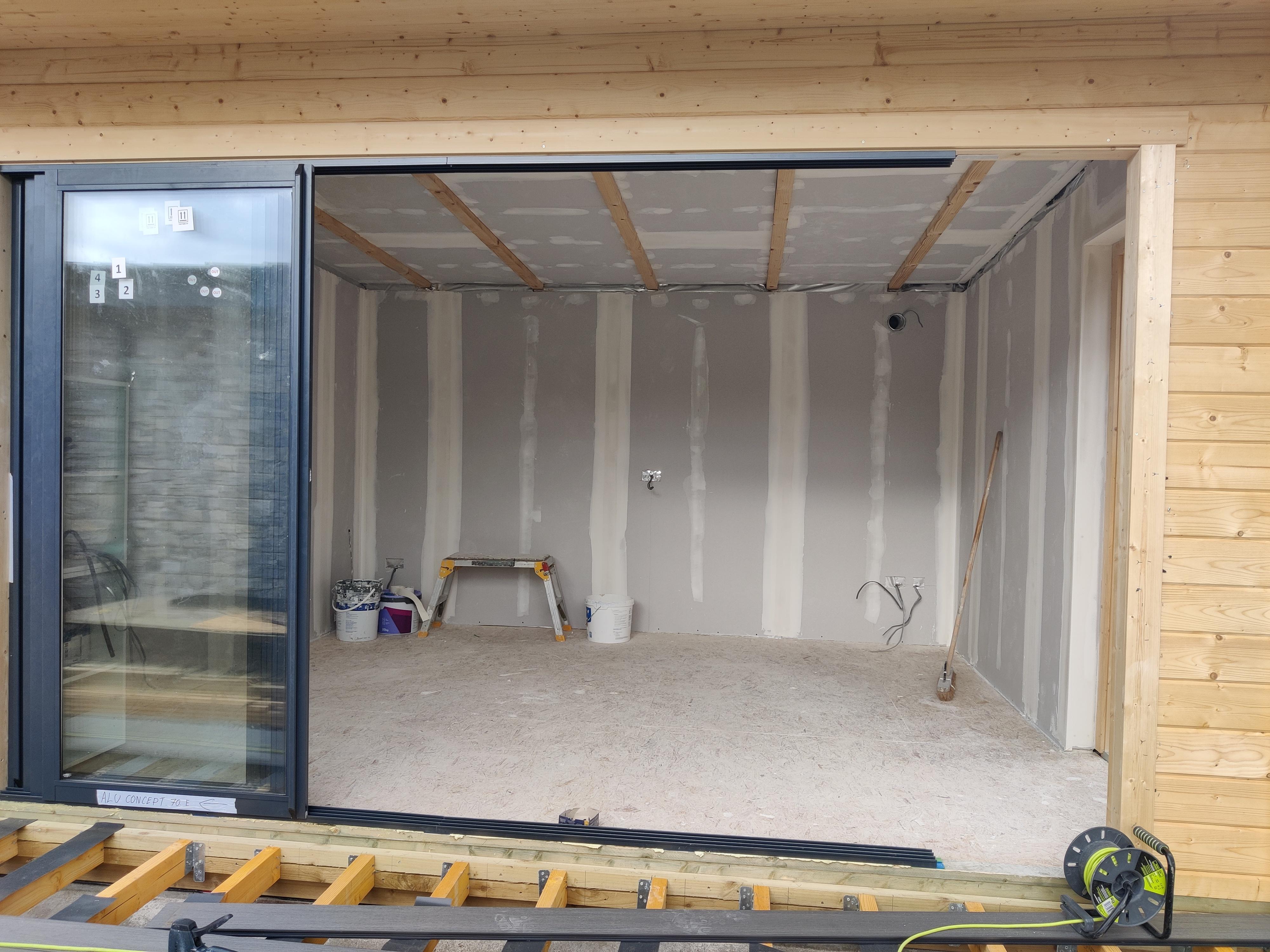

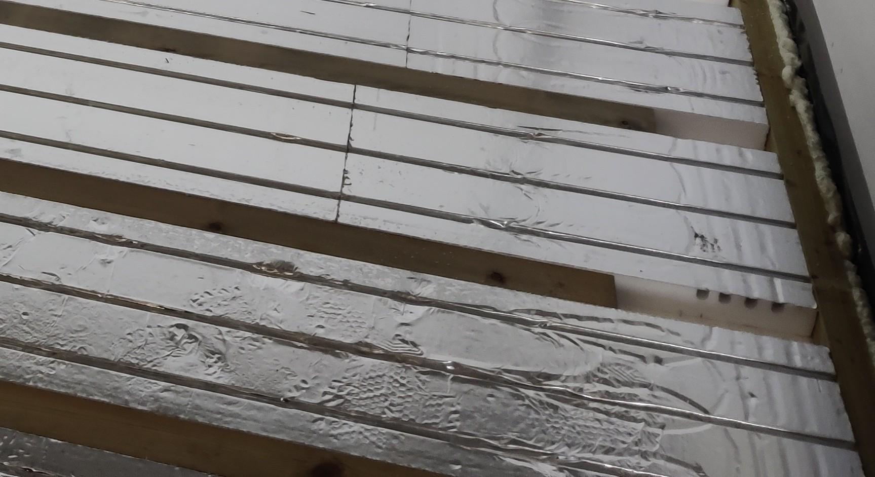

JohnMo Posted April 26, 2023 Posted April 26, 2023 9 hours ago, Iceverge said: gather from those who run low temp heating in low energy houses that you don't get a hot UFH under foot feeling either. Please write in with the answers subscribers ? @joe90 @TerryE @IanR@JohnMo to name a few. @ProDave @JohnMo has recently put UFH over insulation below 2 x layers of OSB floating. I am very interested in this approach. No wet trades. No crucifying hammering of your joints. Floor in main house 300mm centers on UFH, 200mm PIR and 100mm concrete screed. Measured on a cold day, 30 deg flow temp, floor surface temp was 22, room just under 20. Floor never feels hot underfoot, you never actually notice it. Our summer house floor is somewhat different buildup. 150mm EPS 70, 50mm thick UFH EPS moulds to give 115mm centres generally for the UFH. At 400mm centres above the EPS 70 there are 70mm wide wooden bearer. The whole lot is capped with 9mm OSB screwed to the bearers and a 50mm perimeter batten. A second layer of 9mm OSB is glued first layer (offset joint lines) and screwed through to the bearers/battens. Not got the UFH operational yet, but floor has a solid feel, and no comments from the wife, which is a good sign. 1

JohnMo Posted April 26, 2023 Posted April 26, 2023 1 hour ago, Iceverge said: Was this necessary? Would it not have just floated ok? I didn't want to hit UFH pipes, or have screws hanging below the bottom surface and over time scratching away the pipe. The screws would be less than 18mm long if I didn't screw to battens. Was a risk aversion based strategy
Iceverge Posted April 26, 2023 Posted April 26, 2023 Gottya. Looking forward to hear how the UFH performs
