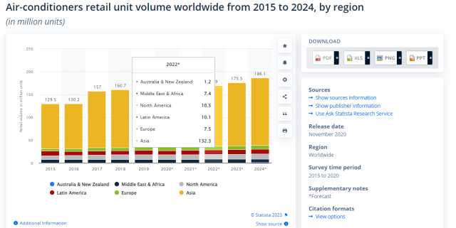

RichardL Posted April 25, 2023 Posted April 25, 2023 21 minutes ago, JamesPa said: Alternatively lets have some positive suggestions as to what we can do to get installed heat pumps in a retrofit situation down to, say, £4K The answer to that is way up in the thread - open the market to more than A2W, and for many smaller properties an A2A 2x inside unit multisplit will do the job of space heating. It even feels like normal heat - i.e. passes the 'I'm cold turn the heater on' => 'I'm warmer and the electric meter isn't going mad/cop 3+' Hot water then is the challenge - perhaps smart immersion (check the cones. on immersion vs A2W/built in cylinders) integrated with an open interface on the smart meter to trigger that heating at off peak - whatever that happens to be over time.

JamesPa Posted April 25, 2023 Author Posted April 25, 2023 (edited) 38 minutes ago, RichardL said: The answer to that is way up in the thread - open the market to more than A2W, and for many smaller properties an A2A 2x inside unit multisplit will do the job of space heating. In part I agree, although I'm not sure that the market discriminates against A2A). But it's a tough sell and won't suit properties with lots of rooms. Ideal for open plan I agree. Edited April 25, 2023 by JamesPa
