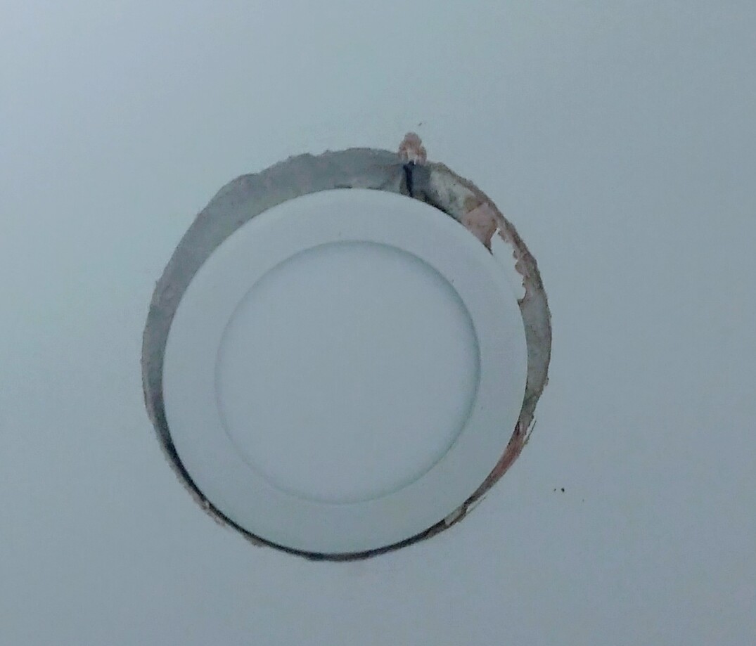

Just don't let some Terence H F***wit install them like this.
Did you have Stevie Wonder Electrical fit them ?!?
You could have cut them neater with a chainsaw. :(
Is that the 6w one? Can you fit the 9w one so it fills the existing hole, or is that one of many in the same view?

There are 5 x 9w lights here . The other 4, are mercifully, only badly fitted instead of horrifically fitted.
Unfortunately, this is 50mm insulated PB and above that there is 25mm then 100mm PIR so a suitable repair is not easy. Some hired spread we've found just wants to muck the light fitting in but I'm trying to come up with a more refined solution.

Depending on the make you should be able to get concealer / converter rings to sort this type of fubar:
https://www.downlights.co.uk/hole-concealer-jcc-fgled.html
What make are they btw?
(Should have got the bloke who laid the lawn to fit them! :) )
These are Enlite units. I rather suspect the hole is bigger than these concealer rings and the hole the fitting requires is bigger than the hole given.
I could get thin acrylic laser cut but I don't think I want to put flammable close to the light
I could get aluminium laser cut and painted but wonder if there is an earthing issue?
Either solution is bad for draughts if it is left in its current state underneath.

Get the Aurora spec for the light then look for something like this:
https://www.fastlec.co.uk/au-ap600w-aurora-85mm-145mm-downlight-adaptor-plate-white.html

Not sure they do them. The cutout on the 9w unit is 133mm the overall dia. is 145mm and clearly this fubar is about 160mm.
As Nick says, the least work option is to go bigger but I don't think the 12w light is big enough. I'd need to go to 18w and there's 4 more of these lights all in an L-shape on the ceiling.

It was actually David Blunkett's dog that fitted the light. He (she?) clawed and chewed the plaster away.

What's the problem... he's probably got shares in Polyfilla....

Get ali rings cut and have them powder coated with say Interpon HT or similar temperature resisting coating?
Either that or some very careful cutting to make plasterboard "Polos" to let in and skim flush.
