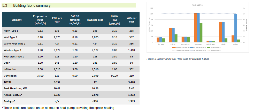

Our energy consultant (EC) has finally written his report and is recommending we install a 16kW ASHP.
Peak heat loss has been calculated at 10.41kW and the EC writes
Quote
This scheme relies upon an air source heat pump delivering 11kW of heat at -2.4°C. Heat pumps are often listed with the output at +7oC, because of the reduced output at lower temperatures we would usually recommend a larger heat pump, in this case 16kW, to ensure it meets the output at -2.4oC external temperatures, without the requirement for backup heating.
He's also recommending we pair it with 7.4kW of solar PV and 2 x Zehnder Q350 MVHR systems (Two due to issues running ducting).
We're planning to install fan coil units for active cooling because we're terrified of building a house that overheats in the uncreasingly hot summers.
400 litre HW tank
Planning to build in Isotex ICF if that makes any difference. Heating with UFH and intermediate floors will be built using Comfloor (i.e. concrete and screed)
Armed with this information I'm unsure of what the next steps are in actually selecting a heat pump and how the various elements tie in with one another (or not). Before I start engaging with potential installers/contractors I feel I need to know more so I can make informed decisions.
I'm open to general guidance and a bit of technical advice (preferably couched in layman's terms!). TIA

Our basement slab was just tamped level and a few bags of latex made it flat as a pancake for flooring. However it ranged from 10 to 2mm  - you'd need a lot more for UFH!
I would question if the consultant is just taking your money, he sounds to be adding zero value here.  Recommending 5m3/m2 and MVHR is just rubbish, wasting your time and more importantly your money. If you are not below 3m3/m2 on a new build with ICF walls something is well a miss with the build and as the consultant he should know that.  He should also know that MVHR with a leakage rate above 3 is not the smartest move and not recommended for optimal energy usage.
Making rubbish assumptions just makes heating systems bigger than they need to be.
Also the ASHP sounds well oversized.
That is again just bone idle, no leg work just throw away rubbish statements.
This is the first energy report I've ever read and I reckon that 90%+ is generic filler content like "What is a heat pump".
Does anyone have a copy of a good energy report that I can look at for comparison?

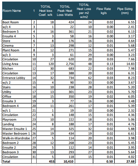

I've attached my EC's report if anyone wants to have a look Grey Cottage Renewable Energy Feasibility Study v1 .pdf
How accurate do you think this is?
If that's a question for me: I have no idea and wouldn't even know where to start.
Yes it is.
Working out heat losses is not that difficult, but it is very boring.
Basically a case of finding out all the wall, floor, window, doors and ceiling/roof thermal properties (the W.m-2.K-1), all the areas, and an assumption of the weather extremes, as well as any temperature differences between rooms.  Then the power loss from the air changes has to be added, and adjusted for the MVHR.
Then the water usage is added, but you can probably work that out pretty well from current usage.
There is a spreadsheet floating about that is pretty accurate.  Search for @Jeremy Harris as he created the spreadsheet.
They're a muppet.
They're all rated differently.
Some rate at air +7/water 35
Others rate at air -7/water 55
And the output from the same unit at air -2 will be very different if your heating system runs at 35 Vs 45 Vs 55C
(e.g. a "7kW vaillant unit running a 45C flow temperature at -2C air actually provides 9 kW output)
Oversizing results in a cluster fudge in operation.
You need one that'll meet your design heat load at your design flow temperature.
Given the "chuck in 16 because it might be rated at 7C" shows such a lack of understanding or at least attention to detail that I wouldn't trust a word they say on heat pump selection OR indeed the heat loss calculation/heating system design to suit the heat pump sorry.
Better to ask a professional rather than somebody out of their depth before they make some expensive bad commitments on your behalf.
We got under 2.5m3/m2/hr in a refurb of a 19th century house with all sorts of issues and I was a bit disappointed that we did not get better. I would be really disappointed with 5 on a refurb, let alone a new-build.
Depending on what the consultant knows about your knowledge I'd have expected simple things like explaining what a solar diverter is, but also looking more broadly at air-tightness, explaining what can be achieved and why you want it, and so on.

Based on slightly better than Building Regs level performance data, the proposed 16kW ASHP seems about right for a 420m² house.
Of note is the caveat on your "Building fabric summary" image in your first post "*These costs are based on an air source heat pump providing the space heating.". So the 6332kWh annual figure quoted is the electricity to run the heat pump, equates to 21,044kWh of annual energy loss through the fabric and ventilation.
You therefore have a 50.1kWh/m² annual energy loss.
Is this planned to be a long term home? If so you are saddled with these energy losses for the time you own the home. I personally would be looking for cost effective ways of reducing this figure. 15kWh/m² annual energy loss is an achievable target.
Going for the 0.12 U Value wall option for instance.
The stated air tightness target of 5m³/h.m²@50Pa is really quite poor. Your EC shouldn't be suggesting an MVHR system at that level as it will bring no benefit, just cost a load to Install, run and maintain. MVHR's come into their own at 3m³/h.m²@50Pa, and are best at 1m³/h.m²@50Pa or lower.
If this is your long term home I'd suggest targeting 1m³/h.m²@50Pa. You describe the property as having some large double volume areas, in those circumstances you'll find that good air tightness considerably lowers your energy losses.
If you are to target 1m³/h.m²@50Pa air tightness, then I'd research your chosen ICF. I've not looked into ICF much but the feedback I've picked up from this site, on wood-concrete ICF blocks, is that there is a lot of work involved in getting good airtightness from them. Maybe there are alternate ICF solutions that will make the job easier.
If you can target better energy performance from the fabric of the building, then rather than the space heating requirement driving ASHP it will become DHW. You've specified a 400l UVC, I'd say that's the minimum size you should go with for the size of property, or perhaps a 500l. If you are heating the hot water via an ASHP you need to be able to store the water at 50°C or less to keep the ASHP efficiency at a reasonable level, so you need a greater volume of 50°C water than if you were heating it to 65°C.  With large UVC's, you then need to watch your re-heat times. ie. you may get your space heating down to just a 6kW requirement, but you may still want to specify a 9kW - 12kW ASHP for better UVC reheat times.
My own property is a similar size to yours, my heat loss is calculated at 15kWh/m² per annum, but has come in at around 12.75kWh/m². At today's prices that's around £535 per year for space heating which is a £1,700 per annum saving on your current performance targets. Index linked over 20 years gives a reasonable budget for performance improvements at the build stage.
