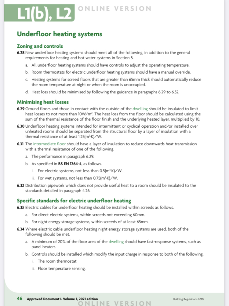

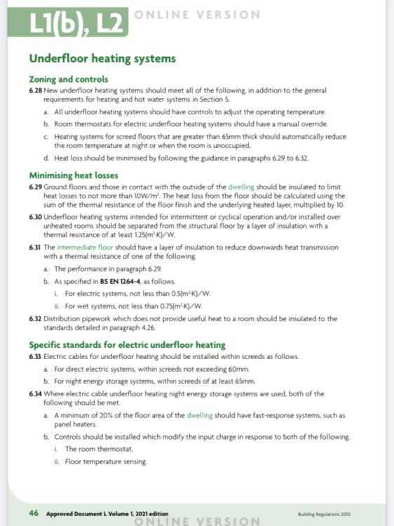

ADLIan Posted March 29, 2023 Posted March 29, 2023 Under the 2021 version of Approved Doc L intermediate floors with heated floor systems require thermal insulation (as well as acoustic requirement). 1

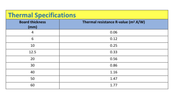

MikeGrahamT21 Posted March 29, 2023 Posted March 29, 2023 4 hours ago, ADLIan said: Under the 2021 version of Approved Doc L intermediate floors with heated floor systems require thermal insulation (as well as acoustic requirement). Just checked this and yeah you’re right, a very bizarre specification but here it is and the corresponding thickness of XPS showing R value so assuming this is wet underfloor heating, it’ll need around 25mm XPS, which should be doable with 20mm PIR. can’t quite get over that requirement, as it’s all inside the thermal envelope 🤷♂️
Dave Jones Posted March 30, 2023 Posted March 30, 2023 (edited) yes this is a little barmy but 30mm of EPS will help with sound transmission I guess, just need to allow for the FFL on intermediate floors now as well... or put the pipes in without insulation and just dont connect them at manifold. sign off then re-connect. Edited March 30, 2023 by Dave Jones
