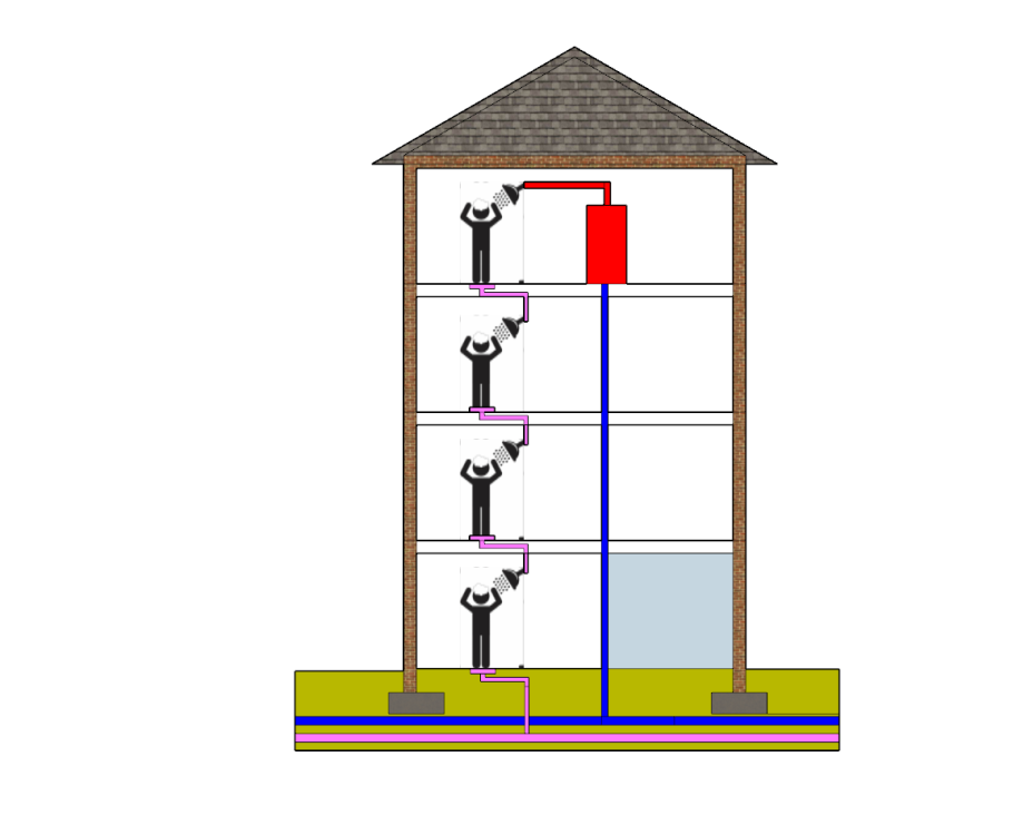

Dave Jones Posted March 8, 2023 Author Share Posted March 8, 2023 this is the waste water heat recovery unit im planning on using. basically plumbing all the shower wastes to it. https://recoupwwhrs.co.uk/documents/Recoup_Pipe_HEX_Be-Technical_Specification.pdf Link to comment Share on other sites More sharing options...
Iceverge Posted March 8, 2023 Share Posted March 8, 2023 In fact scrap that, have a dedicated UVC for the showers for the "cold feed" that is full of water preheated to ~ 30deg by the drain water. Your normal UVC @50deg+ will last for ages when blended with almost warm enough water then. Link to comment Share on other sites More sharing options...

jack Posted March 8, 2023 Share Posted March 8, 2023 3 hours ago, Dave Jones said: this is the waste water heat recovery unit im planning on using. basically plumbing all the shower wastes to it. https://recoupwwhrs.co.uk/documents/Recoup_Pipe_HEX_Be-Technical_Specification.pdf I don't believe any domestic waste water heat recovery unit is rated to cope with four showers. The one you linked recommends a maximum of 24 L per minute (total) for system types B and C, and only 16 L per minute (less than one of your showers) for system type A. 8 hours ago, Dave Jones said: Coming from limitless hot water I'll need to keep adding tanks until it doesn't run out from our usage pattern. If you want to "save the planet" as you say, then why not use this opportunity to change your family's usage patterns rather than just replicating the current pattern in the new place? Assuming you have kids who are using at least a couple of these simultaneous showers, then the flow rate is ultimately up to you. A few weeks ago I installed flow restrictors on our kids' showers to limit them to 9 L per minute (down from about 12 or 13 L max per minute beforehand) and the showers work perfectly fine. Not sure the kids have even noticed - I didn't tell them and they haven't mentioned it. 6 hours ago, Dave Jones said: agree ref shower its a preference as there is no shortage of water in the UK. Depends very much where you are in the UK. There have been hose pipe bans in the south east more than once in the last decade due to water shortages. Link to comment Share on other sites More sharing options...
Dan F Posted March 8, 2023 Share Posted March 8, 2023 Just now, jack said: I don't believe any domestic waste water heat recovery unit is rated to cope with four showers. The one you linked recommends a maximum of 24 L per minute (total) for system types B and C, and only 16 L per minute (less than one of your showers) for system type A. Some can do 2 showers, but (especially if the shower flow rate is high) one per shower is the way to go. That said, looks like Showersave have a commercial option which might be worth looking at: https://www.showersave.com/commercial-new/ Link to comment Share on other sites More sharing options...
jack Posted March 8, 2023 Share Posted March 8, 2023 7 minutes ago, Dan F said: Some can do 2 showers, but (especially if the shower flow rate is high) one per shower is the way to go. Two showers at once would be extremely unusual in our house, so having two connected to one unit (from memory we have the recoup unit linked above) isn't an issue, especially given the flow rate of each shower is less than 10 L per minute. Link to comment Share on other sites More sharing options...
