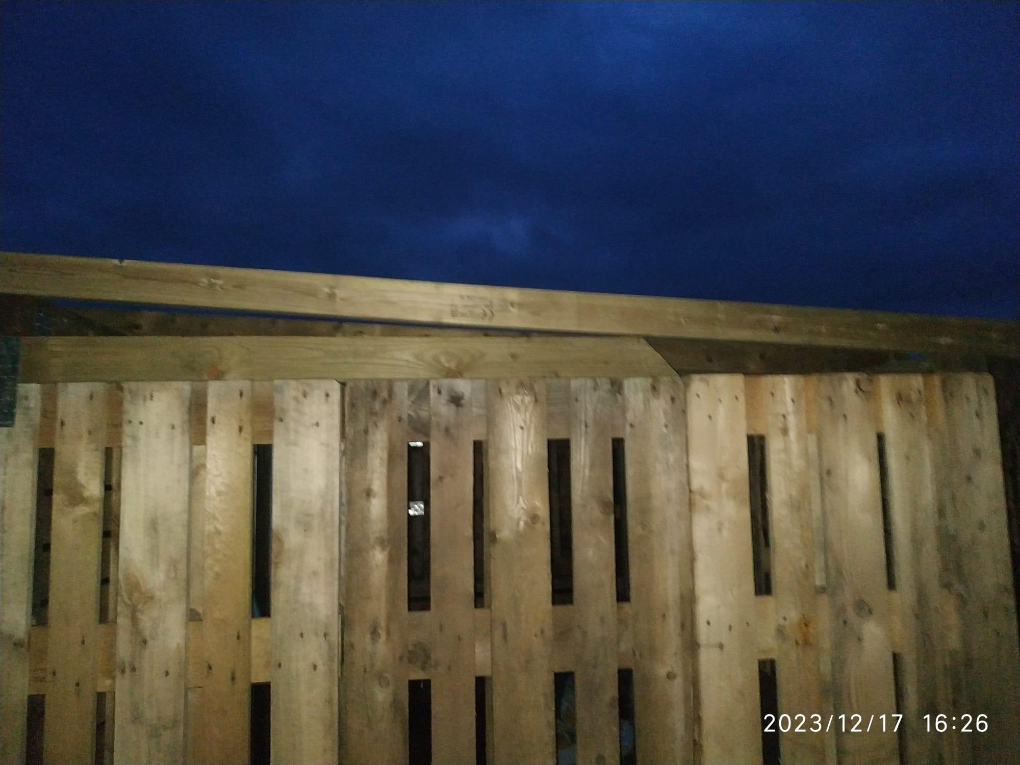

JohnBishop Posted December 17, 2023 Author Share Posted December 17, 2023 Hi Gents, Do I need birdsmouth cuts at this low angle? Link to comment Share on other sites More sharing options...
markc Posted December 18, 2023 Share Posted December 18, 2023 6 hours ago, JohnBishop said: Hi Gents, Do I need birdsmouth cuts at this low angle? Nope, at very shallow rafter pitch a birdsmouth would do nothing except weaken the timber. 1 Link to comment Share on other sites More sharing options...
Onoff Posted December 18, 2023 Share Posted December 18, 2023 9 hours ago, JohnBishop said: Hi Gents, Do I need birdsmouth cuts at this low angle? What are we looking at, the side of the shed with the roof set at a fall? Only thing I might do is face the "4x2s" or whatever they are with ply, brought flush to the face of the pallets. A birdsmouth I think stops the rafter slipping of the wall plate. Glue some wedges in there maybe then screw down with long screwd? 1 Link to comment Share on other sites More sharing options...
Canski Posted December 18, 2023 Share Posted December 18, 2023 or fix with truss clips 1 Link to comment Share on other sites More sharing options...

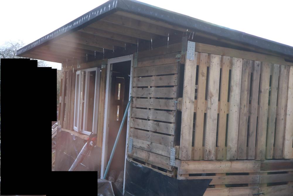

JohnBishop Posted December 18, 2023 Author Share Posted December 18, 2023 (edited) Hi Gents, Thanks for coming back to me. I have bought some truss clips but then I saw a video where a pro said to use hangers because apparently with winds 50+mph it can rip the roof open. On the other hand I want to leave that ridiculously long overhang in front of the shed. The Shed is 2.4m deep, timber is 3.6m long, 30cm overhang at the back so 90cm overhang in front. I admit that the location can be windy at times, it is exposed, the wind usually hits from west to east (there is a 5m tall hedge on the eastern side) so the slope raises from west to east. Or I could use a combination of both just to be safe or use jiffy hangers on every other joist. https://www.screwfix.com/p/sabrefix-jiffy-hangers-50mm-x-275mm-10-pack/60964#product_additional_details_container Edited December 18, 2023 by JohnBishop Link to comment Share on other sites More sharing options...
Onoff Posted December 18, 2023 Share Posted December 18, 2023 You could perhaps loop some builders band over the rafters and bring down the inside face of the pallets? 1 Link to comment Share on other sites More sharing options...
Onoff Posted December 18, 2023 Share Posted December 18, 2023 When I did the pallet shed with the nephew we fitted a 4x2 wall plate to the top of the pallet walls. From memory we in effect infilled the top. Link to comment Share on other sites More sharing options...

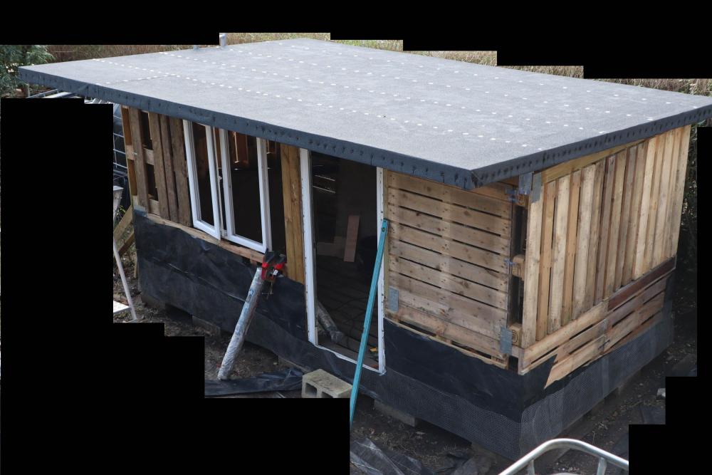

JohnBishop Posted December 24, 2023 Author Share Posted December 24, 2023 (edited) What is the recommended overlap of the felt on a roof with that low angle? Is it like a 1.5 foot or something? I am going to use OB1 sealant to seal the layers of felt https://www.screwfix.com/p/ob1-multi-surface-sealant-adhesive-clear-290ml/434jf Edited December 24, 2023 by JohnBishop Link to comment Share on other sites More sharing options...
JohnBishop Posted December 26, 2023 Author Share Posted December 26, 2023 (edited) According to IKO the overlap should be between 50-75mm but on Youtube Carpenter's Daughter felted a low slope roof and the overlap was more than a foot. They didn't use the adhesive but nails and the sealant/adhesive from a tube. To me using the adhesive from a can looks like a mess. I would rather go the nails + sealant/adhesive route. I went for this more expensive IKO Super Green Shed Felt. What do you think? Edited December 26, 2023 by JohnBishop Link to comment Share on other sites More sharing options...
Onoff Posted December 26, 2023 Share Posted December 26, 2023 Stuck my shed felt down in 2019. 2021: 1st layer was sand felt, nailed on. Second green mineral layer was stuck down with trowelled on felt adhesive. As you can see there are no nails. No lifting etc. 1 Link to comment Share on other sites More sharing options...

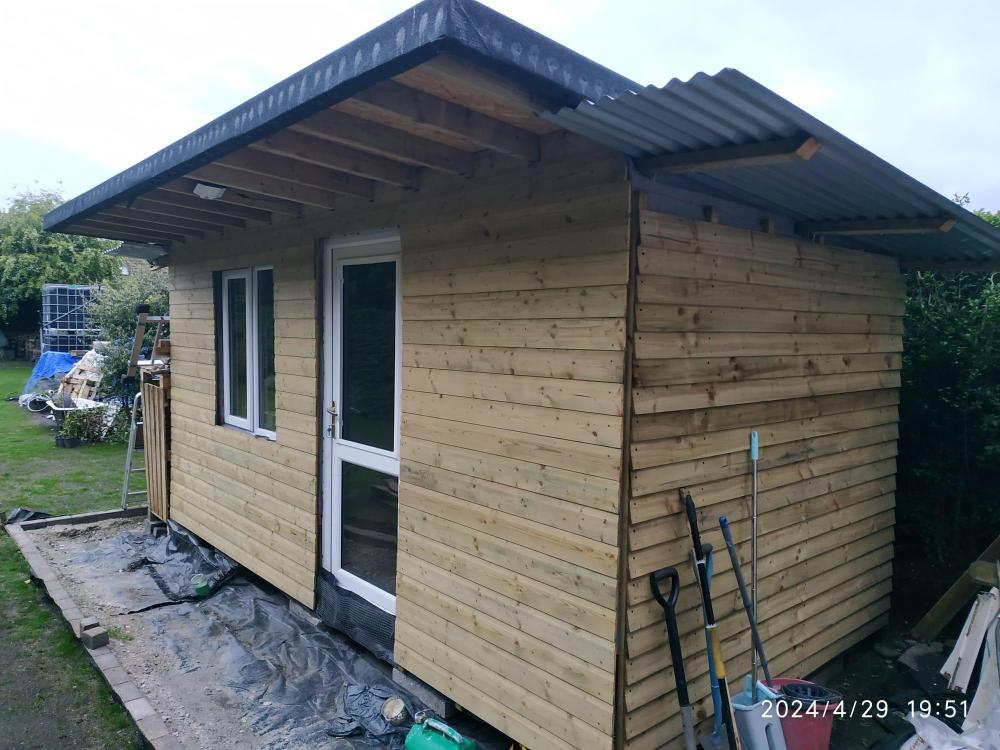

JohnBishop Posted December 31, 2023 Author Share Posted December 31, 2023 (edited) Gents, considering that this shed is built from pallets that have gaps not plywood sheets do I need battens after I attach the breathable membrane? Edited December 31, 2023 by JohnBishop Link to comment Share on other sites More sharing options...
Onoff Posted December 31, 2023 Share Posted December 31, 2023 8 hours ago, JohnBishop said: Gents, considering that this shed is built from pallets that have gaps not plywood sheets do I need battens after I attach the breathable membrane? That's what we did. It'll make it easier to put your cladding on, regular fixing points etc. We used a combination of tile battens and some fresh timber milled to the same size from the chap who gave us the cladding (literally offcuts from milling the trees). Staple your membrane on. I've a couple of this sort though Parkside ones from Lidl: https://www.ebay.co.uk/itm/374194279817? With a helper roll it out along a side, watch you keep the bottom level to whatever line you're finishing at. Staple top left. Then with the helper holding the roll staple bottom right. Stapling on the diagonal will keep it taught. Staple here and there. Cut the membrane and fold/staple into any window & door reveals. You'll want a horizontal batten top and bottom to try and prevent insect and vermin ingress. Then do vertical battens (between the top and bottom ones) and cladding. Got any pictures yet? 1 Link to comment Share on other sites More sharing options...
JohnBishop Posted December 31, 2023 Author Share Posted December 31, 2023 5 hours ago, Onoff said: That's what we did. It'll make it easier to put your cladding on, regular fixing points etc. We used a combination of tile battens and some fresh timber milled to the same size from the chap who gave us the cladding (literally offcuts from milling the trees). Staple your membrane on. I've a couple of this sort though Parkside ones from Lidl: https://www.ebay.co.uk/itm/374194279817? With a helper roll it out along a side, watch you keep the bottom level to whatever line you're finishing at. Staple top left. Then with the helper holding the roll staple bottom right. Stapling on the diagonal will keep it taught. Staple here and there. Cut the membrane and fold/staple into any window & door reveals. You'll want a horizontal batten top and bottom to try and prevent insect and vermin ingress. Then do vertical battens (between the top and bottom ones) and cladding. Got any pictures yet? Ok. Thank you. Did you stain your battens with anything? I have seen a man staining them with some green stuff and on the cuts he stained with some black stuff. Will add some more pictures soon. Link to comment Share on other sites More sharing options...
Onoff Posted January 1, 2024 Share Posted January 1, 2024 8 hours ago, JohnBishop said: Ok. Thank you. Did you stain your battens with anything? I have seen a man staining them with some green stuff and on the cuts he stained with some black stuff. Will add some more pictures soon. Yes the battens were painted with a dark brown wood preserver. The tile battens and the fresh cut ones. Get a couple of trestles or tarp on the ground and paint them all at once by pushing all the battens together. Paint one face of each, turn each one 90deg, push back together and repeat. I'm debating even painting the palets themselves if I do one. 1 Link to comment Share on other sites More sharing options...
