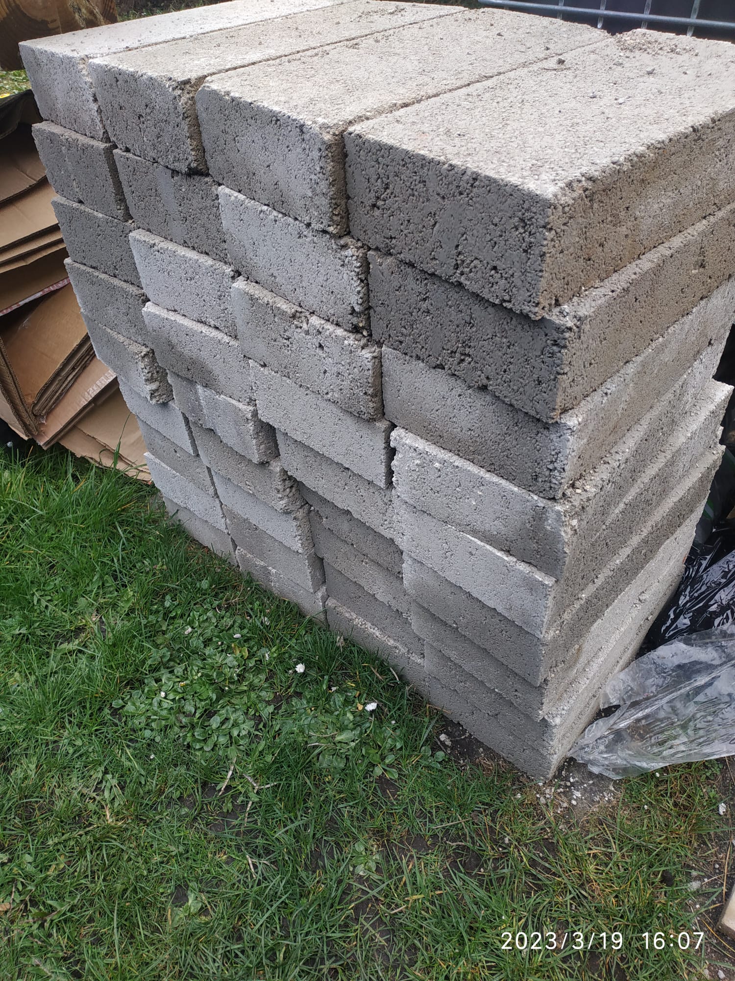

I have some Tarmac 3.6N blocks but these are not good for support. I think they disintegrate in a matter of months.

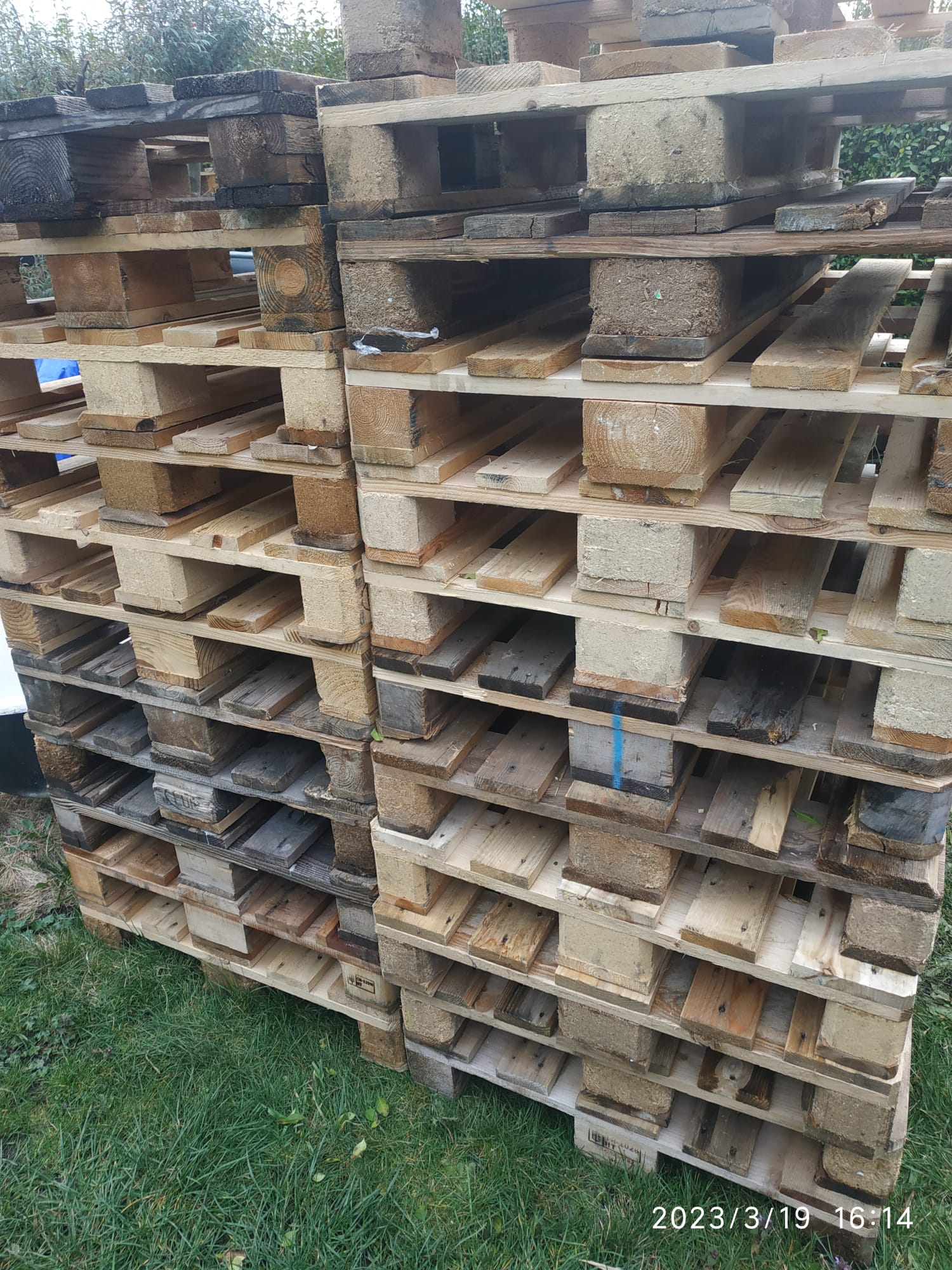

Did he bolt these pallets together?
I am still thinking how to connect them up properly but then I don't want to waste another $1000 on some expensive screws/nuts.
Screwed together.
I've a stock of low grade, M10, nuts and long bolts here. It's what I'll use. Covered in grease probably.
14 hours ago, Onoff said:
Screwed together.
right but this will require like 25cm long bolts, is it? I have to screw these cubes together.
probably cheaper to cut up some threaded bar or to use coach bolts that using an engineering type bolt. its not like you need grade 8.8 or above for a shed.
Yes, I'm lucky to have lots of them about that length. Only thing is my ones are black. They were used to secure cable drums together. If I didn't have these I'd buy the cheapest, zinc plated studding.
Top left corner of the pallets, you can see the one of the M10 bolts and the 50x50 square, M10 galv washer used to secure the corner together.
2017-08-05_11-54-46
Before putting the next level of pallets on, you slip in "uprights" the same width as the existing pallet uprights. Gave them sticking up and screw to them through the top and bottom pallet.
I have seen this video on YT:
This man just screws these Euro pallets with long wood screws. I mean Euro pallets are extra strong. I think he didn't put a DPM or a net like you suggested but anyway. I think Euro pallets for the floor is a good idea but for the walls I think it's an overkill. The end product is a quite thick wall.

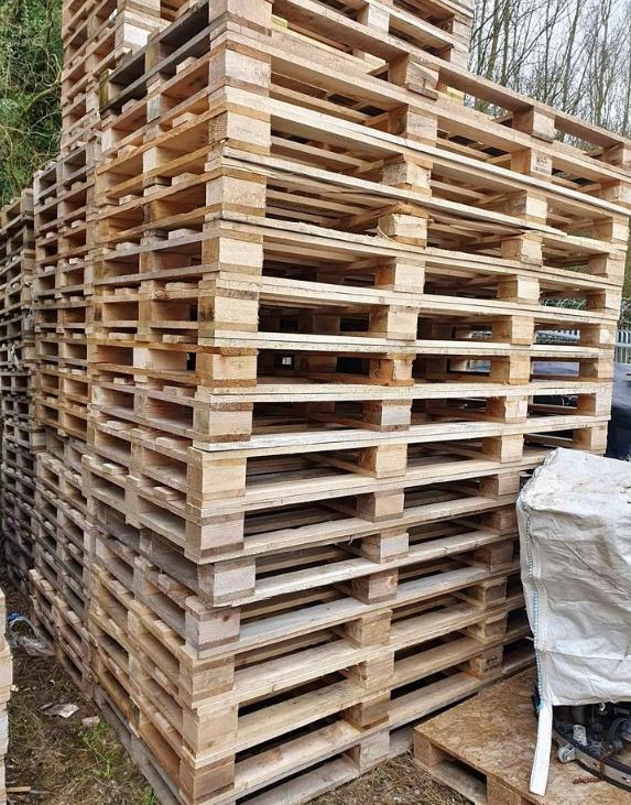

I found a local supplier of these pallets:
I think these are the same ones your friend used.
No pallet has been created equal. Some have wooden 50x50 cubes some have some OSB. Does it matter much?
These are the ones I have:
Can I use these blocks
for support or should I get solid dense 7N blocks?

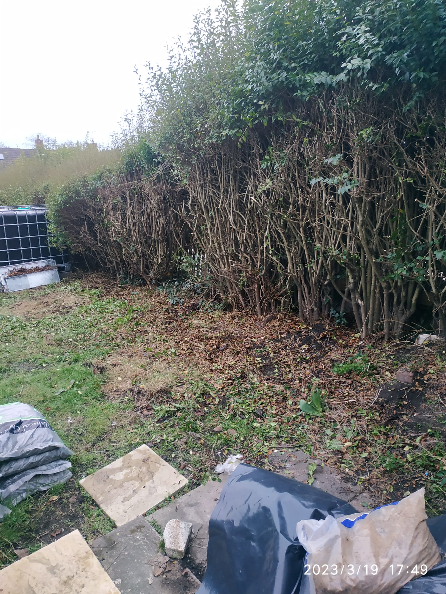

Before I put anything I still have to
level the area which will require removing some earth and trim the hedge further.
I was
considering building a roof to accommodate future PV panels but the 36 angle is still too steep for a shed's roof especially if I have to fit everything under 2.5m.
Lastly what is this regulation that the building has to be built of "substantially" fireproof materials?
"ie built of steel / concrete / brick and mortar with or without a timber frame... the roof CAN be built-up roofing felt (NOT simple nailed on shed roofing felt (its not thick enough unless layered felt with bitumen "glue" between layers))"
Obviously sheds are not fireproof.
Edited by JohnBishop

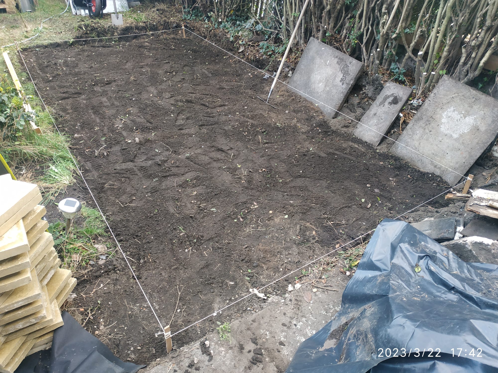

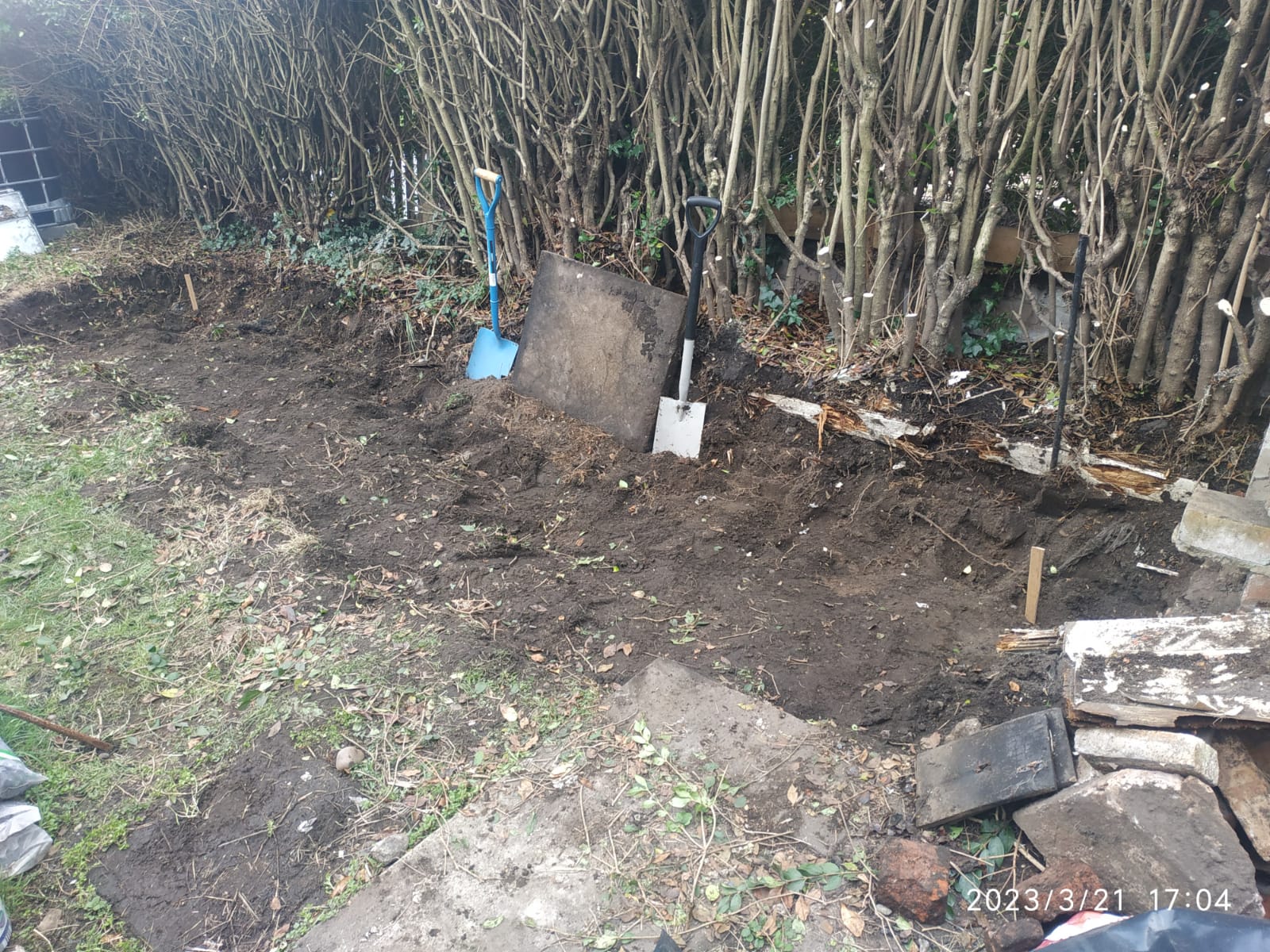

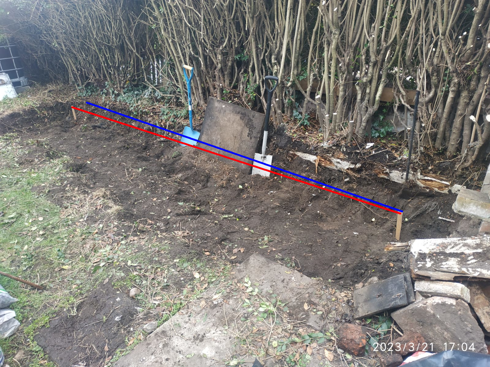

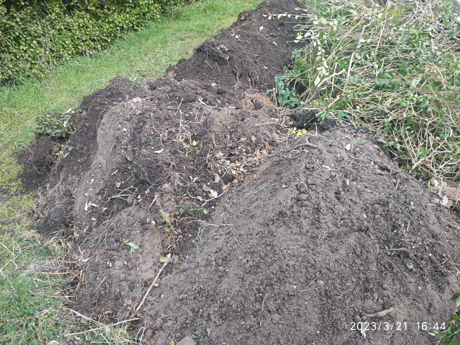

I have dug out some earth in attempt to level the area. Over the years the dead matter has accumulated next to the hedge.
I have removed more than I need but I will be moving the soil from left to right to level it out.
The hedge will require more pruning if I want to work around the shed.
Someone put like doors or door frames what have rotted out by now.
The size is going to be 3 Euro pallets by 4.
So 3x80cm by 4x120cm
so 240cm by 480cm = 11.52sqm
The angle has to be adjusted because with the red line the shed won't be straight to the house. I lean against the wall of the house and I can see that's off by few degree.
It has to be more or less with the blue line so more digging. Possibly the boundary is not in line with the houses.
I have about 9 of these large and thick slabs. I think I am going to use them to support the whole structure.
I would like to move the shed a bit away of the boundary but there is a tree stamp sticking out(not on the picture) and I won't be able to fit 3 pallets 240cm wide.
Once moved it's a lot more earth.
Is there anything else I should do to protect the building vs the hedge?

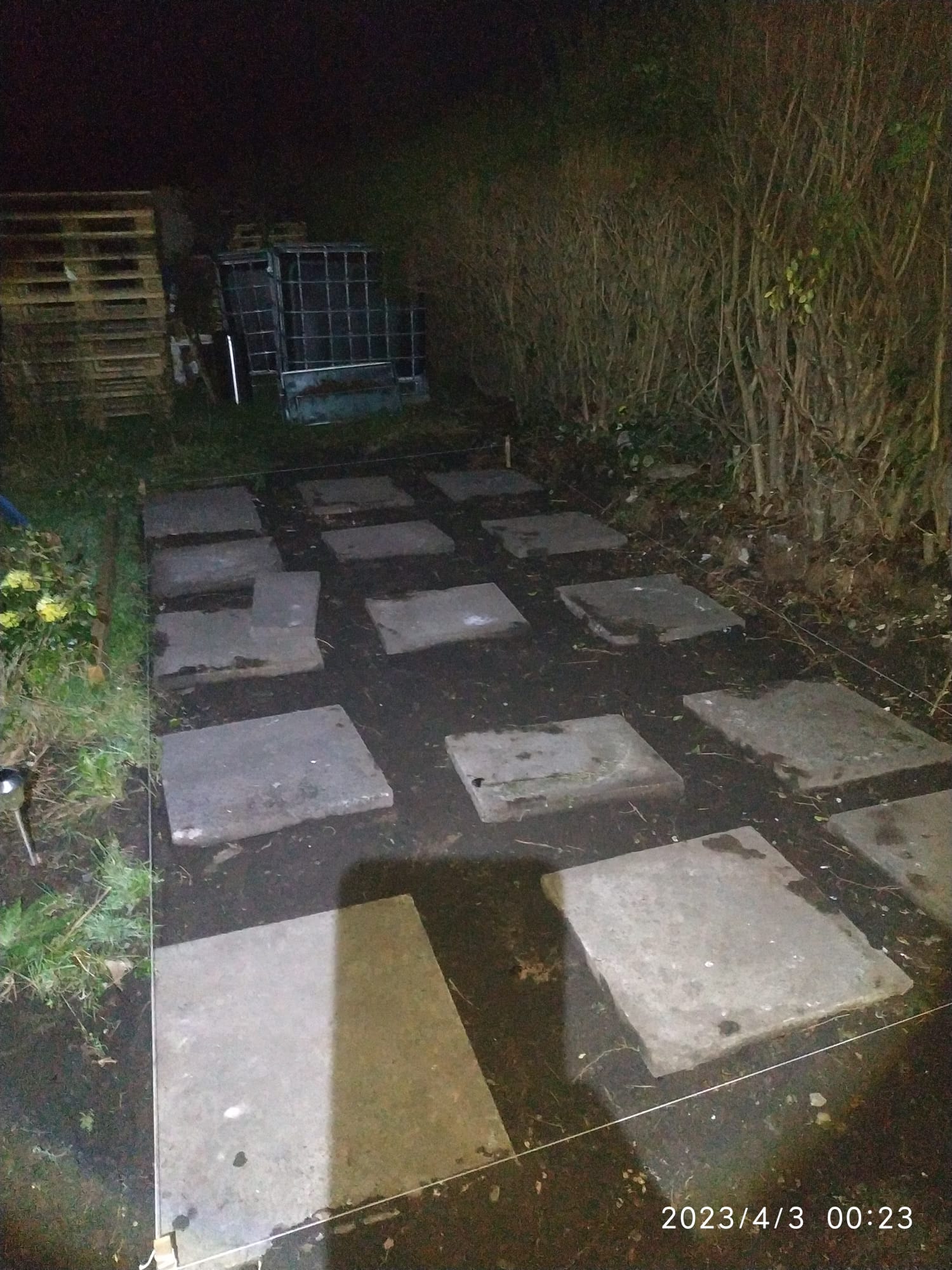

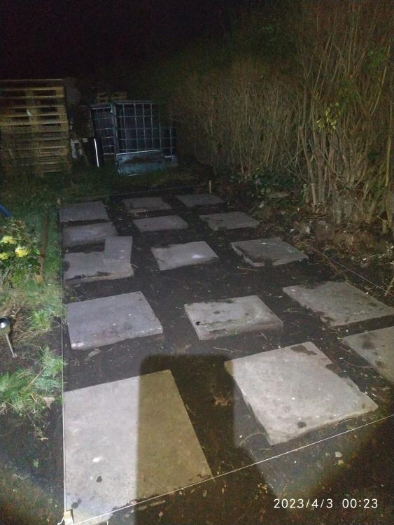

The following day I have levelled the area.
As you can see I have few of these thicker council slabs. These will go to the corners and sides first and then I cover the rest with yellow ones.
Before I lay them down I cover the area with antiweed membrane.
The question I have if these 13mm nets are sufficient and which one should I pick:
Wickes 13mm Galvanised Wire Netting - 600mm x 10m
Wickes 13mm Garden Cage & Aviary Galvanised Wire - 900mm x 6m
The net will go under the DPM and pallet. I lit both DPM and the net high enough I reckon 50cm to prevent any water splashing then felt.

  • 2 weeks later...
Next phase.
Should I put the anti-weed membrane under the slabs or it is not needed? is there anything that can infest?
Foxes, rats, bellbind, Japanese knotweed, wasps, social bees etc.
Does it have to be some reinforced antiweed membrane or the regular membrane. I reckon this one biodegrades after some years.
SWMBO's just said the cheap ones go brittle in sunlight. You pays yer money etc!
