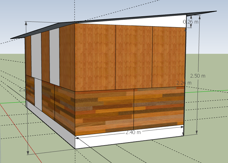

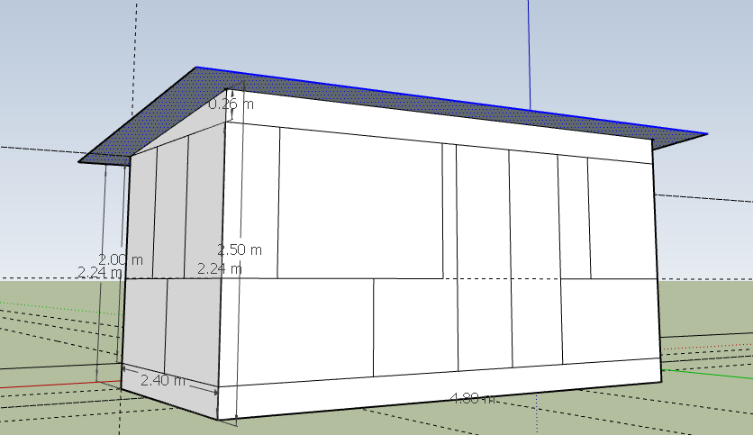

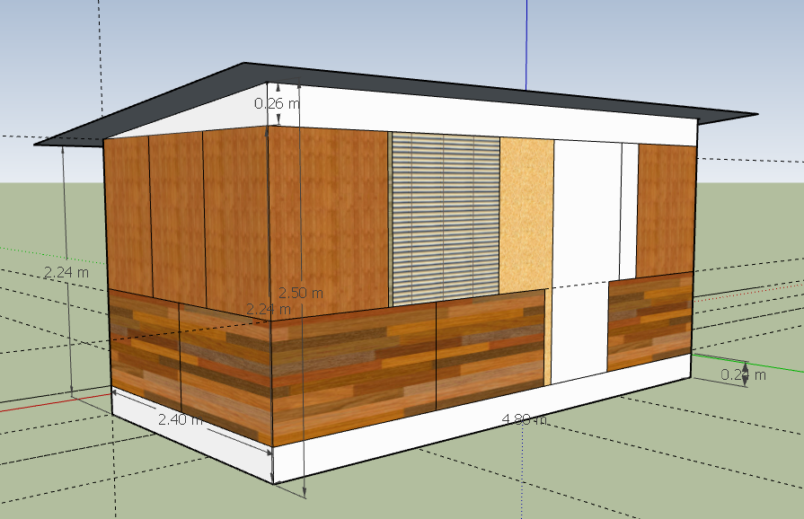

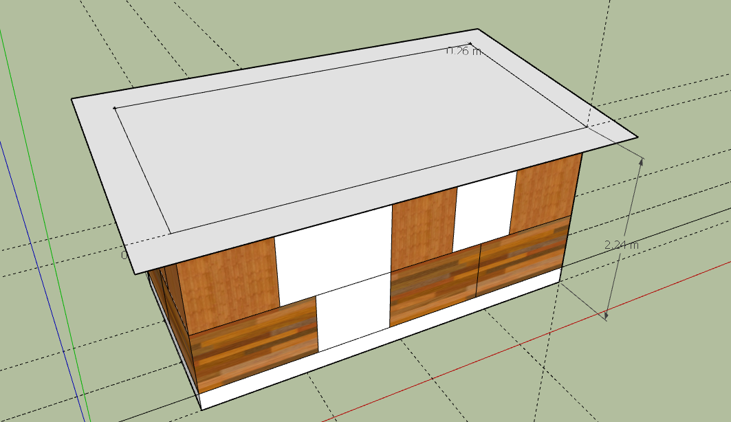

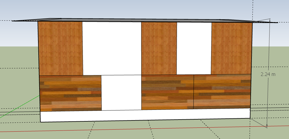

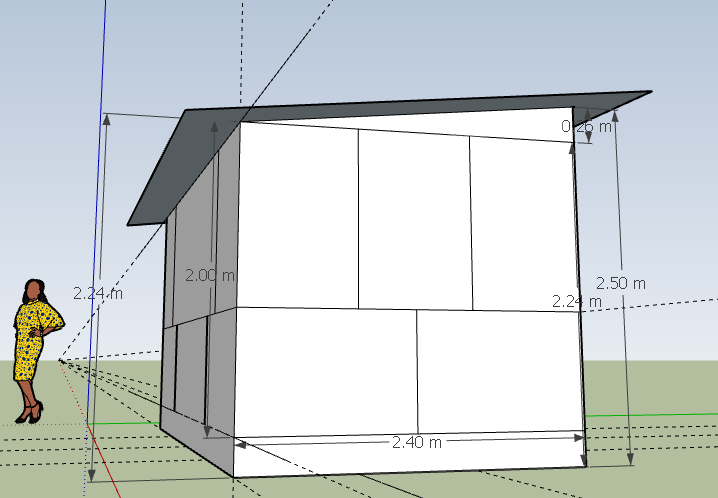

JohnBishop Posted August 12, 2023 Author Share Posted August 12, 2023 (edited) This is the design of the shed based on the EU pallets. There will be EU pallets supporting the structure and the empty spaces I will have to fill in with some lighter pallets and cut to size. It has been adjusted to the PCV windows and doors I have. Same with the garden office where I have double doors and a wider PVC window. The size is the same as the shed. Edited August 12, 2023 by JohnBishop 1 Link to comment Share on other sites More sharing options...

JohnMo Posted August 13, 2023 Share Posted August 13, 2023 I did the 2.4m long walls on mine with plasterboard pallets. 2 pallets equals one wall. Link to comment Share on other sites More sharing options...
JohnBishop Posted August 13, 2023 Author Share Posted August 13, 2023 (edited) How do you think I should achieve this 26cm height extension so it is viable? Probably the roof will end up flatter so I can fit everything under 2.5m. Edited August 13, 2023 by JohnBishop Link to comment Share on other sites More sharing options...
JohnMo Posted August 13, 2023 Share Posted August 13, 2023 One of the reasons I used plasterboard pallets, high wall I made 2.4m high (2 x 1.2m), all others are cut down. Makes life easy for yourself. Link to comment Share on other sites More sharing options...
JohnBishop Posted August 14, 2023 Author Share Posted August 14, 2023 (edited) 21 hours ago, JohnMo said: One of the reasons I used plasterboard pallets, high wall I made 2.4m high (2 x 1.2m), all others are cut down. Makes life easy for yourself. I have these EUR pallets already so I will need to improvise. I could put the 2nd pallet in vertical orientation to get to 2.4m however with the concrete blocks underneath I will be well over 2.5m limit. My structure is above ground. Edited August 14, 2023 by JohnBishop Link to comment Share on other sites More sharing options...
