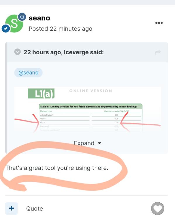

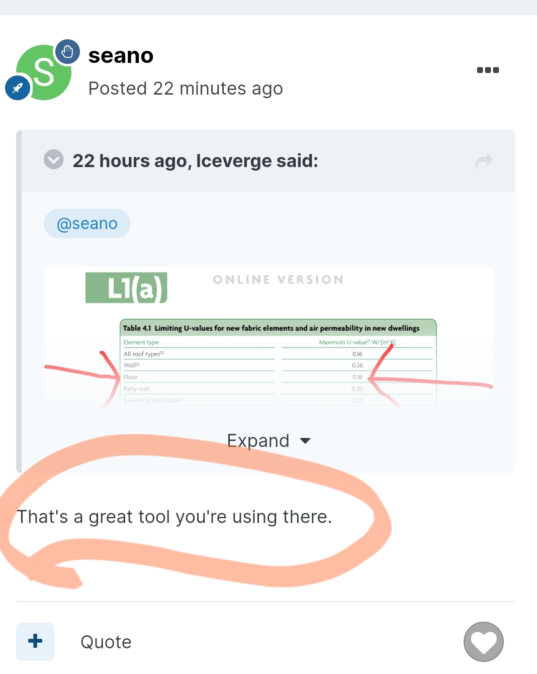

Iceverge Posted February 24, 2023 Share Posted February 24, 2023 @Nickfromwales I'll refer you to a post of one of our fellow members . 1 Link to comment Share on other sites More sharing options...
