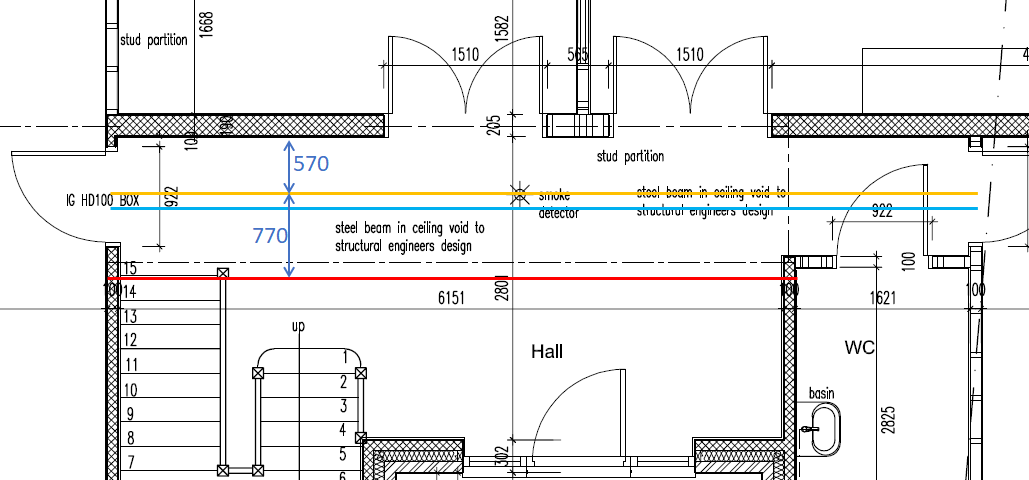

MortarThePoint Posted February 22, 2023 Posted February 22, 2023 The downstairs hall has the landing above and will have 4 downlighters along under the landing. I've shown this below. The red line is the edge of the landing which is further over than previously expected due to the steel beam bearing on the right hand side. We're unsure which line is best for the downlighters: Orange: centred on the doors at each end Blue: centred on the ceiling section under the landing The wife and I are not in agreement as to which is the better choice and I'd like to see what others think 🙂 Arguments for each approach would be much appreciated. For reference, the lateral positions of the 4 downlights is centred on the stair turn, middle of each double door and then middle of WC door.  Â

PeterW Posted February 22, 2023 Posted February 22, 2023 Stagger them - looks better than a set of runway lightsÂ
Rob99 Posted February 23, 2023 Posted February 23, 2023 I've seen lighting designs where a row of spots is positioned closer to the side wall and washes light down the wall. Â Can be quite effective. 1

MortarThePoint Posted February 23, 2023 Author Posted February 23, 2023 7 hours ago, PeterW said: Stagger them - looks better than a set of runway lights  Could have the end two centred in doors and middle two centred on ceilingÂ
Adrian Walker Posted February 23, 2023 Posted February 23, 2023 (edited) 2 hours ago, MortarThePoint said: That would be telling 🙂 Hers is probably the right choice 😂 The centre is the best IMHO. Also you need to think about what are the light there for? Looks vs. function Edited February 23, 2023 by Adrian Walker

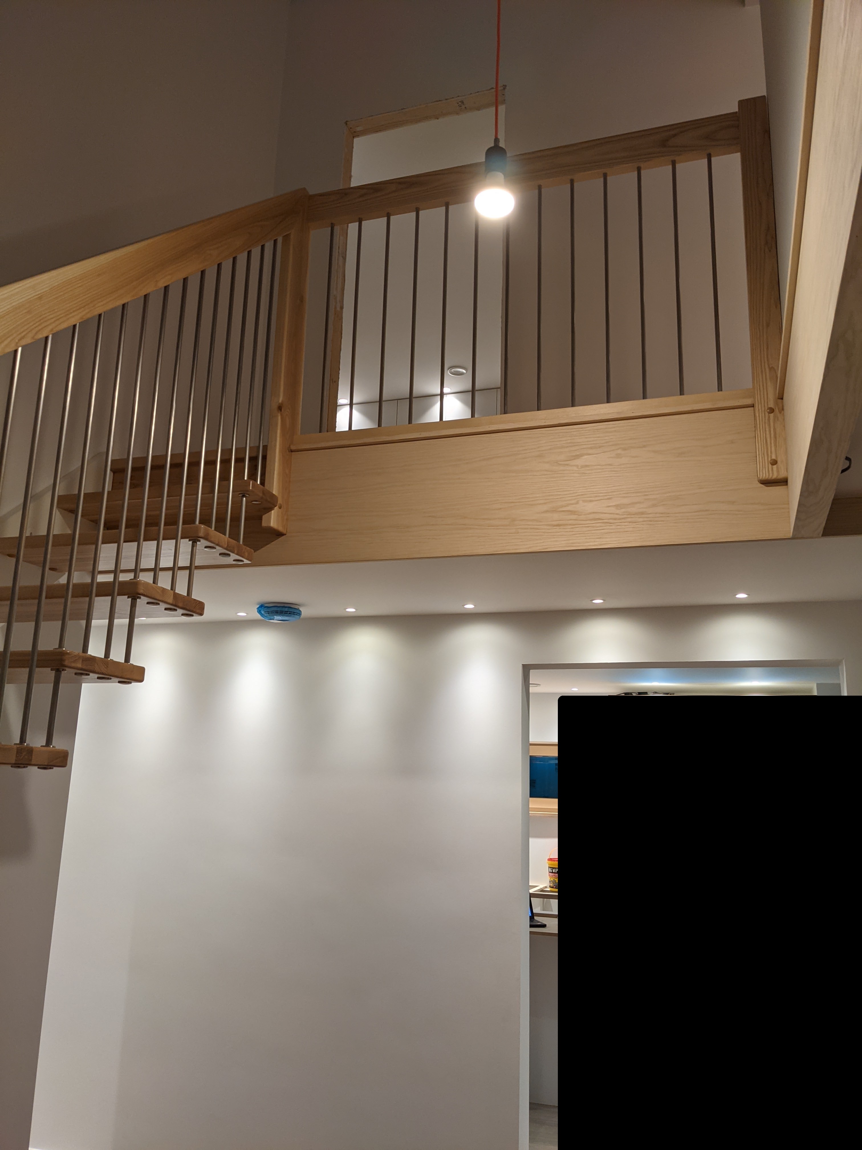

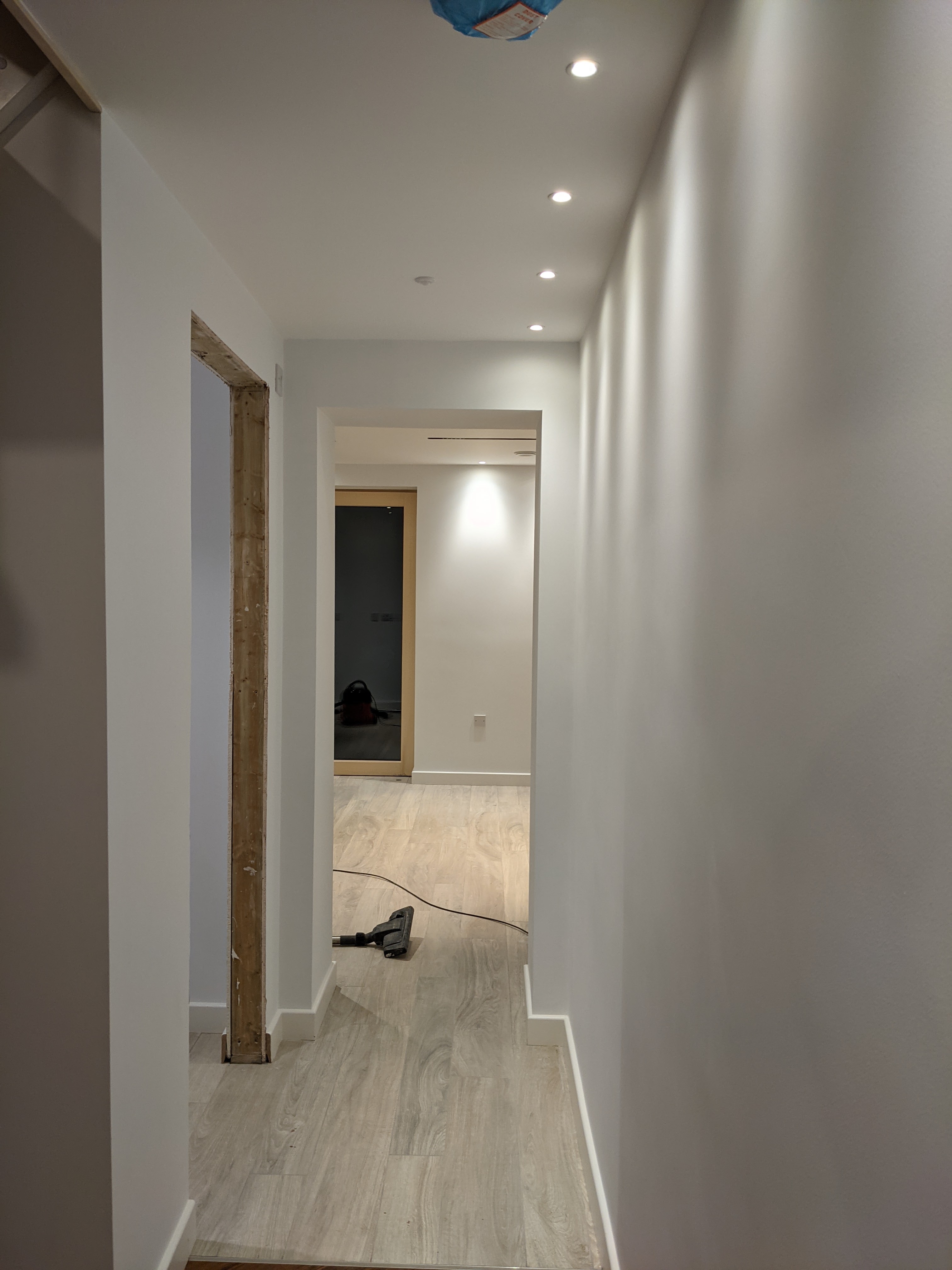

joth Posted February 23, 2023 Posted February 23, 2023 8 hours ago, Rob99 said: I've seen lighting designs where a row of spots is positioned closer to the side wall and washes light down the wall.  Can be quite effective.  Yup this was my thought too - position them at equal spacings washing the walls, or put very narrow beam angle directly over the door entrances themselves.  We have a similar landing bulkhead over part of the hallway, it's what you see as you enter the hall from main entrance door, and it works well. Uunderstand with wood panelling it might not wash quite so well as a white wall, perhaps increasing the LUX or number a bit will offset that.  Either way IMO it's the view from the main entrance you want to optimize for, and you'll never read the difference between your blue and orange lines from that prime viewing angle - it'll only be evident when walking along the length of the corridor. And putting them clearly off centre avoids either possibility of being 'wrong' 🙂   Some scrappy photos from mid-build to illustrate 🙂  View from main entrance door:   View walking along corridor  2
MikeSharp01 Posted February 23, 2023 Posted February 23, 2023 10 hours ago, MortarThePoint said: For reference, the lateral positions of the 4 downlights is centred on the stair turn, middle of each double door and then middle of WC door. Does that mean they are equally spaced? If you can see them from a position outside the run but on the axis will uneven positioning not offend the eye?  9 hours ago, PeterW said: Stagger them - looks better than a set of runway lights Runway lights BAD!Â

Mike Posted February 23, 2023 Posted February 23, 2023 11 hours ago, Rob99 said: I've seen lighting designs where a row of spots is positioned closer to the side wall and washes light down the wall. Â This gets my vote too - better to be deliberately off-centre than maybe-not-quite-centred. Â If you decide against that, then what is the lighting doing in the rooms on either side of the doorway? You may need to consider the alignment of the lights between all 3 spaces.
MortarThePoint Posted February 23, 2023 Author Posted February 23, 2023 2 hours ago, MikeSharp01 said: Does that mean they are equally spaced? If you can see them from a position outside the run but on the axis will uneven positioning not offend the eye?  Runway lights BAD! The left three are equally space, but the right most one is moved closer to the others by about 15% due to being in an alcove. Not sure that discrepancy will be evident from the main entrance
MortarThePoint Posted February 23, 2023 Author Posted February 23, 2023 I think the wife wins it then, fat lot of good you lot were 🤣  Just kidding, all good thoughts and you've won me round. Looking at it from the main entrance you're not going to perceive the difference and walking along the hall from one end to the other the blue line would grate. Closer to the wall may be an option, but I think the panelling and general aesthetic will mean the Orange line wins the day.  Where's my humble pie cook book, in some dusty corner somewhere. 1

Thorfun Posted February 23, 2023 Posted February 23, 2023 late to the party here but +1 for wall washing lights. you have a couple of walls where artwork can be displayed so could have wall washers at each end and then central outside the doors? Â if you have the time download Dialux and render it out different ways to see how they look. at least then you can make a more informed decision! 1
