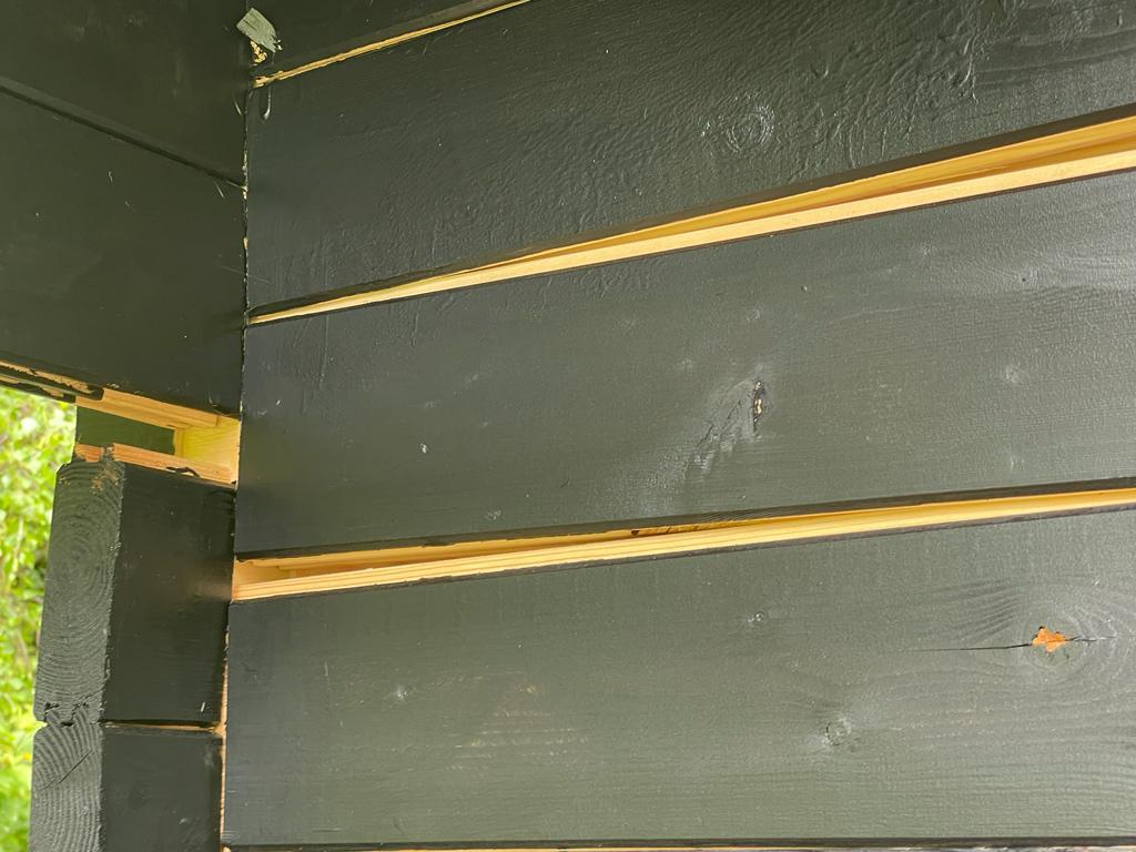

Any thoughts on my concern of the slats not mating together tightly, vertically?   I resolved never to have t & g cladding boards longer then 3.6m, as it will reduce the problem, but doesn't remove it. In these garage the t  & g is structural though, so it might settle unevenly over time.  Or perhaps the weight with the roof on forces the timber into place. I wish I knew.

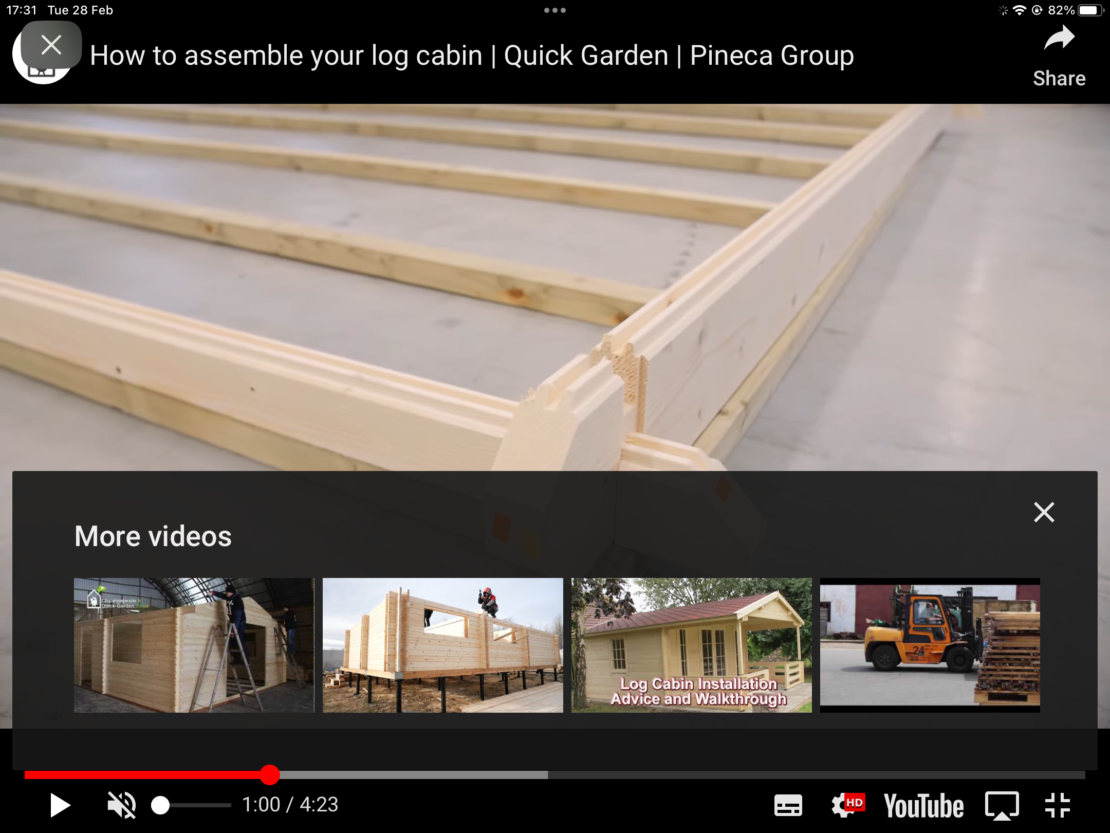

the T@G is duplicated as per pic below and like log builds the walls will shrink a little as the wood dries out, I think the corners will stop twisting . Any vertical timbers (door and window frame are  fitted with slots to accommodate settlement.

Those timbers above the sole plate are not treated at all. I am not happy about that.
A timber co MD told me that Britain is not like other countries, being constantly cold and damp, so never to specify Canadian Redwood. It is ok in a country with very cold winters when the bugs and moulds die. But here everything stays damp and rots. They even issued a note to say this to every architect and customer who asked for a quote. The same applies, but more so, to European pine. Can we rely on a painted on treatment? The exposed ends will surely need to be soaked in wood treatment or painted annually.

That is my reservation, other “stick build” types (that look more agricultural) can come treated but they are over twice the price. Yes special paint/treatment is sold in various colours (I hate painting) but I could consider creosote (the old fashioned carcegenic stuff 😱).
at my age it only has to last about 15 years till I am in my bath chair dribbling 🤣, masonry build with foundations difficult in my location and even more expensive and disruptive.

I am looking at a log type garage from “quick garden” and thought I would look at the Tuin site mentioned by @PeterW . The Tuin site gives a guide on planning etc but I am not sure they are correct, quote…..If you’re within 2m, measure from the boundary to the 2m point, if you’re below 2.5m it’s officially a ‘permitted development’, even if your ridge height extends above 2.5m.
I am not sure that’s correct, from the planning portal sectionE (garden buildings/garages etc) states…
” If any part of the building, container or enclosure is within 2 metres of the boundary of the curtilage of the house, then the height limit for the total development is restricted to 2.5 metres if it is to be permitted development.”
note particularly the “if within 2 meters of the boundary (which mine will be, but more than 1m ) then the 2.5m height limit is for the whole development”.

We are going with t and g boarding. I know that BigJimbo is correct, from expensive experience. But having used t and g with success 6 times and a problem once, I know it was a bad batch.
So let the boards sit for a week or 2 before fixing. Avoid any long lengths, and either stain before fitting, or wait a month for gaps to settle down
