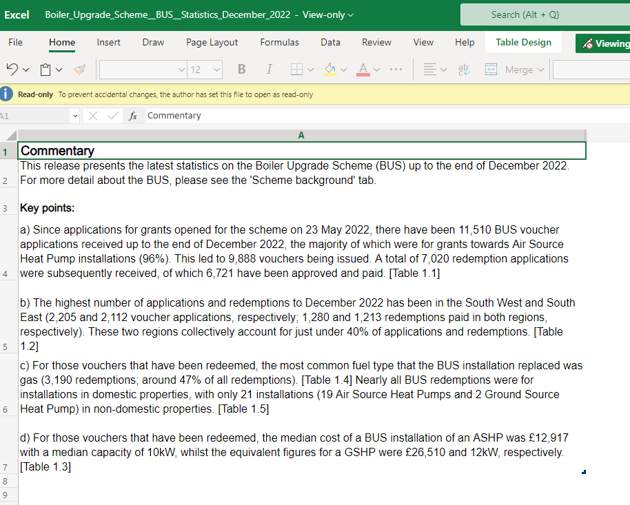

nod Posted February 17, 2023 Share Posted February 17, 2023 Sorry to go a little off topic I’d a call from a HP installer-Seller saying the 5k rebate was still claimable I thought the grants had come to an end Link to comment Share on other sites More sharing options...
crispy_wafer Posted February 17, 2023 Share Posted February 17, 2023 Just now, nod said: Sorry to go a little off topic I’d a call from a HP installer-Seller saying the 5k rebate was still claimable I thought the grants had come to an end Found this on the statistics for BUS. found here Boiler Upgrade Scheme statistics: December 2022 - GOV.UK (www.gov.uk) Link to comment Share on other sites More sharing options...
crispy_wafer Posted February 17, 2023 Share Posted February 17, 2023 17 minutes ago, Post and beam said: Plenty of plumbing suppliers have the Grant 10kw listed on their sites at about £6k with a cylinder included. Thats what i used to deduct £6k from the total quote i was given. Leaving the £8k for the install. Daylight robbery, <expletive> bandits. Link to comment Share on other sites More sharing options...
Kelvin Posted February 17, 2023 Share Posted February 17, 2023 It is dear. The quote I have is £11k for the Ecodan, cylinder, all electrics and plumbing, install and commissioning. Which I thought was a little on the high side. Less the Scottish grant which includes the rural uplift for us so cost is £2k. Link to comment Share on other sites More sharing options...
Post and beam Posted February 17, 2023 Author Share Posted February 17, 2023 20 minutes ago, nod said: Sorry to go a little off topic I’d a call from a HP installer-Seller saying the 5k rebate was still claimable I thought the grants had come to an end Apologies, i dont understand this. Oh and the grant scheme is deffo still active Link to comment Share on other sites More sharing options...
