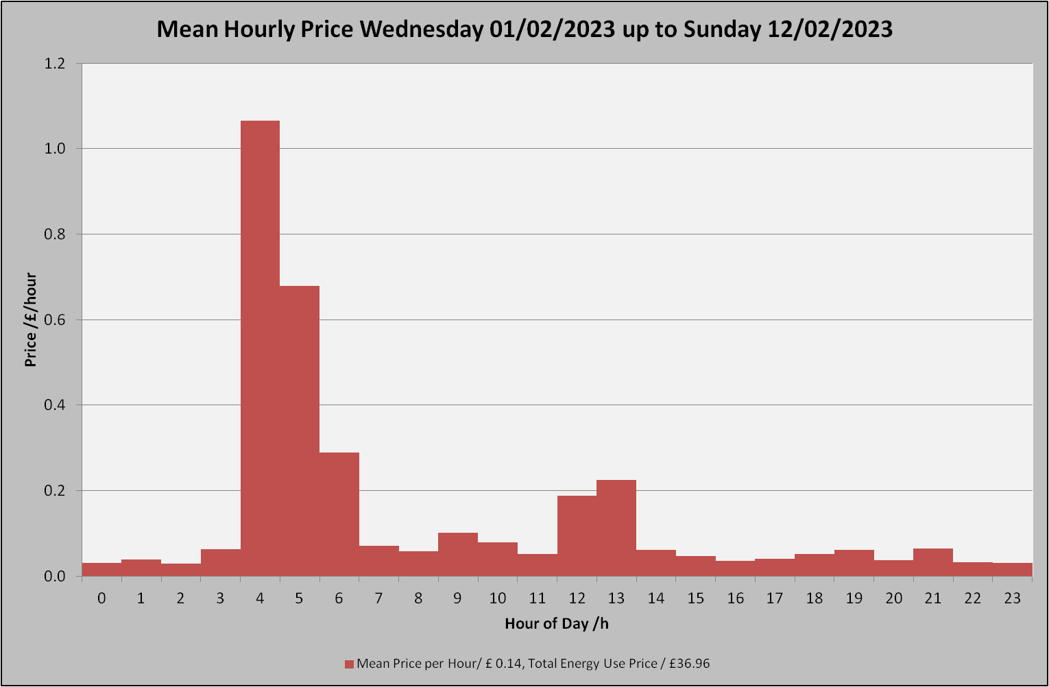

Radian Posted February 14, 2023 Share Posted February 14, 2023 25 minutes ago, Dave C said: I don't really care so much what the heating COP is when it's 10C outside, don't need much heat input then, the COP when temperatures are approaching freezing is much more interesting... Since getting a couple of Daikin A2As installed in our grown-ups play rooms, looking back at our highest energy use, 12 December was our coldest day at an average of -2oC. On that day our two 'as advertised' 3.5kW heating units gobbled around 10kWh hours of leccy between them keeping 60m2 of space heated to between 17oC and 19oC (night/day). That's therefore, in very broad terms, replacing the calculated fabric loss of roughly 2kW (48kWh/day) with a COP of 4.8 Incidentally, this space has a not insignificant (25m2) of glazing to contend with. @SteamyTea would probably say that £3.40 is a bargain for enough energy to keep these rooms usable. All the same, I'm just thankful such cold days are a rarity here. However, getting a COP of nearly 5 does make it a practical proposition compared with the previous year when we just didn't use the space in the winter. 1 2 Link to comment Share on other sites More sharing options...
SteamyTea Posted February 14, 2023 Share Posted February 14, 2023 38 minutes ago, Radian said: @SteamyTea would probably say that £3.40 is a bargain for enough energy to keep these rooms usable. Here is my cost profile for the last 11 days, £3.36/day all in. Link to comment Share on other sites More sharing options...
Dave C Posted February 14, 2023 Share Posted February 14, 2023 51 minutes ago, Radian said: That's therefore, in very broad terms, replacing the calculated fabric loss of roughly 2kW (48kWh/day) with a COP of 4.8 Incidentally, this space has a not insignificant (25m2) of glazing to contend with. Thanks, that's good info - COP of 4.8 at below freezing temperatures is really encouraging! At the very least it shows there's some A2A options out there which keep a good COP at low temperatures. Still interested to see how well the electriQ holds up - that note about performance dropping off below 5C is still a bit suspicious... Link to comment Share on other sites More sharing options...
