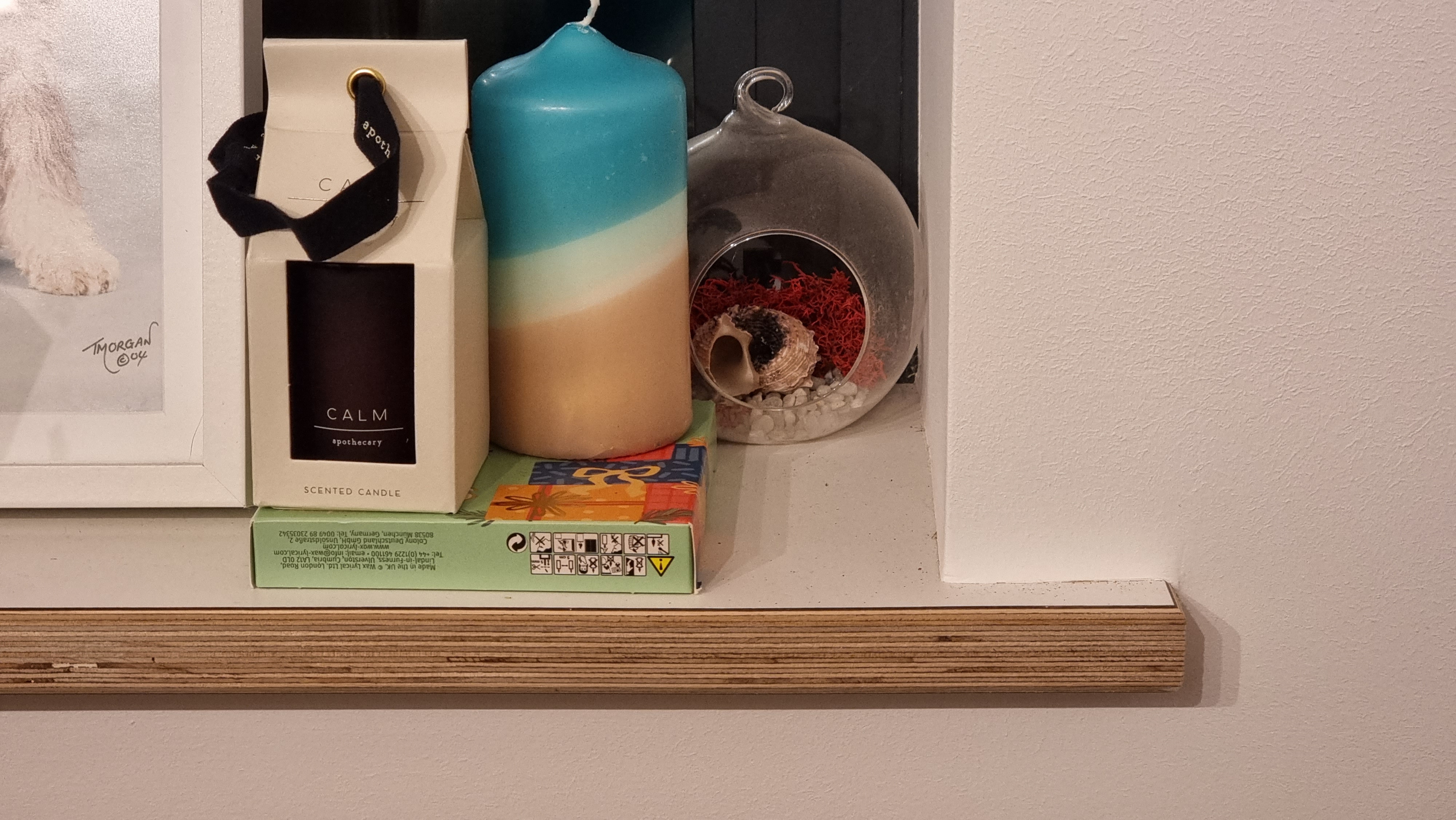

Had vaguely thought we'd have some nice birch plywood reveals (all round) but bit concerned about the rising costs of the material and now we'll need to start thinking about our reveals and cills. What did you use and would you recommend?

Birch ply worked well on our windows, but you will need a track saw to make a decent job of it. My wife spotted a post on build hub which we copied using birch play.
Edited by Simon R
Missed photo attach
  • Like 2

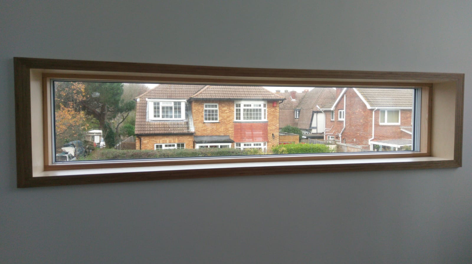

Your blog was the inspiration for our plans - looks fantastic. Did you manage to fit any insulation in behind the ply?
Thanks, it was worth the effort and saw dust. Regarding insulation, our build is ICF so the inside is fully insulated. The JUB ICF system provides a really well insulated window opening.
