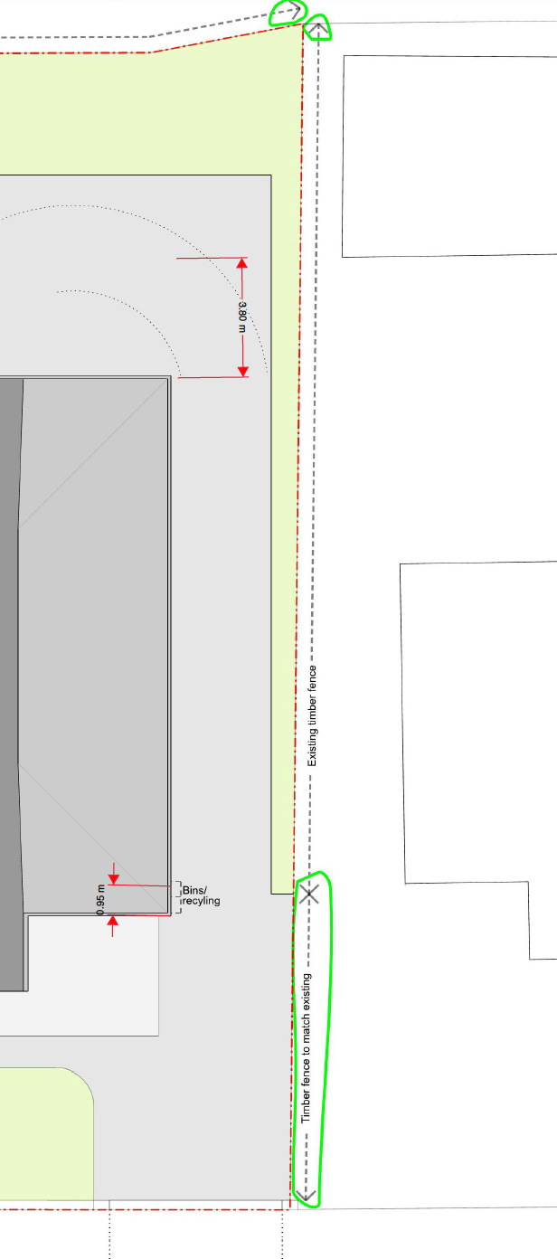

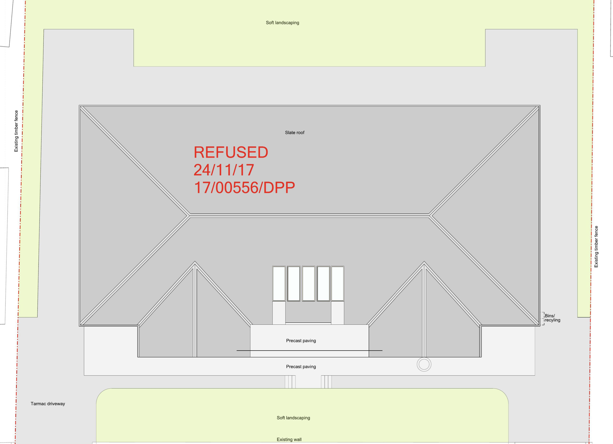

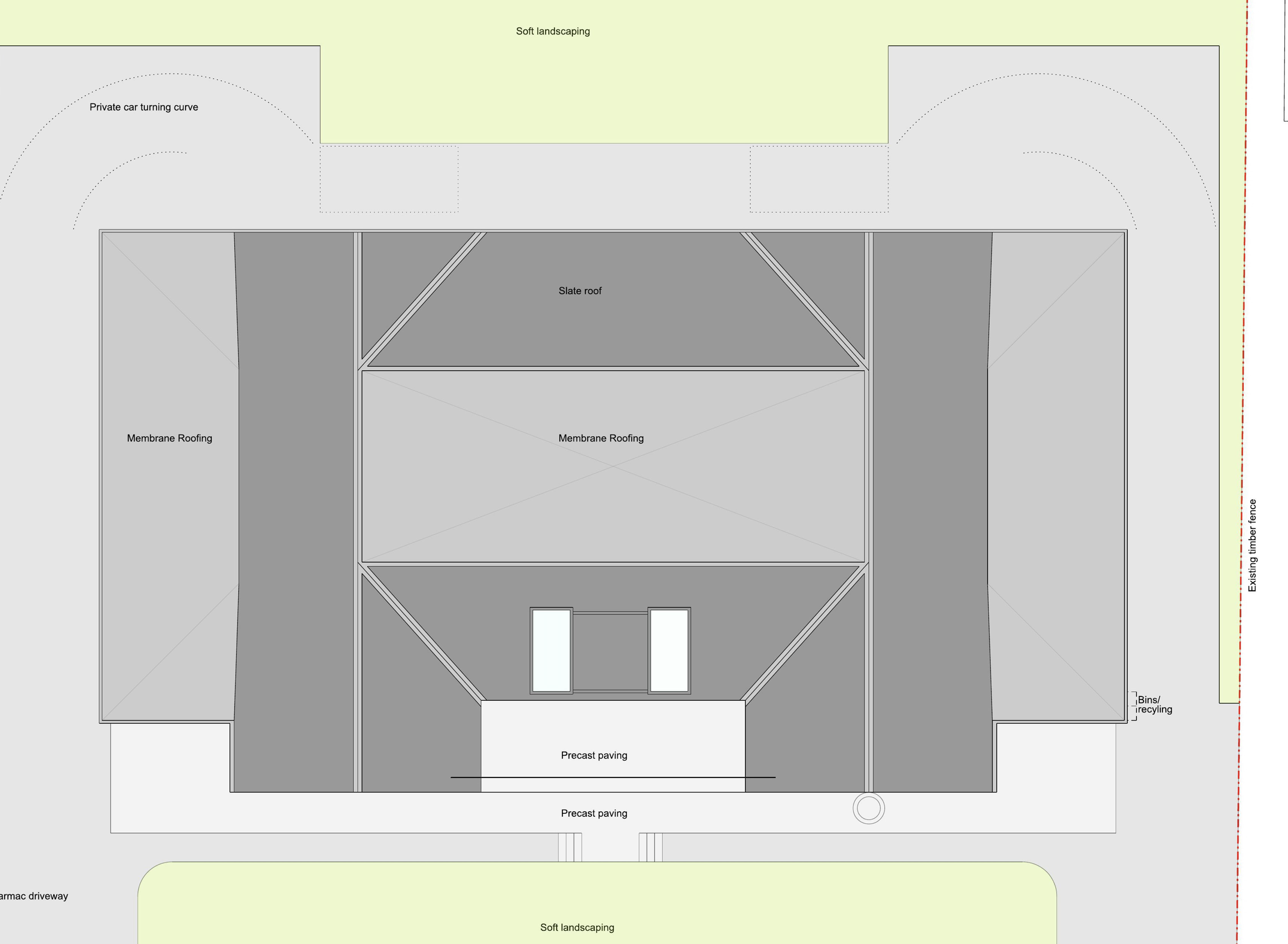

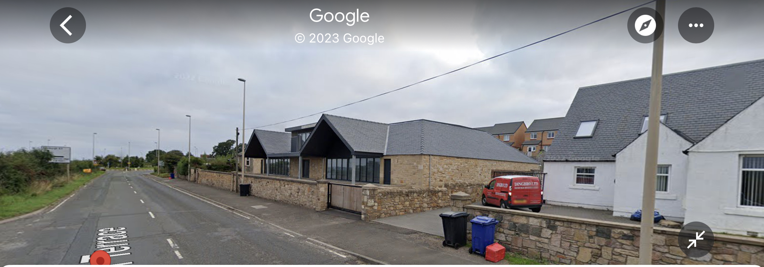

AliG Posted January 11, 2023 Author Share Posted January 11, 2023 I found the planning application. The dormer window shown in the picture in the article was not in the planning application. https://planning-applications.midlothian.gov.uk/OnlinePlanning/applicationDetails.do?activeTab=documents&keyVal=P2A98TKVKNQ00 Actually the whole roof bears little relation to the planning drawings. However, in fairness, I cannot see it making a big difference and cannot see why they didn't get retrospective permission, although the house is stupidly out of proportion with the neighbouring houses, but that hasn't really changed with the alterations. Maybe they were enough to just push it over the edge as it does make the roof even larger and more imposing. I find it hard to believe that they did not know what they were doing. The comments on the article read like people think they should sue the council for making a mistake. However, this is due to the article quoting the owner saying the council made a mistake. No mistake was made that I can see. Planning and building control are separate and they had an architect who would have been well aware of this. The cladding and window shapes also are very different to the approval. The materials had to be approved and the cladding was supposed to be natural oak. Ahh, it all becomes clear. The house looks a lot more like the house they applied to build in 2017 which was refused due to being too "bulky" and poor design. https://planning-applications.midlothian.gov.uk/OnlinePlanning/applicationDetails.do?activeTab=documents&keyVal=OT0ULEKVJ9900 Shame the papers couldn't do half an hour of research. Refused plans 2 Link to comment Share on other sites More sharing options...
saveasteading Posted January 11, 2023 Share Posted January 11, 2023 Good work AliG. It is a common theme 'my house I will do as I please'.' Nobody will make me take it down..' and maybe they won't. In plan it looks like a supermarket. Link to comment Share on other sites More sharing options...
PeterW Posted January 11, 2023 Share Posted January 11, 2023 Looks like a doctors surgery !!! 1 Link to comment Share on other sites More sharing options...
ProDave Posted January 11, 2023 Share Posted January 11, 2023 So they were refused the original plan, got permission for a different design, then built the original refused one. I would certainly NOT risk an awful lot of money playing that silly game. Link to comment Share on other sites More sharing options...

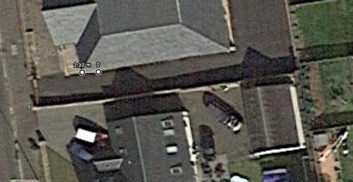

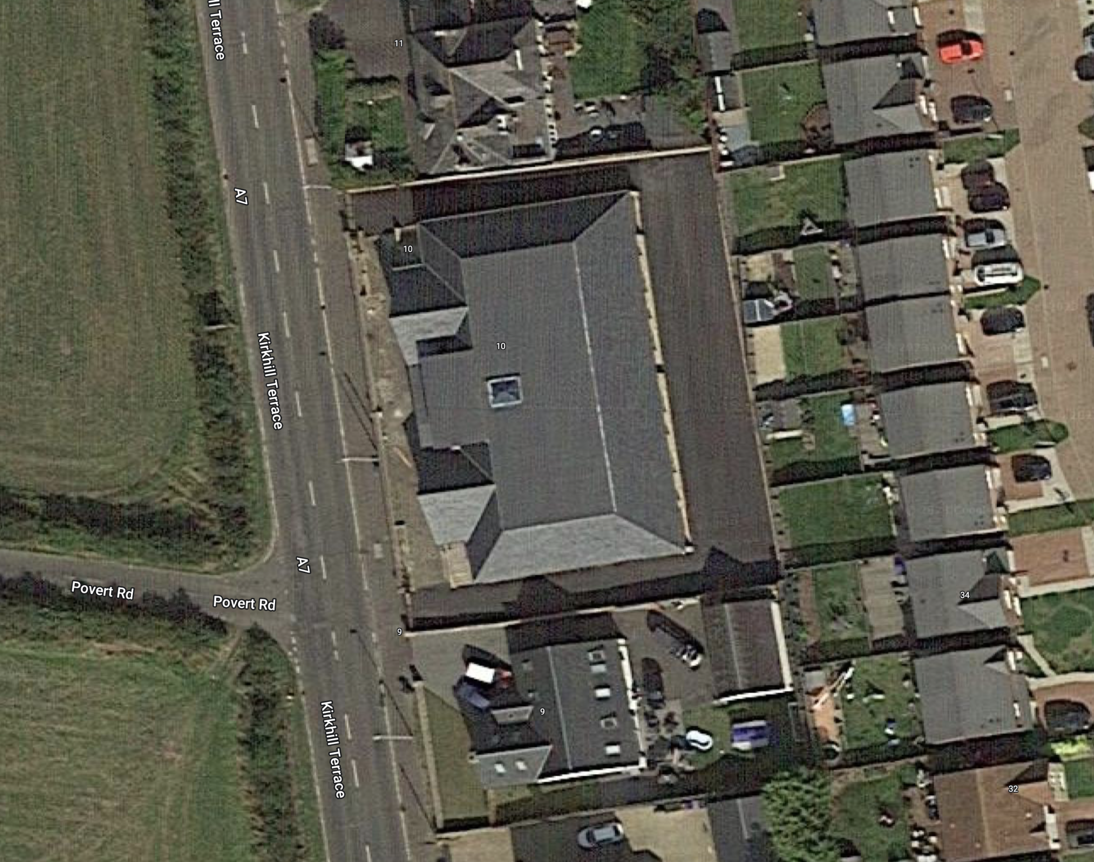

AliG Posted January 11, 2023 Author Share Posted January 11, 2023 I just looked again, the plans show "soft landscaping" there is literally none on the Google view. My house is large, but the houses in the area are large. Most houses in this area are 3-400sq metres and I am around 900. The house here covers a ground area of 700sq metres according to the planning report (this includes the overhangs at the front). This makes it more than 10x larger than the surrounding houses. You can see 5 houses across its width behind and it is more than twice their depth. Despite being "single storey" due to its size it is at least as tall. I don't know how it got permission. It looks ridiculous. Taking rough measurements from the site plan. The house should be 620 sq metres (I excluded the front overhangs) and the site around 1650sq metres. However, I thought the house looked bigger than this percentage of the area when I eyeballed it. I took some measurements from Google Maps and the house appears to be roughly 4m deeper than shown on the plans. It is nearer the rear boundary and considerably nearer the road. I get closer to 760sq metres than the 620 shown on the plans. The house is approx 24m deep, compared to 19.5m shown on the plans and referenced in the planning report (full depth including the overhangs). I am sure Google Map measurements are not fully accurate, but the width measurement is correct comparing the map and plans. Note the position of the house relative to next door versus the plans. The rear is level with next door's garage and the front much further forward than shown on the plans- From reading the story, the council just seems to want them to adjust the roof shape. I bet they haven't even realised how much deeper the house is than approved. Link to comment Share on other sites More sharing options...
twice round the block Posted January 11, 2023 Share Posted January 11, 2023 I can't believe someone didn't query this when the ground works went in. Two departments working on parallel universes. Link to comment Share on other sites More sharing options...
ProDave Posted January 11, 2023 Share Posted January 11, 2023 1 hour ago, AliG said: The house here covers a ground area of 700sq metres according to the planning report (this includes the overhangs at the front). This makes it more than 10x larger than the surrounding houses. You can see 5 houses across its width behind and it is more than twice their depth. Despite being "single storey" due to its size it is at least as tall. I don't know how it got permission. It looks ridiculous. I am not sure why you would want to build such a large house there, on a main road? A better use would have been for 5 smaller houses matching the plot widths of the houses it backs onto? Link to comment Share on other sites More sharing options...
eandg Posted January 11, 2023 Share Posted January 11, 2023 2 hours ago, AliG said: I just looked again, the plans show "soft landscaping" there is literally none on the Google view. My house is large, but the houses in the area are large. Most houses in this area are 3-400sq metres and I am around 900. The house here covers a ground area of 700sq metres according to the planning report (this includes the overhangs at the front). This makes it more than 10x larger than the surrounding houses. You can see 5 houses across its width behind and it is more than twice their depth. Despite being "single storey" due to its size it is at least as tall. I don't know how it got permission. It looks ridiculous. Taking rough measurements from the site plan. The house should be 620 sq metres (I excluded the front overhangs) and the site around 1650sq metres. However, I thought the house looked bigger than this percentage of the area when I eyeballed it. I took some measurements from Google Maps and the house appears to be roughly 4m deeper than shown on the plans. It is nearer the rear boundary and considerably nearer the road. I get closer to 760sq metres than the 620 shown on the plans. The house is approx 24m deep, compared to 19.5m shown on the plans and referenced in the planning report (full depth including the overhangs). I am sure Google Map measurements are not fully accurate, but the width measurement is correct comparing the map and plans. Note the position of the house relative to next door versus the plans. The rear is level with next door's garage and the front much further forward than shown on the plans- From reading the story, the council just seems to want them to adjust the roof shape. I bet they haven't even realised how much deeper the house is than approved. They are clearly tasteless morons but looks like they delivered it at £833/m2 so can't be that daft! Link to comment Share on other sites More sharing options...
saveasteading Posted January 11, 2023 Share Posted January 11, 2023 2 hours ago, AliG said: Google Map measurements are not fully accurate I am constantly dubious then surprised how accurate they are. 46 minutes ago, twice round the block said: Two departments working on parallel universes I have once seen a planner on site. Measuring is not their thing anyway. I twice in 300 projects, was questioned on the matter. Once was an erroneous gut feeling from a nature officer. Another was a neighbours' complaint which stopped the job for 6 weeks. Fortunately we were able to demonstrate / convince them. So only someone pointing these discrepancies out is likely to get it attended to. Link to comment Share on other sites More sharing options...
