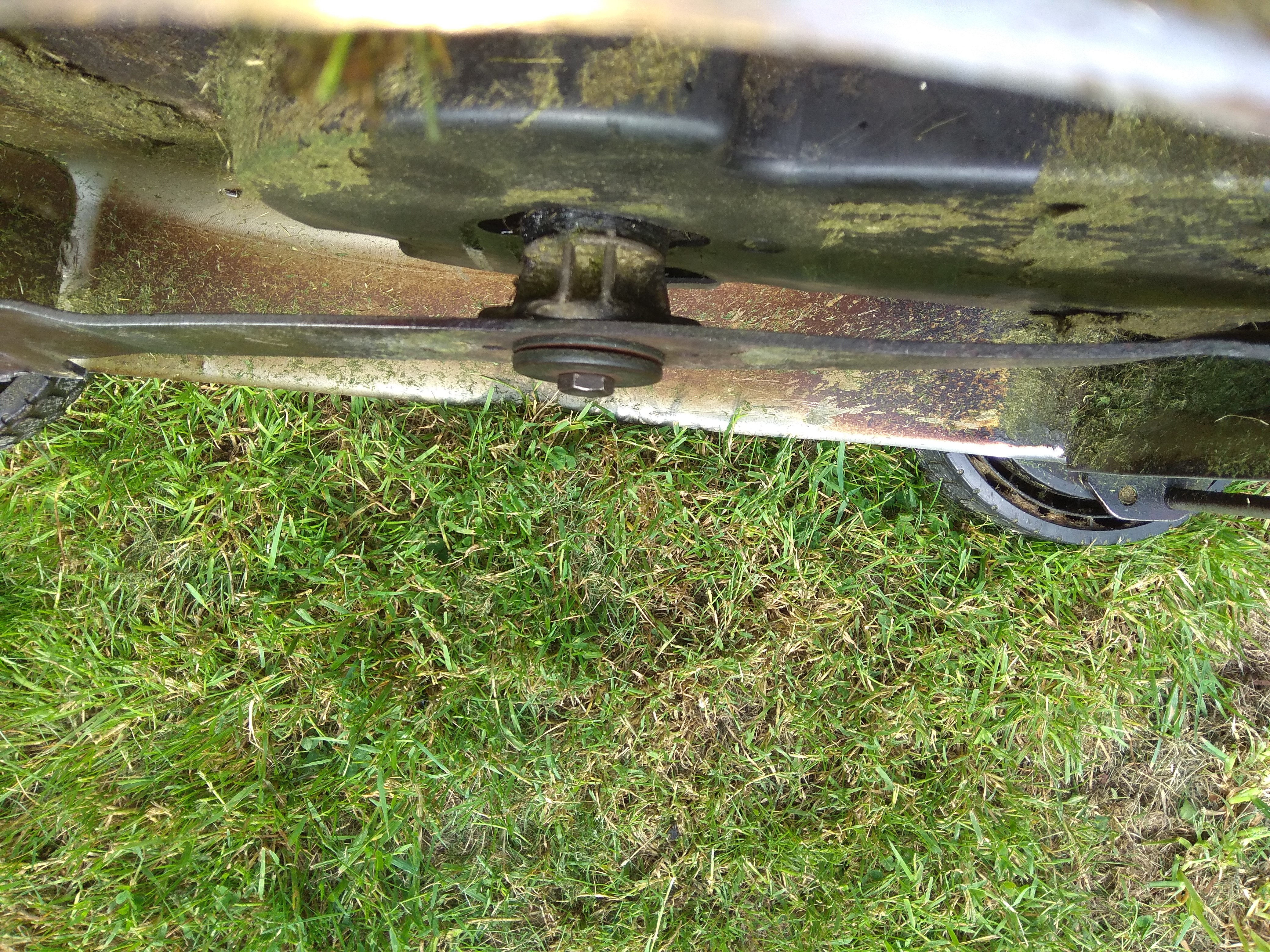

Declan52 Posted July 12, 2017 Share Posted July 12, 2017 So my wee lad in all his wisdom decided to cut to close to tree stump and has bent the drive shaft. Took it all apart and it looks like the connection is pressed in so I can't get it off. It's close on 15 years old so owes me nothing so am on the hunt for a new petrol version. Needs to be at least 450mm cut and self propelled as it's a big garden. Any one have any recommendations. Link to comment Share on other sites More sharing options...

ProDave Posted July 12, 2017 Share Posted July 12, 2017 Is the shaft really bent? Does it run at all? what's the symptoms. A previous mower I had, hit a bit of a stump. What happened was the motor stopped dead, but the inertia kept the flywheel going and it sheered the key that held the flywheel to the top of the shaft. One new key and it ran again and went on for years until the deck rested away. Our own mower packed up a few weeks ago, so SWMBO went into town with the objective to come back with the cheapest petrol mower she could find and came back with a "Challenge" Good points it's got a plastic deck so it won't rust but I suspect it will find some other way to fall apart instead. Bad points it's a bit small at 42cm cut and the grass box is a bit small. Link to comment Share on other sites More sharing options...
Declan52 Posted July 12, 2017 Author Share Posted July 12, 2017 It's the actual shaft that comes out of the engine that the blade attaches to. Tried a few gentle taps with a hammer but no movement in it. It still runs fine but it's sitting at maybe 15 degrees so it hits the frame when it spins round. Out at the moment so will take a pic later Link to comment Share on other sites More sharing options...

Declan52 Posted July 12, 2017 Author Share Posted July 12, 2017 Here's a pic Link to comment Share on other sites More sharing options...
ProDave Posted July 12, 2017 Share Posted July 12, 2017 Bend the blade to compensate Link to comment Share on other sites More sharing options...
dpmiller Posted July 12, 2017 Share Posted July 12, 2017 aye. blade and adaptor off, then scaffold bar (or whatever fits better) on the shaft. Link to comment Share on other sites More sharing options...
Barney12 Posted July 12, 2017 Share Posted July 12, 2017 (edited) 49 minutes ago, Declan52 said: It's the actual shaft that comes out of the engine that the blade attaches to. Tried a few gentle taps with a hammer but no movement in it. It still runs fine but it's sitting at maybe 15 degrees so it hits the frame when it spins round. Out at the moment so will take a pic later If it's destined for the skip anyway then hit it harder! What have you got to loose EDIT: Unless it's an excuse to buy a new shiny one. In which case put it in the skip quickly and look sad and mournful in front of the wife whilst explaining it could be a h&s risk if the shaft and blade flew off Edited July 12, 2017 by Barney12 Link to comment Share on other sites More sharing options...
Temp Posted July 12, 2017 Share Posted July 12, 2017 Can't tell from the photo but sometimes the shear pins fail allowing the blade to rotate on the shaft and "ride up" over the broken pins making it a funny angle. I purchased a Honda powered "unbranded" mower from a DIY store when we were living abroad some 20 years ago. Engine has been faultless despite it never being serviced. Well I think I changed the oil once and perhaps cleaned but not replaced the air filter a few times. I don't know if there is anything like this still being made. Perhaps have a look in some of the UK DIY stores. Only problem is the deck is now starting to rust through. One advantage of a real Honda mower like the IZY is that you can get replacement decks for them if you really wanted (just over £100 on ebay). Link to comment Share on other sites More sharing options...

Declan52 Posted July 12, 2017 Author Share Posted July 12, 2017 It's already been beat quite a bit to get it to that shape. It hits the frame every 4-5 Revolution so it's not spinning any where near true so it looks like a dead duck. The 2nd one in screwfix looks like it ticks a lot of boxes. Link to comment Share on other sites More sharing options...
