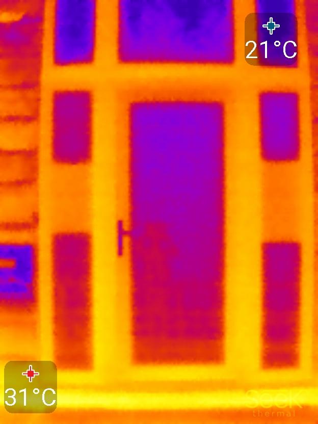

I've just been out and taken a thermal image of the glazing.  Not ideal, as it's warm and overcast, with no direct sun, but the contrast between the glass and the patches of heat reflective film is marked:
The cooler thing at the far left is a stainless steel mailbox.

Not yet, the chap is sending me all the details next week, together with a thermal analysis of both systems when applied to our glazing.  The warranty is longer on the 3M stuff (12 years IIRC) as it doesn't need edge sealing.  Apparently the Sentinel Plus does need edge sealing, as it uses a metal sputtered internal film layer and this can corrode unless the edges are sealed after fitting.  The 3M stuff has no metal coating, it's a multi-layer construction, that presumably relies on mixing film layers with differing refractive indices to get the performance.  It's also more expensive.
As soon as I have some more details I'll post them here, but based on the thermal image above I doubt that there's any significant practical difference between either film.  The chap was saying that the almost clear version of the 3M film is very nearly as good thermally as the medium tint, as it really only reflects IR, and allows a fair bit of visible light through.  Our choice will probably come down to the privacy enhancement, given the similarity in IR reflectance.
Both of these films block around 95% plus of UV, which may be a consideration in some applications (although I think that triple glazing probably blocks a great deal of UV on its own).
What I found interesting in the thermal image is that the plain glass was allowing the thermal imaging camera to read the room temperature from inside, so there was virtually no IR reflection from it at all from outside in (which fits with the spec for the glazing).  You can also see how the floor inside the hall has warmed up, with the lower part of the glazing seemingly warmer than the upper part which is looking at the temperature of the wall to the rear of the hall.  You can just make out the thermal reflection of me holding the tablet with the Seek Thermal camera up to the right of the door handle, and also the thermal reflection of the post and rail fence behind, so there is some IR reflection from the standard glazing, but not a great deal.

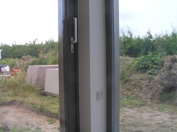

Had our window film installed today. Had to wait a couple of days for the wind to die down a bit. It's not easy to see the difference between glazing with the film and without. I'll have to wait till this evening to see what the effect is on solar gain.

There are many different internal and external window films for different applications and it sound as if the specification was wrong in that case. I worked in an all glass building built in the late sixties that was single glazed. It overheated in the summer and they fitted a mirrored film which even back then made a huge difference. The film I have had fitted has made a big difference to the amount of solar gain and glare in my sitting room.
