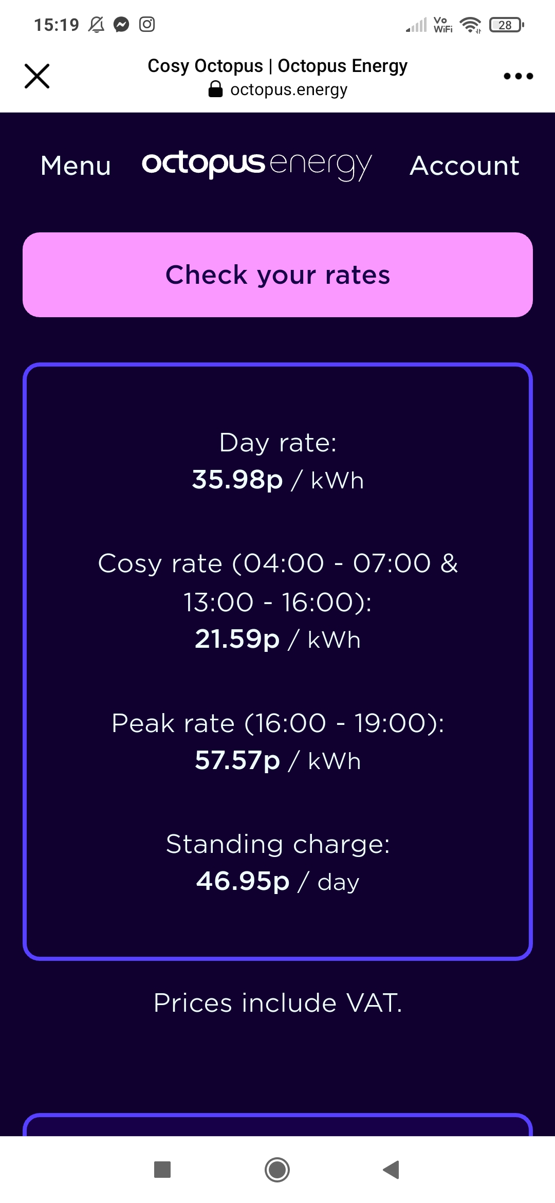

RichardL Posted December 22, 2022 Share Posted December 22, 2022 Gut feel, I didn't run precise numbers, It feels more like a winter battery tariff (or battery without solar) so you can charge up twice a day and time shift usage a little later without needing capacity for the whole day in the battery bank? Link to comment Share on other sites More sharing options...
Dave C Posted December 22, 2022 Share Posted December 22, 2022 That's probably fair - I have a battery, but initially made the mistake of comparing the Cosy price to my current Octopus Go prices; of course prices have gone up since my last renewal! So you get two shots per day at charging your battery, and the price is higher than Go, but less than double. Working the figures out, for my battery I reckon Cosy is cheaper than Go on days where I'd use ~20kWh or more. That's essentially never during the no-heating part of the year, but during the winter ... eh. Probably a bit of a toss up: in January, that's the majority of days for me, probably about half the time in December/February - so for those three months, it's better than Go. The other 9 months of the year (especially when there's no heating going on!) it's worse. If you were willing to switch to it just for the winter months ... yeah, it could work. Link to comment Share on other sites More sharing options...
canalsiderenovation Posted December 22, 2022 Share Posted December 22, 2022 (edited) We have been looking at Cosy as our Go Faster 5 hour 830pm slot expires in March (the heating is coming off when our Go Faster expires I don't care what the temperate is outside)! 🥶 If we move to Go we are limited on the 0030-0430 times at 12p (providing rates do not go up) and their day rate is more expensive than Cosy although I'm not clear if their day rate is reduced because of the government cap. Whilst this is good for running appliances, charging etc I am not sure if I'd want to use the dishwasher and washing machine then as there is always the risk of flooding. Also running the ASHP for heating during these times isn't particular helpful as we will be asleep, rather I'd prefer it to be warmer when we are up and it's likely we will need the heating on at non Go times even more than we do now (we boost temperatures during the Go Faster times). It's demand on the heat pump for our heating, hot water and other appliances in a 4 hour slot and as others have said trying to do the heating and hot water with th ASHP at the same time doesn't work well. The current go Faster slot has also been useful as we could run appliances when we were still awake, charge up things etc and as we were still very much awake at 830pm. With the normal Go times we would have to set timers for things like laptops etc to charge during the cheap rates. As someone has said, it's the winter and likely 6 months of the year that it's the heat pump demand that's the issue as our heat pump is off 6 months of the year because our solar does our hot water and normally all our appliances and charging. With limited solar at the moment we are running large appliances during Go Faster. As we both work from home (730-4) the Cosy would work well for us, laptops running etc and with solar the peak time would only likely be an issue ok in winter when there is no solar 4-7pm. We may be looking to invest in batteries next year and if we do perhaps you could use use battery in the peak time? Our heat pump is set to a minimum of 18 degrees and boosts to 20.5 degrees during Go Faster and again comes on in the morning. In the cold snap it was kicking in mid afternoon again. Ps I did have the temperatures higher until someone bought me an Oodie. It changed my life 😂 Edited December 22, 2022 by canalsiderenovation Edit Link to comment Share on other sites More sharing options...
ProDave Posted December 23, 2022 Share Posted December 23, 2022 13 hours ago, canalsiderenovation said: charge up things etc and as we were still very much awake at 830pm. With the normal Go times we would have to set timers for things like laptops etc to charge during the cheap rates. I doubt the cost of charging small things like that is significant. Though I would not do it during the silly early evening rip off peak. Link to comment Share on other sites More sharing options...
PhilT Posted December 23, 2022 Share Posted December 23, 2022 I've registered for this as it fits my situation quite well, and today called to check as I had no email acknowledgement. Good job I did as my Cosy registration triggered an automatic process to give me a new smart meter which I already have. Now they are aware of the issue hopefully it will prevent a log jam building up of unnecessary application processes to give all cosy applicants a new smart meter, whether they have one or not. But be prepared for a wait if you do register. Link to comment Share on other sites More sharing options...
willy_eckerslyke Posted December 24, 2022 Share Posted December 24, 2022 Something that might change your thinking, if you have solar, is that Octopus will pay 15p/kWh for export on Cosy and only 4.1p/kWh on GO/Intelligent. For me this makes a big difference and means that Cosy would be cheaper than GO/Intelligent even though I have an EV. - I have solar + Heat Pump + EV. 1 1 Link to comment Share on other sites More sharing options...
canalsiderenovation Posted December 24, 2022 Share Posted December 24, 2022 (edited) 17 minutes ago, willy_eckerslyke said: Something that might change your thinking, if you have solar, is that Octopus will pay 15p/kWh for export on Cosy and only 4.1p/kWh on GO/Intelligent. For me this makes a big difference and means that Cosy would be cheaper than GO/Intelligent even though I have an EV. - I have solar + Heat Pump + EV. Interesting! We have never exported before - do you have to sign up for it or do anything for extra? At the moment any excess is diverted to the hot water but I know at times we would have had a excess but we have never exported before so unsure what we do. We are hoping to sign up with cosy. Edited December 24, 2022 by canalsiderenovation Link to comment Share on other sites More sharing options...

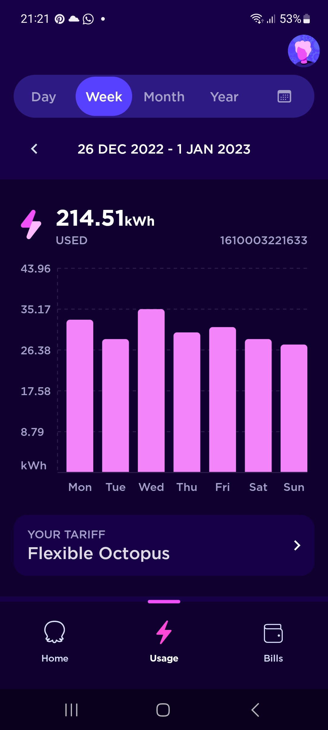

Steve W Posted January 2, 2023 Share Posted January 2, 2023 I have Solar PV coupled to 18.5KWh of batteries and Economy 7. At this time of year the ASHP runs between 12.30am and 8.30am (and 7.30pm to 8.30pm upstairs only) and the batteries are also charged as necessary. The average temperature is around 20C when I get up, peaks around 21.5 and falls back over the evening. My average consumption for everything is around 30KW at 14p/kw. The heat pump is showing at about 13KW with COP of just under 3 - this includes hot water and running it at night. I'll be sticking to E7 / Solar Link to comment Share on other sites More sharing options...
SteamyTea Posted January 2, 2023 Share Posted January 2, 2023 4 minutes ago, Steve W said: kw 4 minutes ago, Steve W said: KW kWh Link to comment Share on other sites More sharing options...
