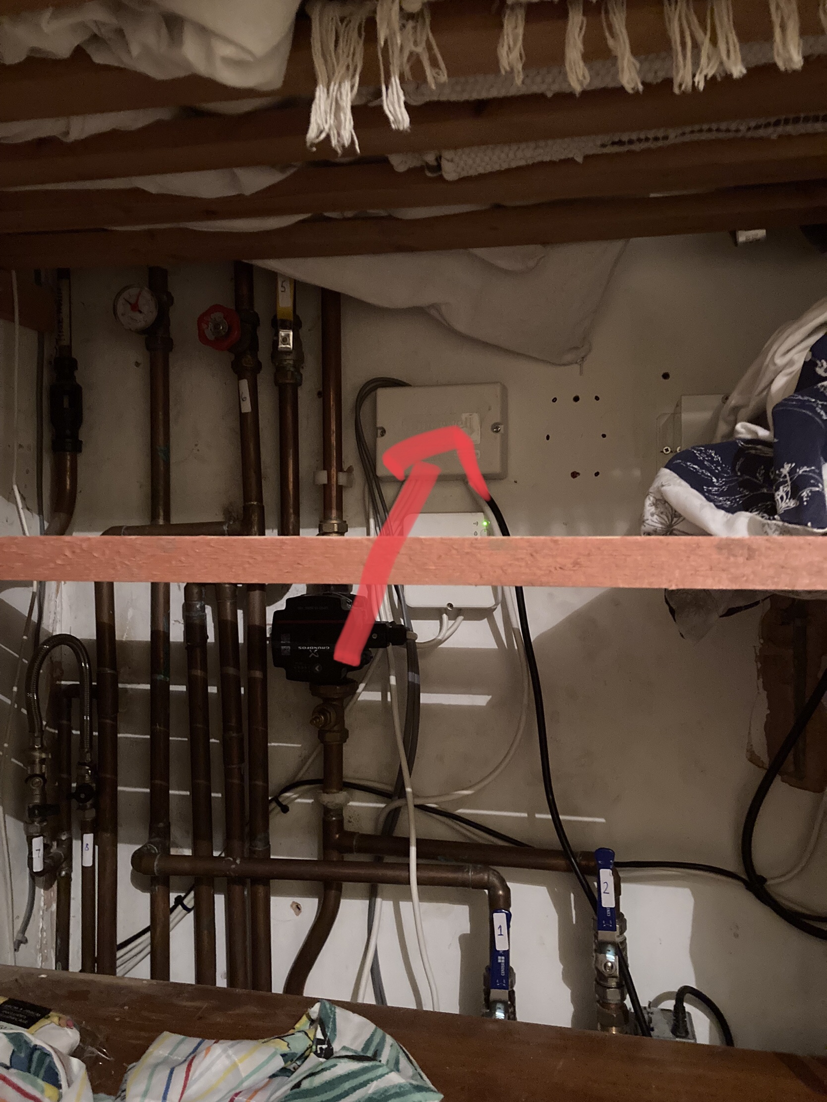

  2. You are correct. I’ve shown the CH pump, also motorised valve actuator. Pressure is 1.5 bar (ignore red arrow). Reckon my Therma V ASHP is as yours - unaware (not connected/integrated) with the CH pump. Don’t understand this point. “In my case I'm not using the Air + Water control option with Load Compensation so there wouldn't be any point anyway”. thx for FB. T
  3. There’s only one cable from the CH pump, to the Honeywell power unit. Att 1. CH and HW both have their own two way valve, means I can manually open individually or together to test. T

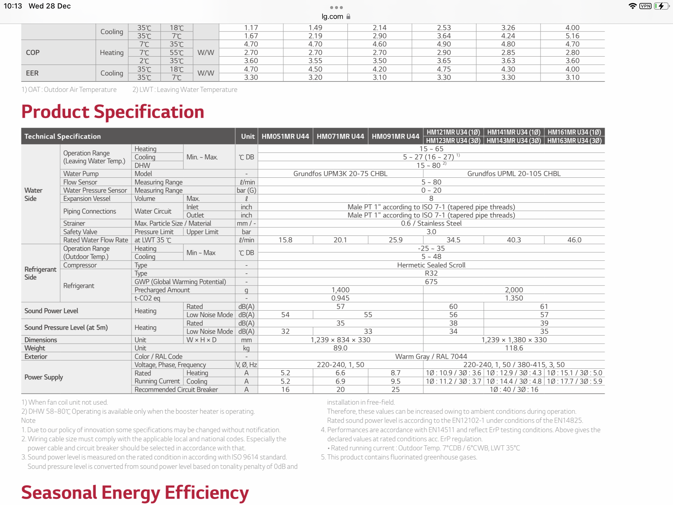

  4. Ok so updates as follows. 1. Flow Switch Flow switch removed and paddle appears ok. No debris. Connection and wiring checked, appears ok. Option remains to replace with lower switch rate. (ProDave). 2. ASHP pump Grundfoss 20-105 installed aligns to recommended spec. (Att 1). Document confirms runs at max. (per HughF I would assume that LG, like all good heatpump manufacturers, use a PWM controlled primary pump so they have control over the delta-T. So there should be no need to check what speed it is running at.) However, comments (AKJOS) and engineering document (Att 2) suggest inadequate flow with this single 20-105 pump. Option to add additional pump, or upgrade existing (15 to 25?). 3. Two way valve Located two way valve, as per guidance. Re valve response time (Kelvin, ProDave, ReedRichards) there is a manual switch on this valve. I’m unclear on how to check if there is an automatic by-pass. “But most motorised valves take less than 10 seconds to open, and there should be some form of automatic bypass valve to give some flow even when all motorised valves are shut. If you suspect this is your issue, you can manually open most motorised valves, so do that to one of your valves and see if the CH14 error stops.” Question - if it’s two way, then is the default (off/closed position) usually set on DHW or heating? Option remains to - refill the system. - check for ASHP motor running. - manually open two way valve and see if this has any impact. (Any guidance on exactly when to do this? When ASHP is running?). Again, thx all and HNY! Tim

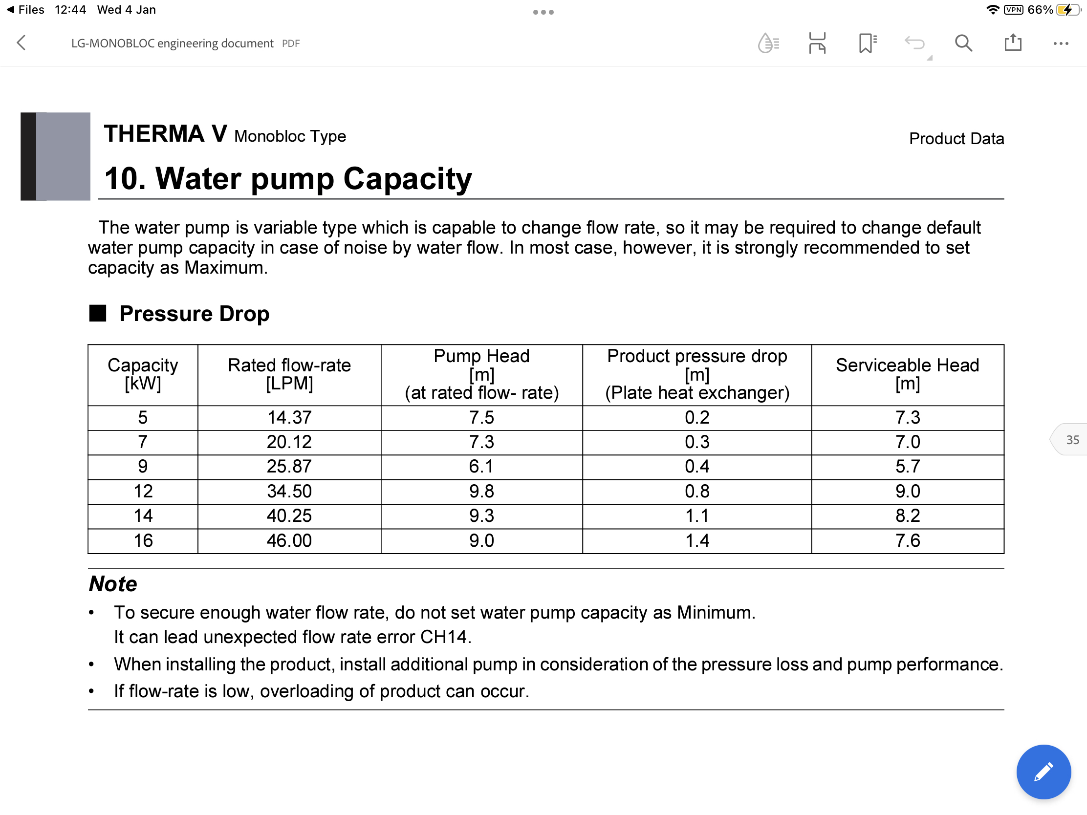

  9. Ok so looking at all those comments and using @ReedRichards checklist. 1. Strainers and filters blocked. Will check and clean filter (on next dry day ..). 2. Water pump, possible fault. - per @AKJOS, pump capacity should be 30 LPM (2.5 * 12j. Rated flow per attached technical document is only 34.5, so little tolerance. Recommends pump set to max (need to work out how to check this setting). - technical document I found refers to use of additional pump, also suggested by @ProDave, or replacement with larger pump (yes, there are isolating valves, enabling filter removal and cleaning). I have attached this technical document. See in particular - piping schematic (pp 15). - reference to CH14 errors arising from pump setting (pp28), including the following info. “The water pump is variable type which is capable to change flow rate, so it may be required to change default water pump capacity in case of noise by water flow. In most case, however, it is strongly recommended to set capacity as Maximum. Note • To secure enough water flow rate, do not set water pump capacity as Minimum. It can lead unexpected flow rate error CH14. • When installing the product, install additional pump in consideration of the pressure loss and pump performance.”. 3. Flow switch abnormality (leave for now). 4. PCB fault (leave for now). PS document too big to attach, see https://cms.intermetal.bg/storage/uploads/2019/12/02/5de4e66b09ef03.---LG-MONOBLOC.pdf Thx for support, Tim
