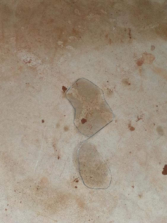

Moonshine Posted December 13, 2022 Author Posted December 13, 2022 4 minutes ago, Bonner said: What exactly makes you think it has frozen? You’ve got water coming out of the manifolds which will be colder than in screed. Also you had 1 bar of pressure. If it has frozen, you might expect the pressure either off the scale due to expansion, or zero if it’s leaking (although it depends if and where an ice plug may have formed). I would be surprised if it has frozen and even more surprised if UFH pipe has burst. The water in the external hosepipe feeding the site are frozen you can hear the ice crack in the hose pipes when they are bent. Regarding the pressure I think that the one bar it's measuring is at the manifold and an 'ice plug' has formed. I do hope that I am wrong, going in there in a bit and see of the patches have changed from those marked out last night

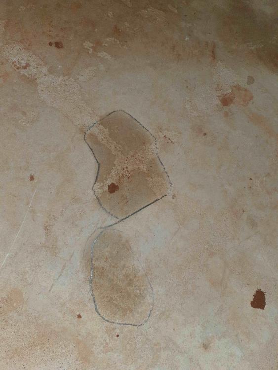

Bonner Posted December 13, 2022 Posted December 13, 2022 4 hours ago, Moonshine said: I do hope that I am wrong, going in there in a bit and see of the patches have changed from those marked out last night what do your damp patches look like then?
Moonshine Posted December 13, 2022 Author Posted December 13, 2022 5 minutes ago, LA3222 said: It should be even easier because the leak area is known so the assumed faulty loop should be easy to identify. yes the leaks that i can see are all in one loop, looking at other loop areas i can't see any other wet spots on the other loops, and am surprised that its not happened in other areas. weather is warming up from the end of the week and should thaw out the UFH pipes (if they are frozen), my plan is to see how it dries out and give the problematic loop a wet pressure test up to 4 bar and see how it fairs.

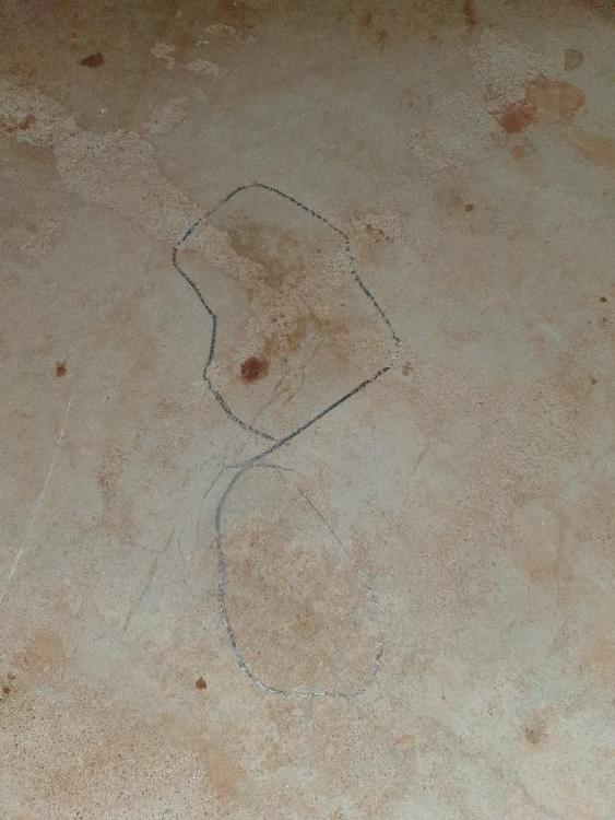

Moonshine Posted December 13, 2022 Author Posted December 13, 2022 (edited) 14 minutes ago, Bonner said: what do your damp patches look like then? i don't know if you are taking the pi$$ or not, but the extent of them haven't really changed but they have got damp again after my hair dryer drying (not deep drying). its about 3 degrees here, so i am not expecting much change in them. I think that the only real test will be when it thaws out, and i can put the system under a higher pressure again (over the 1 bar its indicating at the moment). Also checking on the the pressure in the system if that drops as it thaws. I may in the near future do a dig out of one of the biggest damp spots to expose the pipe and get an eyeball on it. Edited December 13, 2022 by Moonshine
Bonner Posted December 13, 2022 Posted December 13, 2022 6 minutes ago, Moonshine said: don't know if you are taking the pi$$ or not ?! you said you going back to have a look, I am interested to know if UFH pipes do split if they freeze
Moonshine Posted December 13, 2022 Author Posted December 13, 2022 15 minutes ago, Bonner said: ?! you said you going back to have a look, I am interested to know if UFH pipes do split if they freeze I looked at the patches this morning, and they haven't got any bigger (yet). But yes it appears they can split if they freeze and there is guidance on this matter out there.

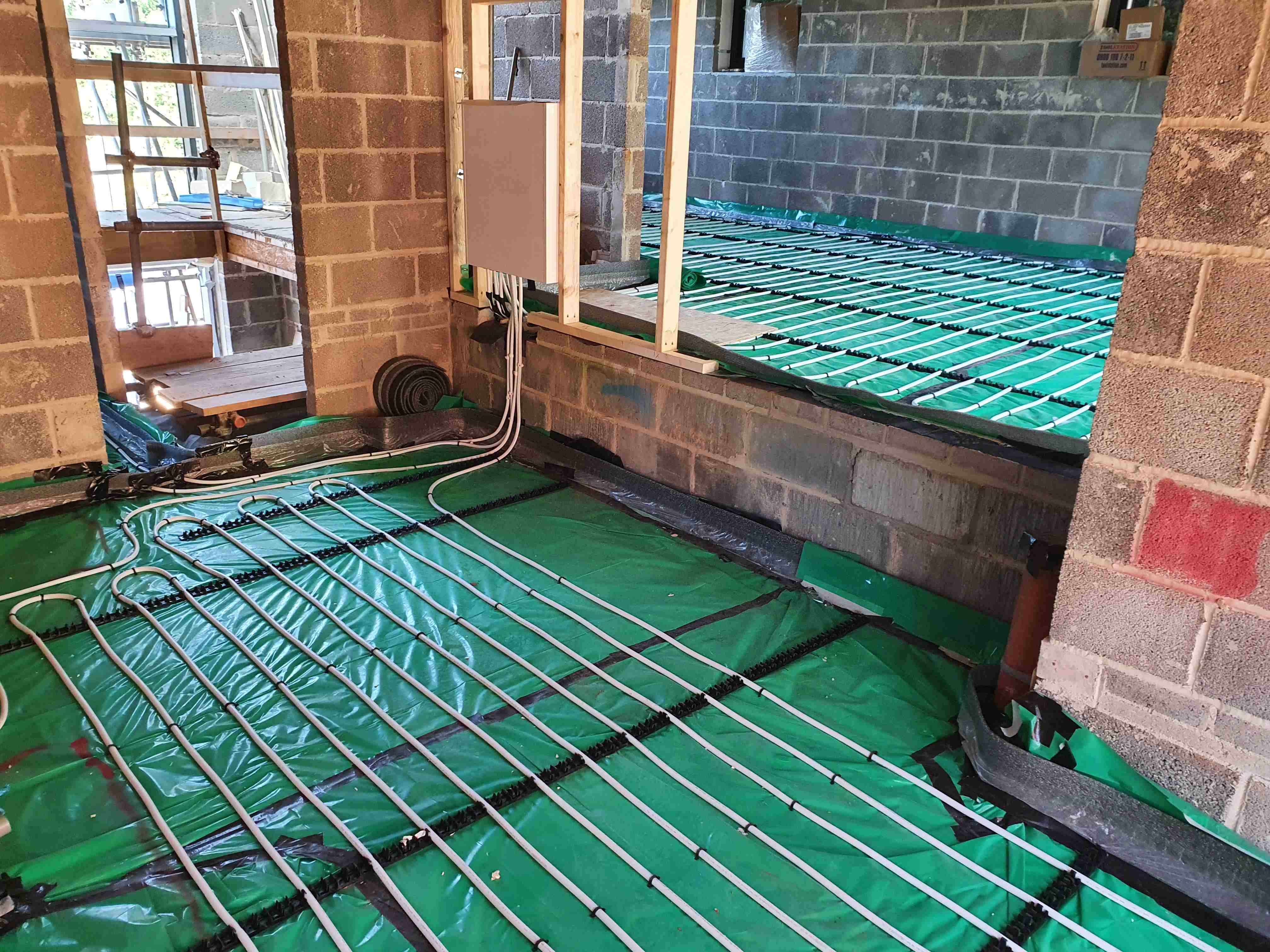

Moonshine Posted December 13, 2022 Author Posted December 13, 2022 10 minutes ago, Radian said: It could of course be that they're still frozen solid. What's the opening at the top of your photo? The wet patches seem to be only in this area. Just wondering if it's potentially colder or warmer here. I'm sorry if replies sound a bit too matter-of-fact, I think there's a lot of sympathy here and it's not even certain that you do have a problem yet. It's a stepped house and this is another area of the house which has a deeper floor void under the block and beam and more air under it. Don't worry about the tone, would love if this was just fuss about nothing and time will tell
Moonshine Posted December 13, 2022 Author Posted December 13, 2022 This is what the area looked like mid August just before screed went down
