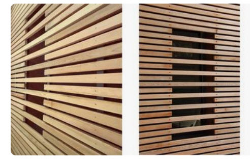

I've been researching cladding options and I quite like the idea of splayed cladding detailing. I.e.
All the companies that supply it mention that you need "weather protection" due to the open nature of the boards (which is pretty obvious). But, nowhere can I find what the recommended means of weather protection is? It would be going onto a timber frame.
Is the answer as simple as; batten, fully weatherproof board, batten, splayed timber?
In other words you clad it twice!

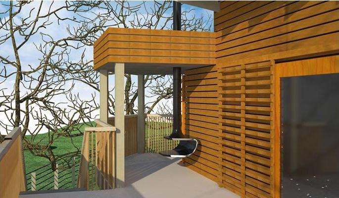

Surely a breathable membrane would suffice? That's what I ve used on mine, although it's within the overhangs of the balcony so is nt really exposed

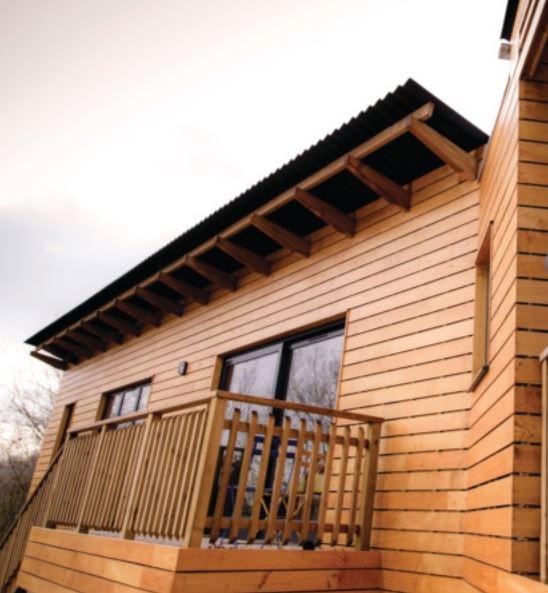

The house I saw with that particular style of timber cladding used profile metal sheets as the weatherproof layer on the walls and roof, battened then over clad the whole building (inc roof) as pictured.
I have seen that done/ The outside was clad in a breathable membrane, then battened then clad.  I thing the crucial thing in the one I saw, was the gaps were narrow, and the edges were cut at an angle, so water entering the gaps would drain outwards, so probably not much would rain would get through the gap.

There's quite a wide range of breather membranes out there. Being a bit ocd, I compiled a list of options with info pulled off the BBA certificate. So I was able to compare g/m2, tensile strength in two directions, nail tear strength, and UV exposure rating.
It is that last factor that is likely to be crucial. Most membranes are only rate for 3-6 months of exposure, so if your cladding detail allows light to fall on the membrane you might be in trouble. Having said that, my wall membrane was fairly cheap stuff and has been keeping the weather out for about a year now, doing a much better job than I had dared hope.
@Barney12
maybe all you need behind the timber is a black coloured UV resistant breather membrane and black battens.

This is what I did - although mine is more for aesthetics so that you can't see the shiny silver membrane of the timber frame itself. Its pretty sheltered from the weather as you can see it in my amazing blog.
The hardest part I found was finding a membrane that did nt have a great big logo/name of manufacturer plastered all over it.

Yes, if its a proper breather membrane it will provide full weather protection. Obviously common sense needs to come into it as it won't take a snow load etc.
Your main issues:
UV resistance (difficult to assess quality?)
is an insect barrier required?
Colour of the membrane will probably need to be black or dark grey
