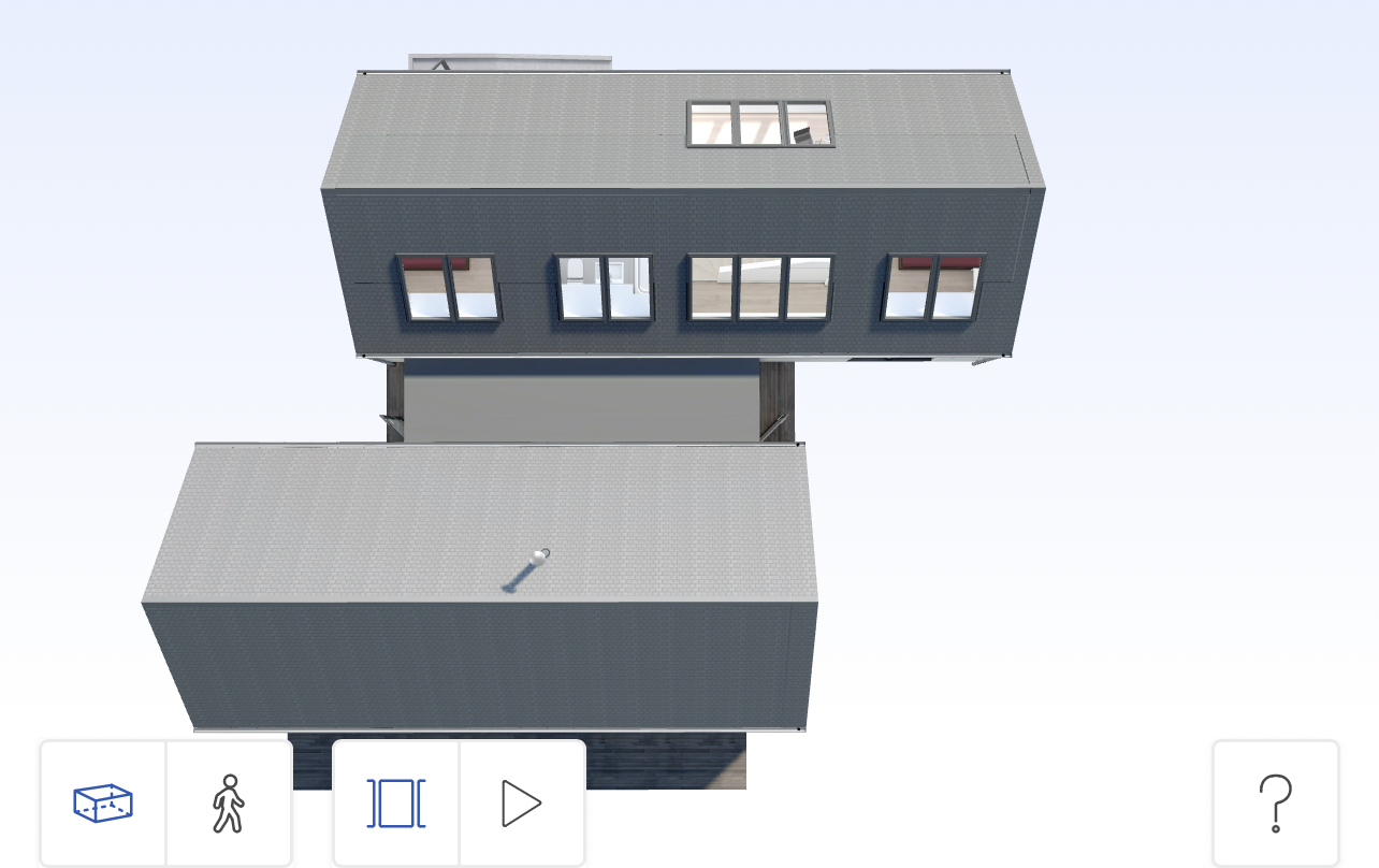

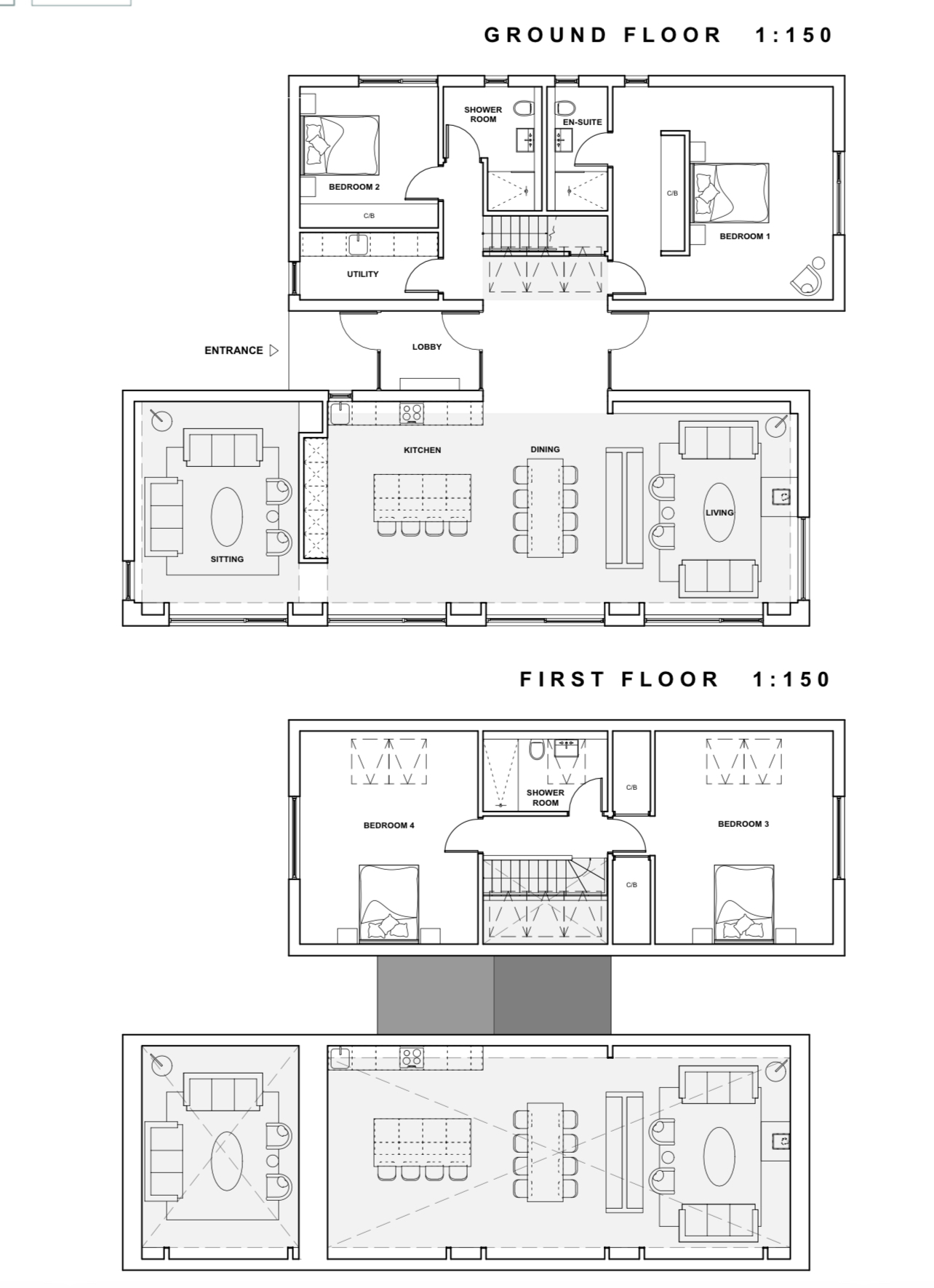

beebee Posted November 27, 2022 Posted November 27, 2022 Hi all, hoping to get some advice/input on our house plans. Bit of background - we have a site in Ireland (flat, 1.12 acres, road on south boundary, nice view visible from first floor height) and are in early stages of design. We spent over a year waiting for an architect but the estimated build cost for their design was 350k above our clearly stated budget. We eventually parted ways as they did not believe it was possible to build a house for our budget. I know I'm probably sounding like a nightmare client already, but neighbours of ours are in the final stages of a build that will come in at 100k UNDER our budget. They designed their own house, had an engineer do the plans and then used a local (1km away) timber frame company. We will be using the same engineer and TF company as them and working from the same list of recommended trades. On their encouragement and after a few meetings with the engineer and TF company owner, we've decided to do the same thing. I did some basic sketches and sent them to the engineer who sent back the drawings below. I have sent back a new sketch with some changes including adding a door between the kitchen and KDL, changing window sizes, moving veluxes upstairs etc. I plan to PM the job myself - I have no experience at all but I'm not working this year so have plenty of time. We live about a 5 min drive from the site. All opinions and input welcome!
ProDave Posted November 27, 2022 Posted November 27, 2022 If you want minimum price per square metre (and wile we are at it, minimum heat loss per square metre) that design is NOT it. On such a large site, I cannot imagine it is the site making you build to that inefficient shape. If you wanted cheaper build cost, I am surprised your ex architect did not mention this to you? P.S we only tried to have dealings with an architect once and his estimated build cost was twice what it finally cost us, for almost the same house.
nod Posted November 27, 2022 Posted November 27, 2022 I agree with Dave Architects over budget everything Anyone trying to keep to a budget should steer clear of TF A convenient but expensive way to build
beebee Posted November 27, 2022 Author Posted November 27, 2022 Hi ProDave, thanks for your input! The architect's design was completely different, it involved a cantilevered monopitch roof and a multitude of acute angled walls! We essentially started from scratch after ending the contract. I'm not looking for the absolute minimum price per square metre, the basic reason behind the design is to have most of the rooms downstairs (we have 3 small children and some disabled family members) and to give every room a south facing window (with a brise soleil/overhang). The obvious solution is to plonk the bedroom block on top of the living block but I'd like to see how costings come out for a design similar to this one first before sacrificing the single storey plan.
Kelvin Posted November 27, 2022 Posted November 27, 2022 (edited) That’s a poor design both for efficiency and layout. Google some timber frame companies and have a look at their designs for ideas. The simplest most efficient to build are squares/rectangles either 1.5 or two storey. Edited November 27, 2022 by Kelvin

beebee Posted November 30, 2022 Author Posted November 30, 2022 I can see what you mean about inefficiency, the idea behind two blocks is to have a kid block and a main/adult block, with the possibility of being able to split the house in future for our older parents/an adult child and their family. We have 3 kids so initially we would be in the bigger room downstairs, the younger two would share and the older child have their own room, then when they are all older we would move into the guest room upstairs and give each child their own room.

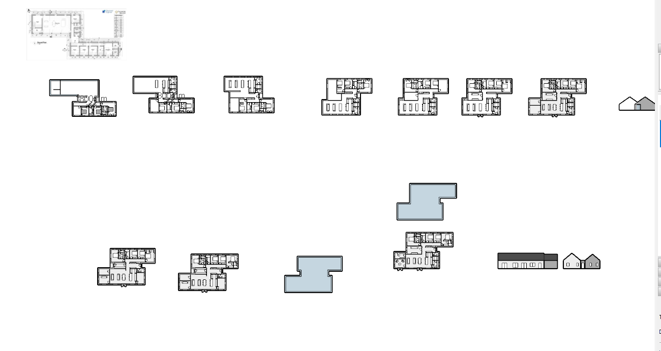

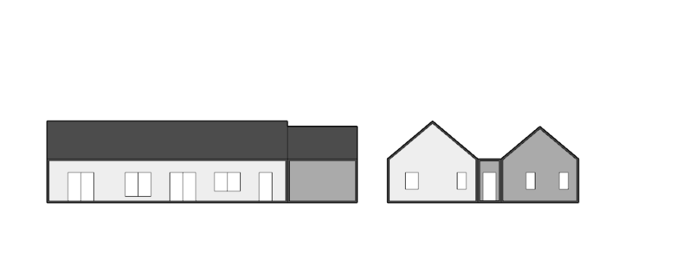

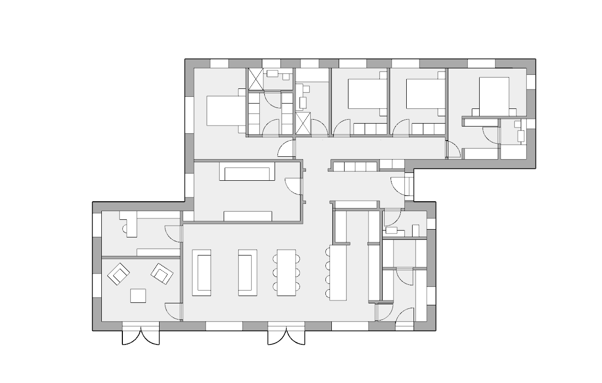

Iceverge Posted December 3, 2022 Posted December 3, 2022 A reduction to 227m2. I did away with the upper level. I've tried to keep all the existing rooms, upped the external walls to 500mm. Light to arrive in the north side via sky lights. I haven't drawn them. Please query if anything in the picture doesn't make sense.
Iceverge Posted December 3, 2022 Posted December 3, 2022 Here's the rough work if you like anything ( or can see it ) I'll post it up.
Kelvin Posted December 3, 2022 Posted December 3, 2022 (edited) These are great designs. I was really keen to do similar but our plot doesn’t cater to this kind of design. This is what we considered: (238m2) Edited December 3, 2022 by Kelvin
Conor Posted December 3, 2022 Posted December 3, 2022 The two separate (linked) blocks looks great but adds huge amounts of cost and hampers practicality and efficiency What are the constraints of your plot and can you come up with a virtual box of the biggest building foot print you can have? I think the first drawing you posted could be tweaked a bit and be practical and more affordable but still interesting. 1
