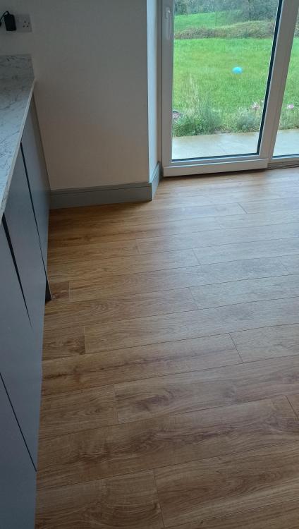

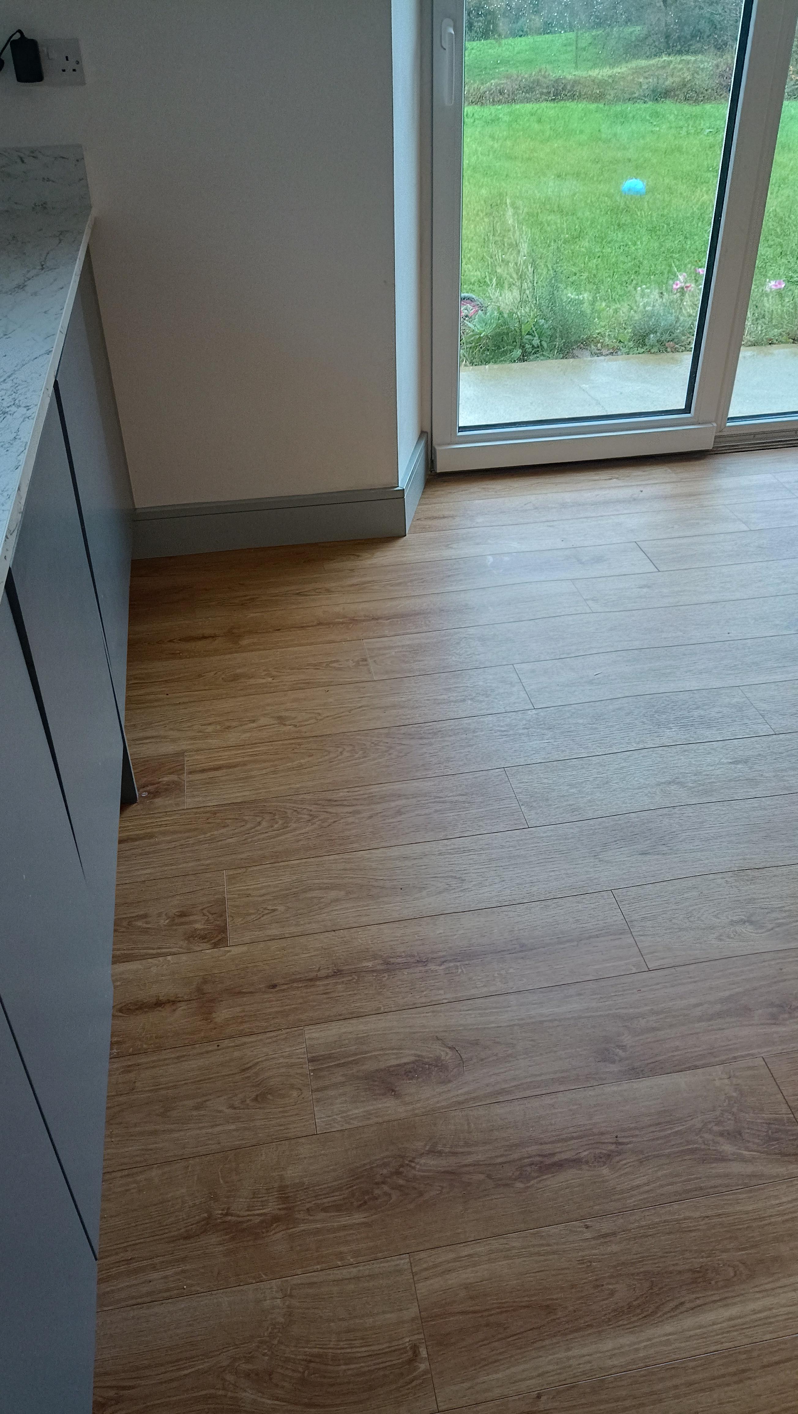

Iceverge Posted November 19, 2022 Share Posted November 19, 2022 Oak effect click down LVT here. I think it is quick step by another name. Easy to lay ( once your floor is dead smooth) Hides dirt tremendously. That floor is filthy!! It has certainly reduced visits to the first aid kit for small kids. It's warm underfoot even with UFH. Be cautious of floating it however. I did over 12m stretch maximum length. I left the reccomended length for expansion but it became trapped by furniture and bulges a little in the direct sunlight. I think that's due to using a thin underlay which slows the soaking of heat into the floor and heats the LVT more. Smaller areas I used it without underlay I had no problems. 2 years in and it's proving hard wearing. Link to comment Share on other sites More sharing options...
