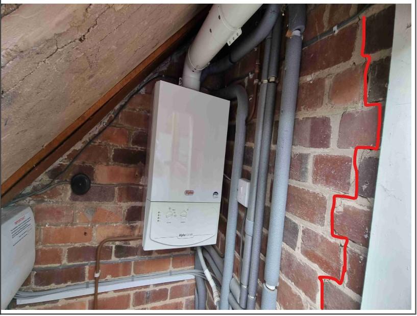

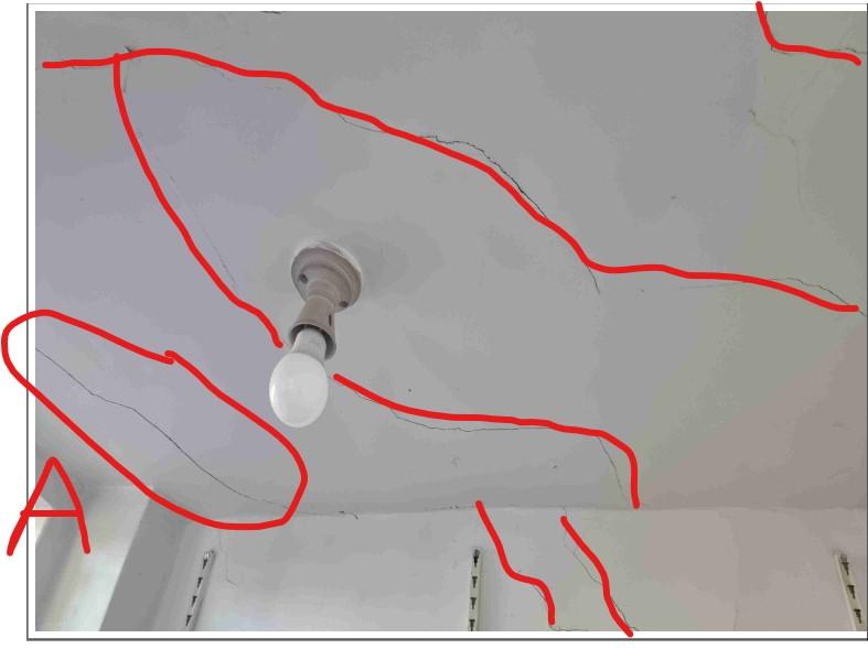

SilverShadow Posted November 13, 2022 Share Posted November 13, 2022 (edited) Hi there, My 1st post on the forum, and hoping you guys can help with our quandary please 🙂 My partner and i are looking to purchase a house, and our lvl 3 RICS survey has highlighted the potential for needing structural rework (sloping floors, cracking in interior plaster, some vertical mortar cracks in brickwork). From the checks we've had (Struc Engineer report & drain survey), it seems as though the waste sewer running alongside the house has failed in several areas, though there might also be some ground movement (can't yet tell if the subsidence is from soil erosion from drains, or ground, or both). Obviously we'd get a more detailed structural analysis if we proceed, but wanted to gather a few initial thoughts from anyone in the know. Our questions are around the following: 1) I've read that resin injection with geopolymers can be a cheap & effective alternative to underpinning - just wondering if anyone had used this & what their thoughts were (we're thinking of using Geobear, unless anyone can recommend a better UK company)? Have heard it's around £1200/metre.... 2) When using something like this, are there any implications if we decide to build a house extension over/around that area at a later date? 3) I've read that house structural rework can cause problems with insurance & resale value. Apparently, resin injection avoids this, as it doesn't 'break the ground', hence no need to declare it. Does anyone know more about this claim of avoiding the insurance/resale issue? 4) Does anyone know what is classed as 'structural repair' that may affect the house value/insurance? Eg, if we use helibars to repair the brick mortar cracks will this need to be declared or just part of the normal process of house repair? 5) Any other advice/tips/gotchya's from anyone who's experienced similar when fixing their property Many thanks for you help - totally appreciated Mark Edited November 13, 2022 by SilverShadow Link to comment Share on other sites More sharing options...

SilverShadow Posted November 14, 2022 Author Share Posted November 14, 2022 (edited) Many thanks again. The vendor did get their insurers to hire a SE company to perform a report, based on a visit. Their report highlighted the following: External: The cracks observed appear to be due to thermal movement, settlement of foundations and potentially defective underground drainage. Kitchen/Bathroom floors (bathroom is above the kitchen): The sloping and uneven floors appears to be due to historic and/or active settlement and timber creep General: The property appears to be structurally stable but is in below average condition Underpinning, Geobear or similar works will be required, if cracks re-appear after helical bar installation. A CCTV is recommended to check the condition of the underground drainage system Sloping/uneven floors can be removed and replaced once any cause of drainage failure/subsidence has been rectified The drain CCTV did identify places where the clay pipes had moved to expose a few clear gaps for water to leech into the soil, so we envisage this will be a main factor, though have no expertise as to how much a leaking drain would feasibly create holes big enough for the foundations to sink. Overall, our budget for shoring up the foundations is around £15-30k(ish), which we'd hope would cover most if not all of the rework along various points of the 8m house sidewall. Our surveyor costed £17k on other items identified in the survey, and as mentioned we've also allocated up to £33k for structural rework, but overall wary of whether a repair budget of £35-50k would typically cover enough to make it viable. We are very much on the fence with the house - it's not a ramshackled heap of bricks by any means & we're not afraid to find problems, but also quite aware it hasn't been 'loved' for many years & appreciate it might need lots of work in several key areas Edited November 14, 2022 by SilverShadow Link to comment Share on other sites More sharing options...
