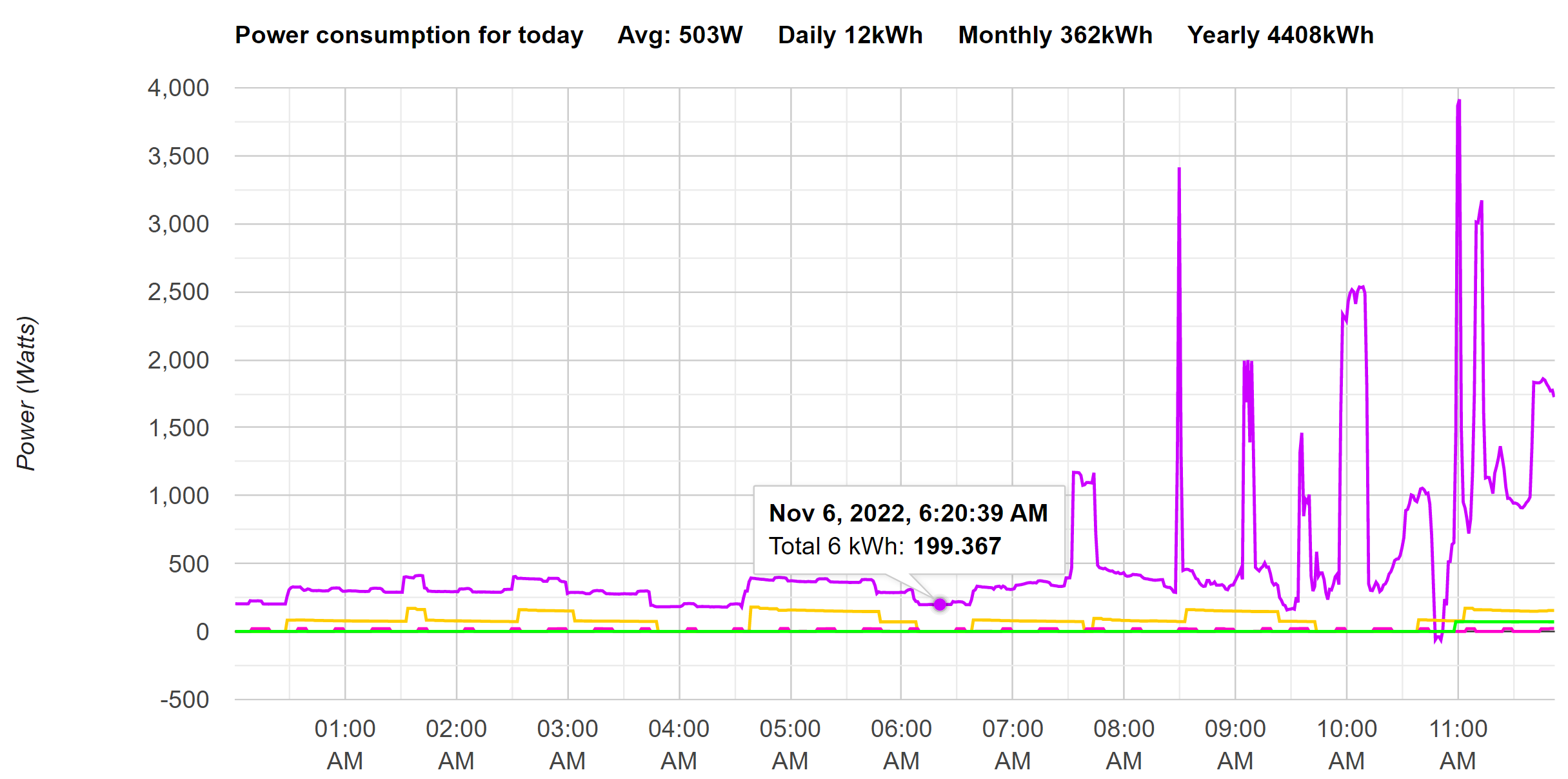

Alan Ambrose Posted November 6, 2022 Posted November 6, 2022 Anybody else have actual numbers for their base loads? It would be handy to see what the realistic ranges are. Alan

Radian Posted November 6, 2022 Posted November 6, 2022 I started a similar topic back in september: The big benefit was to be blackout-proofing for the essentials like internet and heating. I concluded I needed 2.4kWh battery storage and 800W inverter to be useful. Unfortunatley the required outlay of around £1300 proved too much for a 'nice to have' at the moment. My baseload ignoring fridge freezer is a fairly predictable 200W which is mostly the routers, NAS, Sky box and a handful of Rpi's plus all the smart gadgets sprinkled around: The mouseover above at 6:20 is in a gap where the fridge and freezers (little red blips and yellow humps) is a fairly predictable 200W. These power traces are superimposed on the total grid measurement in purple.

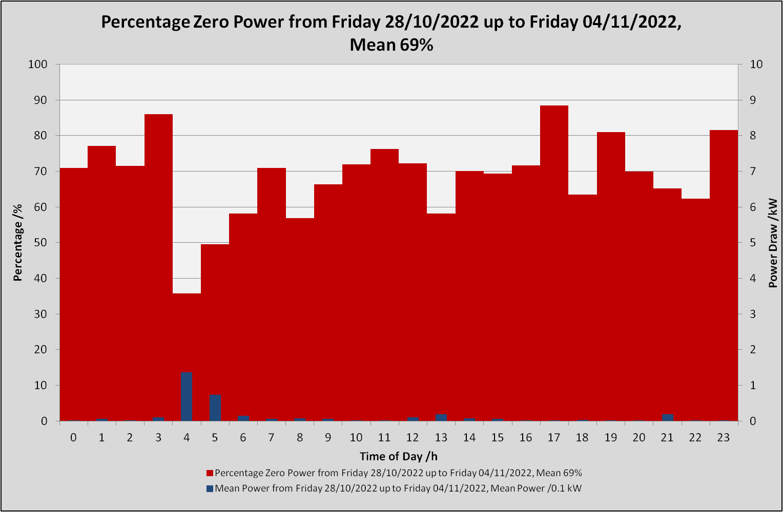

SteamyTea Posted November 6, 2022 Posted November 6, 2022 @Alan Ambrose So last weeks usage. Mean power draw of 0.1 kW, so 16.8 kWh for the week, 7 kWh day usage and the remaining 16.8 kWh night usage. 69% of the samples are Zero Power (78,931 samples, mean sample time 7.7 seconds).
Alan Ambrose Posted November 7, 2022 Posted November 7, 2022 Ah, so 100W base load? Does that include fridge/freezer etc? Alan
SteamyTea Posted November 7, 2022 Posted November 7, 2022 On 07/11/2022 at 11:28, Alan Ambrose said: Ah, so 100W base load? Does that include fridge/freezer etc? Alan Expand If that was a reply to me, then no. The 0.1 kW is the mean load for everything. It is actually a little higher but I rounded the result, use about 3.3 kWh/day, so about 138 W. It could be argued that at nearly 70% of the time I draw no power at all, my base load is 0 W.
